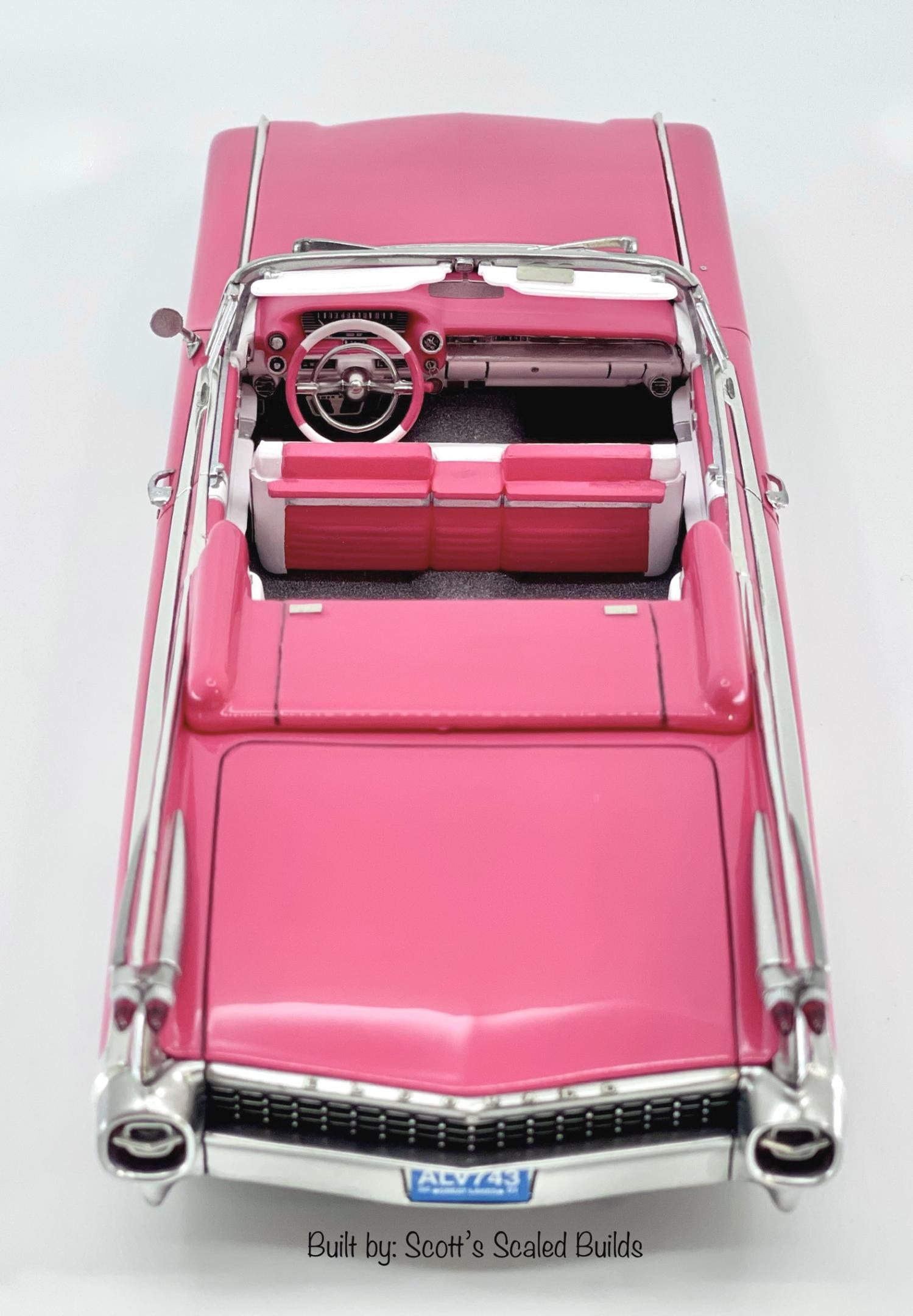

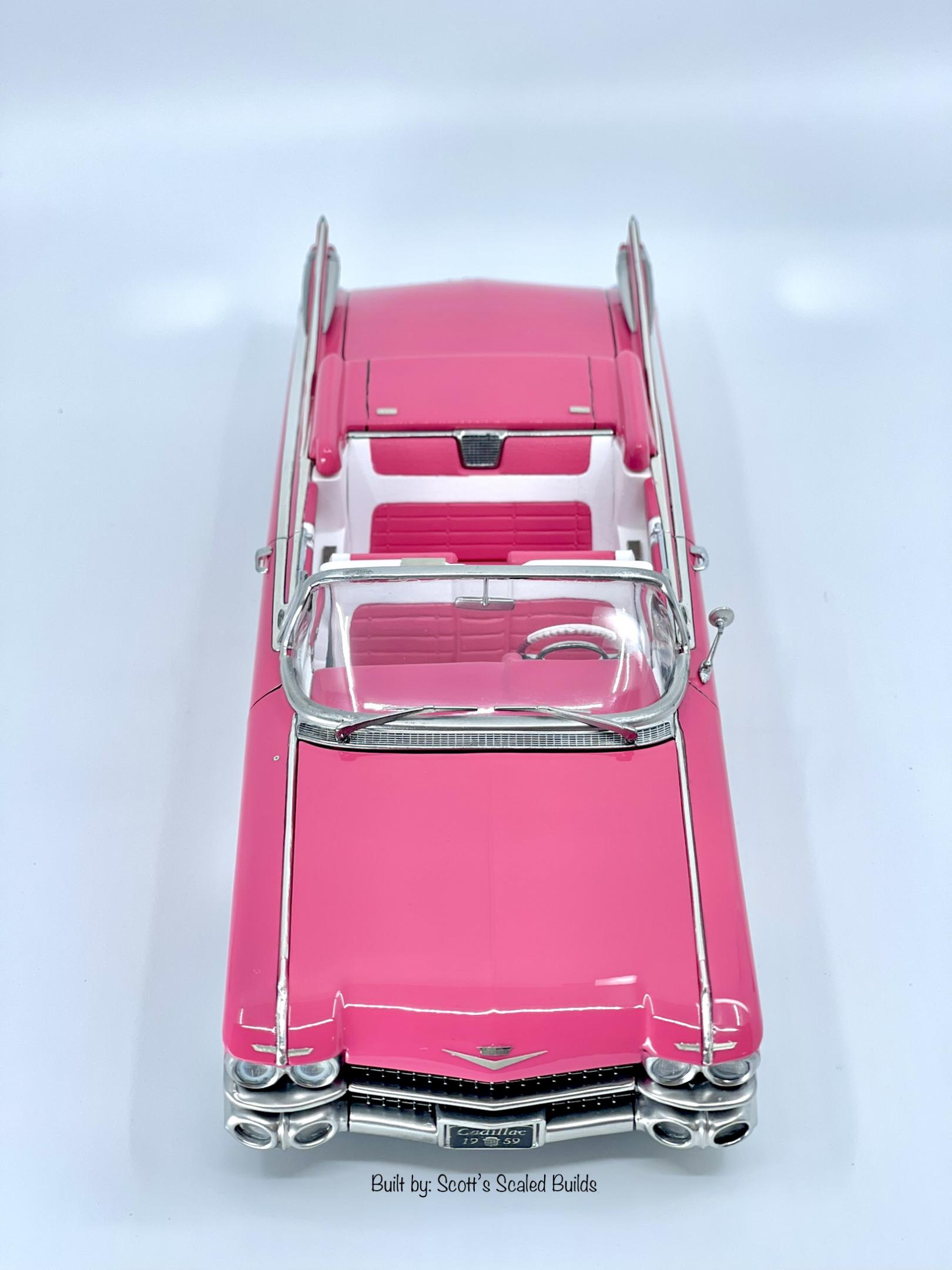

lghtngyello03 Posted June 16, 2021 Posted June 16, 2021 Finally able to call this one complete. I didn’t post any WIP pics on here as they’re all on my Instagram account Early 90s Monogram 1959 Cadillac Eldorado 1:25 scale. I have to say I was impressed by the quality of this old kit. No real major issues on fitment or anything. Paint is finished in ScaleFinishes Ford Tropical Rose and topped with Splash Paints 2k Clear Coat. The chrome trim is done using BMF, and all of the bumpers and things such as this, are finished in SpazStix Chrome. All emblems are part of the Modelcar Garage Photo-etch set for the 59 Caddy. I decided to lower the kit some to give it a good stance, and the wheels and tires are from the Foose Eldorado kit, also finished in SpazStix Chrome. Interior is completed using embossing powder for the carpeting, and utilizing the photo-etch parts, again from Modelcar Garage. The engine bay is fully wired and plumbed. I also added some fender brace bars as I noticed on the 1:1 from some reference pictures. Thanks for looking! 3

espo Posted June 16, 2021 Posted June 16, 2021 Beyond the beautiful paint and trim I like the fine details thru out. I spent some time studying the painting details on and around the engine and the chassis. The longer I look the more fine details I notice. The same can be said for the interior. 1
lghtngyello03 Posted June 16, 2021 Author Posted June 16, 2021 3 hours ago, echo said: Nicely done and nice presentation. Thank you sir!! 2 hours ago, espo said: Beyond the beautiful paint and trim I like the fine details thru out. I spent some time studying the painting details on and around the engine and the chassis. The longer I look the more fine details I notice. The same can be said for the interior. Thanks man! Yes, the more you look the more you’ll find lol. There are vacuum hoses off the actuators, tubes for the windshield fluid bottle, battery cables, heater blower vent tube, and the list goes on lol.
Classicgas Posted June 16, 2021 Posted June 16, 2021 Hands down the best build i have ever seen of that kit. How did you do the gauge panel? 1
lghtngyello03 Posted June 17, 2021 Author Posted June 17, 2021 5 hours ago, Classicgas said: Hands down the best build i have ever seen of that kit. How did you do the gauge panel? Thank you very much sir. I bought them from a seller on eBay that I use often. They’re not a water slide, they’re just printed and you cut them out and glue them in place. https://www.ebay.com/itm/1959-CADILLAC-ELDORADO-GAUGE-FACES-for-1-25-scale-REVELL-MONOGRAM-kits-PLS-READ-/203490746607?_trksid=p2349624.m46890.l49286 1 hour ago, bisc63 said: Very well done; just beautiful. thanks man!!

89AKurt Posted June 19, 2021 Posted June 19, 2021 I have the kit and p-e, so of course I studied your very well done model. I also bought the last gauges. ? One thing I did that not everyone would do, got the dash chrome plated. If I ever build it, will search for this thread. ? 1
