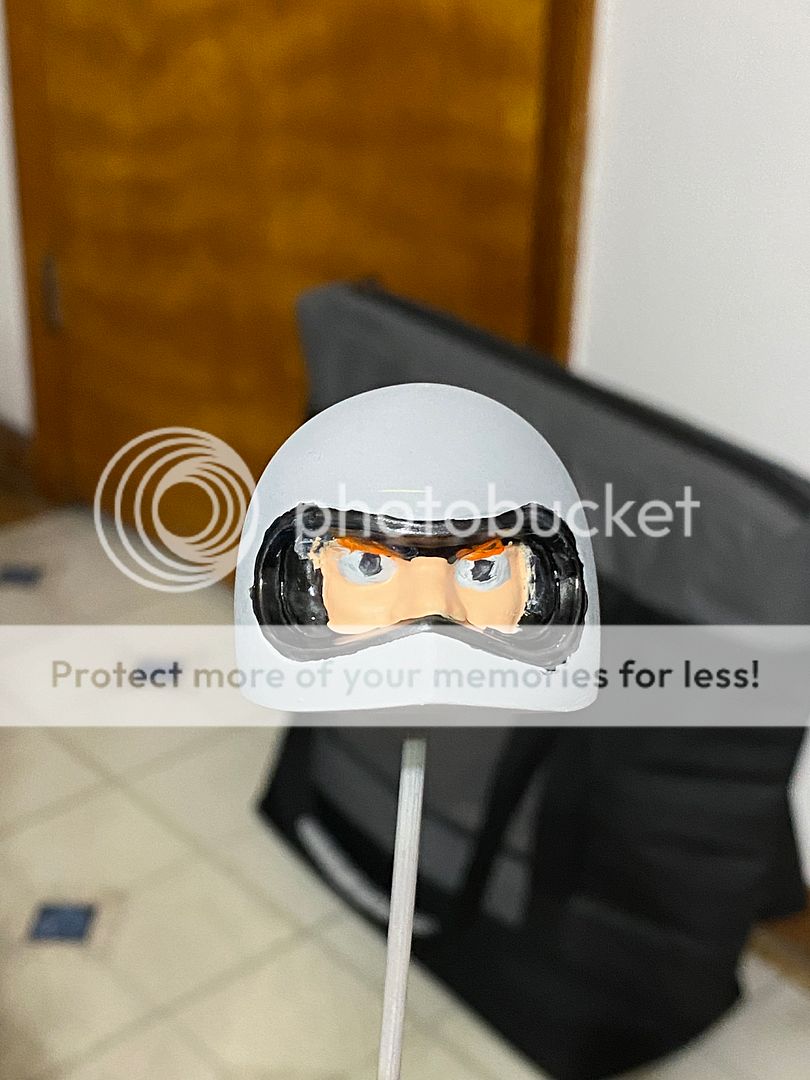

Turns out the WR-02 and GF-01 share a large number of parts, even though one is 2wd and the other is 4wd and have similar dimensions that make putting the Wild Willy body on the Monster Beetle Trail’s chassis very simple! Not only were these both use ABS plastic “hardbodys” that need to be painted like a model kit, but Willy also has a driver figure that needs to be painted too. I used Jeep Moss Green Metallic automotive touch up paint mixed and canned by my friend Miguel at RestoPaint in West Chicago from Sherman-Williams automotive product for the color coat in the truck body and helmet then gloss cleared the helmet and flat cleared the truck then painted Willy with a mix of Testors Enamels, Vallejo and Games Workshop Acrylics, and Tamiya Flat Clear after the body was painted,  this also just so happens to be the first figure I’ve ever painted too!

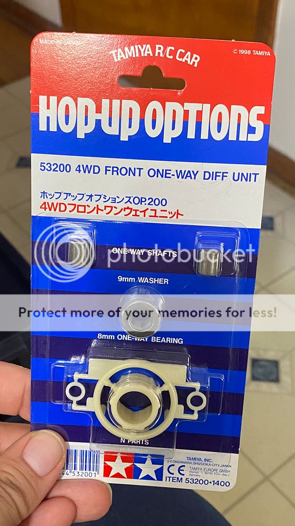

Unfortunately, it did endo while shooting some video of it yesterday and I now have a one way front differential on order for it to fix that little drivability issue and plan on removing the roll bar and painting it and the roll bar lights  where the silver pinstripe tape isn’t with the bedliner I used on the spare and inside the tub.

Got the part to fix the end over problem in the mail today!
818EC369-C840-4585-B250-FB44BDE9D53D.jpe
So long as I put it in the right way, the truck will be 4wd going forward and RWD in reverse and while braking!  Sounds like this is a common mod for this chassis in the Japanese market.
