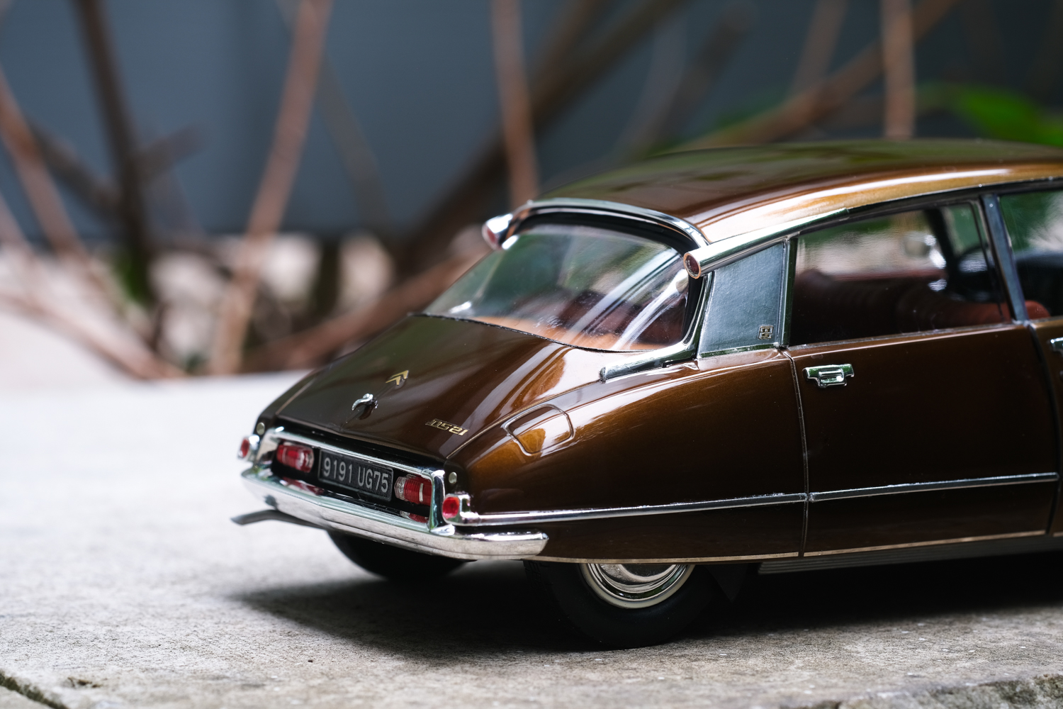

e30lover Posted July 3, 2021 Posted July 3, 2021 Hi all, I finally finished Ebbro 1/24 DS21 Pallas - it’s a fairly new release from Ebbro and it’s a fantastically engineered kit with working doors and full engine and suspension details. I built this one completely box straight - DS was available with many beautiful colours but I thought DS21’s Brun Scarabée is pretty iconic, so I laid Mr Color’s GX109 clear brown on top of chrome silver to simulate that. As for the interior, I used mix of Tamiya acrylic red, yellow, brown and tan to simulate brown interior and carpet, then laid semi-gloss clear on top of all leather trims to get the similar sheen. As for the rest of interior details, I used BMF and Molotow chrome marker. As for the body; Removing sink marks with 600 > 1500 grit Tamiya grey surfacer Mr color’s chrome silver 2 layers of gx109 clear brown 3 layers of Mr color’s super clear III with 3000 grit sponge before the final coat drying the paint for 1 month in room temperature 3000 grit sponge > Tamiya compounds Applying BMF matte aluminum to C pillar Even though the overall quality of kit is very impressive (after all Ebbro has very close tie to Tamiya), there were a few pitfalls such as chrome trims that go around the roof, incorrect looking wheel caps, and headlamp cover that doesn’t have vertical hairlines. Hope you guys enjoy! 3

Anglia105E Posted July 4, 2021 Posted July 4, 2021 This is an excellent build of yours, Chang....... I particularly like the technique that you have use for the paint finish on the body exterior. Clear Brown over Chrome Silver, that really works. Also, this is a very nice kit from Ebbro, and I have thought about purchasing one of these before, but they are rather expensive here in England. Your attention to detail is very accurate, and you have produced a top quality result. This model car looks highly realistic and you should be very proud of this build. David
