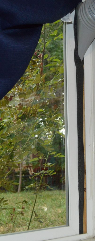

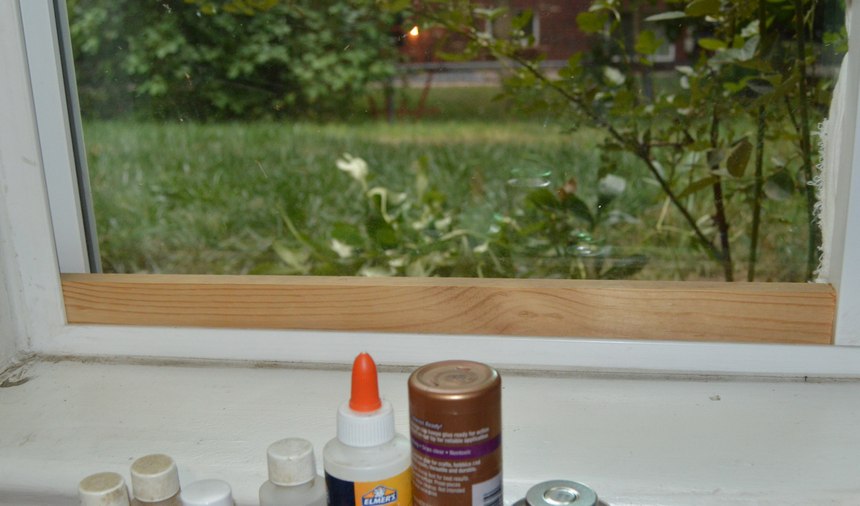

Straightliner59 Posted July 18, 2021 Posted July 18, 2021 Here's my setup. As a renter, it needs to be temporarily permanent. Although I plan to replace the flex across the top of the window with rigid pipe, it draws wonderfully, as it is. The only time I experience any lingering paint odors is when I need to change the filter. I can remove the installation, and return everything to normal, in five minutes, or less. It's secure, as well. If anyone would like further details about the installation, please ask!

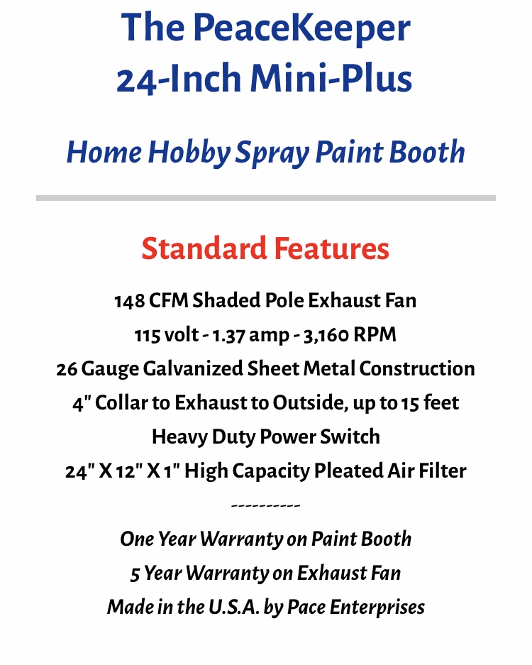

Tom Geiger Posted July 19, 2021 Posted July 19, 2021 1 hour ago, Zen said: Stock fan that came from Pace. It will actually suck the filter in when turned on. Only thing I did to it was rotate the fan to push out the back. Amen! I find the set up in my Pace booth more than acceptable. I originally was concerned because I mainly use spray cans. People who actually own the booths assured me it was fine. Here’s the specs right from their website. The 24” units both use the same setup. The 36” unit has a 265 CFM fan. What drives me crazy in these threads is the people who don’t own the unit and probably never even saw one in person giving disparaging advice.
Aaronw Posted July 20, 2021 Posted July 20, 2021 16 hours ago, jchrisf said: Yes, it is only marginal. I wish I would have found this one first because it has 2x the cfm and built in LEDs.. Mine is 24" wide so about the same size as the pace mini but I put a 465 cfm blower on it, Pace uses a 148cfm blower. I considered one of the Pace booths, but after pricing materials I was able to build one for about 1/2 what they wanted. Mine is made from plywood so it is heavy but it lives over in its corner and doesn't need to move. They look like a well made booth so it is a shame that they use such a small blower, it would only add another $30 to go to a 265cfm, and probably less since they would be buying in bulk. Maybe they assume people will just use an airbrush with it. 1
Aaronw Posted July 20, 2021 Posted July 20, 2021 12 hours ago, Tom Geiger said: Amen! I find the set up in my Pace booth more than acceptable. I originally was concerned because I mainly use spray cans. People who actually own the booths assured me it was fine. Here’s the specs right from their website. The 24” units both use the same setup. The 36” unit has a 265 CFM fan. What drives me crazy in these threads is the people who don’t own the unit and probably never even saw one in person giving disparaging advice. I've found both. When I was looking for a booth, I looked hard at Pace, and very nearly bought one. I talked to quite a few people who had them on several model sites. A lot of people were happy with theirs, but I also ran across a fair number who were disappointed in its performance. I suspect being satisfied or not largely comes down to the exhaust, the size, distance, material and how straight it is. 3 feet straight out the window probably works ok, buying a 30 foot piece of flex hose and leaving the whole 30 feet laying willy nilly between the booth and the exit, is going to result in terrible flow. Looking at recommendations for a booth the size of the pace mini (24x14" opening) ideally should have a 235cfm fan on the low end, so with only 148cfm it needs all the help it can get. Looking at your set up it appears you and the OP have a similar run but you have rigid ducting, and possibly larger ducting (5"?) vs 4" flex duct on his. The info on air flow, and friction loss of ducting is readily available to look up. 1
