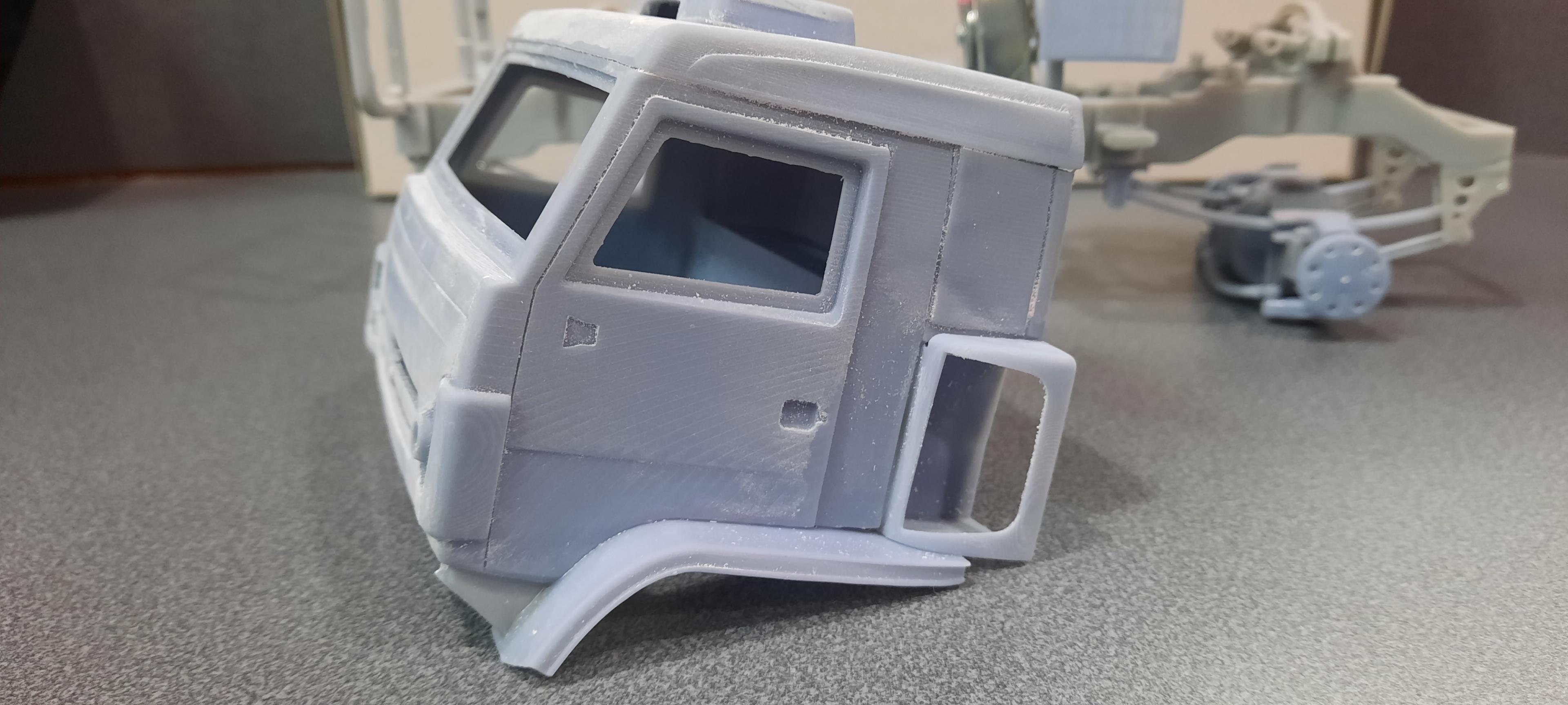

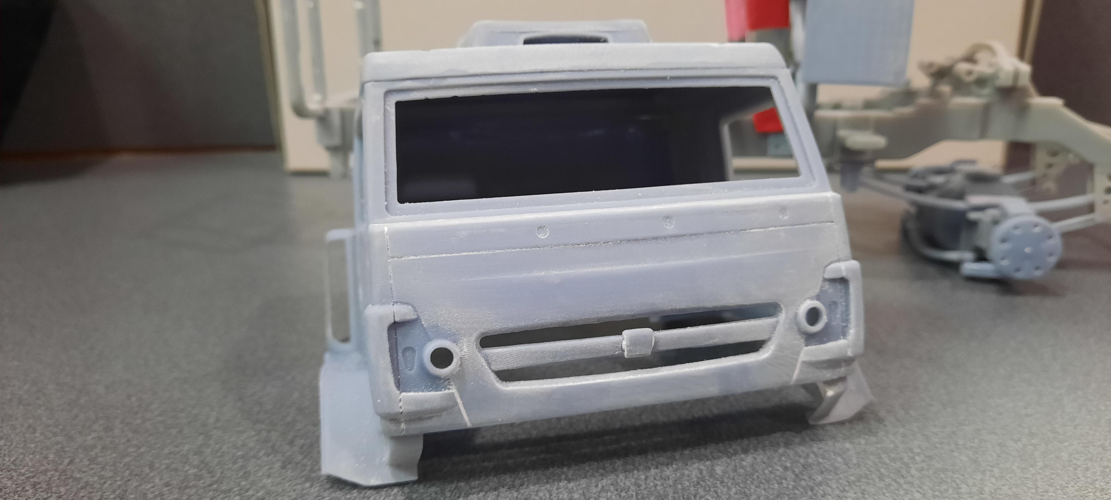

First up the Cab.
Some of the parts that attach to the cab, including window frames and airbox vents.

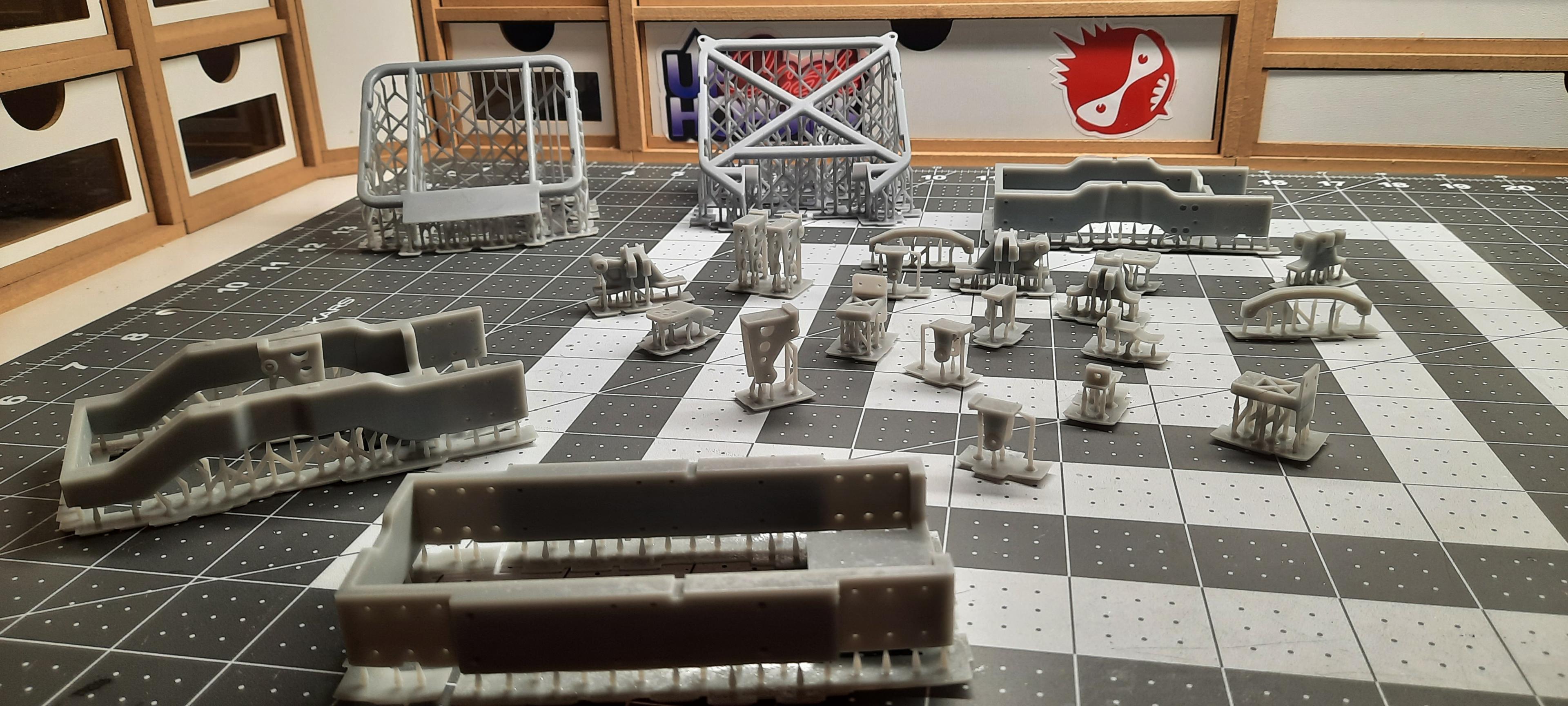

This is one of the six files for the frame itself. I am currently printing the frame sections and will be building this mostly from the ground up.

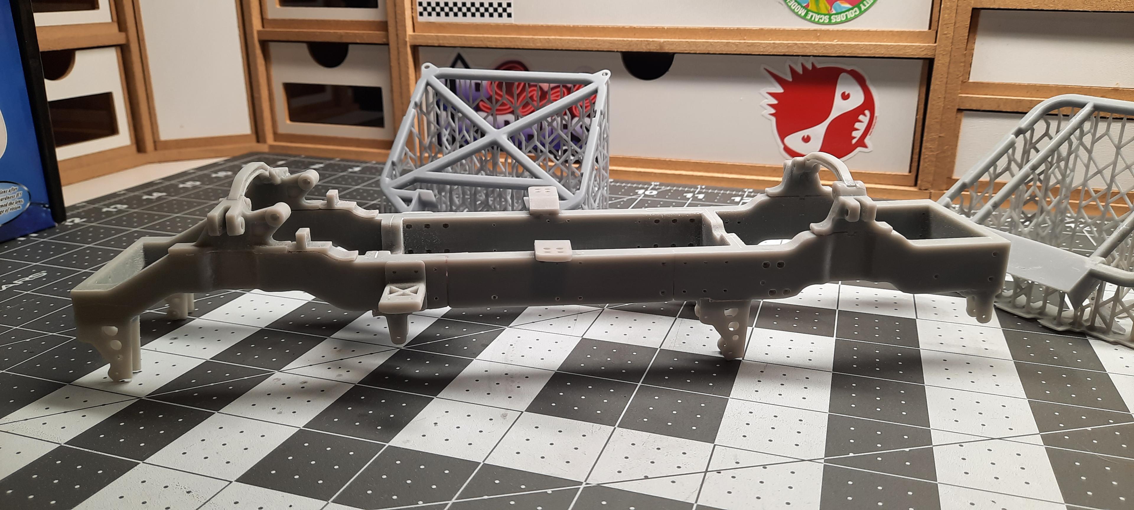

Frame update.
 All six files have been printed and are ready for clean up.
And here's the frame assembled, minus the two large brackets in the back of the pic. These are the supports for the rear body work. I'm going to leave them connected to the supports till I'm ready to glue them to the frame to avoid any chance of warpage.
The holes in the frame are where the machine screws go to hold the 1/12th scale RC kit together. I will print off some bolt heads to add in some detail before I paint.

Dan, it took about 1.5hrs for each of the frame sections, they weren't very tall on the build plate. The rear supports for the body took around 3.5hrs each cause of their height and all the brackets were around another hour. The files for the front and rear axles were another 2hrs each and the extras that go with them were just under an hour. So far I've pretty much been printing since I Friday around noon, tho I did miss a few hours while sleeping. The big files, the body panels will be started on shortly, I'm guess I'll be printing on and off till around Wednesday.

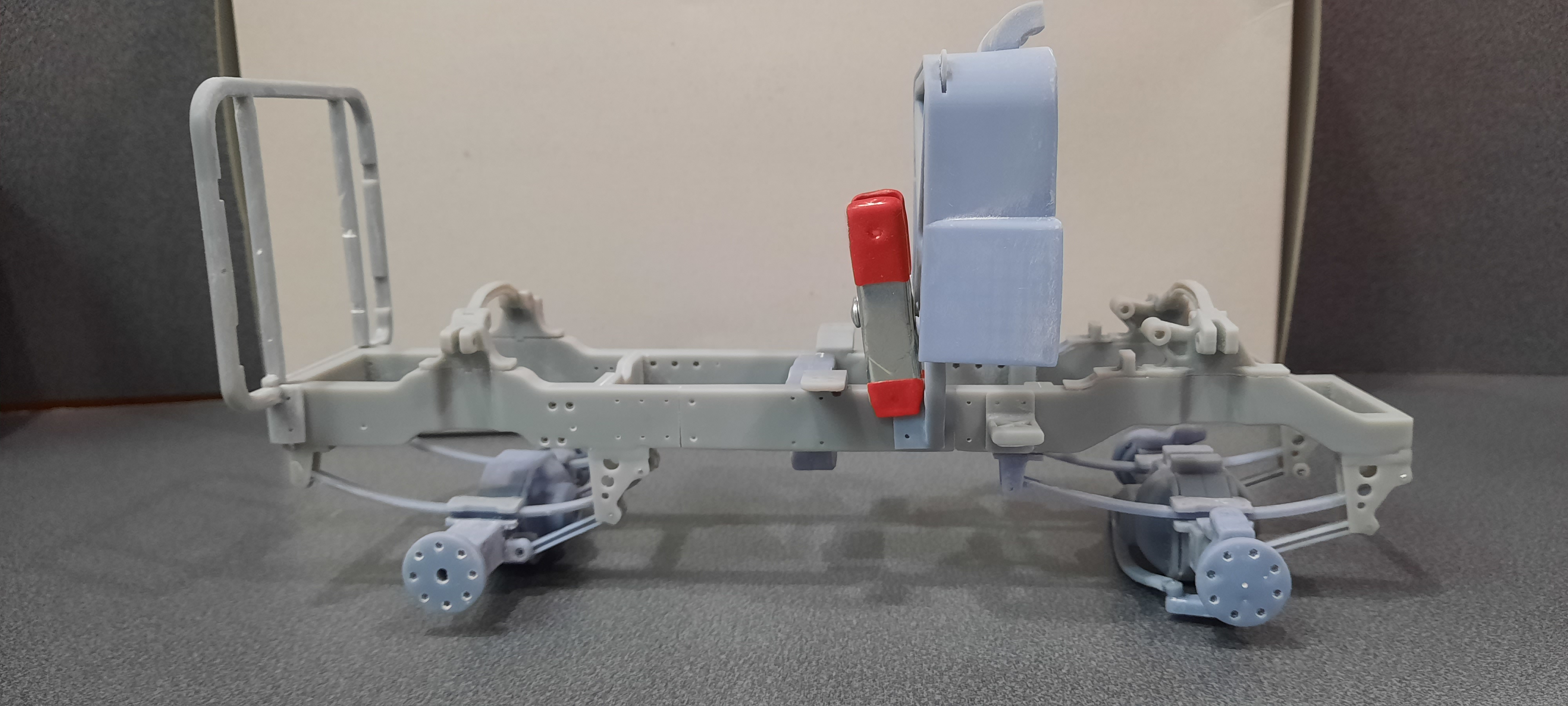

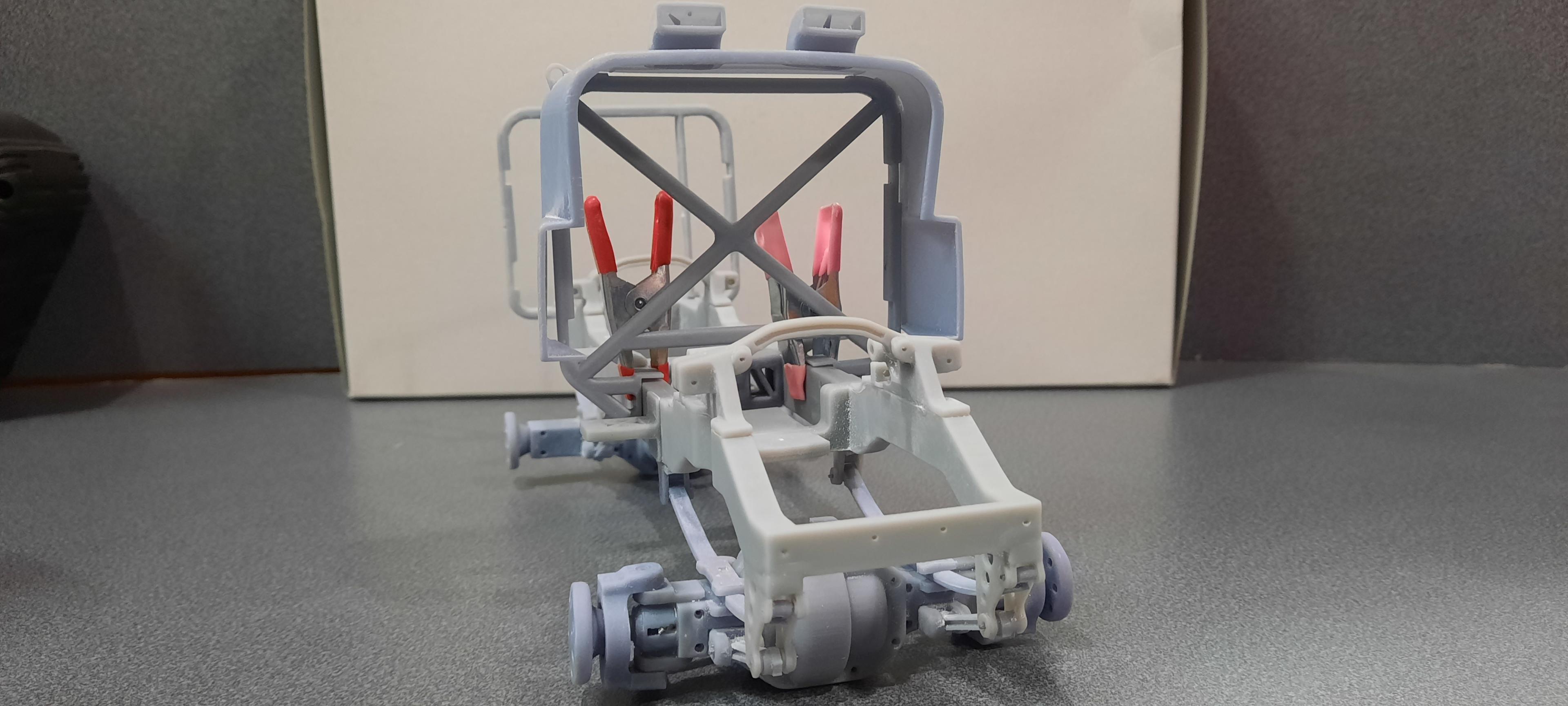

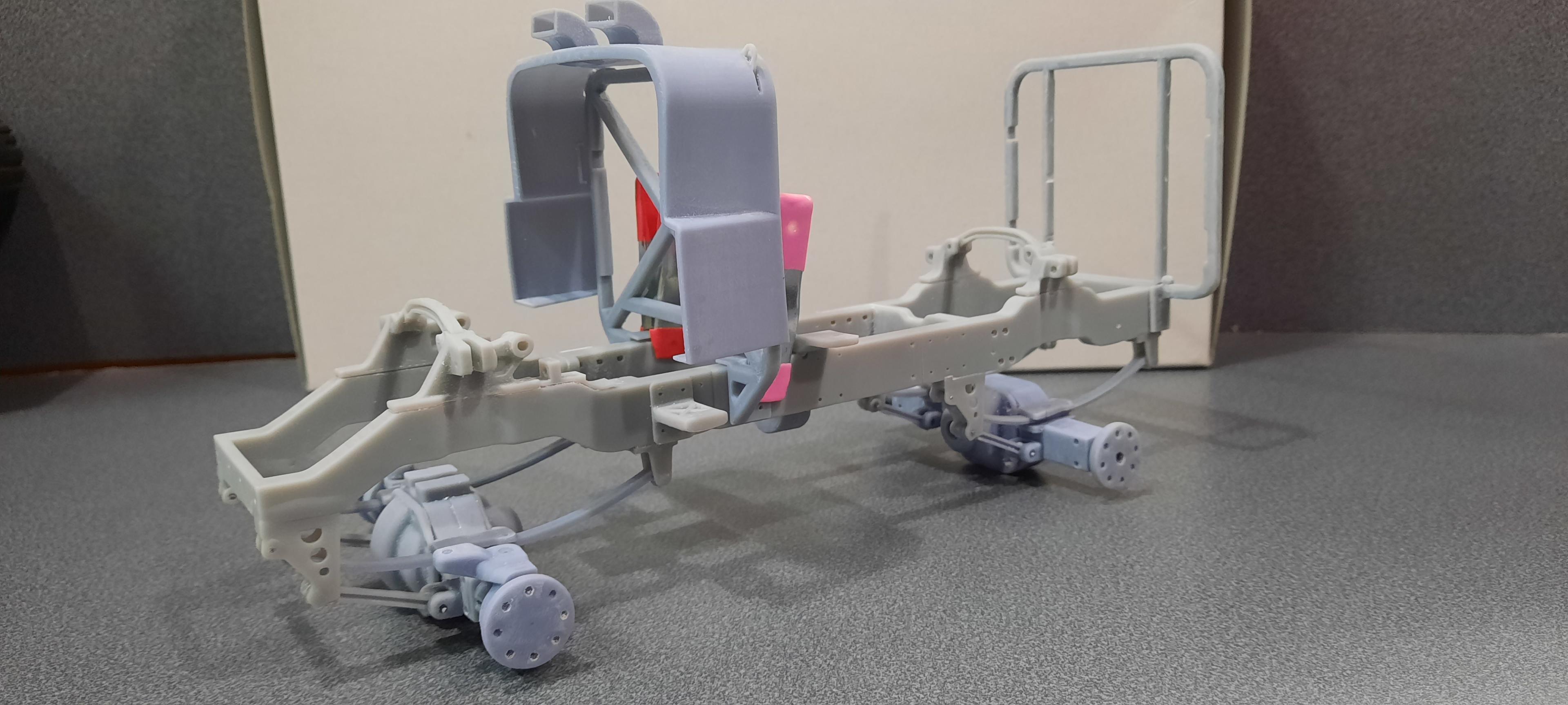

Update.
Chassis is almost complete. I still need to figure out what to do for the shocks, the model is designed for RC shocks but I'm going to have to scratch something or try to find some I can print.
The upright frame work, which holds up the rear cargo sections of the truck are not yet attached. I was not happy with the roof panels so I'm reprinting them. One of the issues with scaling down the files is that some of the parts become too thin and just don't print as well as you'd like, so I've reprinted more than a few parts. 20210723_041557.thumb.jpg.cfcd934ea4cc50238aae8221dfe658d9.jpg
Also the differential casing are over sized, again due to the fact that the original design was for an RC chassis. They won't be perfect looking but I can live with it.
At this time I have not printed out the engine file I have, I wanted to get the chassis complete so I can figure out how big I need the engine and transmission to be to fill up the space inside the chassis as the file I have does not have a listed scale to it, so it will be trial and error. I'm hoping to print the file off this weekend and see where I'm at for sizing. After that I have some more detail parts for the rear cargo area I want to print off as well, some fuel tanks and some air tanks that are on the rear truck. I also need to print off some wheel and tires well.  I plan on printing off not only the 4 driveline wheels but 2 spares for the cargo area as well.
For the cabin (cockpit) I have the main panels completed as well as the exterior details. I still have to print floor as well as figure out an interior. More files to print off over the weekend.
Some of the print layer lines are still visible but sand away easily. I plan on getting some primer on some of the parts by the end of the weekend.
