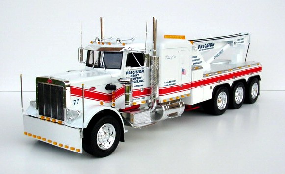

20210719_210623.pngthis view shows what I'm trying to accomplish.
