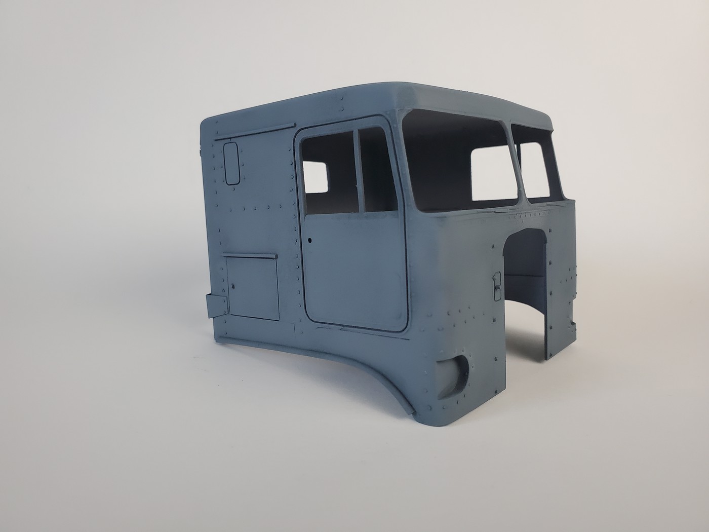

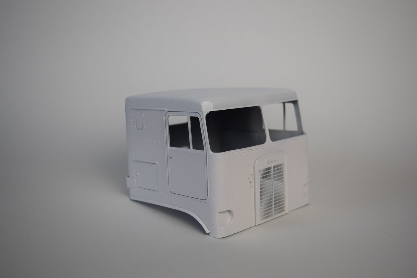

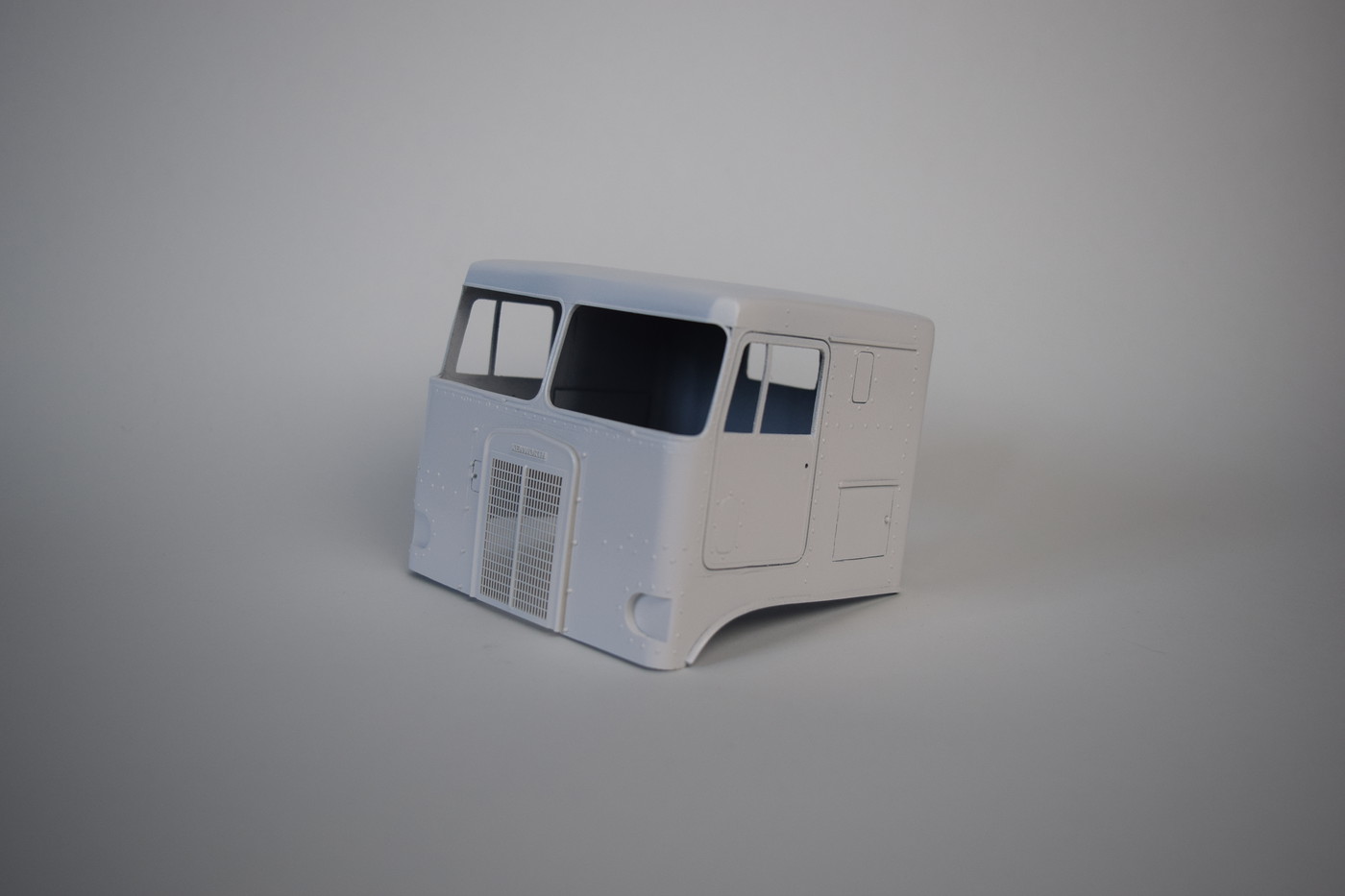

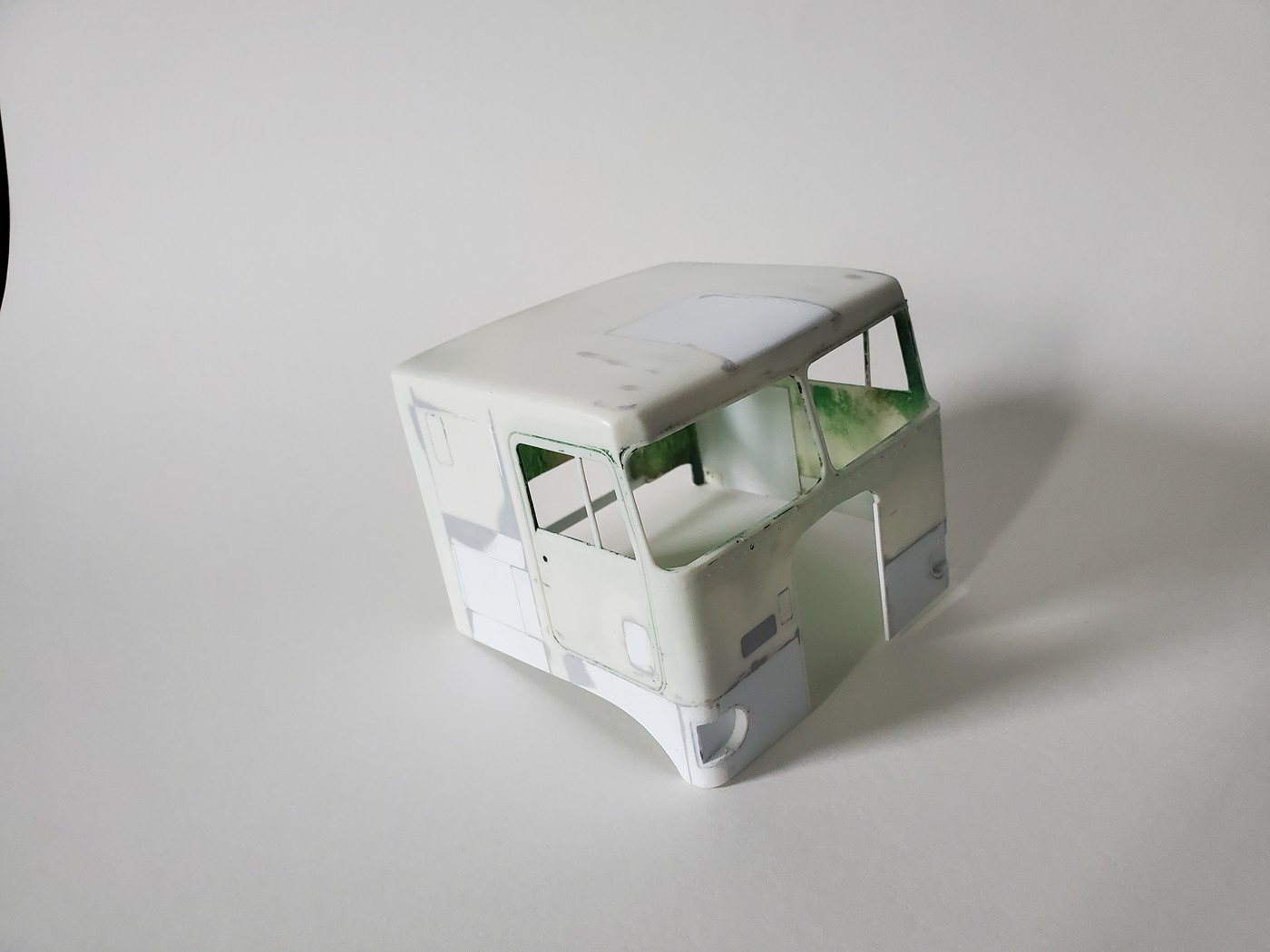

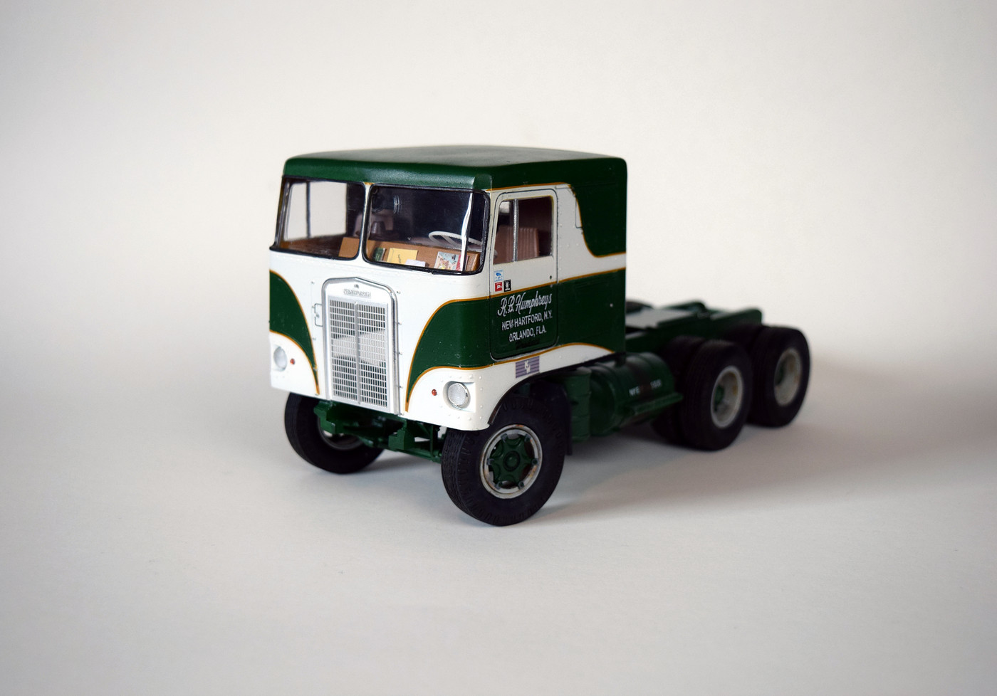

KJ790 Posted July 28, 2021 Posted July 28, 2021 I thought that I would post my work so far on truck that I have wanted to build for a long time, a first generation 1964 Kenworth K100. I am using an AMT K123 kit and backdating as much as I can. The cab was an old glue-bomb that was damaged. I stripped the old paint and started working away at it. I made new luggage doors on the side of the cab, filled the "peep" window in the passenger's side door, shaved off the protrusions on the roof, moved the passenger's side vent door towards the back of the cab, added a rear window opening, and made new lower front quarter panels and headlight housings. The rivets were made using a punch and die set with .010" thick styrene sheet. First coat of primer:

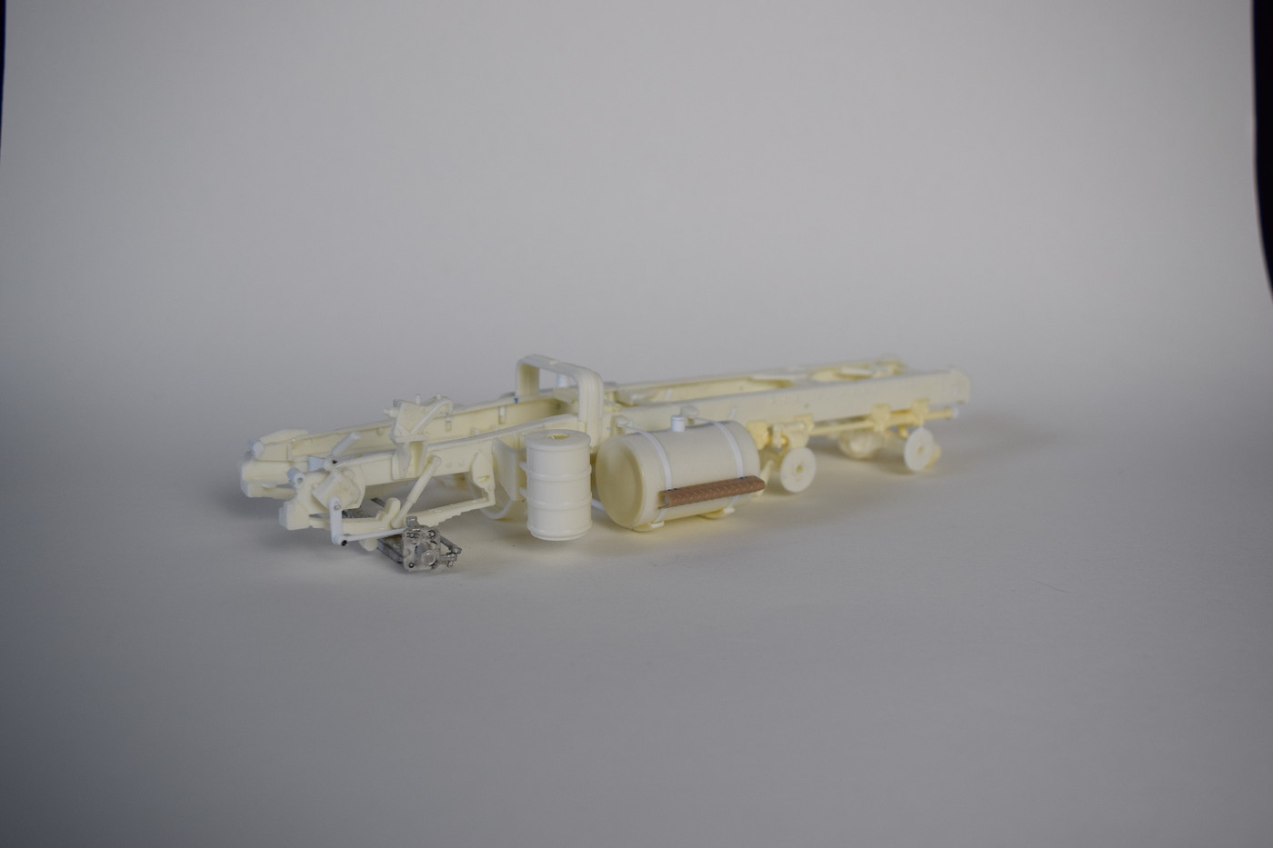

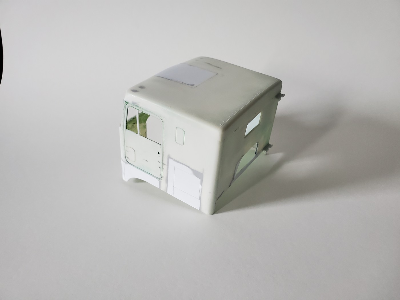

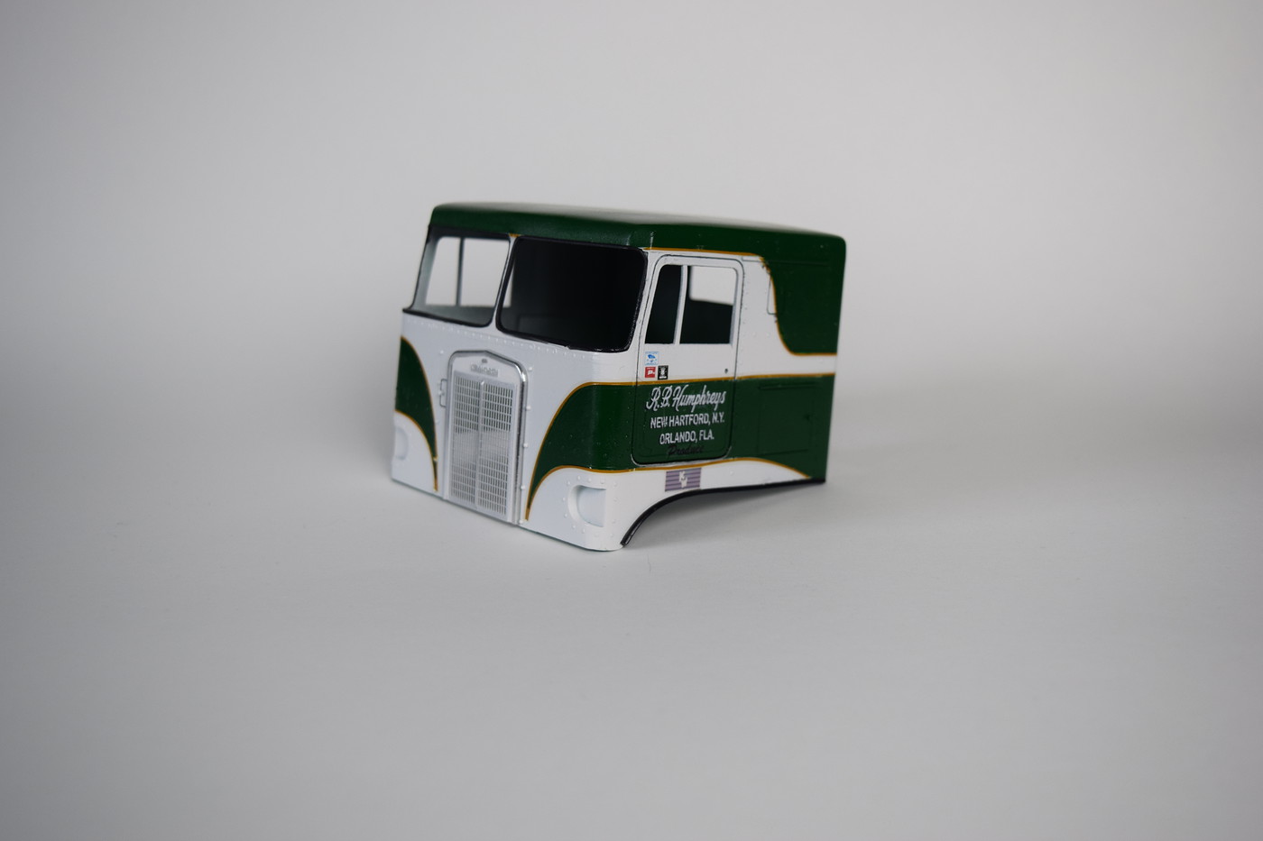

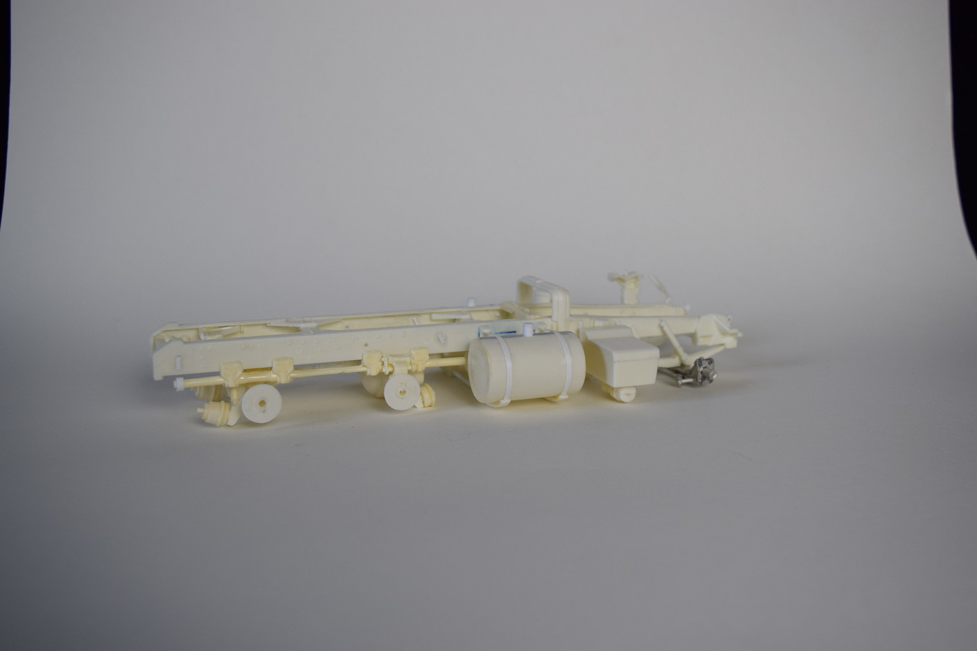

KJ790 Posted July 28, 2021 Author Posted July 28, 2021 I drew up a back-dated grille in 3D cad and had it 3D printed. Then sprayed the first coat of white paint on everything: I also started on the chassis. This was a frame from the parts-box. Up until 1969, the K100 used tapered frame rails to make room for the popular V8 configuration engines of the era. I modified the kit rails to represent this. I also shortened the frame slightly. I cut the kit fuel tanks down shorter and shifted them forward on the frame slightly. I made a step for the driver's side tank out of diamond plate styrene sheet. I added a resin torsion bar suspension and steerable front axle with the front brakes cut off. The battery box was lowered on the frame rails to reflect the 1:1 I am using as a reference.

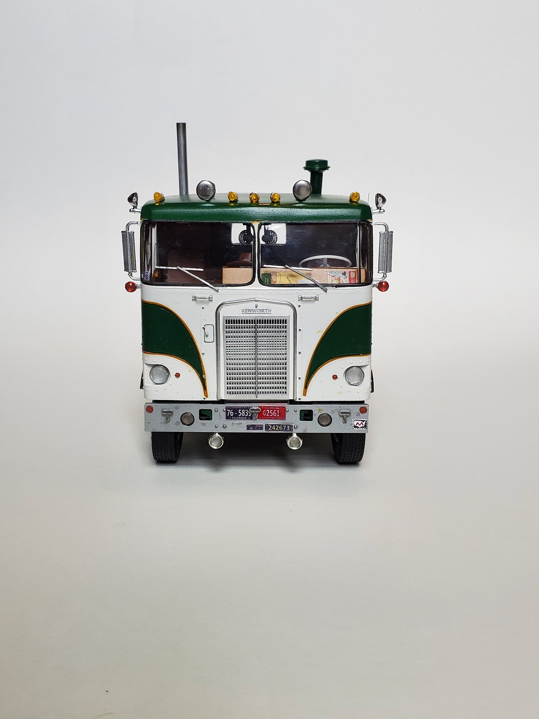

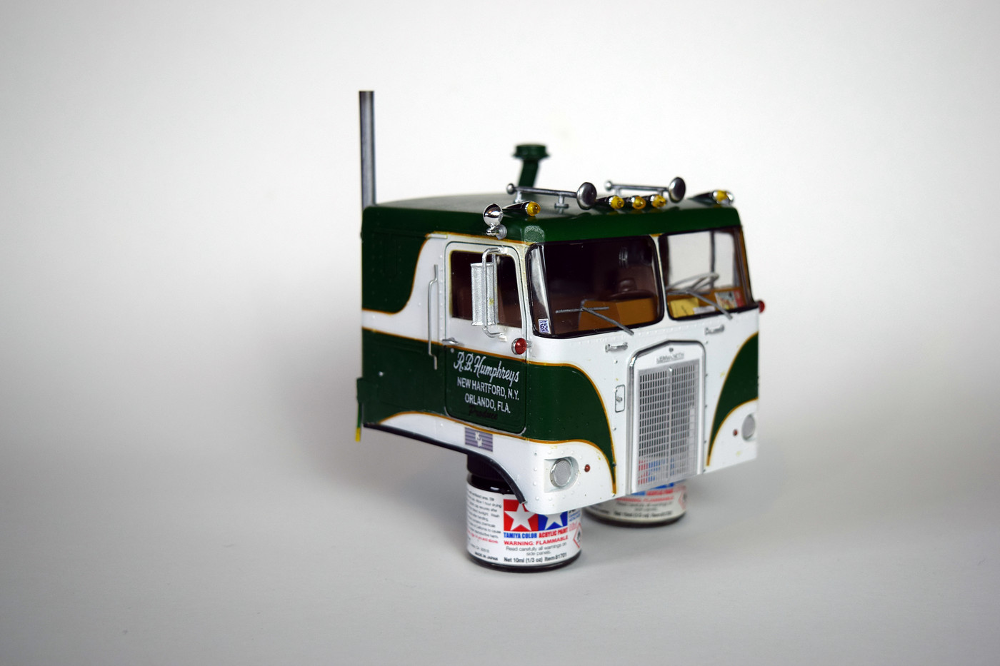

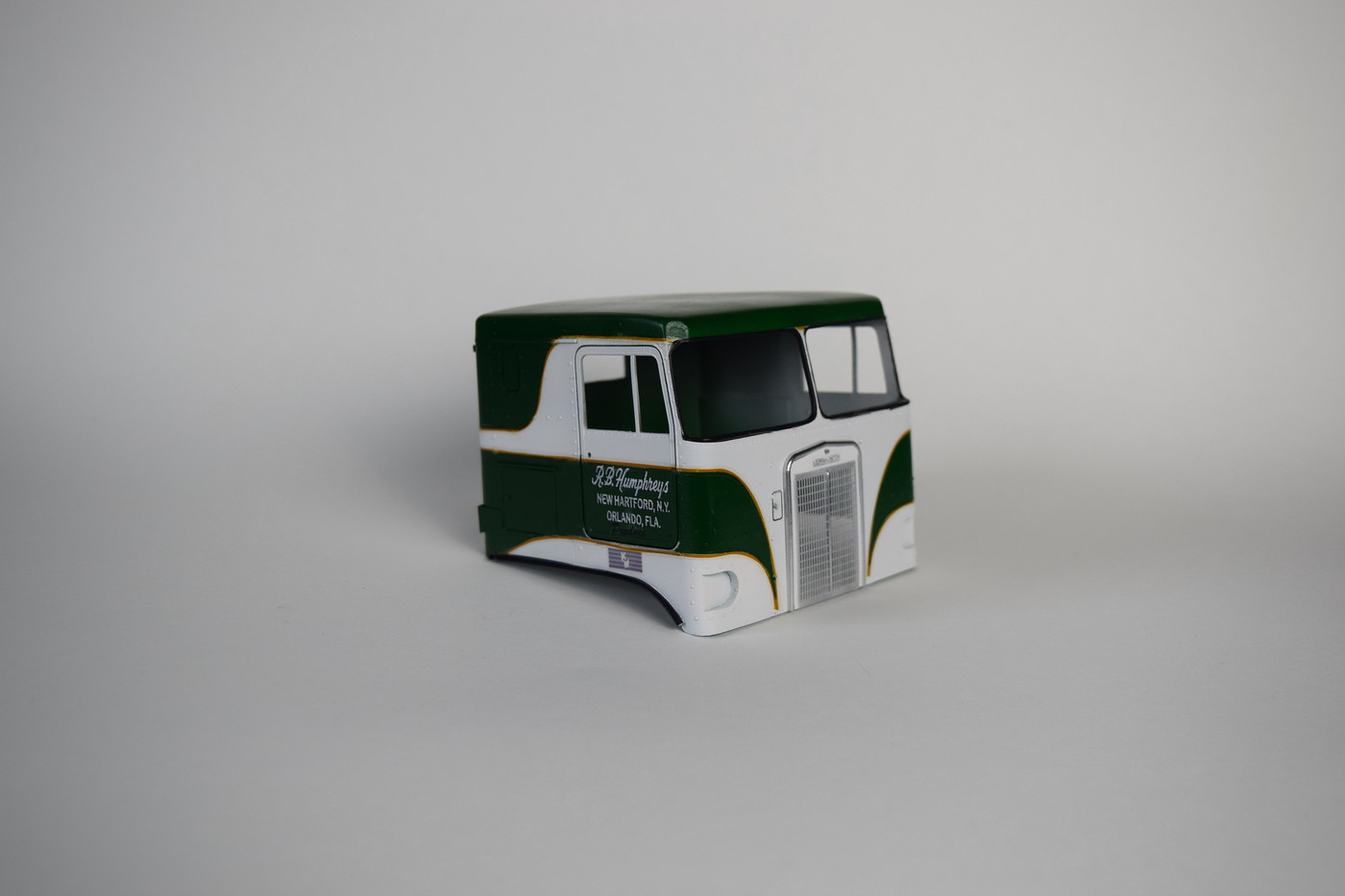

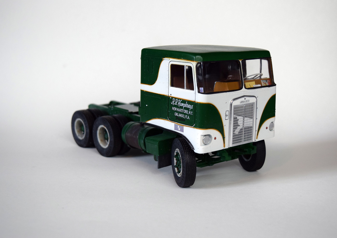

KJ790 Posted July 28, 2021 Author Posted July 28, 2021 I was not happy with the first paint job that I did, so into the strip it went. The second attempt came out better, but still not perfect. Luckily this truck is going to have some weathering to help hide some of the flaws. Decals from Firebird designs were applied. The permit decals are from CMT. 1

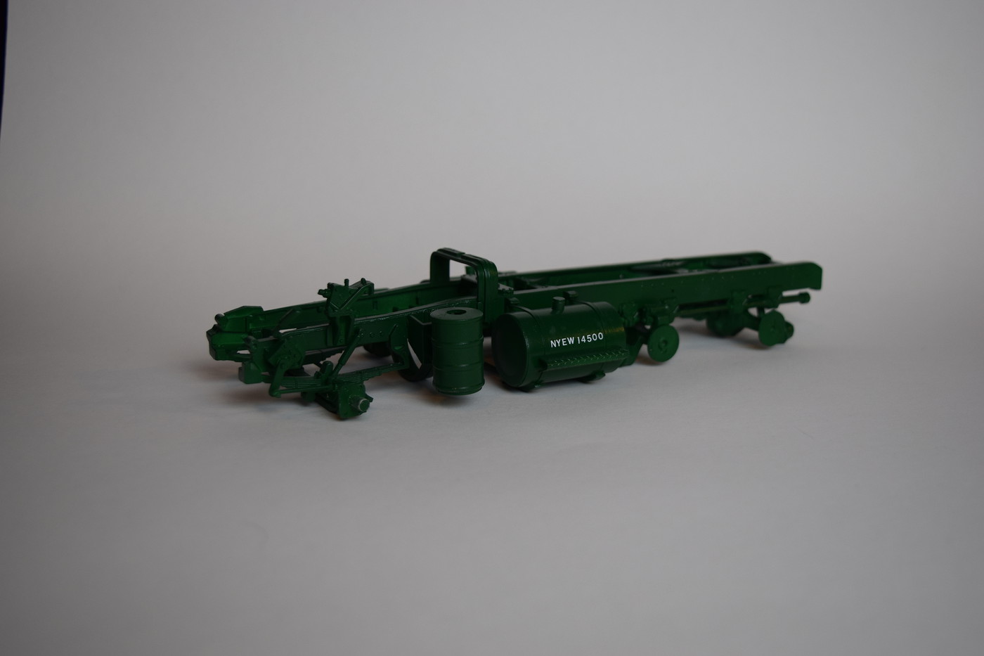

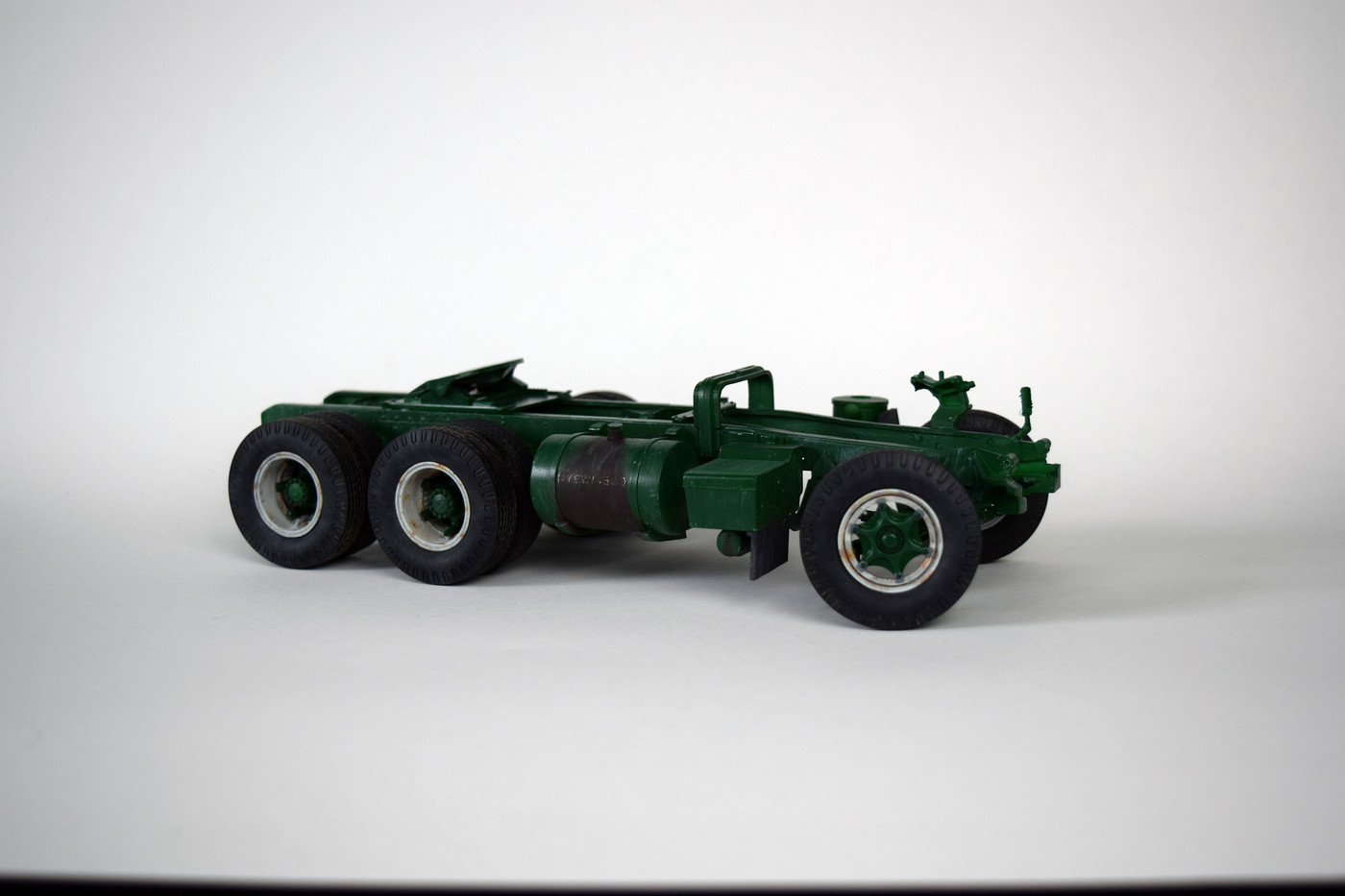

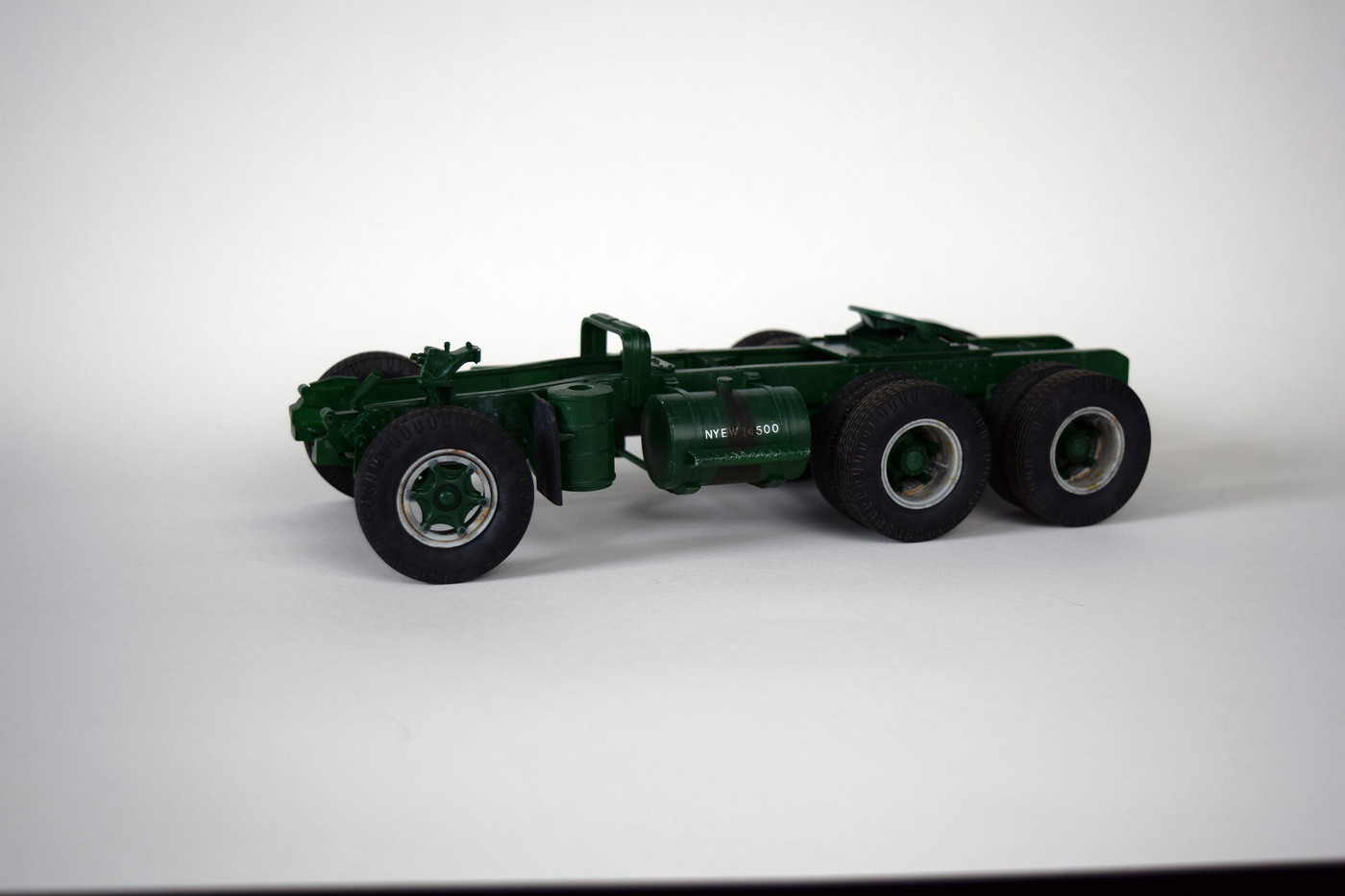

KJ790 Posted July 28, 2021 Author Posted July 28, 2021 The chassis was painted. I used individual letter decals from microscale on the fuel tanks, what a task those were to line up. Not perfect, but it will have to do. I drew the spoke hubs in CAD and had them 3D printed. The rims were a set of resin cast rims that I had made a while back. The 1:1 truck I am using as inspiration did not have very aggressive tires, so I am using a set of tires from the AMT Papa Truck kit. I sanded off the "Tyrone Malone" logos with fine sandpaper. Weathering of the chassis has begun.

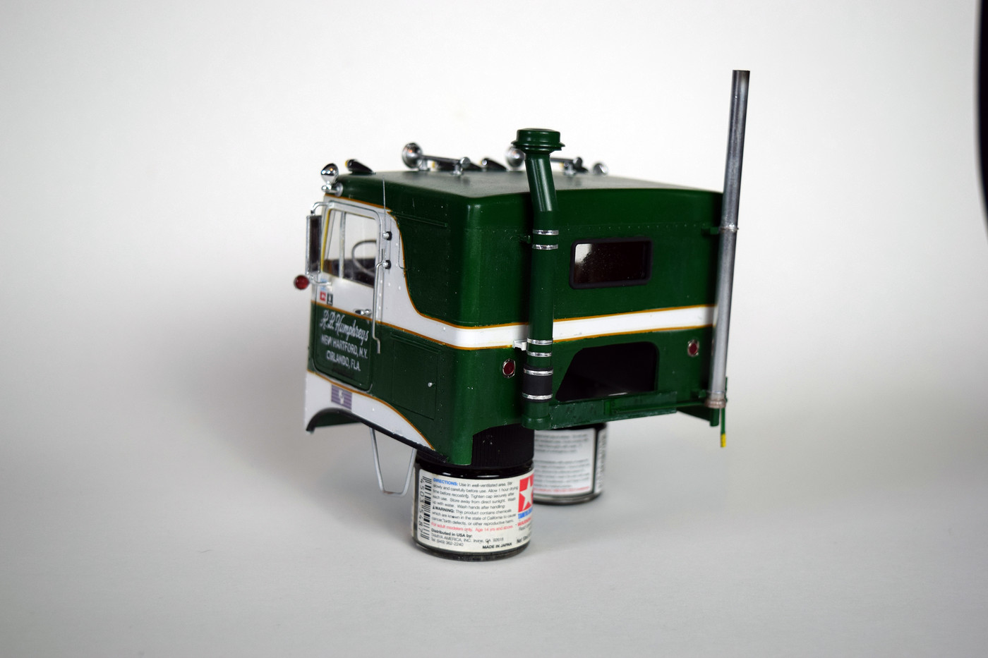

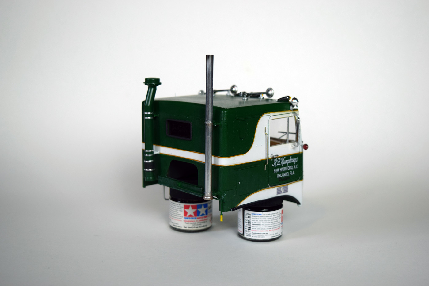

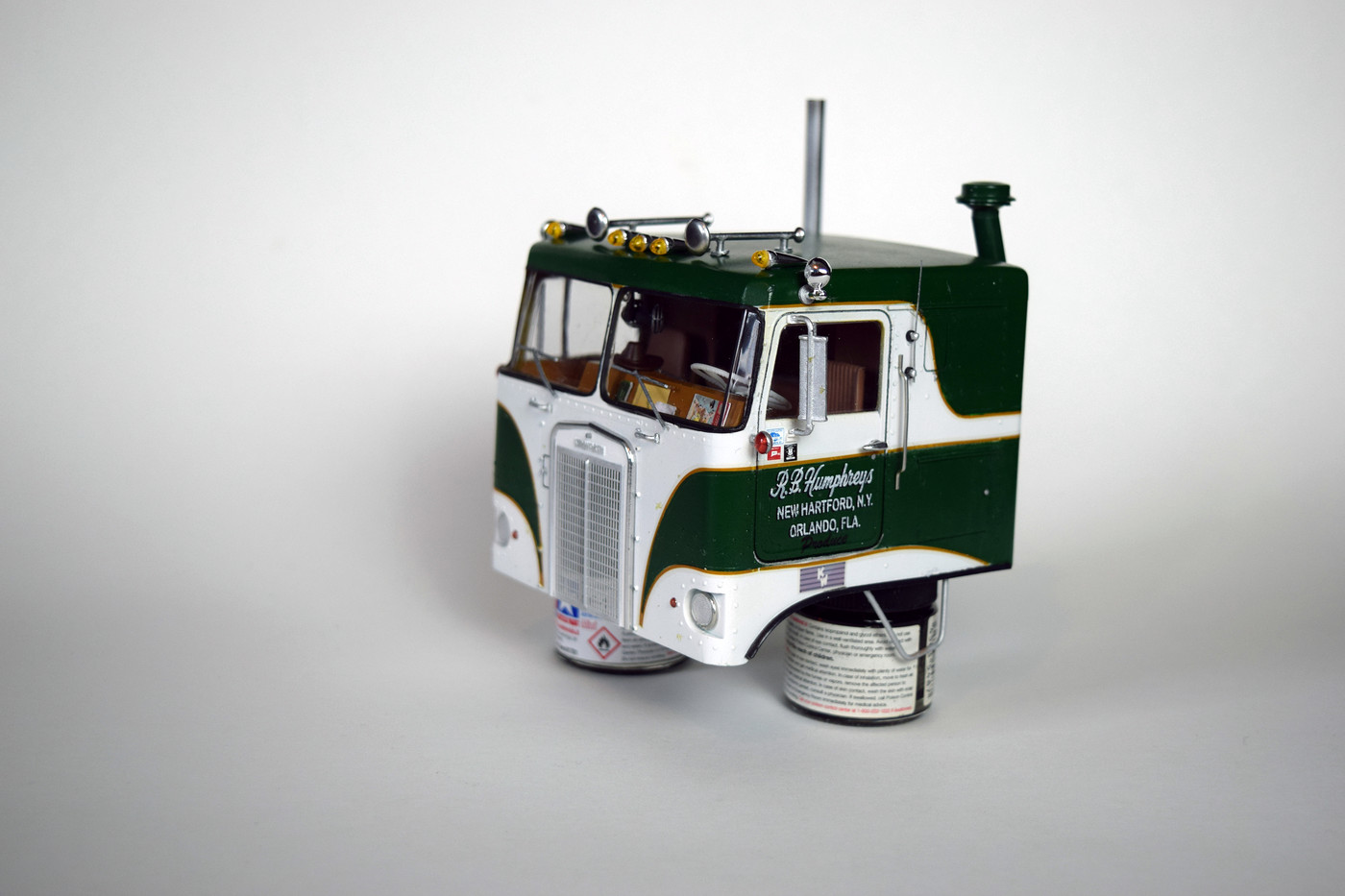

KJ790 Posted August 10, 2021 Author Posted August 10, 2021 Finally finished all of the little details of the cab. I added some slight weathering and attempted a couple splattered bugs on the front. Next onto the engine.

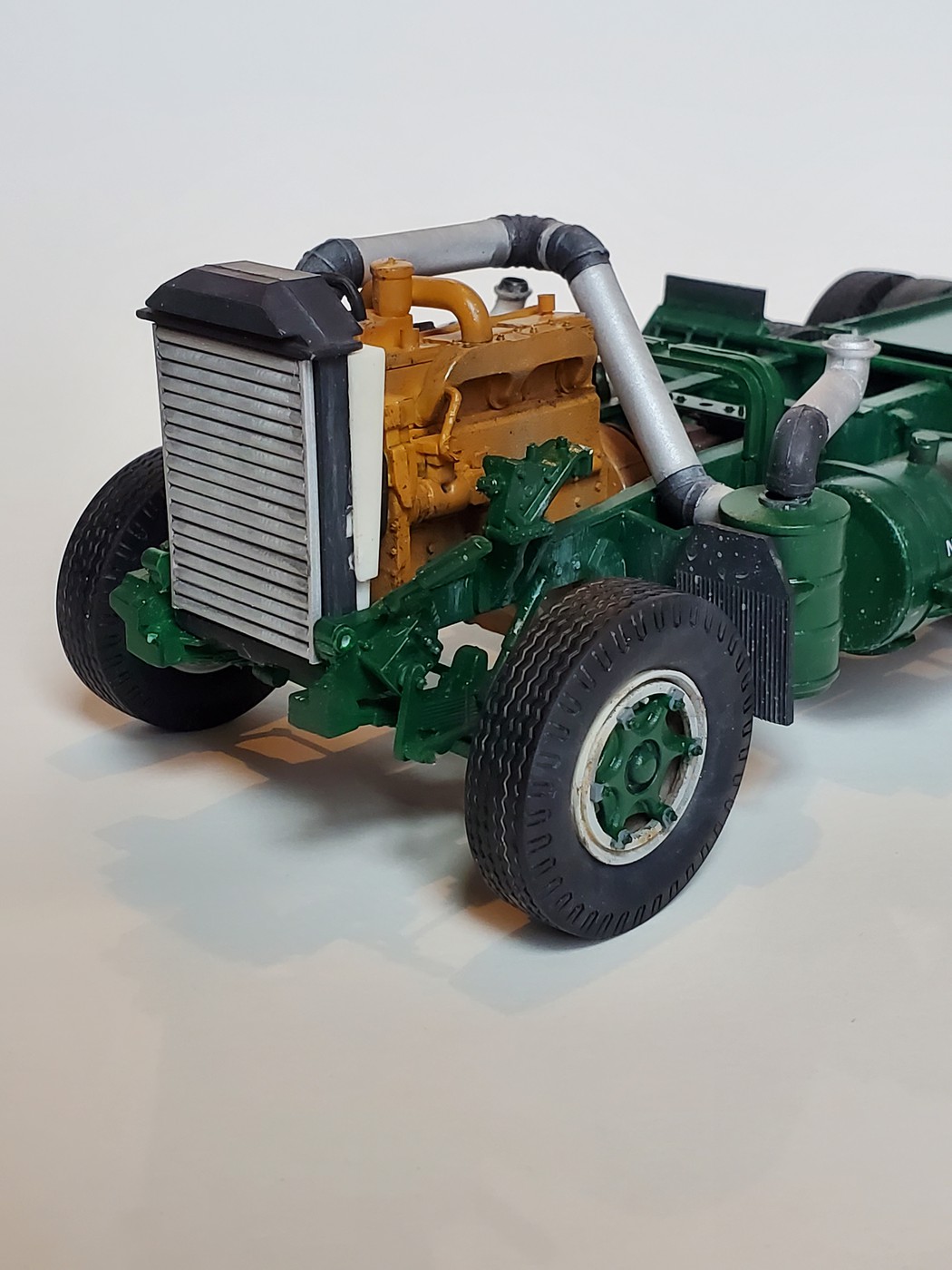

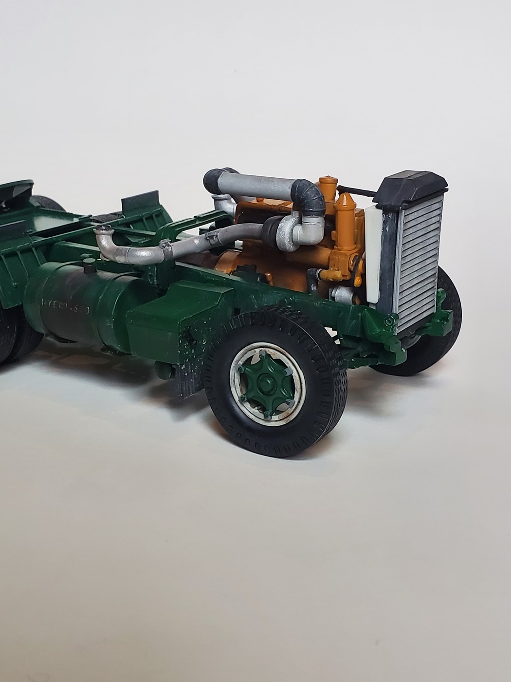

KJ790 Posted August 16, 2021 Author Posted August 16, 2021 Engines have always been a weak point for me, but fortunately you can't typically see them on the finished model. Since the radiator will be slightly visible through the grille, I made a set of louvers from .080" half-round rod. The engine is an attempt to make an early 60's 335 Cummins from the kit NTC. I added a 4x4 married transmission out of a Diamond Reo kit, as that is what the real truck had. Getting the "bells" on the exhaust and intake connection to line up with the plumbing mounted to the back of the cab was quite a task.

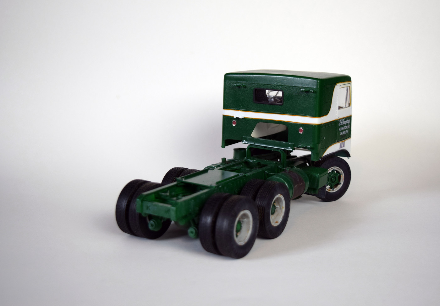

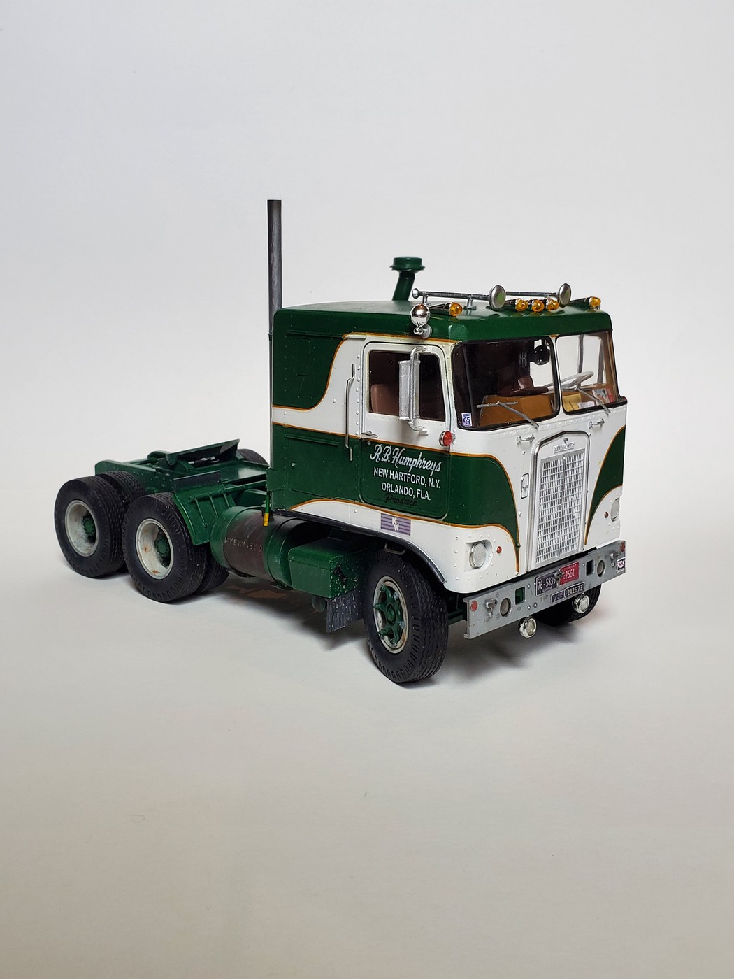

KJ790 Posted August 16, 2021 Author Posted August 16, 2021 Cab is fitted to the chassis. Just a few more details to finish up.
