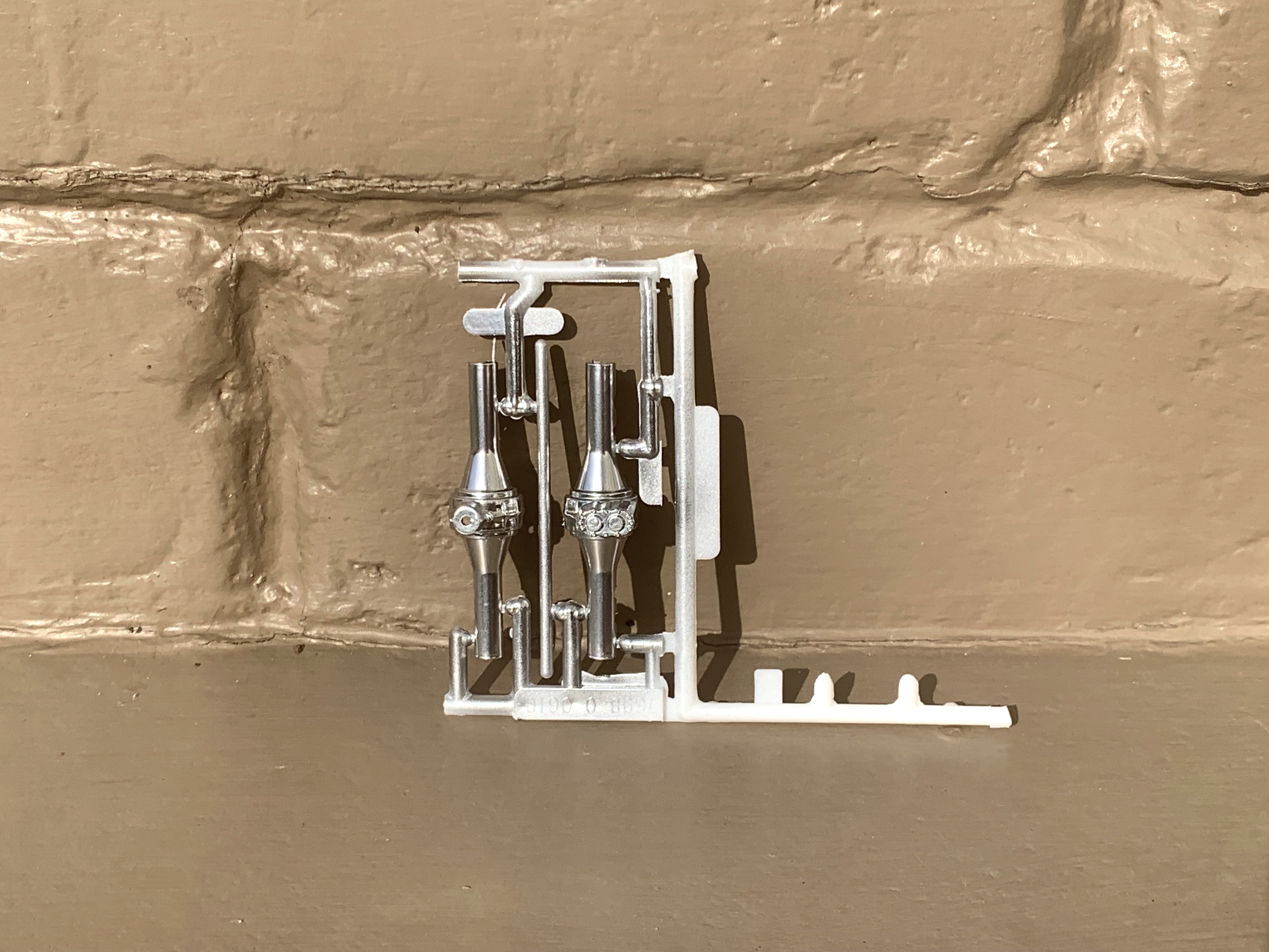

Roncla Posted August 1, 2021 Posted August 1, 2021 I had been reading positive things about e7paints chrome sealer lately so I went ahead and purchased a couple of bottles off Ebay. They have now arrived and today I sprayed some over Molotow I had sprayed a week ago without doing any surface preparation of any kind. The manufacturer describes it as a synthetic resin coating and its the only clear coat I have sprayed to date that doesn't effect the shine of Molotow in a perceptible way. The part on the right has a coating of this chrome sealer while the left side is just plain Molotow. I just sprayed one wet coat and I've found I can now handle my Molotow painted parts as much as I like without seeing any of the usual loss of shine that can occur.

Venom Posted August 5, 2021 Posted August 5, 2021 On 8/1/2021 at 1:54 AM, Roncla said: I had been reading positive things about e7paints chrome sealer lately so I went ahead and purchased a couple of bottles off Ebay. They have now arrived and today I sprayed some over Molotow I had sprayed a week ago without doing any surface preparation of any kind. The manufacturer describes it as a synthetic resin coating and its the only clear coat I have sprayed to date that doesn't effect the shine of Molotow in a perceptible way. The part on the right has a coating of this chrome sealer while the left side is just plain Molotow. I just sprayed one wet coat and I've found I can now handle my Molotow painted parts as much as I like without seeing any of the usual loss of shine that can occur. Glad to see this thead started! ...I just bought my first Motolow pen yesterday and was very impressed with it. So I went ahead and ordered a 30ml refill bottle off eBay so that I can use it to dip a detail brush in. Just last night I was wondering if you could airbrush this stuff... so now that I know you can I have some questions: 1- Do you just spray the Molotow straight? I assume any form of thinning is bad. 2- What should you use to clean your airbrush after using Molotow? 3- What do you use to clean the airbrush after using the sealer you showed? 4- What is the best way to purchase Molotow for airbrush use? Is there something better than the refill bottles like shown in the pic below?

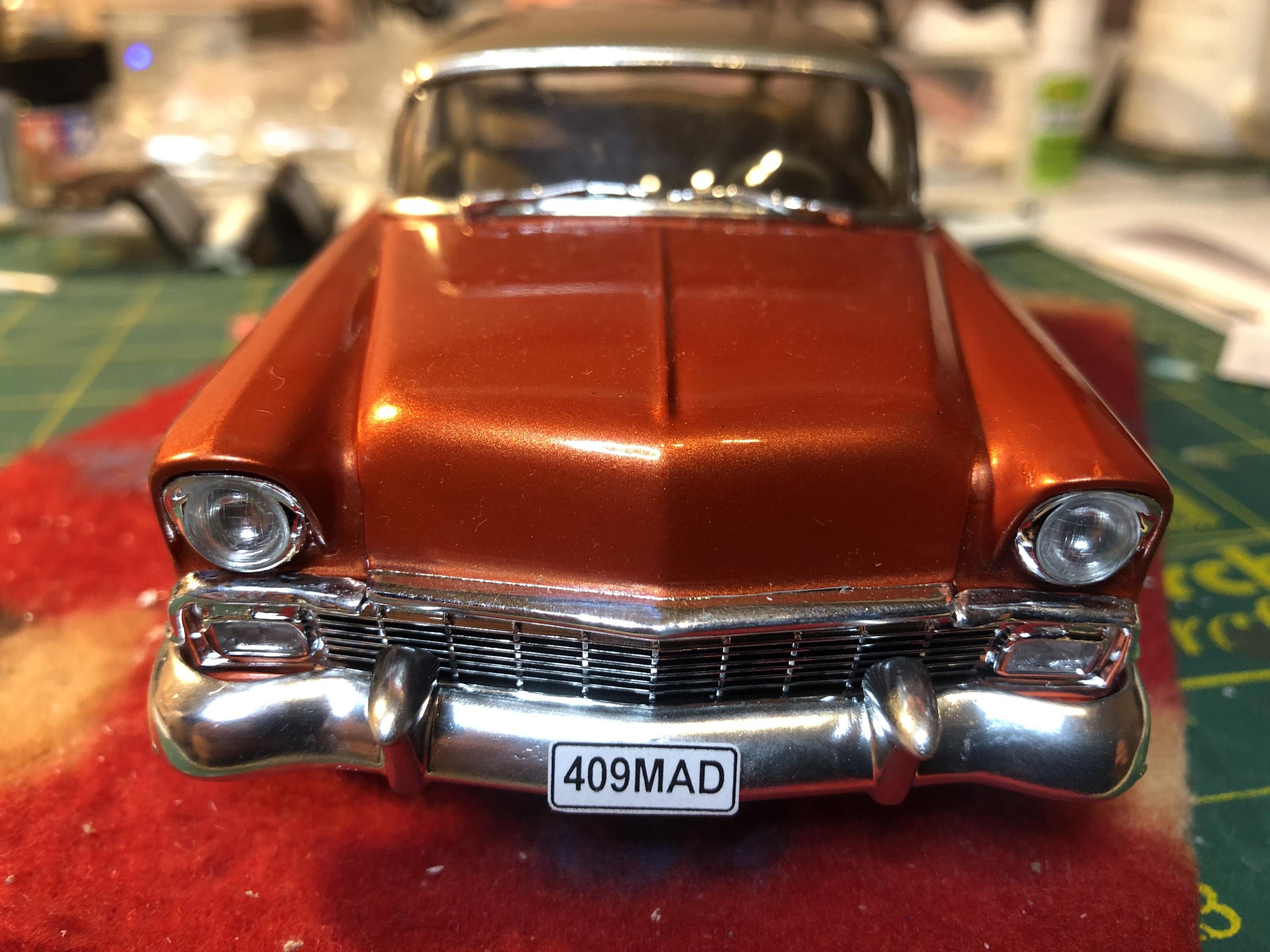

bill-e-boy Posted August 6, 2021 Posted August 6, 2021 1- Do you just spray the Molotow straight? I assume any form of thinning is bad. Yup - straight through the air brush with no thinners 2- What should you use to clean your airbrush after using Molotow? I use roller and brush cleaner which may not be available in the US - lacquer thinners works OK too 3- What do you use to clean the airbrush after using the sealer you showed? I haven't used clear coat yet so cannot answer. But take heed of above advise - let it dry for at least a week before handling 4- What is the best way to purchase Molotow for airbrush use? Is there something better than the refill bottles like shown in the pic below? Get the 30ml refill bottle and it pour straight into you paint cup Spray at lower pressures too - 15-20psi The 56 Nomad front bumper shown below was sprayed with Molotow after I tucked it into the body And yup it has a 409 in it, lol

Venom Posted August 7, 2021 Posted August 7, 2021 11 hours ago, bill-e-boy said: .....The 56 Nomad front bumper shown below was sprayed with Molotow after I tucked it into the body 4 hours ago, Roncla said: X2 on everything Bill has said. I just used lacquer thinner to clean my airbrush after using the sealer. The sealer is ready to use from the bottle and requires no thinning just like the Molotow. Both the Molotow and the e7 sealer need to be sprayed wet. Provided you give the Molotow at least a week to dry you can get away without the sealer provided you carefully handle the painted parts with dry clean fingers but it does give a longer term protection. Thanks guys, I really appreciate your input ... and that Nomad bumper looks excellent!
