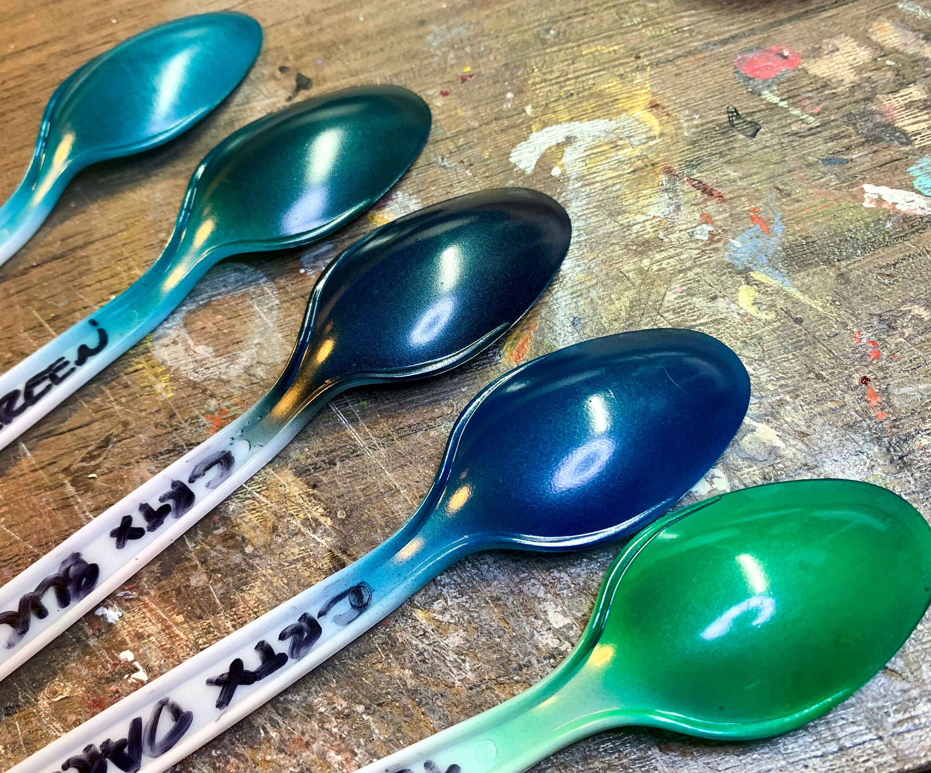

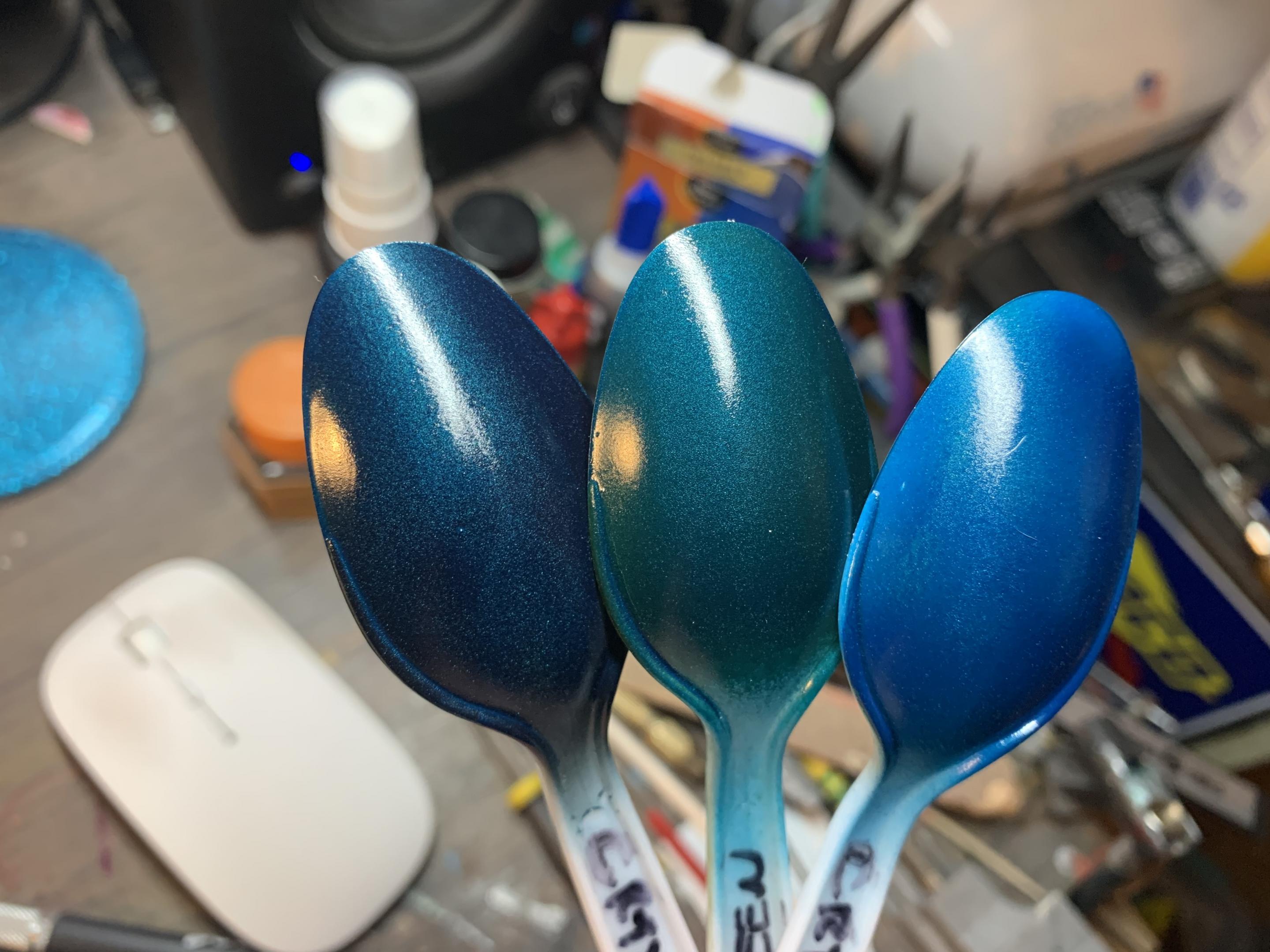

So, using some spoons and a variety of base colors I’ve been messing with spoons the last couple of evenings.
From top to bottom we’ve got Testor’s Chezoom Teal over light gray, olive green, black, dark blue and light green.  Obviously the grey primer and light green are out, which leaves these three possible contenders:
Seen here under a bright LED lamp, I think of these three the left spoon is probably closest - which is the version with the black base.  In regular daylight the blue base (right spoon) looks the closest…but then under a light it’s WAY too blue.  Next test I think will be shooting some blue pearl over these (particularly the teal-over-black) to see if that lightens it up a touch and gives it the same flip-flop quality that the real car has where it can be REALLY dark green, or almost a man electric kingfisher blue.
Soon as I figure this part out I can actually start painting some of the big parts and detail and assemble some stuff!
More soon (and comments and ideas welcome on that color…) - thanks for looking!

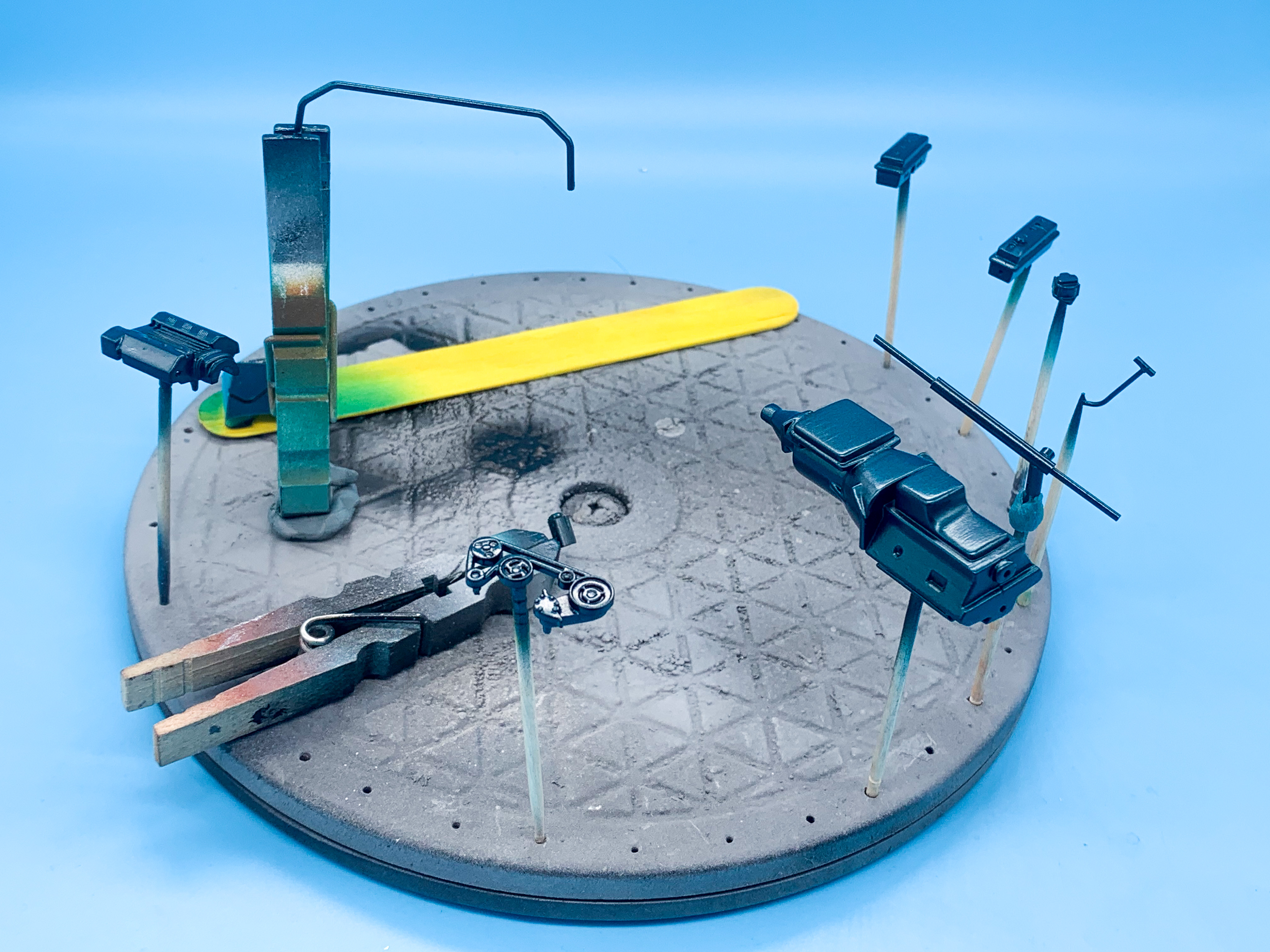

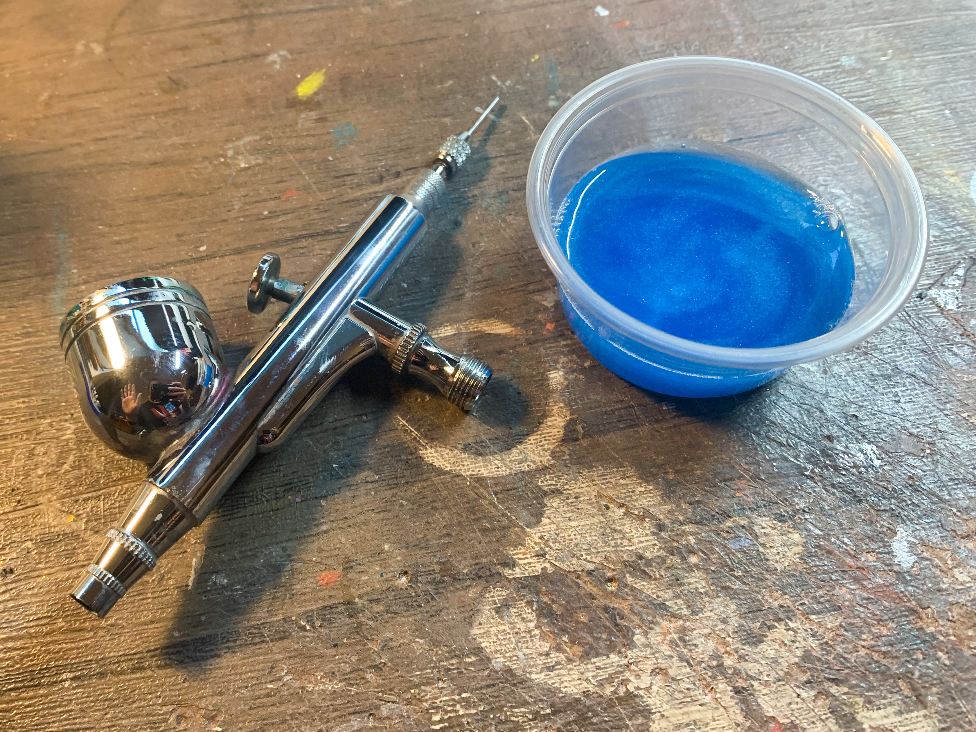

That said, my paint experiments continued today and I think I got it figured out.  Mixed up some Future with bright blue Pearl Ex powder and tested that over the black/teal basecoat combo that I decided was ALMOST right and got REALLY close to what I think the real color should be.
The clear/Pearl Ex mix, ready for a light coat or two:
A bunch of suspension and engine parts, ready for clear:
And the results after pearl blue and then a gloss coat:
In daylight the blue pearl seems to flip and flop and give that kingfisher blue color that you see on the real car, but in the low spots and less bright light it dips down to dark emerald green and almost black.  I think we got it!

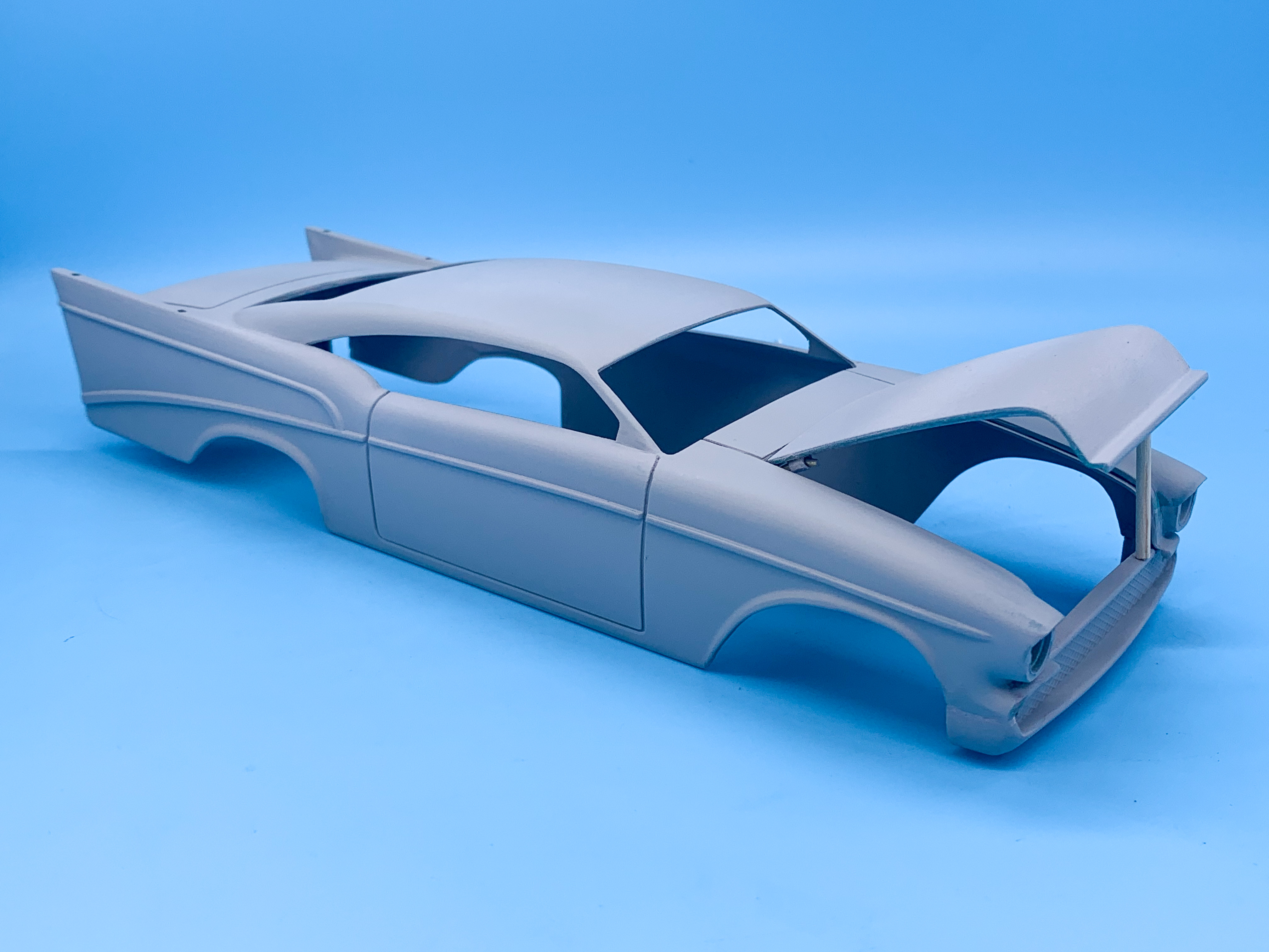

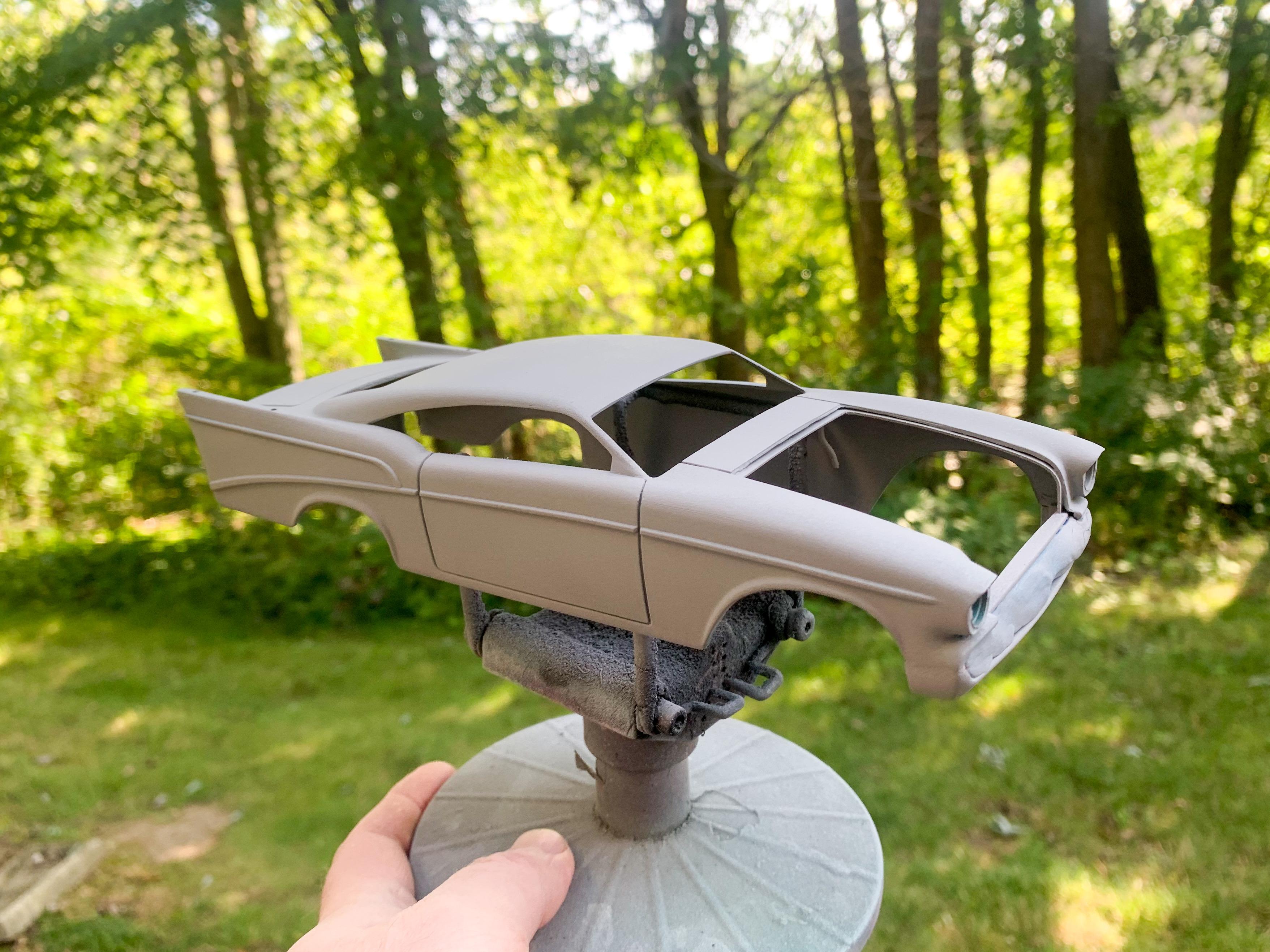

The weather was really nice here today, perfect spraying weather, so I shot some filler primer on the body so that I can see how much more work that’s going to need:

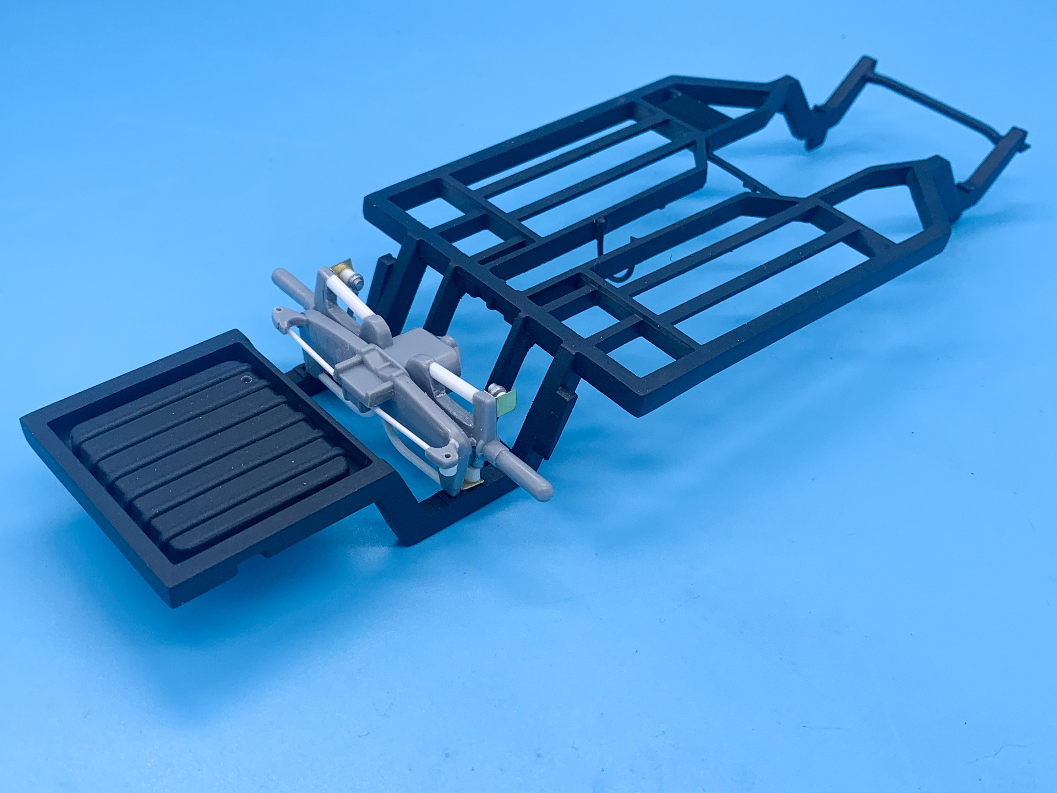

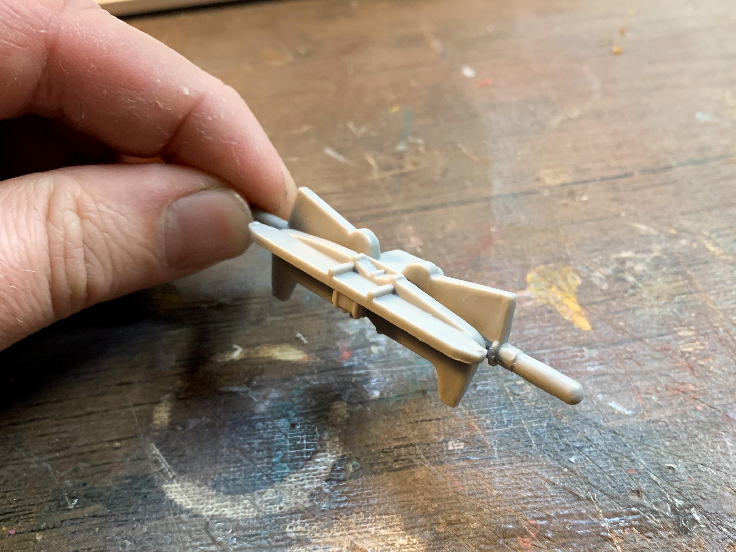

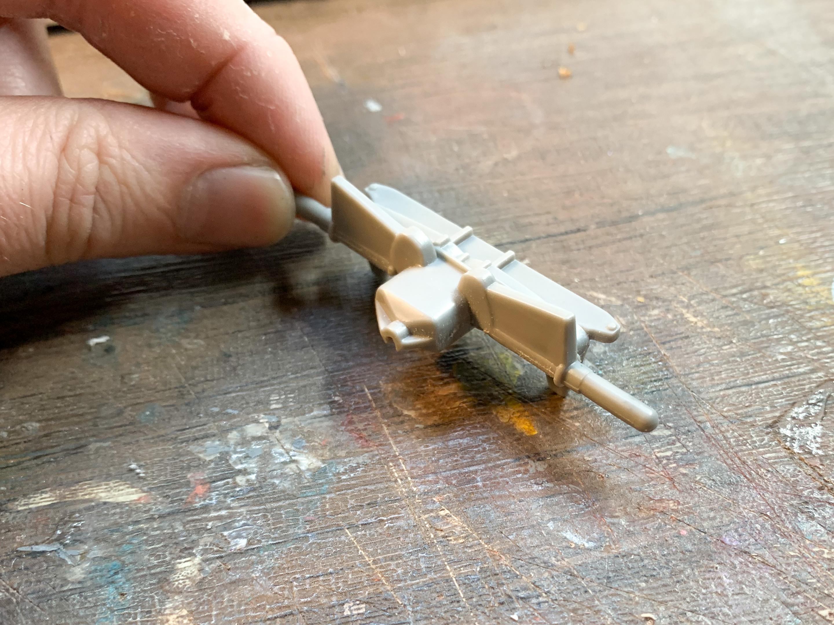

Today’s project was the diff and rear suspension.  I haven’t been able to find a tonne of pictures of the rear end of the real car, but it definitely doesn’t look too much like this:
Kinda blocky and bulky and doesn’t look a bunch like a C4 Vette’s rear suspension (which is what the real Chezoom ran).
So, using the few reference pictures I could find, I did some slicing and dicing and building and got something a lot closer to what the real car ran:
I had to use a little artistic license to make it play nice with the frame and interior tub, but it’ll look a lot better than the blobular assembly that Testors put in the box:

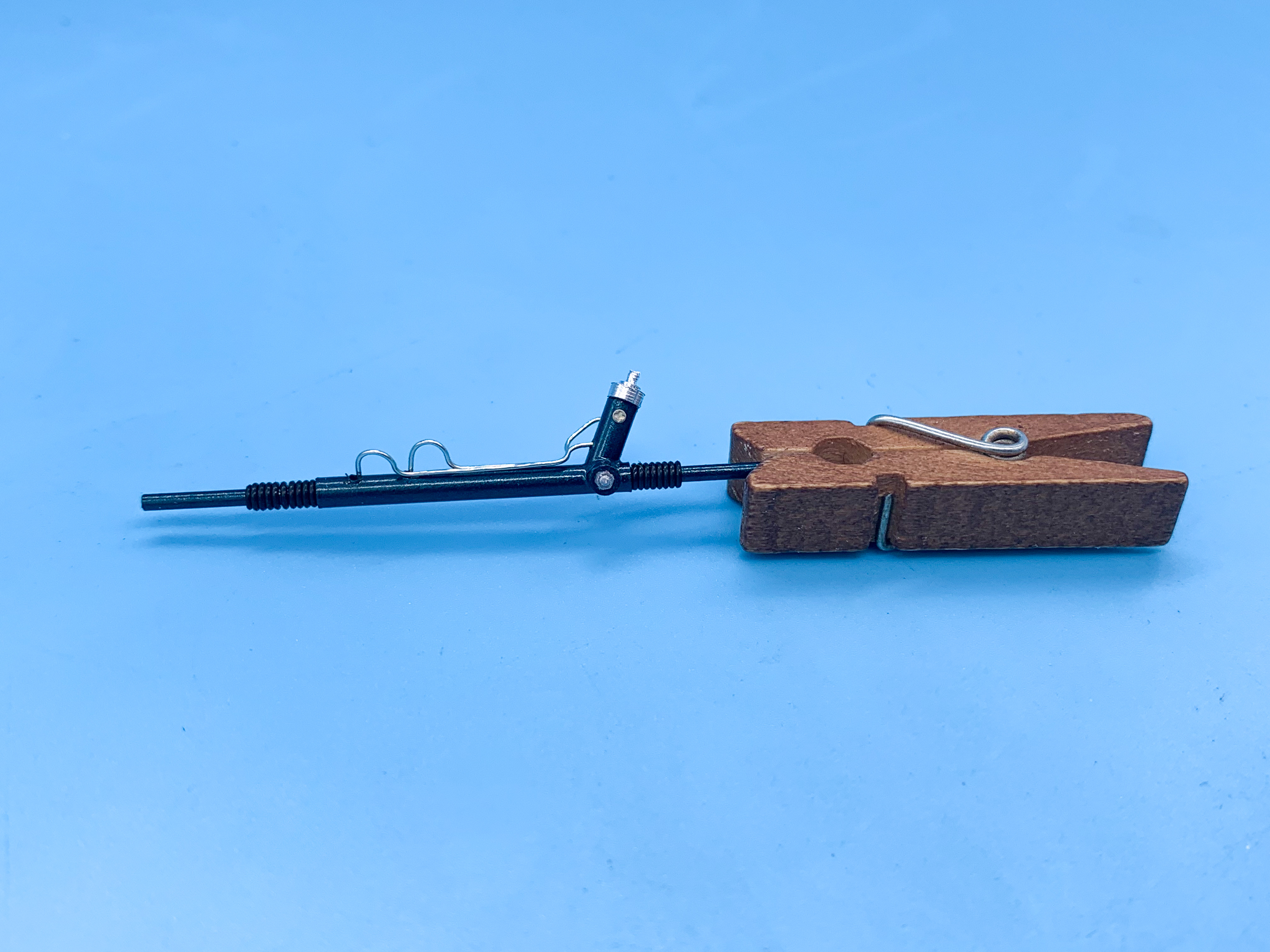

Back at the front of the car, spent a little time today doing some detailing on the steering rack that I made last week - used some micro O-rings, dollar store craft wire, photoetch and a model railroad bolt…came out ok I think:

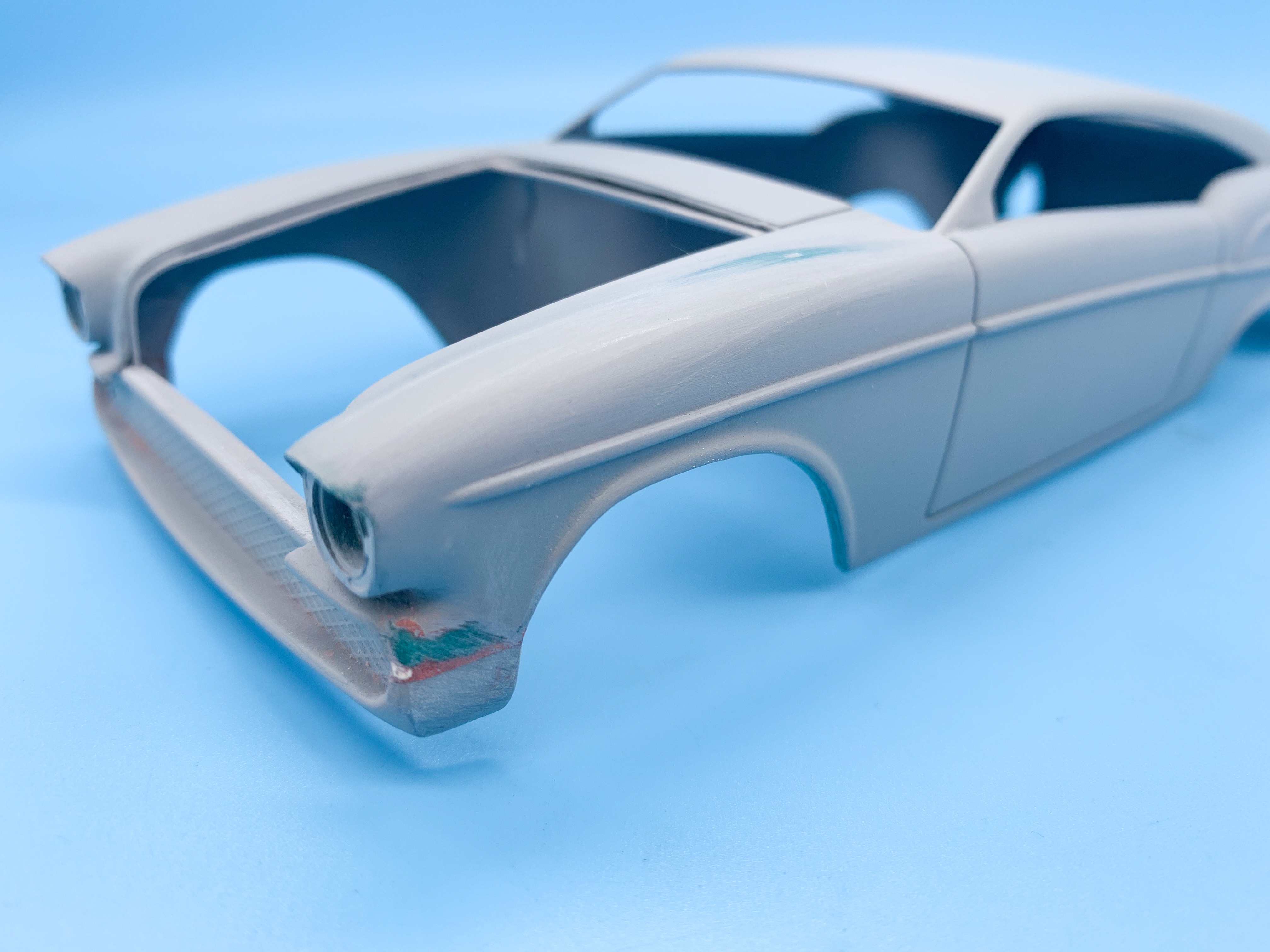

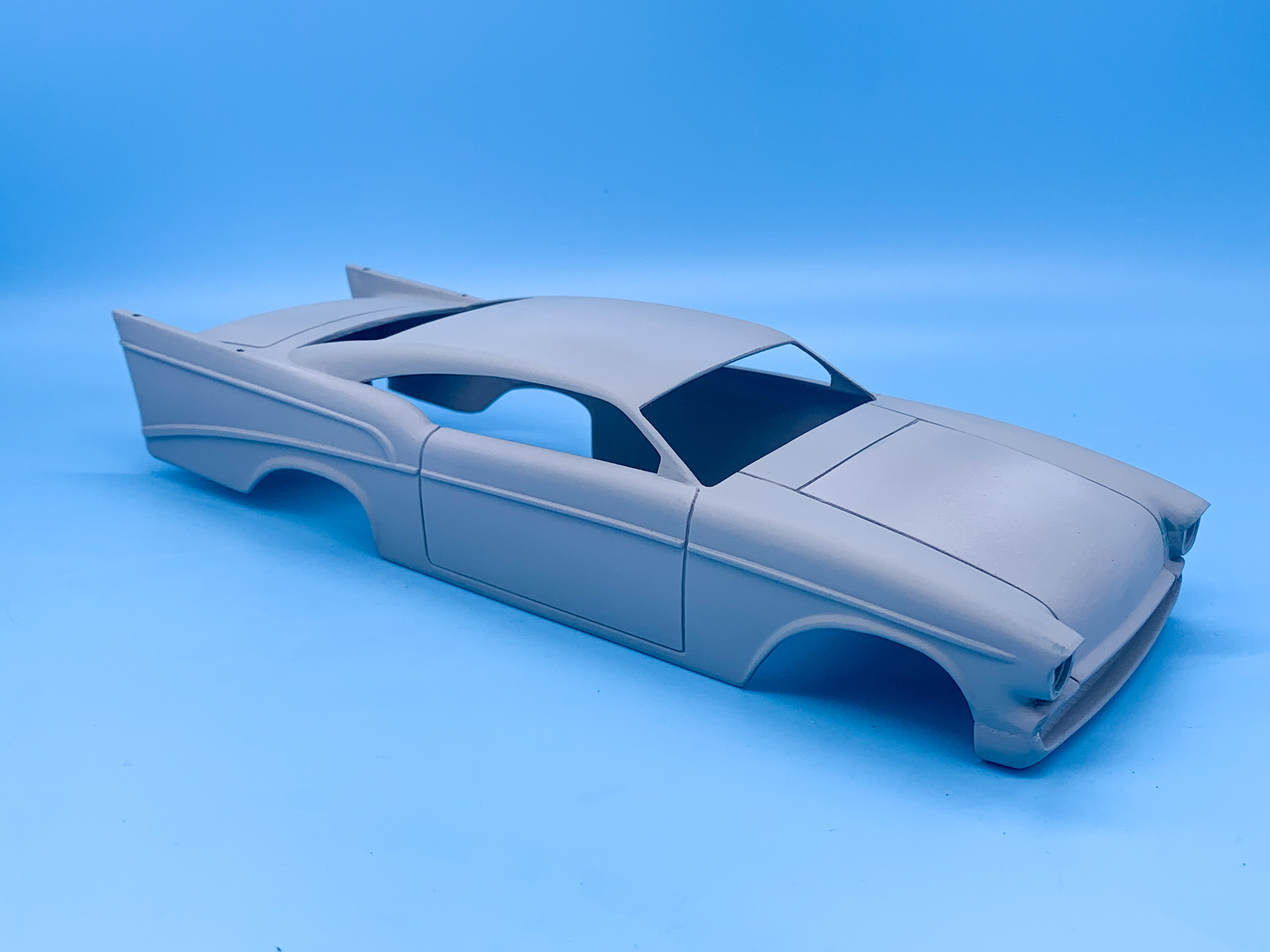

And finally, gave the body a first round of sanding having primed it yesterday - found a few imperfections that I hadn’t seen before…still need to do some work on that front quarter:

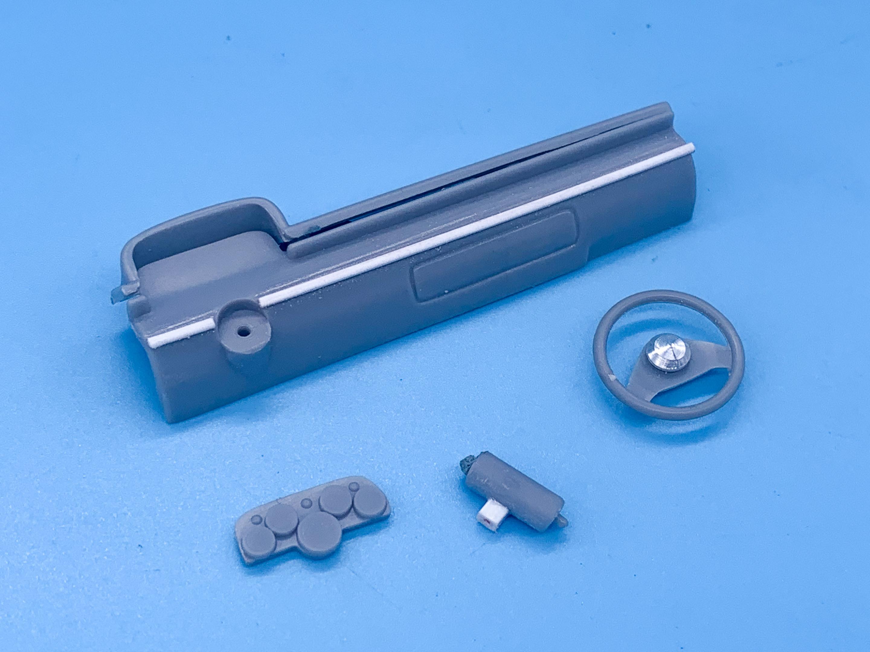

Did some work on the dash, first off - it’s actually not THAT far off the real car - looks pretty simple and basic, but so does the real one…
Added some little missing details and machined an aluminum center for the wheel to match the 1:1’s:
That white block on the steering column will be for the turn signal lever - still need to make that but that’s a pretty simple part…

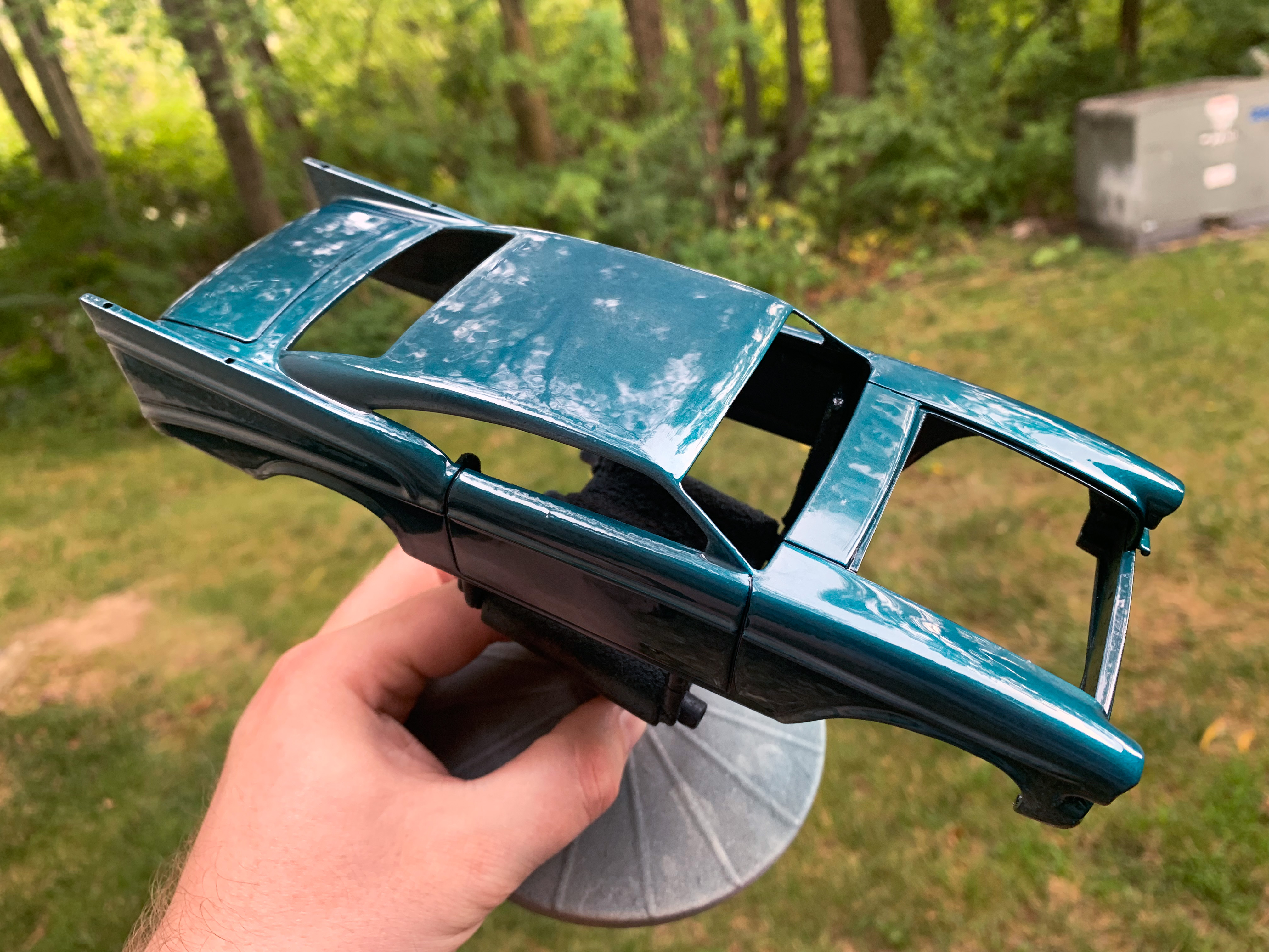

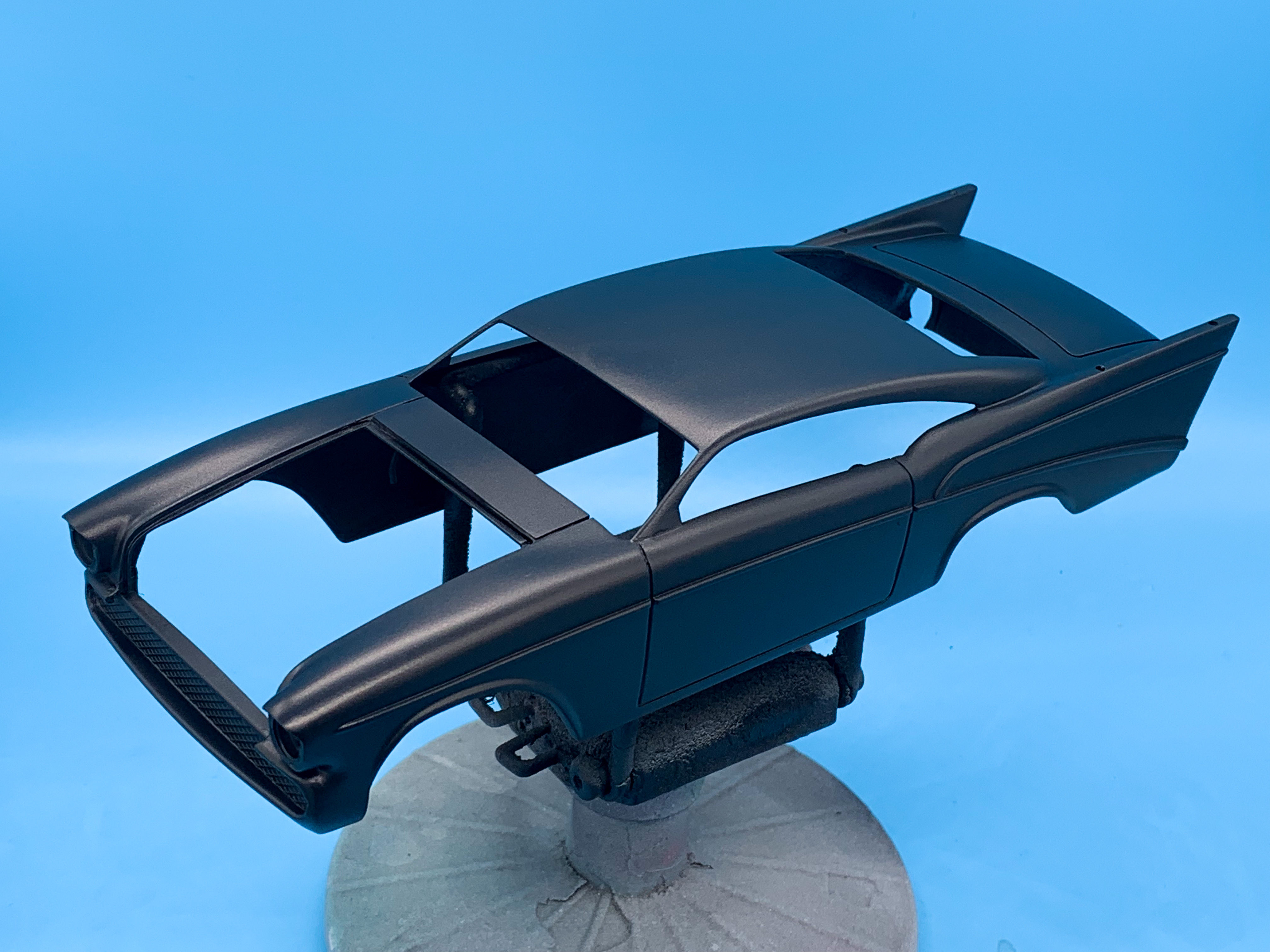

Spent some time getting the body straight - only part that needed more attention than normal is blending the grill to the fenders to lose the seam that isn’t present on the real car:

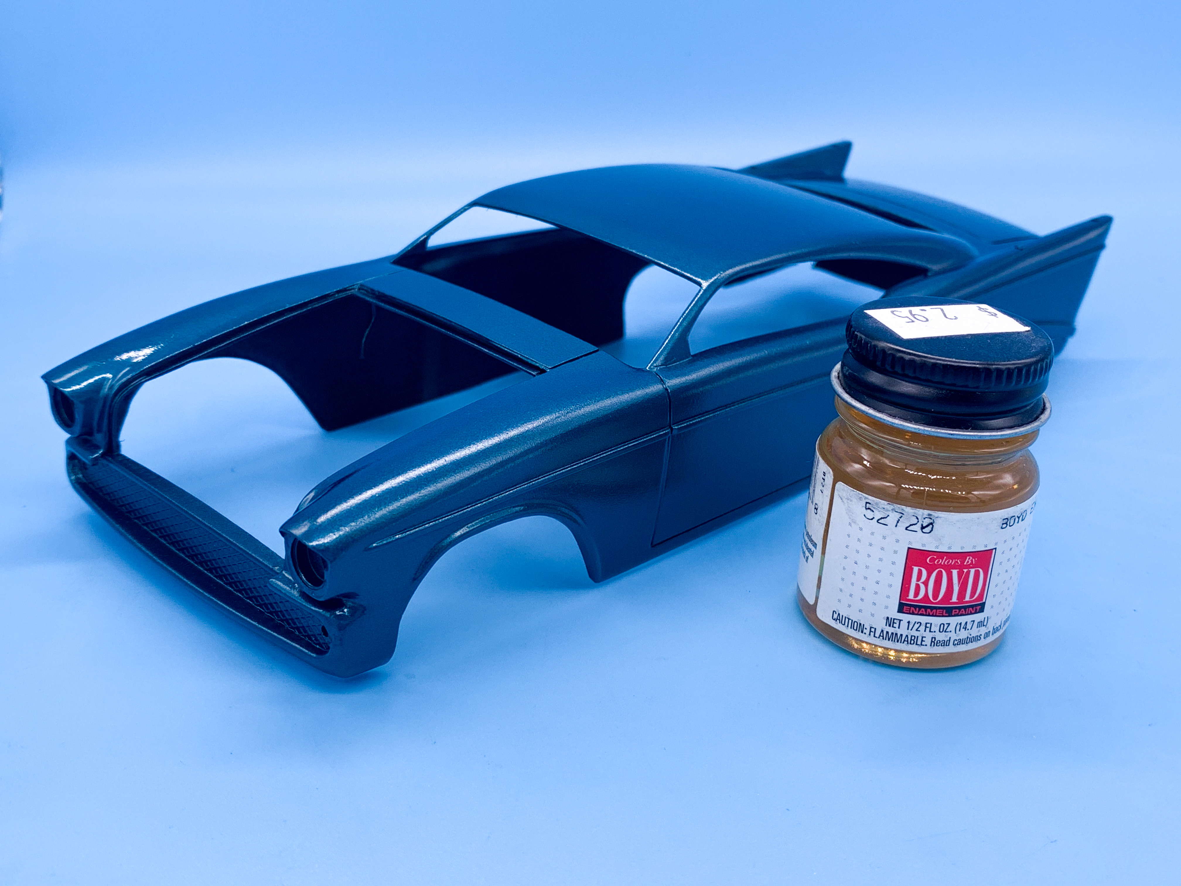

And then when it was all straight on both sides, I shot the whole thing in black:

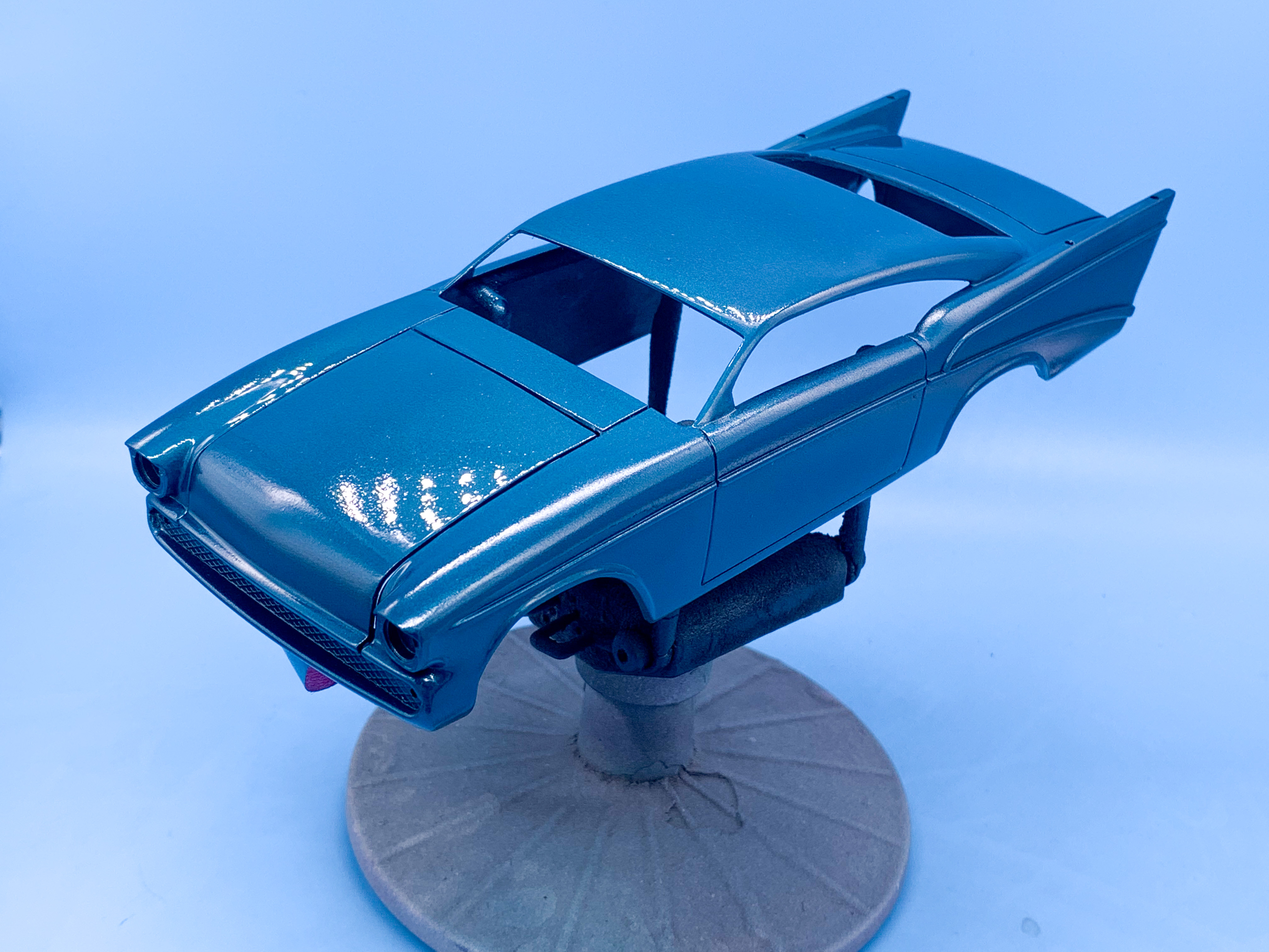

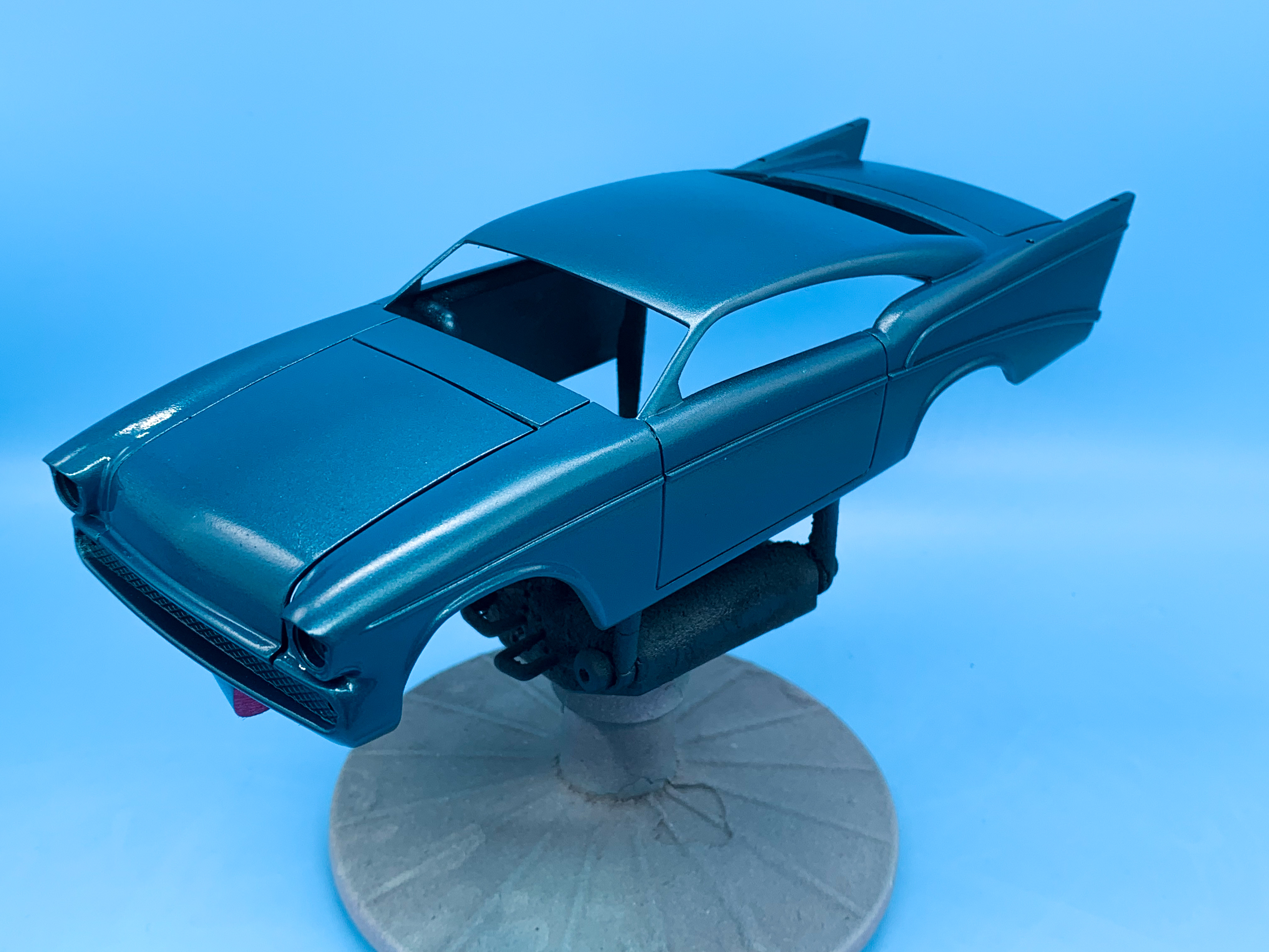

Then four coats of Chezoom teal, thinned:

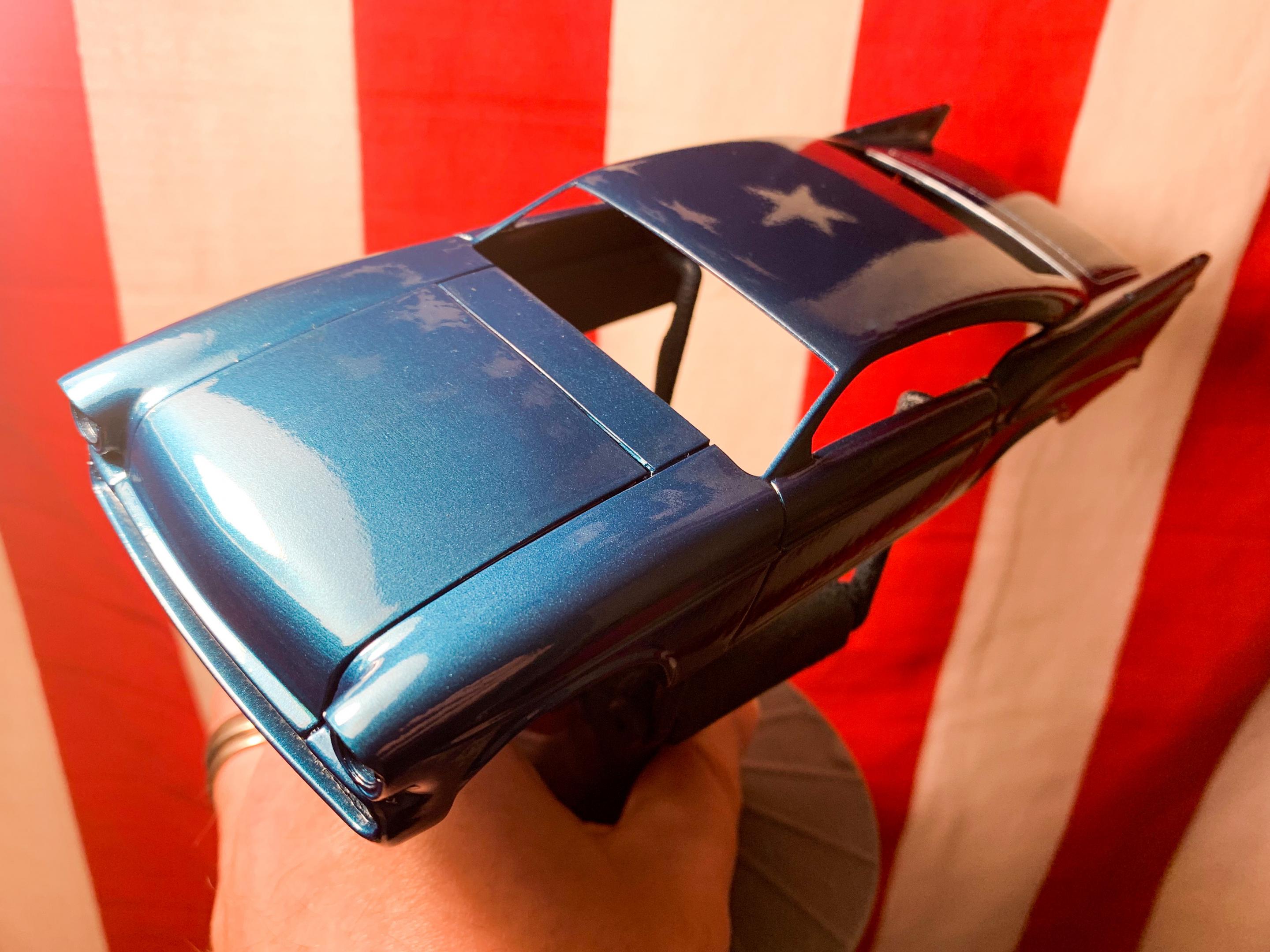

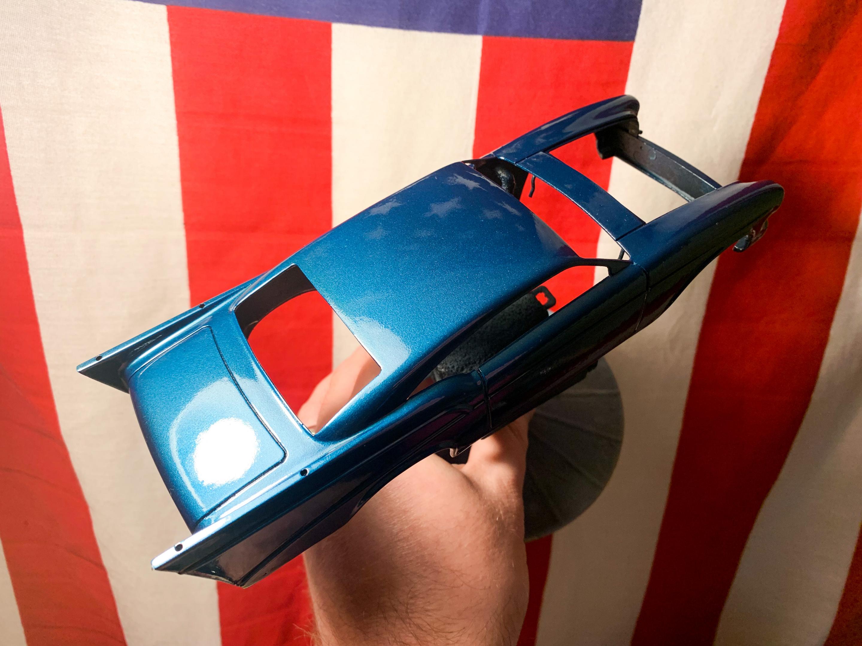

Then finally Pearl + clearcoat to give the blue flip that the real one has:
Once those have dried a few hours I’ll shoot some clear (unless I get distracted by the car show down the street and go to that instead…) - found an appropriate clear to use on this one!

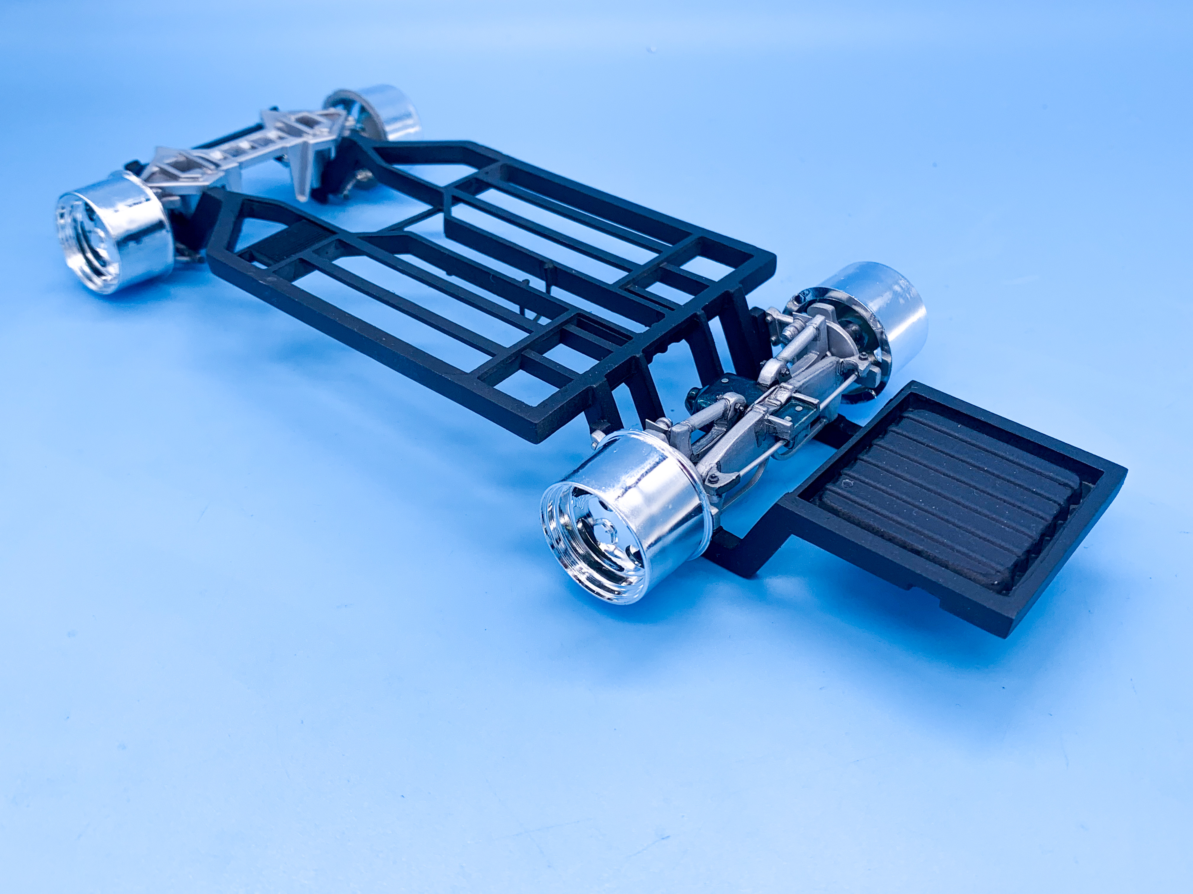

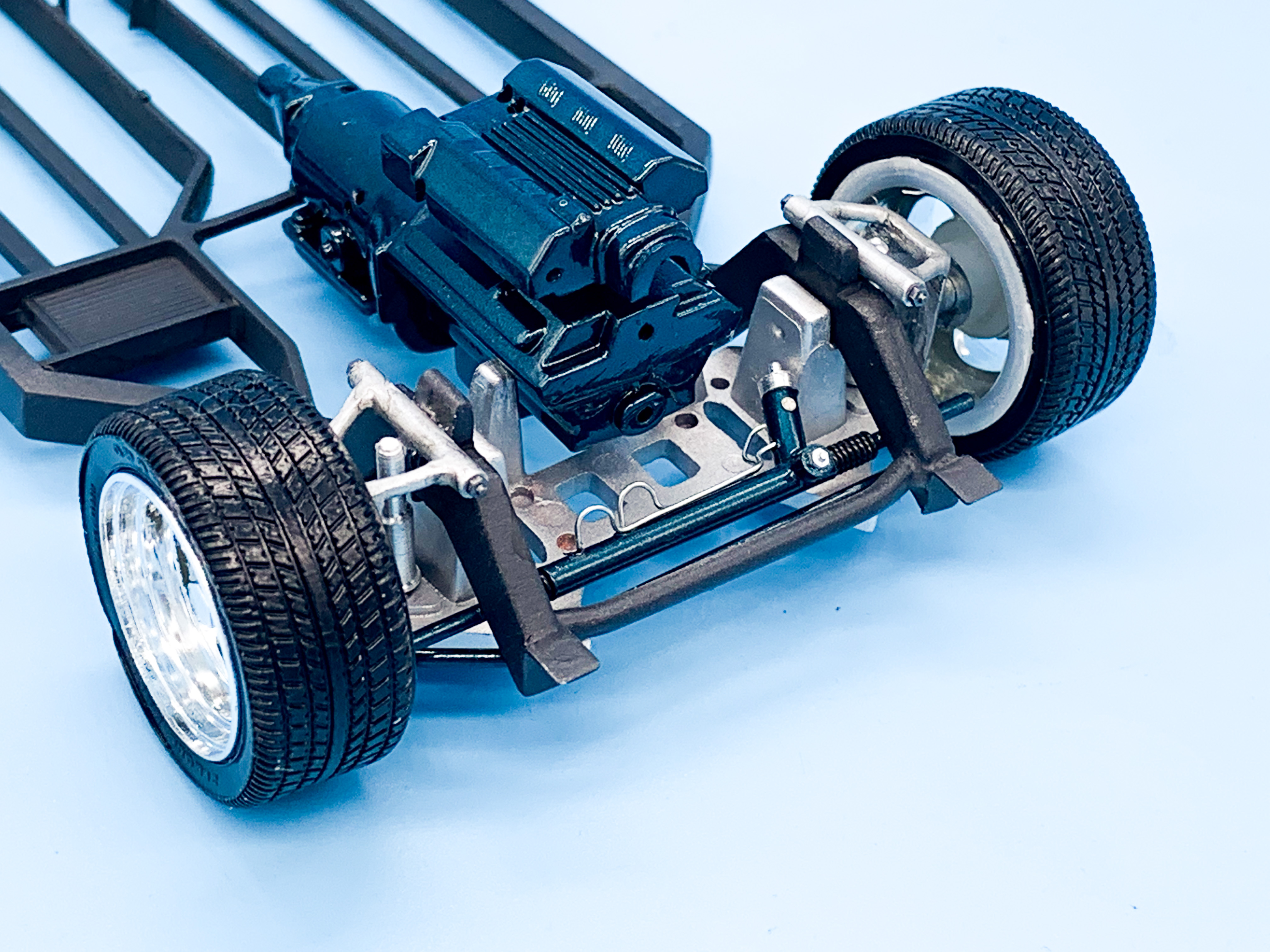

Got the front suspension put together, with that scratchbuilt steering rack that I made earlier, home made sway-bar and some machined shocks:
The wheels aren’t glued on yet, but I wanted to make sure everything still fit right…
Got the rear suspension handled too:

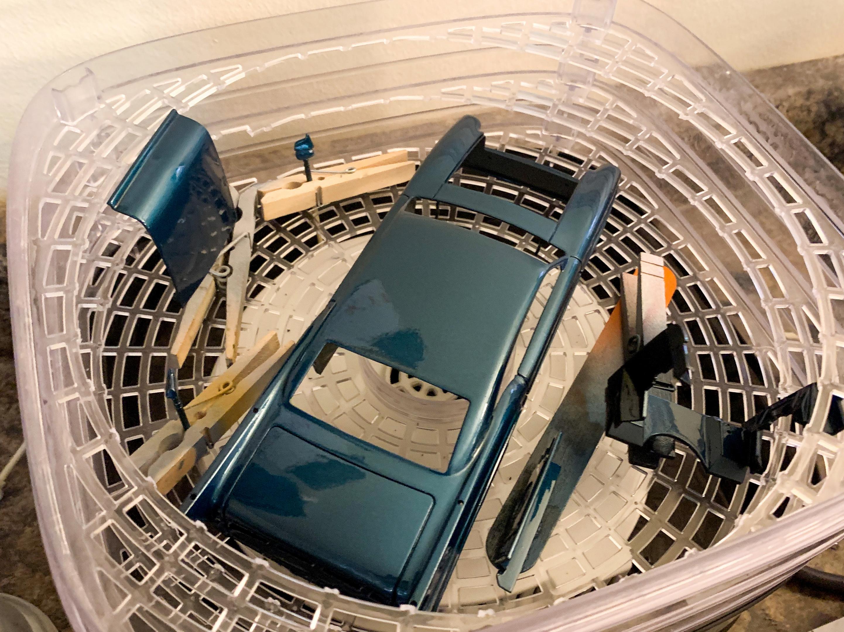

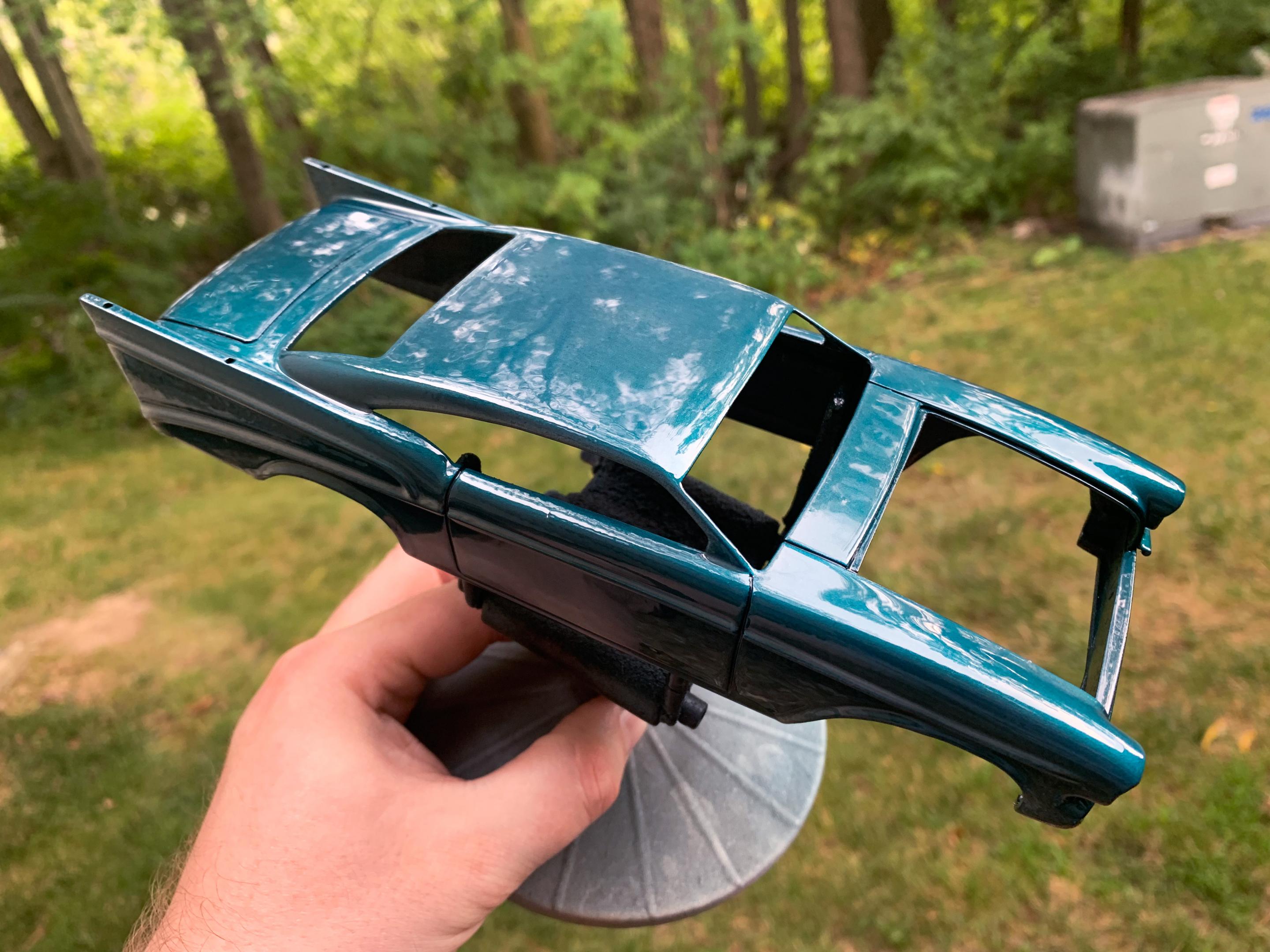

Then got some clear on the body:
Gave it a 24-hours in the dehydrator to bake:
And it’s leveled out pretty nicely overnight!
Far from perfect, but good enough that it’ll polish out nicely I think…

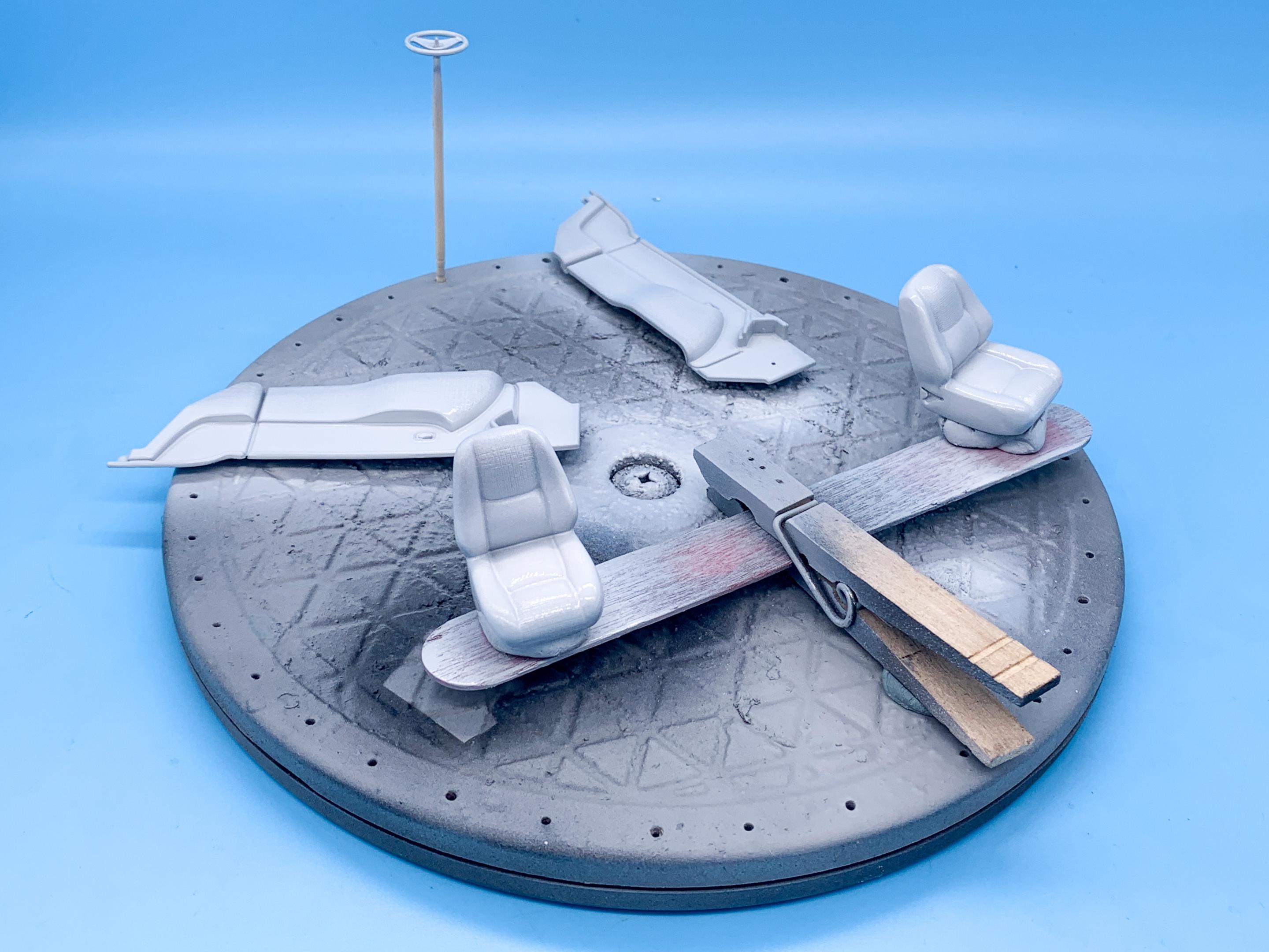

And finally for today, shot the interior parts with Model Master light gray, with some white mixed in.  The interior of the 1:1 car was white, but I wanted some distinction between the glossy bright white dash and the parts that are supposed to be leather, so I went for a slightly darker shade for these bits:
Next up I’ll figure out the right color green for the cloth inserts on the seats to match the real one:

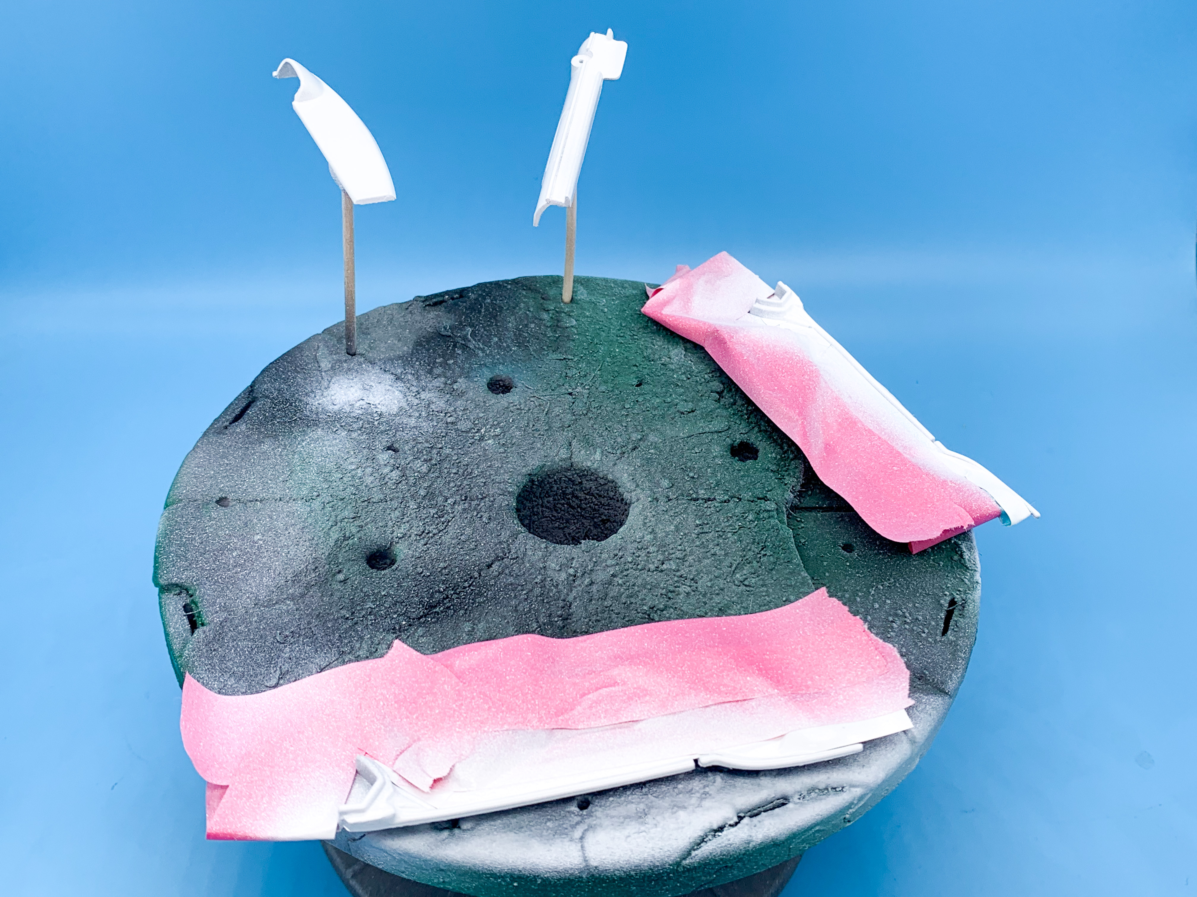

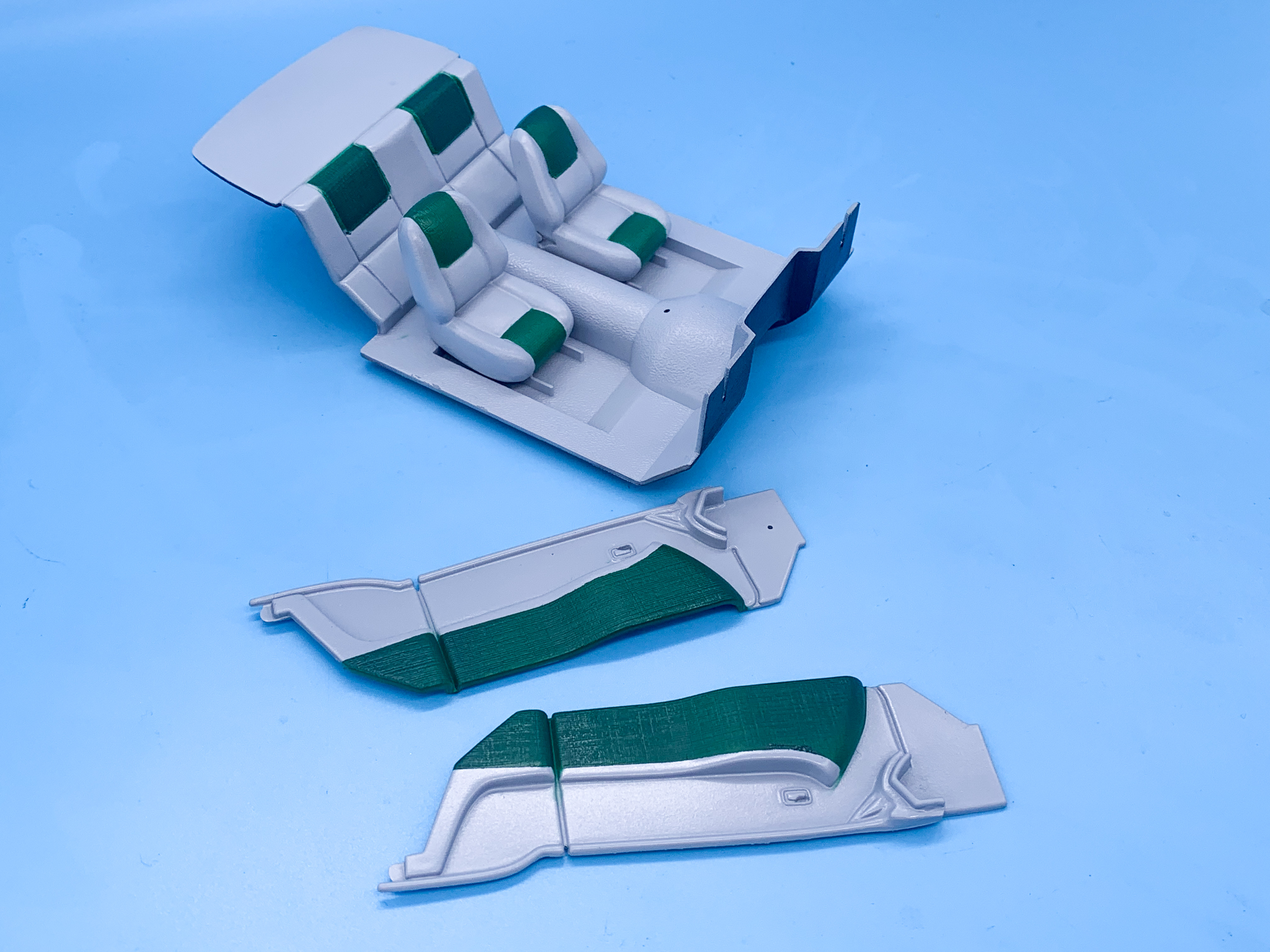

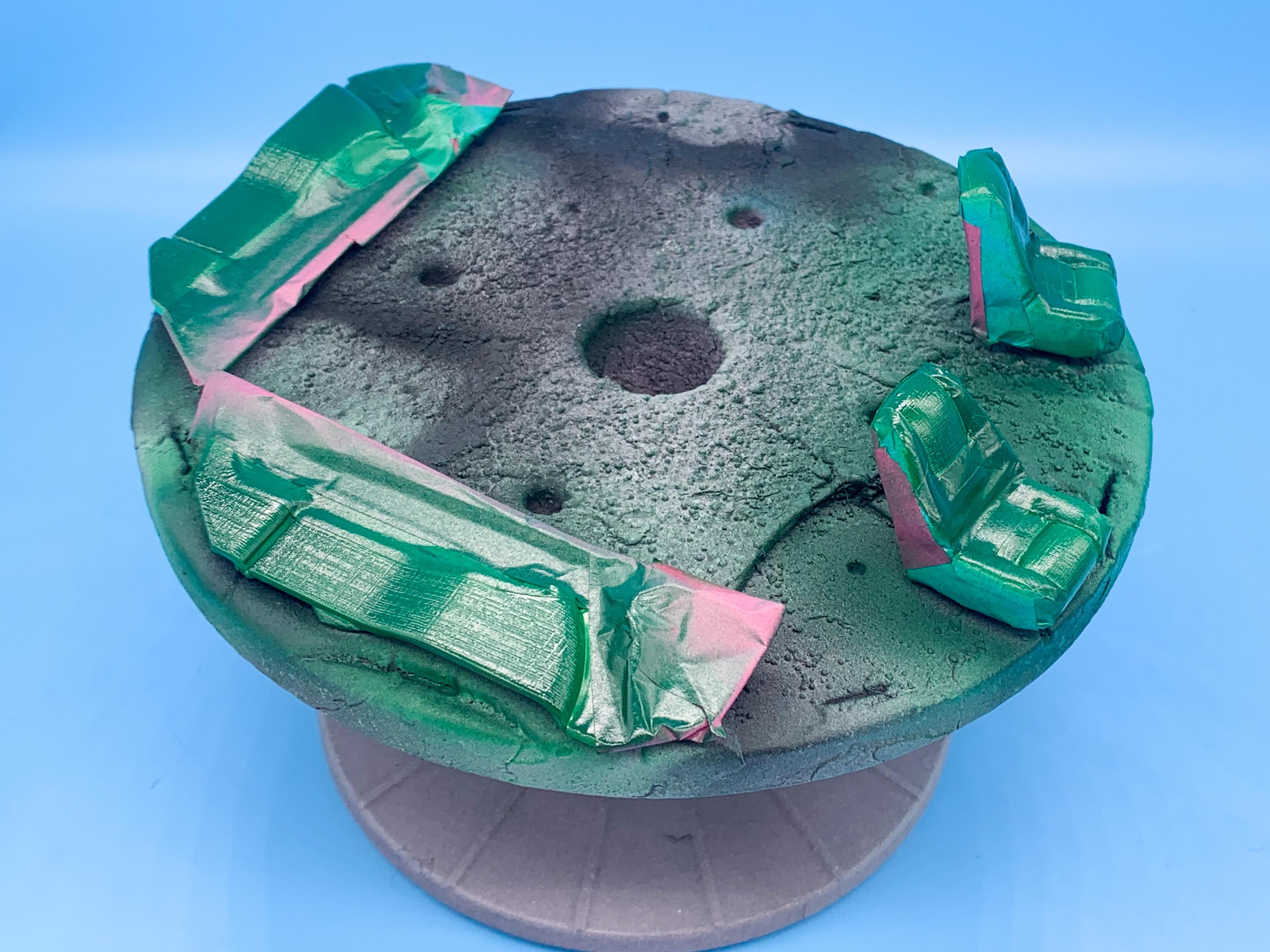

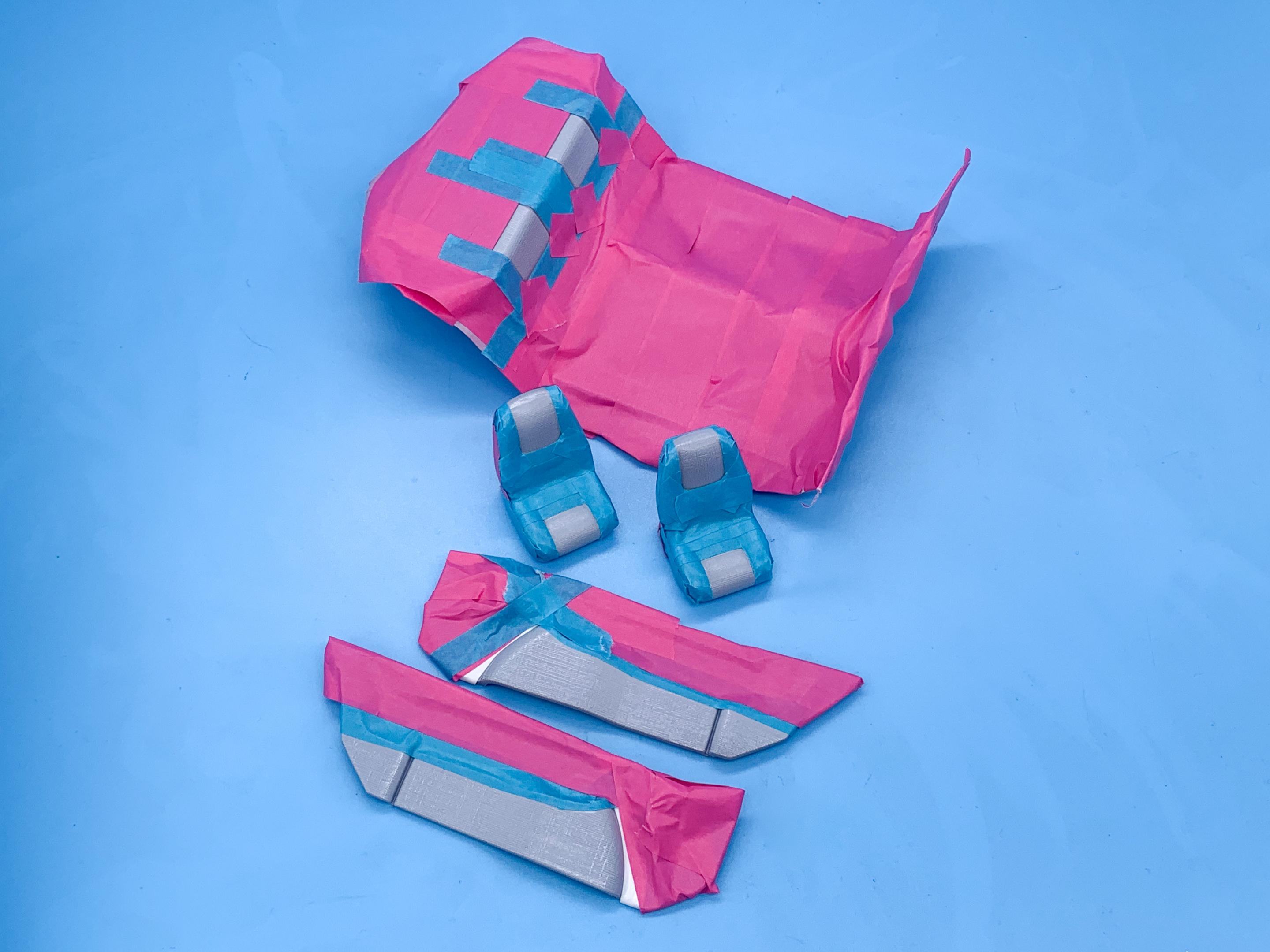

Masked the interior pieces ready for the green cloth inserts that the real car has:
Studied the handful of interior photos I’ve got in my reference folder and mixed up some acrylic green to match:
Then shot them with matte clear with a couple of drops of translucent black mixed in - tada!
The tops of the doors and the dash are white as best I can tell, so I remasked and shot those this afternoon - I went for Createx pure white for these, because it’s a really nice high-pigment opaque white that covers really well:
Once that was dry I shot the white with some Rustoleum clear lacquer to make them nice and shiny like the real parts…I’ll give those some more attention and detailing tomorrow…

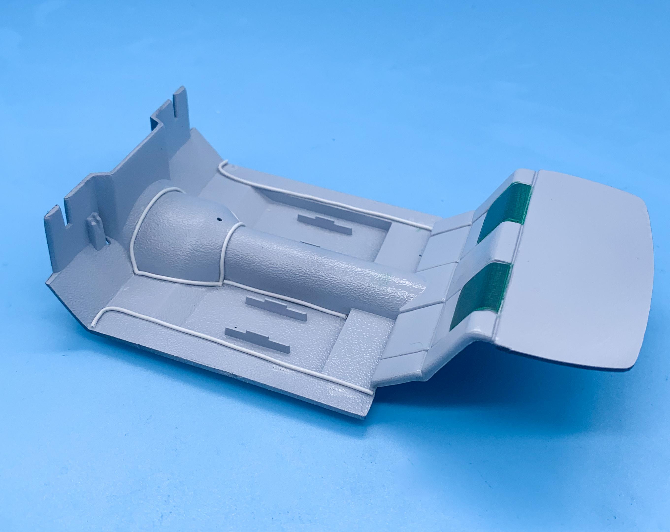

Whilst I’m messing with interior parts, one of my reference shots shows that the carpet has white piping, so I added that in the places where you’ll be able to see it:

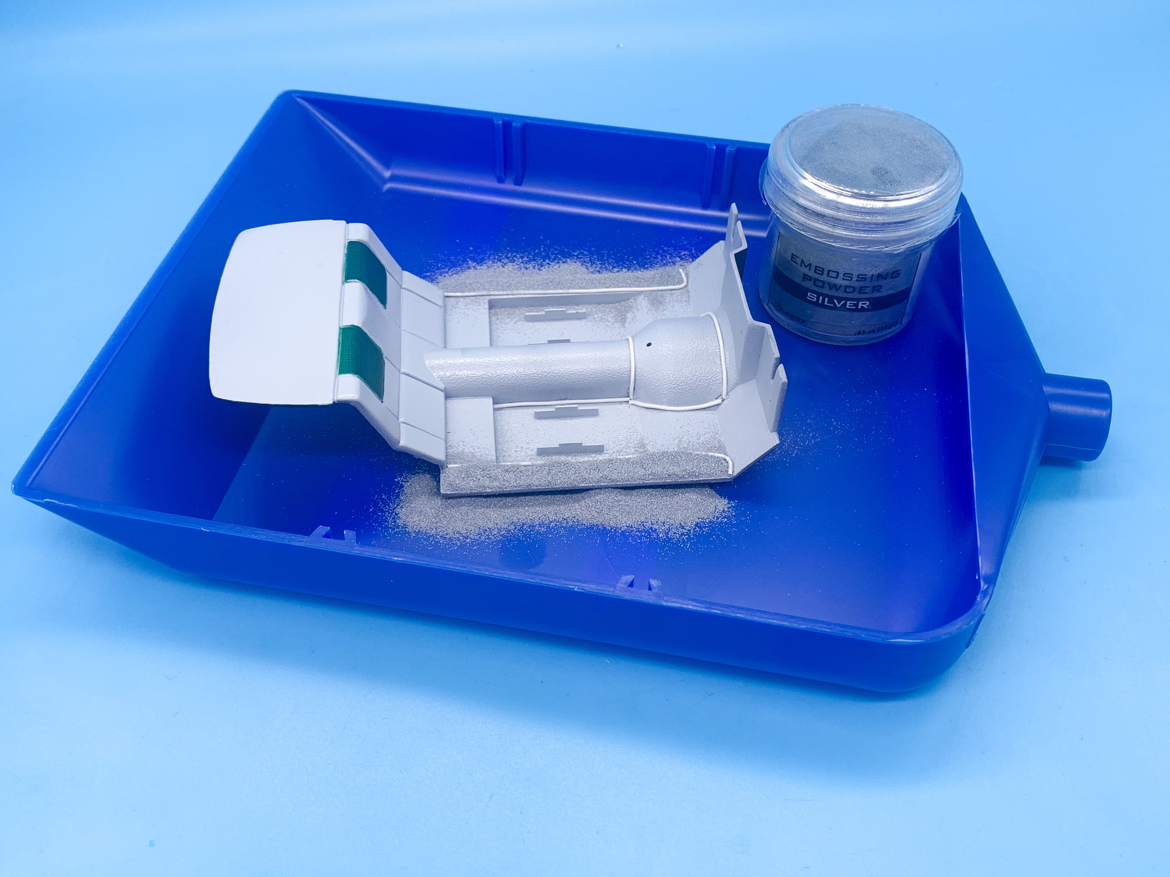

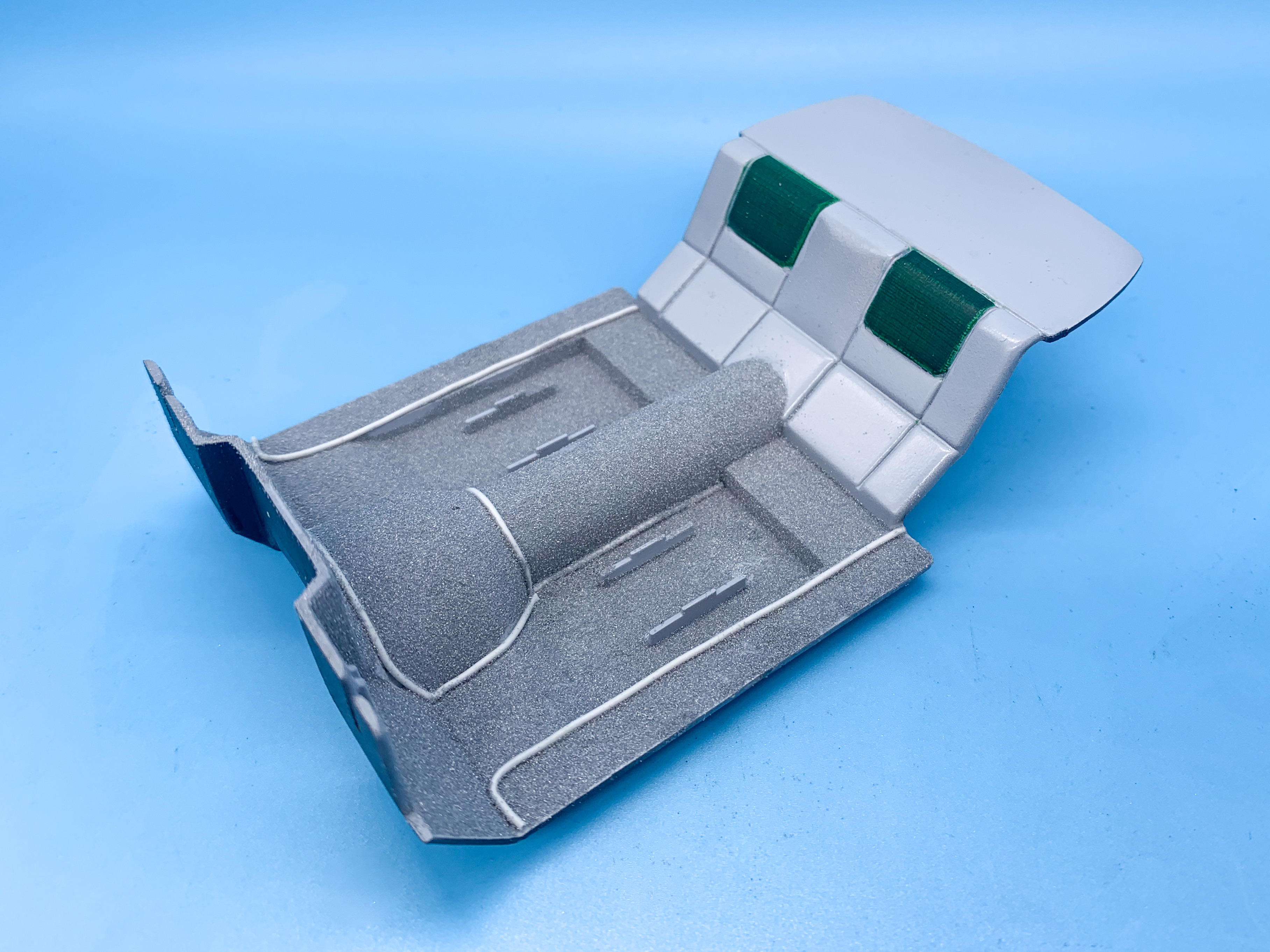

Then started working through and adding ‘carpet’ itself:
Got lucky and found an embossing powder that was a good match for the reference pics I found…it’s technically silver, but its not particularly metallic-looking and it’s close enough for the girls I go with ?
A few hours later:
Couple of little touch-ups needed but nothing major…

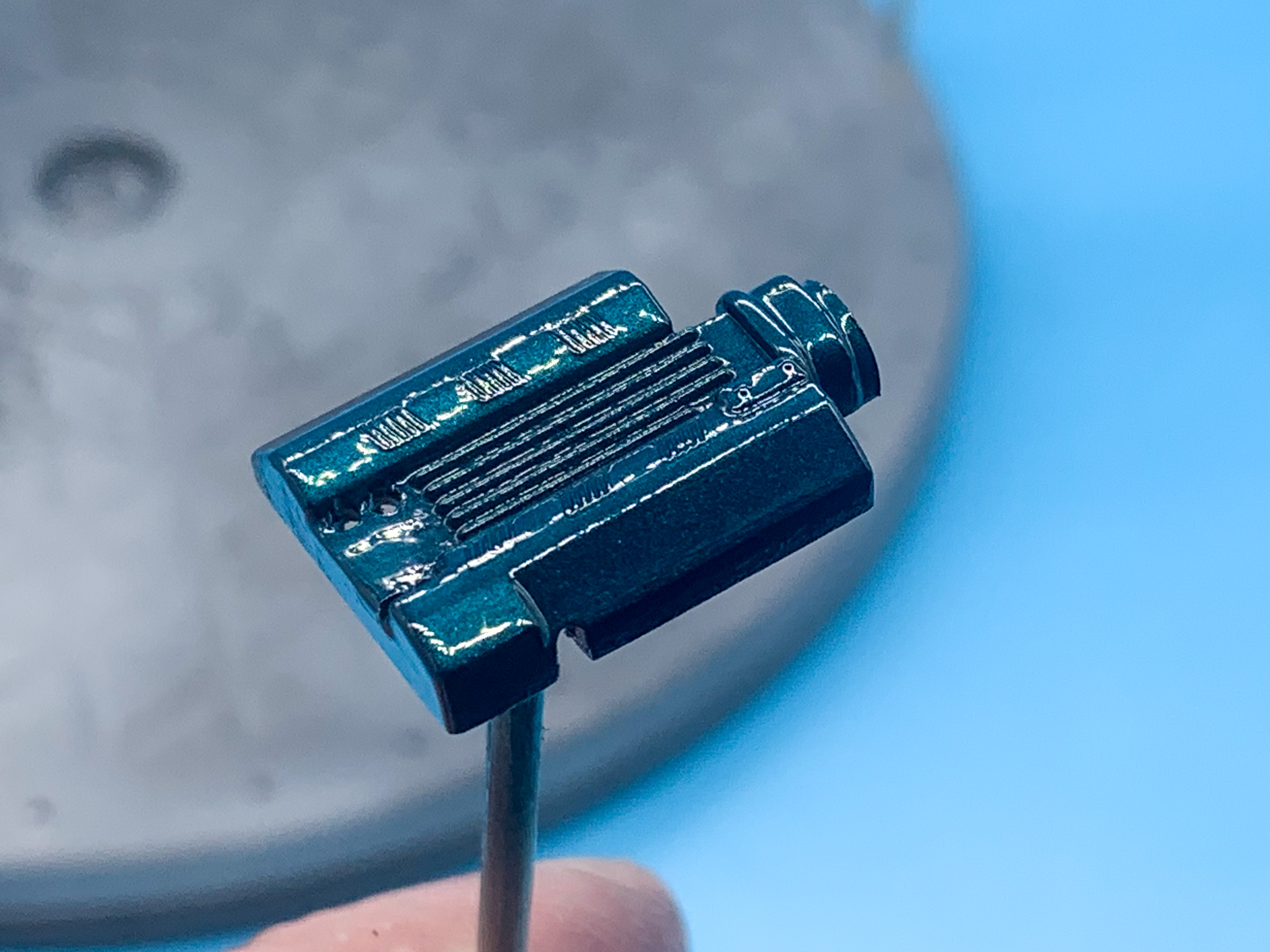

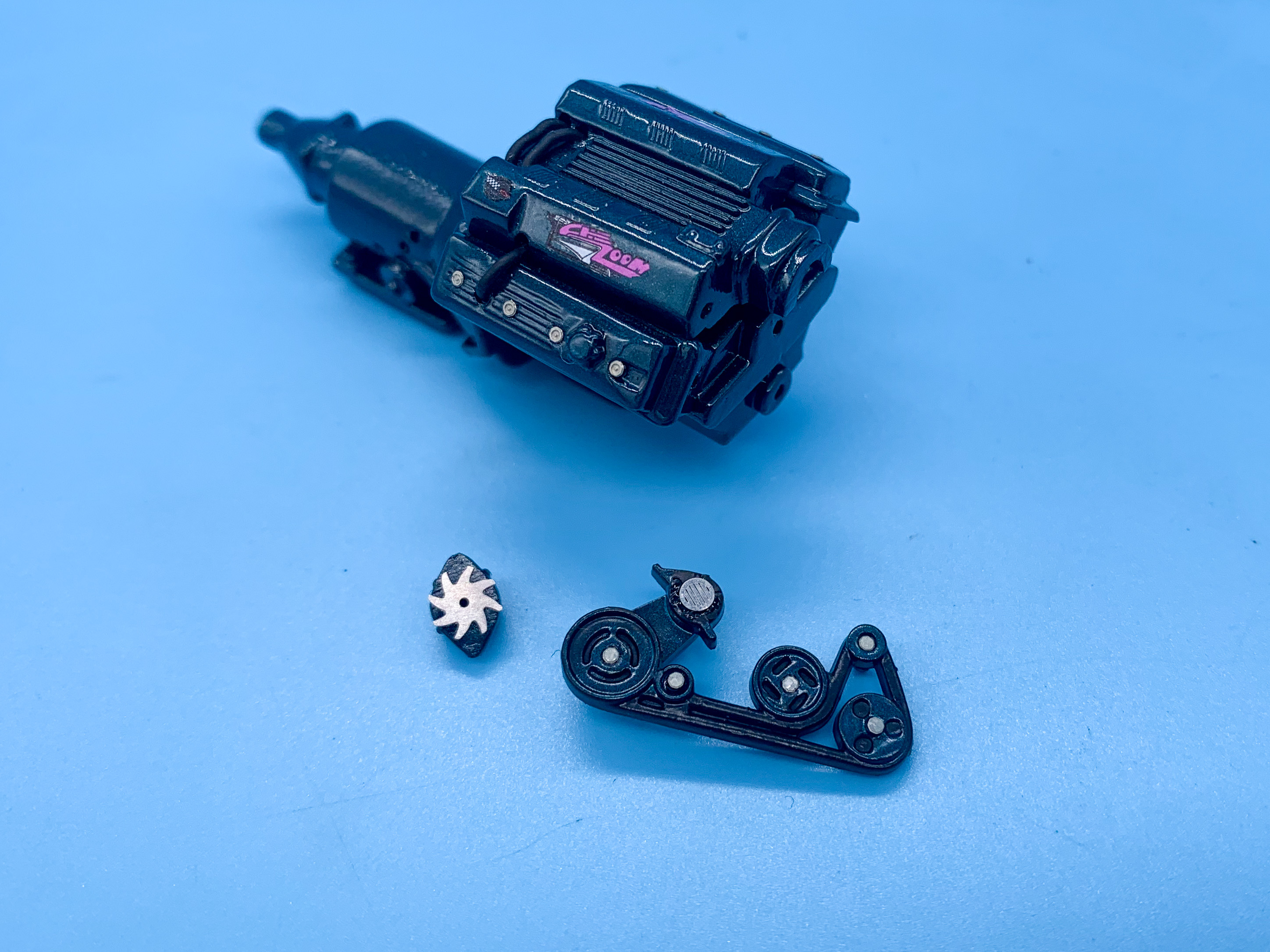

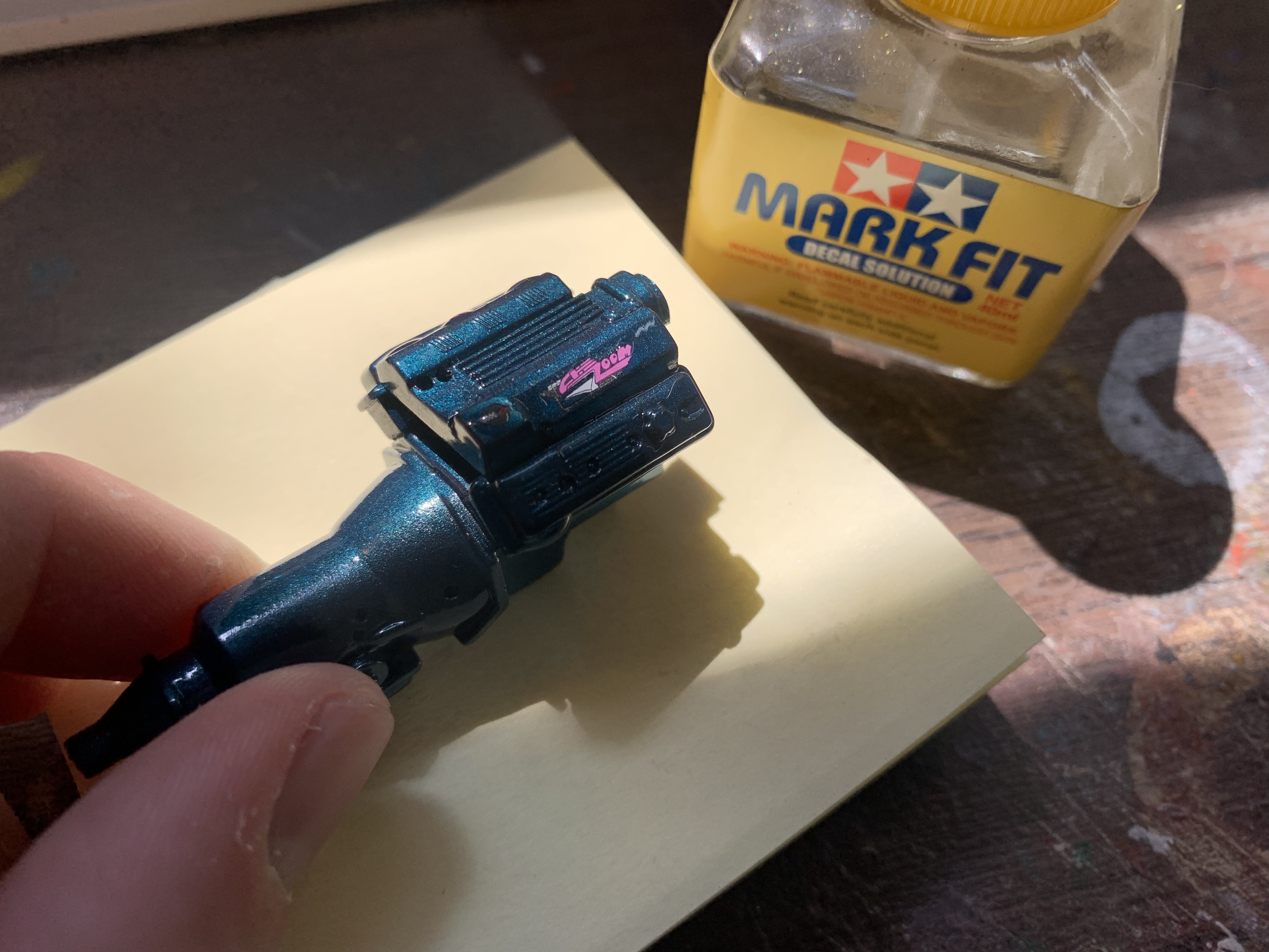

Whilst the glue’s drying on the carpet, started some work on the engine…got those distinctive Chezoom logo decals in place:
These decals were REALLY fragile - I could see them breaking apart as I applied them, but I got them on there safely…and with that done, started adding some little bits of detail to the engine - added some PE bolts to the valve covers, PE bolts to the pulleys and a little detail to the alternator too whilst I was at it:
