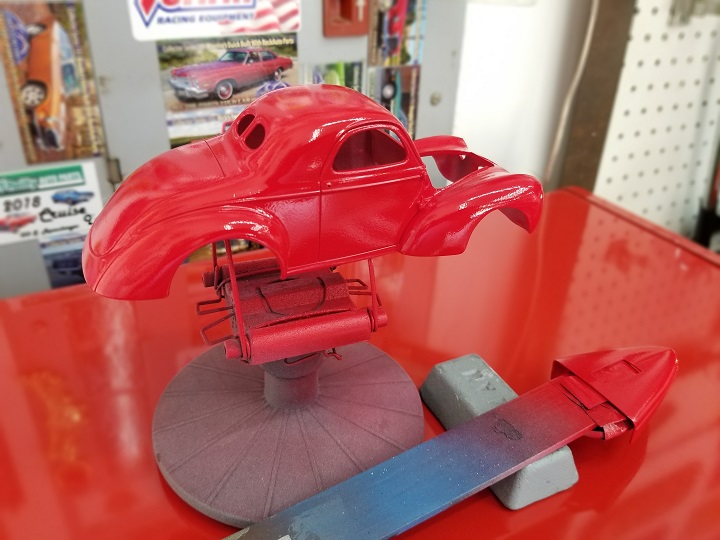

Zippi Posted August 4, 2021 Author Posted August 4, 2021 Just did a little test on the top portion of the dash on my 41 Willy's. This is after just 2 coats. Looks like the Rust-Oleum lacquer is compatible with the Tamiya lacquer. Now it's on to the body.
Zippi Posted August 4, 2021 Author Posted August 4, 2021 I got the body and hood clear coated. Two light coats, one medium coat, and one wet coat with 20 min flash time with each coat. I'll let this cure until the weekend then start the wet sanding.

TransAmMike Posted August 4, 2021 Posted August 4, 2021 1 hour ago, Zippi said: I got the body and hood clear coated. Two light coats, one medium coat, and one wet coat with 20 min flash time with each coat. I'll let this cure until the weekend then start the wet sanding. Looks good Bob. So how do you like the this clear compared to the other Rusto clear you were using?
Zippi Posted August 4, 2021 Author Posted August 4, 2021 Well.....I think the Rust-Oleum enamel and lacquer gloss clear coats lay down about the same and both are thin so running could be an issue if your not careful. One being an enamel and one a lacquer and they both can be we sanded so I think they are both great products. I think either one would be fine for clear coating a model.

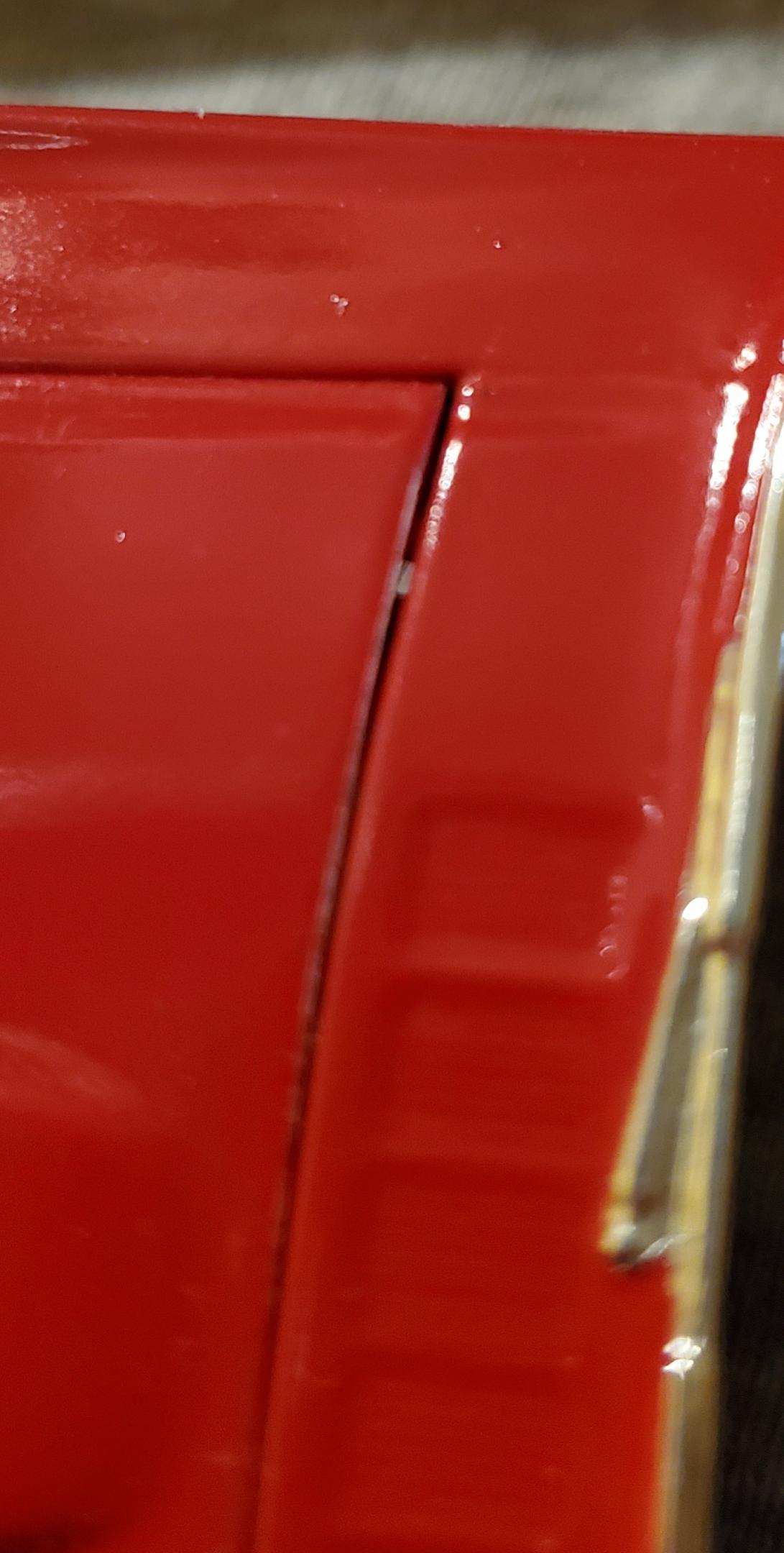

Fat Brian Posted August 4, 2021 Posted August 4, 2021 I've been using the acrylic lacquer and found that it's very susceptible to humidity, it dries much rougher now than it did in the winter and spring. I've also noticed that it can cause the color coats to pull back from the edges of panel lines. This hood shows how it thinned at the edge, it wasn't like this before the clear. This is Duplicolor red over Duplicolor white primer.
Zippi Posted August 4, 2021 Author Posted August 4, 2021 Thanks for the info Brian. I'm well aware of the humidity and the important roll it p!ays in painting. Don't ask me how I know. Today the humidity was 52% so for me that was ideal.
AMT68 Posted August 4, 2021 Posted August 4, 2021 That Willy's turned out great Bob and doesn't appear from the pictures like it will need much wet sanding. I've never thought to try the 2X enamel clear but think it would be worth attempting. 1
