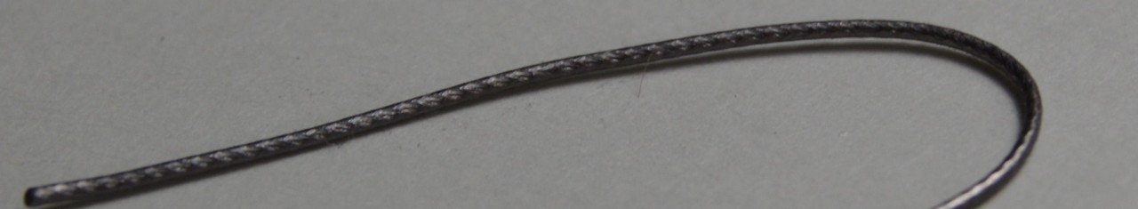

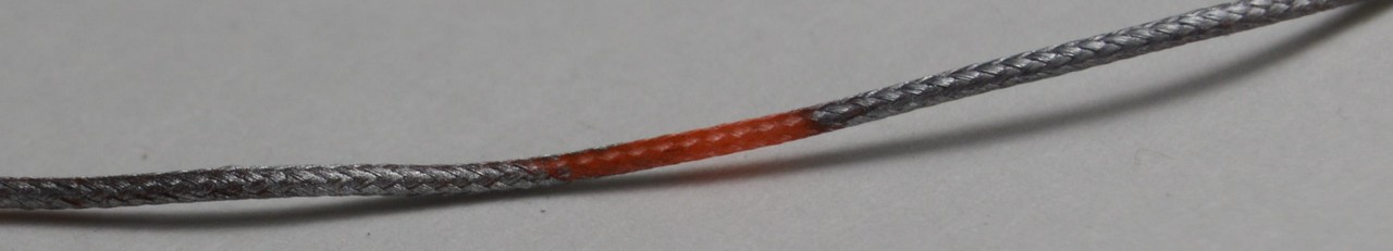

Straightliner59 Posted August 8, 2021 Posted August 8, 2021 My late friend, Mark Brown always suggested braided fishing line as braided line on scale models. I hadn't found the stuff I knew he was talking about, until just the other day, while looking for something flexible, to make braided lines to the calipers on my supermodified. This stuff is lead core, and is about .040". It's made by Tuf Line in Grand Junction, CO. I colored these two sections with A: (Closest to the end) silver Sharpie and B: Molotow Chrome pen. I deliberately cropped the photo large, so the detail shows up better. The other photo shows the lead core, which has been somewhat imprinted by the braid. Now, I really understand what Mark was talking about! I am currently searching for other diameters.

peteski Posted August 8, 2021 Posted August 8, 2021 While the fishing stuff looks ok, if one really pays attentions to scale fidelity, the angle of the braiding is wrong for scaled down braided lines. The only scale braided line I know that has the most realistic appearance is from Pro-Tech. Those really look like scaled down braided lines. Sure, they cost more, but to me couple more bucks spend on a model to make it look really good is worth it.

Straightliner59 Posted August 8, 2021 Author Posted August 8, 2021 8 hours ago, peteski said: While the fishing stuff looks ok, if one really pays attentions to scale fidelity, the angle of the braiding is wrong for scaled down braided lines. The only scale braided line I know that has the most realistic appearance is from Pro-Tech. Those really look like scaled down braided lines. Sure, they cost more, but to me couple more bucks spend on a model to make it look really good is worth it. None of the packaged braided lines appear to be in scale, to me. That was always Mark's feeling, as well. That's the only reason I started really looking at the braided fishing line.

Claude Thibodeau Posted August 13, 2021 Posted August 13, 2021 HI! I make my own with aluminium wire from Home Depot, laid flat on a counter, nd "cross-rolled" with a flat file (1" wide". The number of file strokes, and the angle of the file in relation to the wire varies the braiding pattern. Not perfect, but cheap, and being solid metal, it keeps any bend or arc you inflect on it. My two cents, for what it's worth... CT

Straightliner59 Posted August 28, 2021 Author Posted August 28, 2021 On 8/12/2021 at 12:40 PM, 1930fordpickup said: I would like to note that fishing line becomes smaller in diameter because of better tech. So if you are at a garage sale look for braided line there. Andy, yes, I am thinking that the stuff I remember from when I was young would have the proper look. On 8/13/2021 at 9:46 AM, peteski said: I don't really build models for the judges -- I do it for my own satisfaction. Ain't any other reason! On 8/13/2021 at 6:49 AM, Claude Thibodeau said: HI! I make my own with aluminium wire from Home Depot, laid flat on a counter, nd "cross-rolled" with a flat file (1" wide". The number of file strokes, and the angle of the file in relation to the wire varies the braiding pattern. Not perfect, but cheap, and being solid metal, it keeps any bend or arc you inflect on it. My two cents, for what it's worth... CT Claude, I remember trying that when Randy Derr and Jim Drew(?) were doing low-budget, high tech articles on some ancient clay tablets. When you get it right, it's very convincing! I've revisited it, recently, and find it to be a bit tricky, to get it just "so", but there are applications where I definitely plan to use it.
Claude Thibodeau Posted August 29, 2021 Posted August 29, 2021 21 hours ago, Straightliner59 said: Andy, yes, I am thinking that the stuff I remember from when I was young would have the proper look. Ain't any other reason! Claude, I remember trying that when Randy Derr and Jim Drew(?) were doing low-budget, high tech articles on some ancient clay tablets. When you get it right, it's very convincing! I've revisited it, recently, and find it to be a bit tricky, to get it just "so", but there are applications where I definitely plan to use it. Hi Daniel! Well, it works for me. I do them in batches, in different aluminium wire sizes. Perfect for brake hoses, fuel lines, heater hoses, and even radiator hoses, if you use the silver solder (solid core) found in electronic shops. CT
