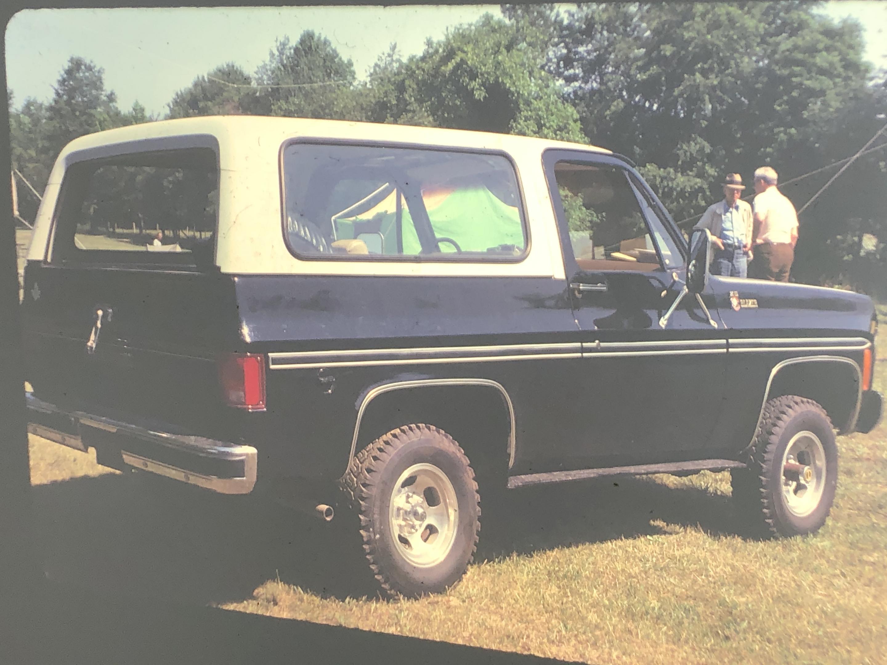

SCRWDRVR Posted August 11, 2021 Posted August 11, 2021 I’m looking for the easiest way to replicate the body side moldings that came on the 70’s Chevy trucks, any ideas?
Fat Brian Posted August 11, 2021 Posted August 11, 2021 (edited) I would use Evergreen plastic strips. 1mm or 1.5mm wide and .2mm or so thick looks close. Sand the point at the front into it then glue it down with something like Tamiya thin or Bondene. For the silver part I would glue a round rod about .3mm around the edge of the flat strip. This should get you in the ballpark at least, if you have actual measurements for the trim you could get it closer. Edited August 11, 2021 by Fat Brian
SCRWDRVR Posted August 11, 2021 Author Posted August 11, 2021 58 minutes ago, Fat Brian said: I would use Evergreen plastic strips. 1mm or 1.5mm wide and .2mm or so thick looks close. Sand the point at the front into it then glue it down with something like Tamiya thin or Bondene. For the silver part I would glue a round rod about .3mm around the edge of the flat strip. This should get you in the ballpark at least, if you have actual measurements for the trim you could get it closer. I don’t have measurements unfortunately that would definitely help, I’m building both of these vehicles that were my Dads, I have an extra cab so at least I have a tester cab….
Beans Posted August 11, 2021 Posted August 11, 2021 Similarly I would use Evergreen, but a flat length with a half round on top of it but not as wide for the black. Both sanded to shape and depth. If a definite distinguishable seam is wanted then you can scribe around the edges of the half round.
espo Posted August 11, 2021 Posted August 11, 2021 I would follow the suggestions from both Brian and Joe with a little change to the chrome parts surrounding the black molding. I would suggest using quarter round for the outer moldings. My reason for this is the trim was the same thickness all the way across on the 1:1. GM used an aluminum molding for the trim with an indentation in the center for the black plastic type trim. The quarter round trim would give you a flat surface to the center and the mounting side of the part you're adding. As for the size a lot of that can be done by eye. You have some great looking photos to work with. You may have to mock up a couple of different sizes but I think you'll know when you have the correct sizes when you see them. There is also a molding that runs around the back side of the cab below the rear window. Looking at your picture of the pickup with the camper shell you can see a very small portion where the meets the door. The drip moldings over the doors were a brushed aluminum type finish. The grill moldings were chrome but the grill its self was painted Argent, GM's term for flat silver.

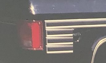

Foghorn Leghorn Posted August 11, 2021 Posted August 11, 2021 5 hours ago, SCRWDRVR said: I don’t have measurements unfortunately that would definitely help, I’m building both of these vehicles that were my Dads, I have an extra cab so at least I have a tester cab…. How's your math these days? The lens is 7 ½” tall.
SCRWDRVR Posted August 11, 2021 Author Posted August 11, 2021 14 minutes ago, mikemodeler said: Keep in mind that HL only stocks a fraction of what is available from Evergreen. Check the Evergreen website and you may have to order it from a hobby shop. Definitely I want to see what they have to reference the size, I’m sure I will have to order what I get 8 minutes ago, Foghorn Leghorn said: How's your math these days? The lens is 7 ½” tall. knowing that and just looking I would say that molding is about 2” thanks it helps know the size of the tail lights
Beans Posted August 11, 2021 Posted August 11, 2021 20 minutes ago, Foghorn Leghorn said: How's your math these days? The lens is 7 ½” tall. Lets see if I can figure this out... 7.5" / 3.75 =2" / 25 = .08" (assuming we are reducing it to 1/25 scale)
Foghorn Leghorn Posted August 11, 2021 Posted August 11, 2021 (edited) 25 minutes ago, Beans said: Lets see if I can figure this out... 7.5" / 3.75 =2" / 25 = .08" (assuming we are reducing it to 1/25 scale) I did 7.5" ÷ 3.5 = 2.14" Knowing that GM did everything except a few ignition components in fractional dimensions at the time, i rounded off to 2 & 1/8". 2" to 2.12" is a difference of only .005" in 1/25 scale. So yes, 2" if not perfect is close enough! ? I've never contracted for such a thing but i'd look into having this molding 3D printed just because i like short cuts. Edited August 11, 2021 by Foghorn Leghorn 1

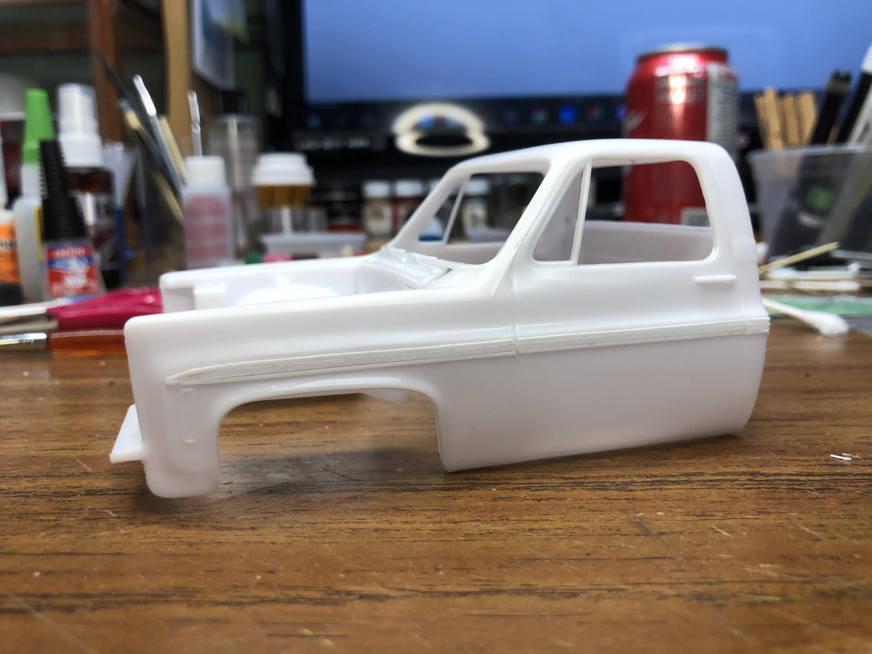

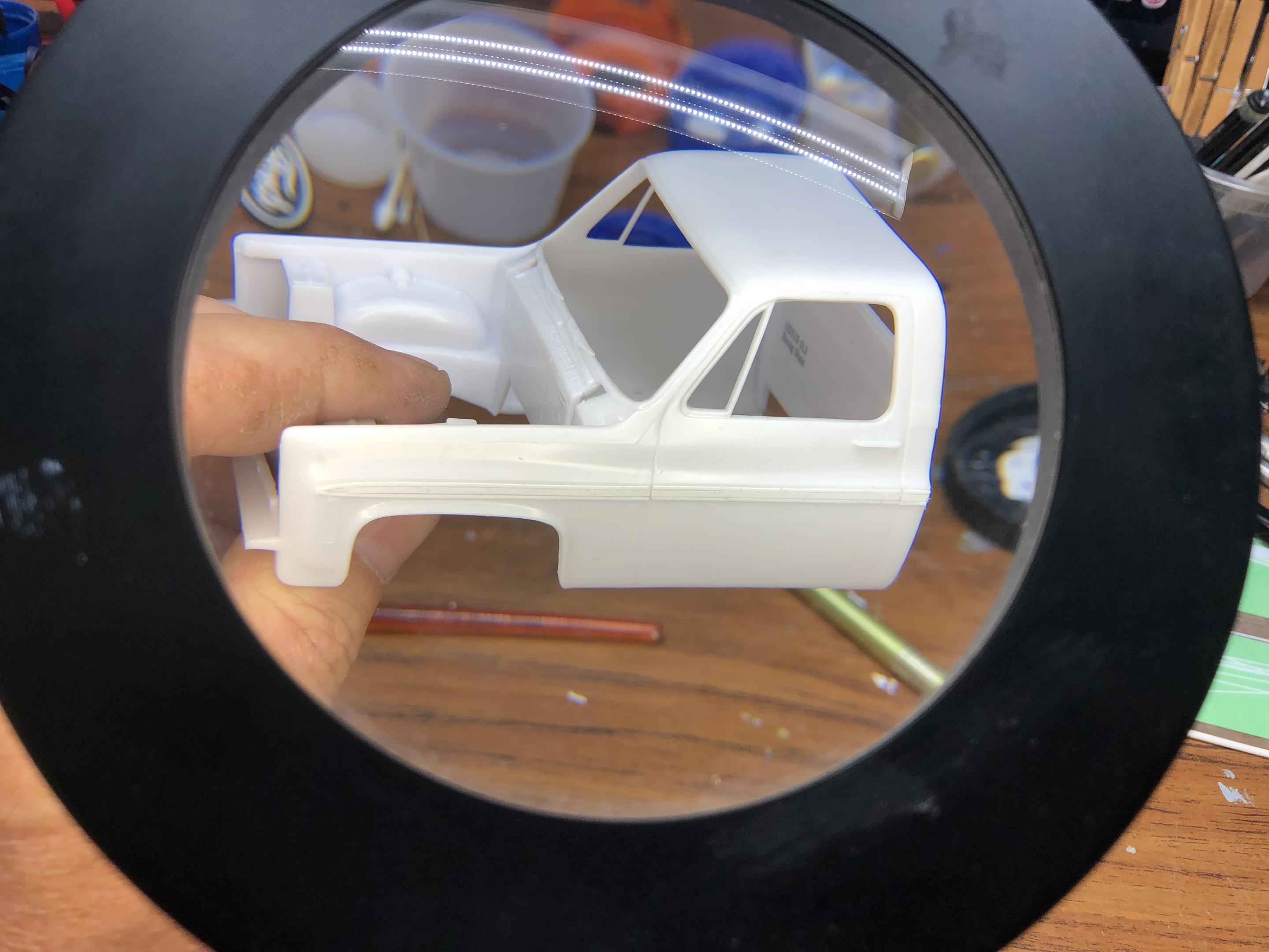

SCRWDRVR Posted August 28, 2021 Author Posted August 28, 2021 I gave it a try today, what do you all think
ZTony8 Posted August 28, 2021 Posted August 28, 2021 I think the pointed tip of the fender molding is closer to the front vertical edge of the marker lamp. Trim the back edge of your piece and line up the point with the front of the marker lamp.
SCRWDRVR Posted August 28, 2021 Author Posted August 28, 2021 17 minutes ago, ZTony8 said: I think the pointed tip of the fender molding is closer to the front vertical edge of the marker lamp. Trim the back edge of your piece and line up the point with the front of the marker lamp. Got ya, yeah looks like I did go a touch to far forward...
slusher Posted August 31, 2021 Posted August 31, 2021 On 8/28/2021 at 3:26 PM, espo said: Looks good with ZTony8's suggestion. true your very close. You did a pretty nice job. Did you you glue it down all the way..?
SCRWDRVR Posted August 31, 2021 Author Posted August 31, 2021 9 hours ago, slusher said: true your very close. You did a pretty nice job. Did you you glue it down all the way..? Thanks, I glued it down with white glue and I’m hoping the paint will lock it down….

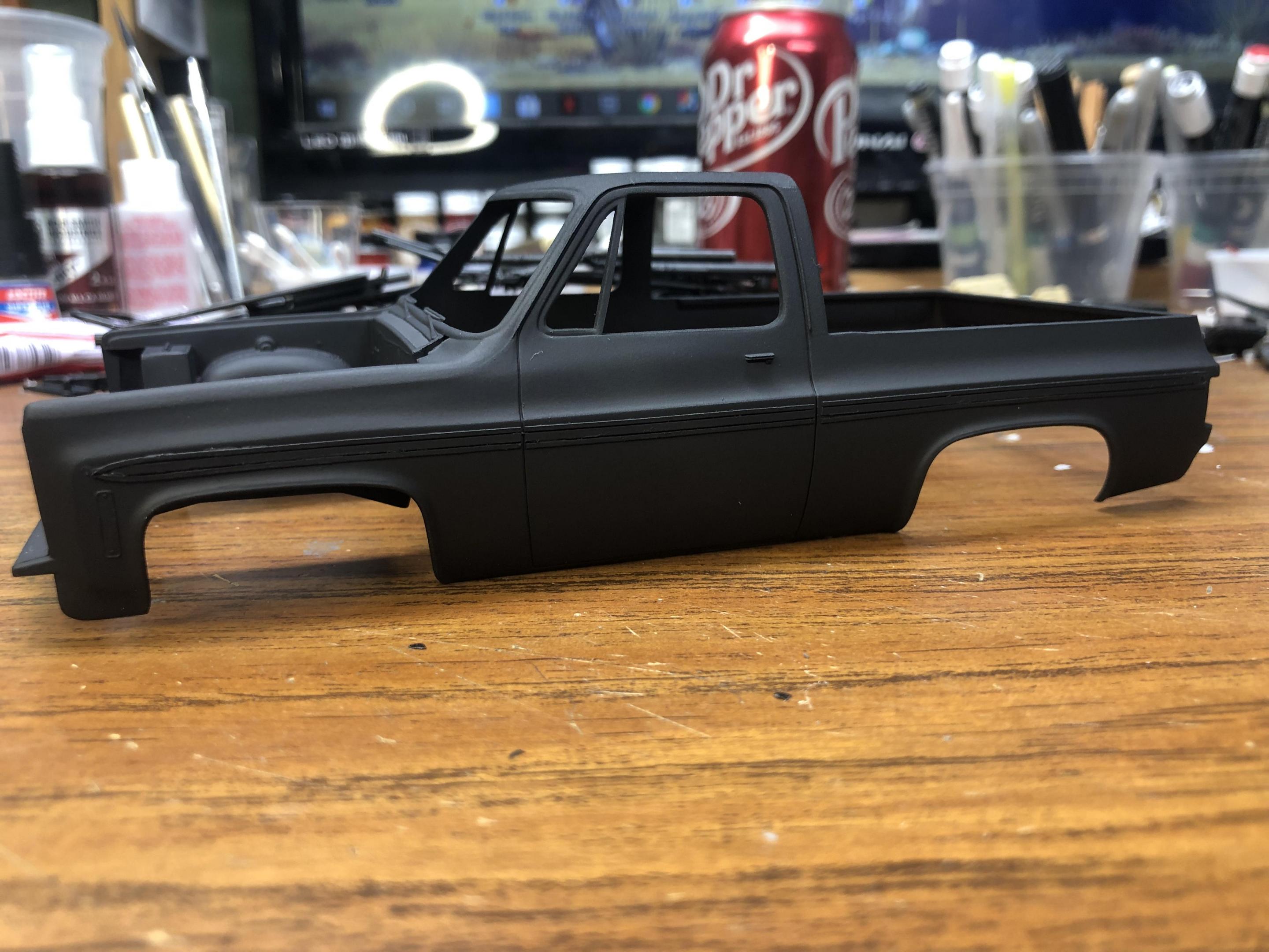

SCRWDRVR Posted September 7, 2021 Author Posted September 7, 2021 Ok I have the molding done and primed on the Blazer, I’m figuring cover it with BMF and painting the center semi gloss. What do you all think?
espo Posted September 8, 2021 Posted September 8, 2021 The picture is a little dark to see all of the detail, but what I see looks good. A thought on the molding painting. You mention painting the moldings and I think the semi gloss Black would be the most ideal finish for that. The outer edges of the moldings would be a chrome type finish. Would it be easier for you to paint the center of the molding and then go over the molding with chrome foil and cut away the center, or try a liquid chrome treatment for the outer edges ? Should you go with the foil option think about just doing one body panel at a time. Being right handed I usually would start with the left front fender, then the door, and then the bed side. Part of this is to keep the door edge detail and less chance of the foil bunching up and getting any wrinkles I have found.
SCRWDRVR Posted September 8, 2021 Author Posted September 8, 2021 2 hours ago, espo said: The picture is a little dark to see all of the detail, but what I see looks good. A thought on the molding painting. You mention painting the moldings and I think the semi gloss Black would be the most ideal finish for that. The outer edges of the moldings would be a chrome type finish. Would it be easier for you to paint the center of the molding and then go over the molding with chrome foil and cut away the center, or try a liquid chrome treatment for the outer edges ? Should you go with the foil option think about just doing one body panel at a time. Being right handed I usually would start with the left front fender, then the door, and then the bed side. Part of this is to keep the door edge detail and less chance of the foil bunching up and getting any wrinkles I have found. I think the foil (BMF) is definitely the way to go for the outside chrome, My hopes by foiling over the whole thing is to lose some of the depth of the transition between the outer part and the center since on the 1:1 it is not very deep. I did separate the molding per panel so I agree doing each panel at a time will be best.
