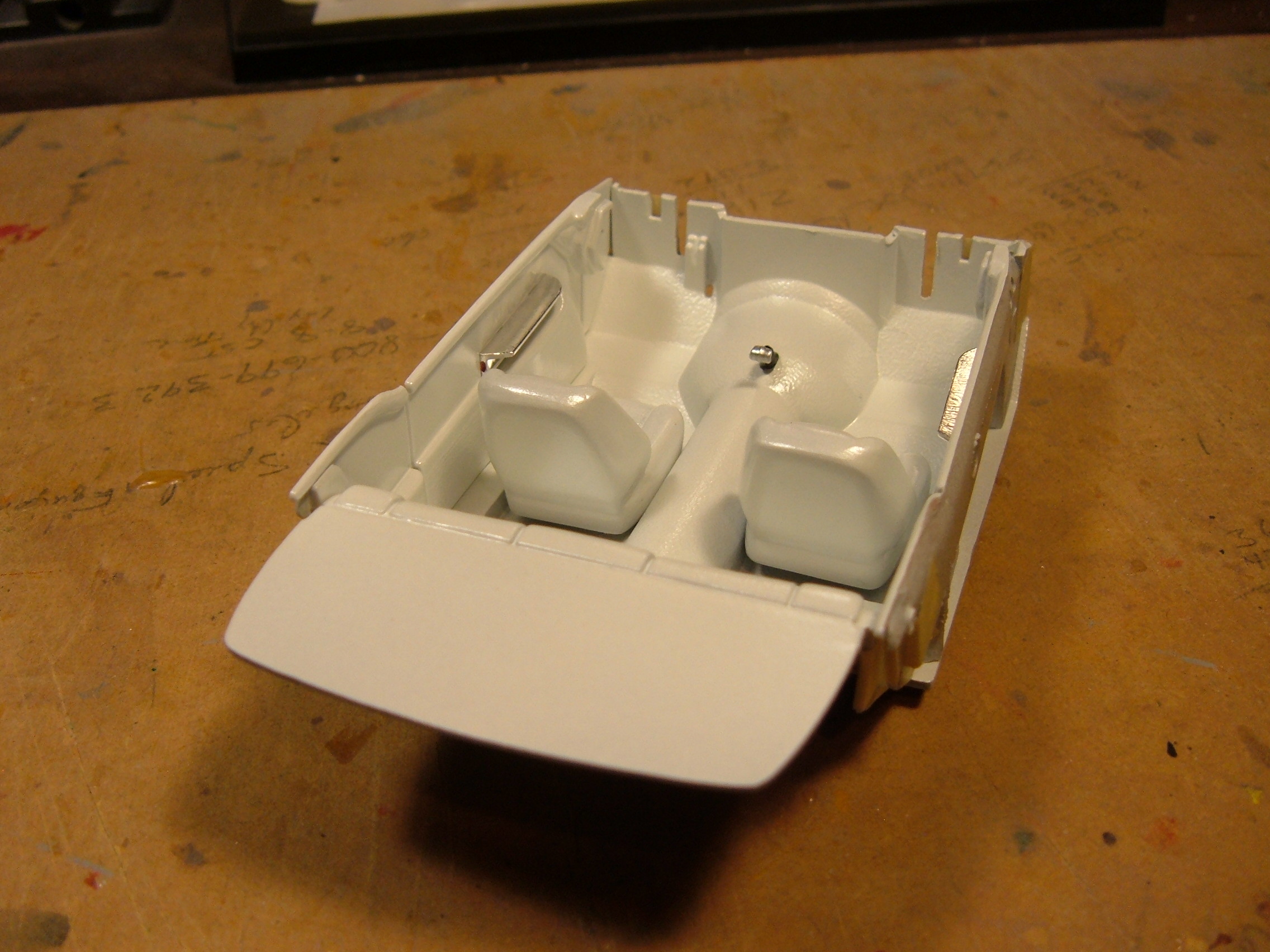

carbuilder1950 Posted August 11, 2021 Posted August 11, 2021 (edited) This was one of those cars I wanted to do a few things I hadn't done before, so on this IMEX Caddy Eldorado Biarritz kit, I cut the front fender chrome spears from the body, and also cut the large rear moldings/wheel opening chrome, from behind the rear tires, and removed the front wheel well trim from the body, and sent them to a chromer to be plated. While those parts were gone, I took the roof off a Revell Chezoom kit and fitted it on the caddy body, and beings that the Chezoom was a "Full builder kit" with interior, I also modified the interior to make it fit in the caddy body. The hood wasn't long enough for me, so I stretched it a bit, and hinged it, so the under hood would work for me. The front fenders and doors, from the headlights to the sweetheart dip, needed to be rounded like Cheezoom, so some body filler took care of that, along with stretching the doors to the dip , and reshaping the rear of the door line, rounding it a bit and angling it back, and the tail lights were moved from the body to the bumper. Next, I mixed up a custom urethane peach pearl, and after prepping the body with urethane primer, gave her some color and then several coats of clear, before rubbing her out, and then put her all together. Edited August 11, 2021 by carbuilder1950 3 1
