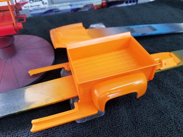

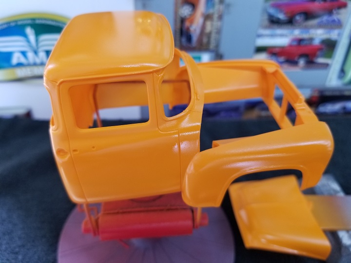

Zippi Posted August 15, 2021 Posted August 15, 2021 (edited) I saw a video of a fellow (Dave G.) airbrushing Testors thinned with lacquer thinner at 50/50 and the outcome looked pretty good. I thought I would give it a go this morning. The subject body is the Revell 1956 Ford pickup. I bough a bottle of the Testors Gloss Tangerine and thinned it with the Sunnside lacquer thinner that I keep on hand. I did not prime the body and this is a first for me. Air pressure was set at 35 psi running through my Paasche H airbrush. By the time I got done with 4 coats of paint I had used the whole bottle. Except for some trash in the paint (I paint outside) it came out pretty good but not as good as Dave G. red that he airbrushed. Edited August 15, 2021 by Zippi 1
Dave G. Posted August 15, 2021 Posted August 15, 2021 Not much time right now, I have a couple thoughts. But that finish should polish right up after a couple applications with something like Formula 1 Scratch Out. I was going to suggest getting two bottles lol !! I'll be back,others might chime in meanwhile.

AMT68 Posted August 16, 2021 Posted August 16, 2021 Color and shine look great Bob and I didn't realize lacquer thinner was used to cut enamel paint. But then I've never airbrushed either.
DPNM Posted August 16, 2021 Posted August 16, 2021 Doesn't look real bad. A good buff should do it. Just a suggestion, if you raise the bed and hood inside the tub you could put something under the tub edges to raise it up a bit for airflow. You could leave the painted parts in there so you don't get more debris falling on your paint job.

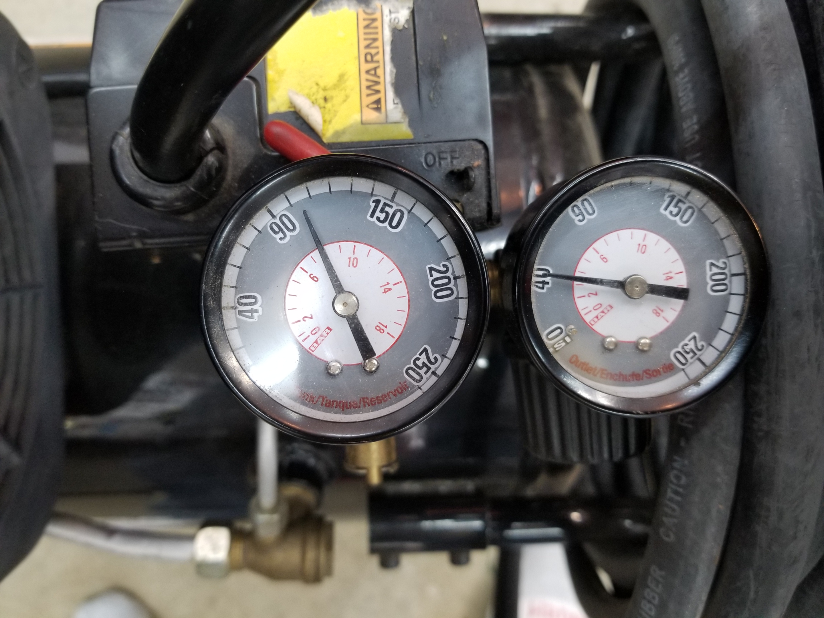

Dave G. Posted August 16, 2021 Posted August 16, 2021 Depending on the paint viscosity, the day etc. I put down the last two coats pretty wet. I don't so much change my shooting distance as open up a bit more and slow the passes down. I hand hold the body on a mount of one sort or another and always shoot down onto it, not to the side. So the roof faces up when I shoot, the left side faces up when I shoot and the right side faces up when I shoot and each end faced up when I shoot. Doesn't have to be perfectly up but the brush should be shooting down on it in a general way rather than shooting a horizontal surface. Another thing is the compressor. The Paasche H flows that true 35 psi but not all compressors keep up to that. Many airbrushes today restrict air to 20 some odd psi, you can set the compressor to 50 psi but the airbrush itself won't flow it but the H will. You need to watch your working pressure, that's what the gauge reads with air flowing through the brush. That said I shoot enamel 32-33 psi working pressure anyway personally,least at the thinning ratio we are talking about. If there is a good pattern coming out it will go down fine. If it needs more I crank it up some more but my compressor will flow 4.5 cfm at 45 psi or 3.5 at 90. Most hobby compressors won't flow that at any pressure setting. Point being I don't worry about it. I don't pamper it, I just blast it on lol. There is a rhythm to the passes, once in the groove just keep going. Black can be tricky, pick a nice day. And practice, get a few bottles, you don't want to run out mid spray. When Model Master stopped producing classic black I was bummed, had it perfected. I havn't shot the regular enamel in decades. But I have Tamiya X-1 going down pretty glassy. Just a light buff is all. Did 1/16 model A fenders in that last fall and came out awesome. Then the wife died and I've only worked on the kit half heartedly since. Just getting back to functioning a little more normal now but 47 years with someone you love who up and croaks one night is a real shall we say stirring upset.
bbowser Posted August 16, 2021 Posted August 16, 2021 Dave, some great information here, thanks for sharing. My condolences on your loss. 1
Zippi Posted August 16, 2021 Author Posted August 16, 2021 Thanks once again Dave. Sorry to here about you wife's passing. Here is the air compressor I use. I set the pressure at 40psi and once I hit the button on the H it drops to a 35psi working pressure and holds it there. 1
Dave G. Posted August 16, 2021 Posted August 16, 2021 11 minutes ago, Zippi said: Thanks once again Dave. Sorry to here about you wife's passing. Here is the air compressor I use. I set the pressure at 40psi and once I hit the button on the H it drops to a 35psi working pressure and holds it there. That compressor looks to be pretty close to mine lol !
