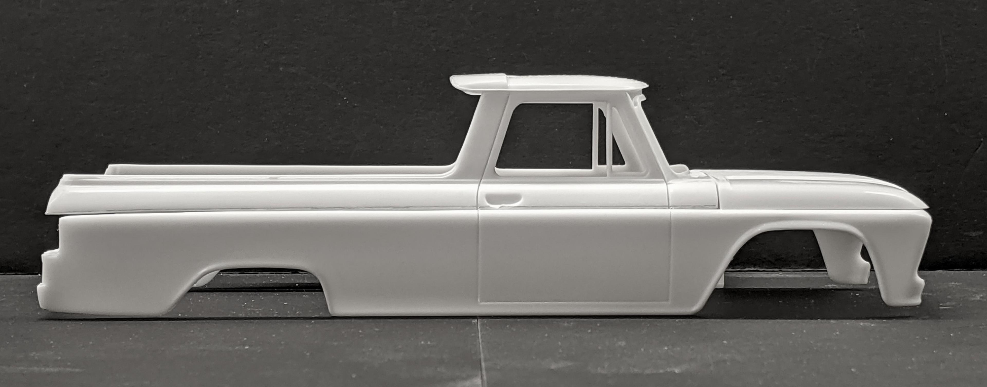

I considered that early on, but though it would make the body area above the rear wheel arches too thin looking. I wanted less visual mass, but didn't want to remove too much:
I had an idea for the rear end of the truck I was sure was going to look great...until after I cut the top corners free and it became clear it was not, in fact, going to look good...so I glued them back into place:

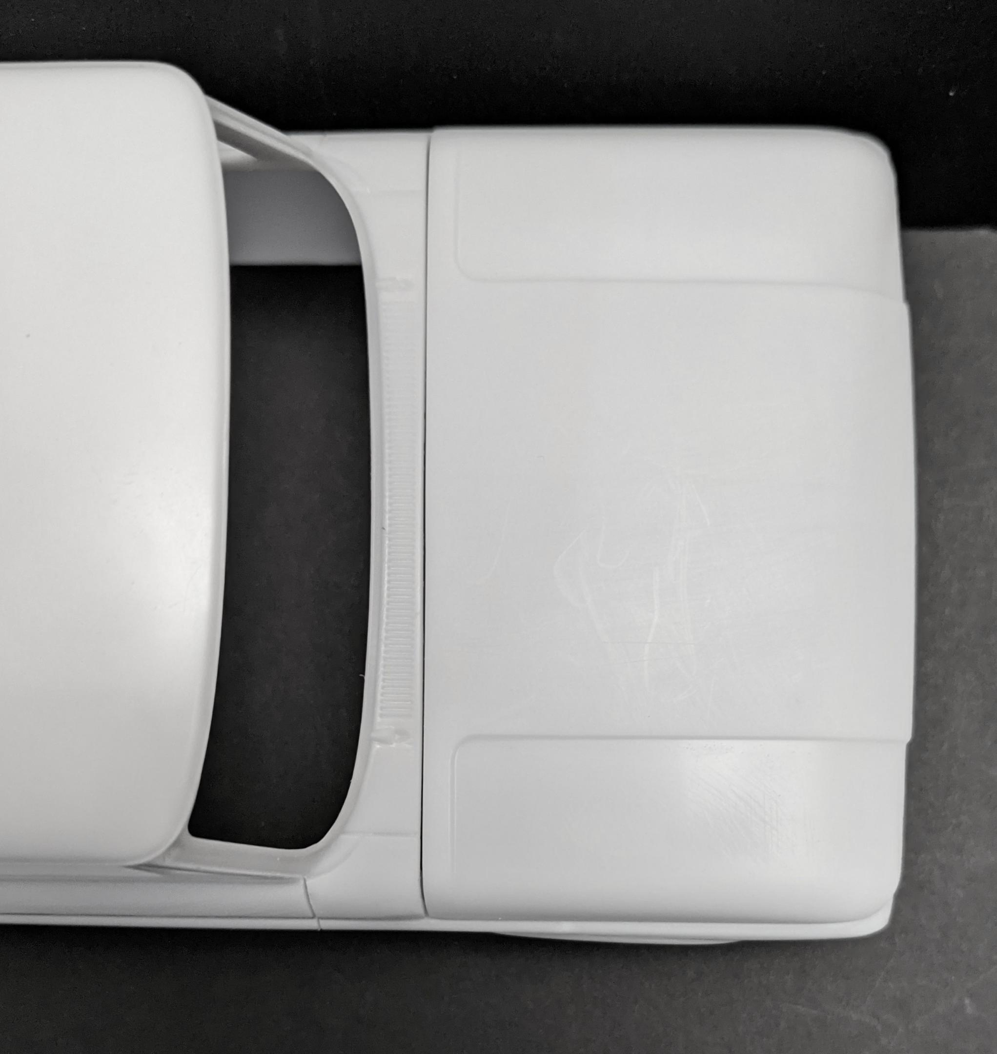

I did get some sanding done on the leading edge of the hood, but there's still some fine tuning to do. The front-to-back length is correct now, but some edges on both the hood and header panel need to be redefined and evened, too:

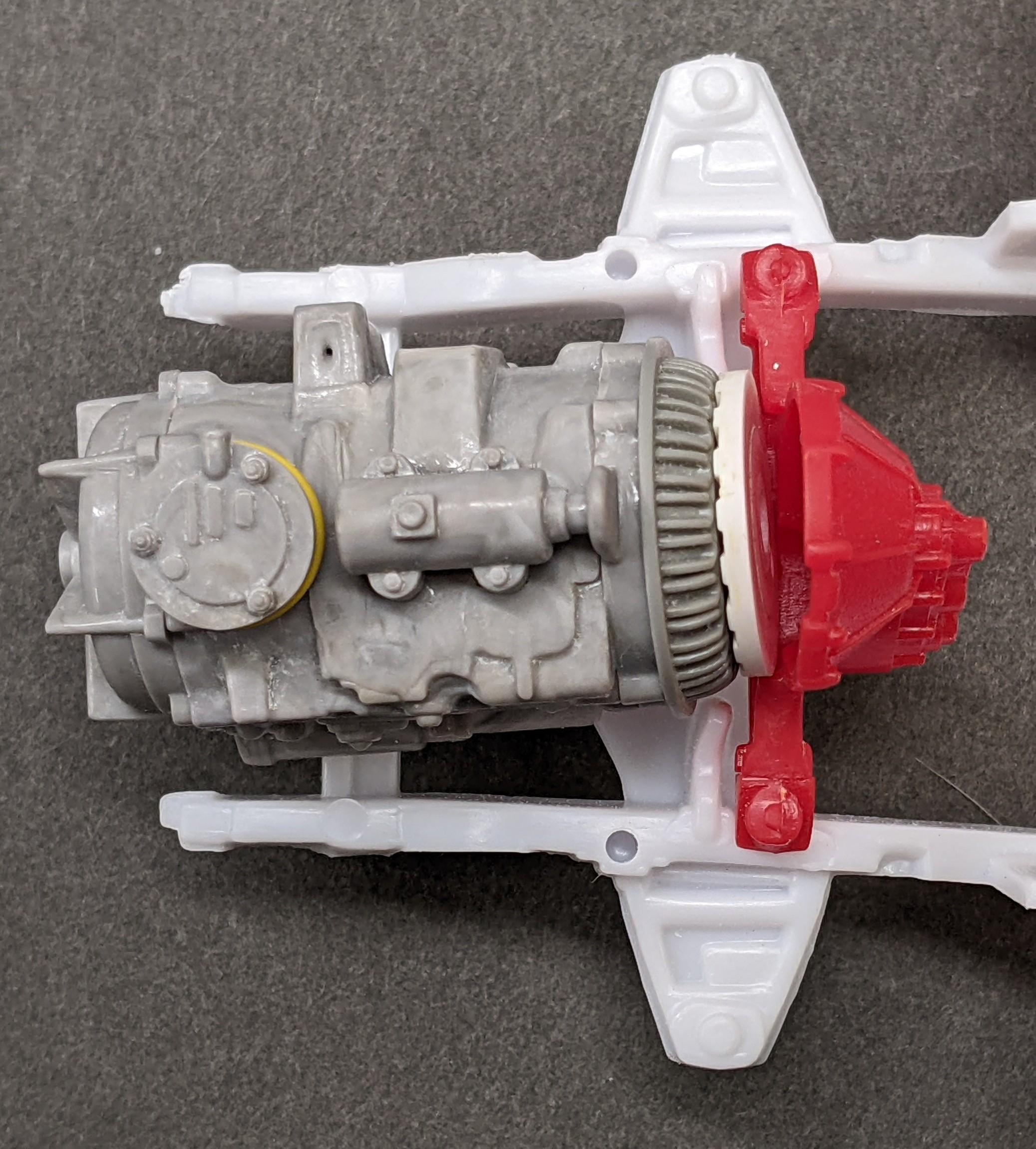

I purchased a 1/25 Revell "Dream Car" turbine engine kit a few weeks ago, with the hope of installing it in this truck, so I stripped the engine parts' chrome plating, assembled some pieces, and generally tidied things up. I will not be building the turbine engine as it comes-- creative liberties will be taken, but I will try to keep things believable for the most part. Here's where the engine is at so far, with the first image also containing a '60s Chevy I6 for comparison:
Below, the exhaust pipe and flange are (almost) resting against the engine, and are not yet attached:
Very loose test fit of the red bellhousing/mount on the '66's stock frame:
