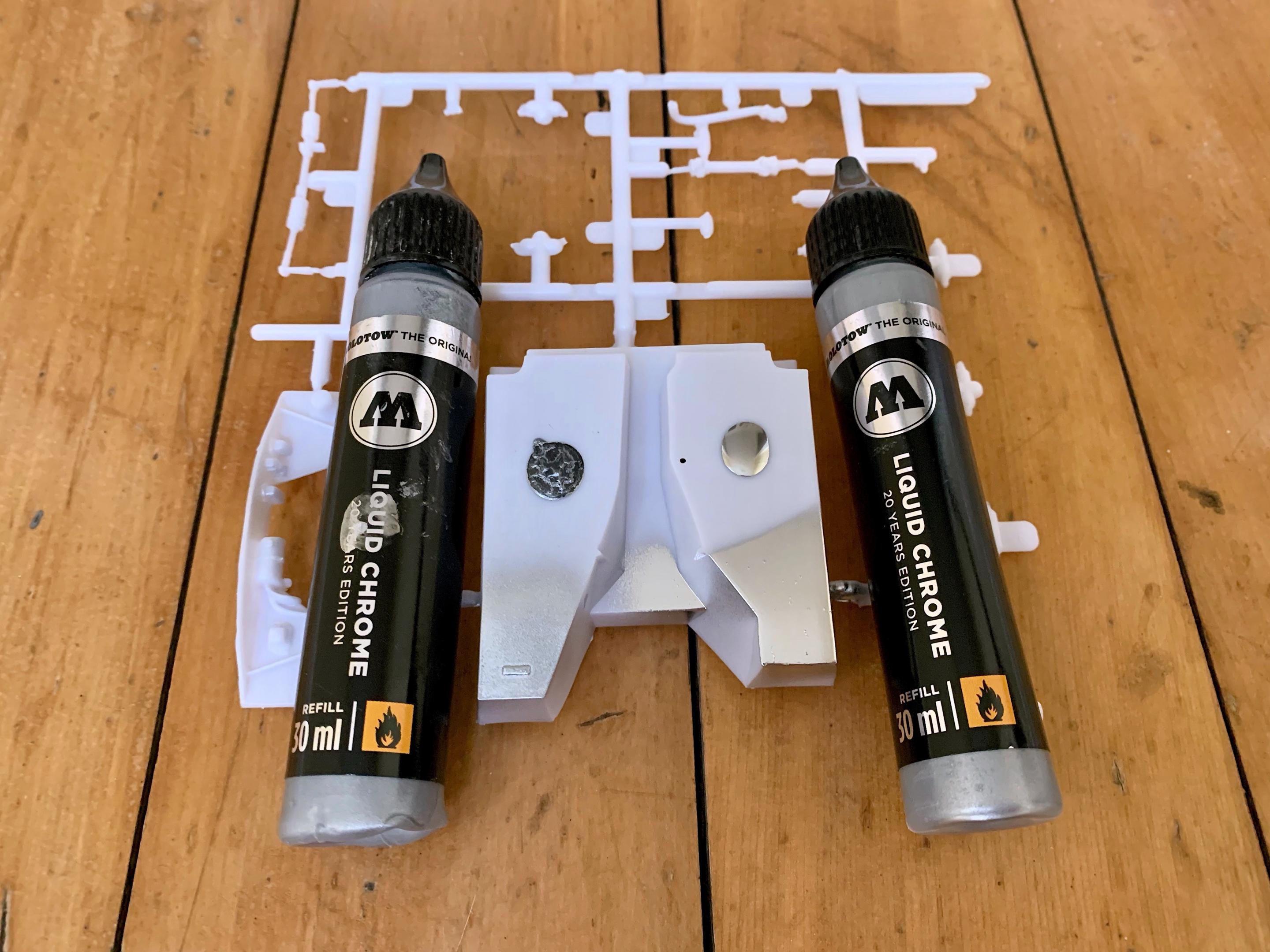

Roncla Posted August 21, 2021 Posted August 21, 2021 Molotow going off has occurred to others on this board and I've experienced it myself. I had bought both of these refills together about 18 months ago and while the one to the right had never been opened the left one had been partly used and has turned to a gunmetal grey.
Quintillus Posted August 21, 2021 Author Posted August 21, 2021 (edited) 20 hours ago, kruleworld said: No. period Not a ringing endorsement for the markerszone markers! 15 hours ago, Fat Brian said: There is something in the pens that is part of the chrome reaction that evaporates out and ruins them. Both pens I bought were useless in a couple months but the refill is still as good as day one after two years. I just put a drop or two in a water bottle lid and apply it with a brush or toothpick. The "magic chemical has evaporated" was my working theory, since I had tried near everything else. If I crack open my next pen and get good results, I may immediately dump the ink into an empty paint bottle in hopes of prolonging it's usefulness. 2 hours ago, Roncla said: Molotow going off has occurred to others on this board and I've experienced it myself. I had bought both of these refills together about 18 months ago and while the one to the right had never been opened the left one had been partly used and has turned to a gunmetal grey. Thanks for the crystal clear comparison! I searched but only found one other reference to Molotow turning gunmetal gray. It's not even very good at that- it turns splotchy! THANKS EVERYONE FOR YOUR RESPONSES! Edited August 21, 2021 by Quintillus Weird quoting stuff
