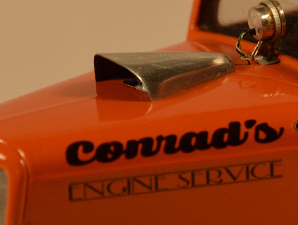

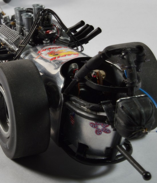

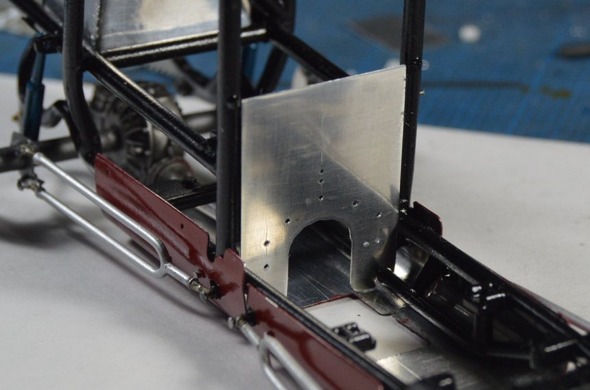

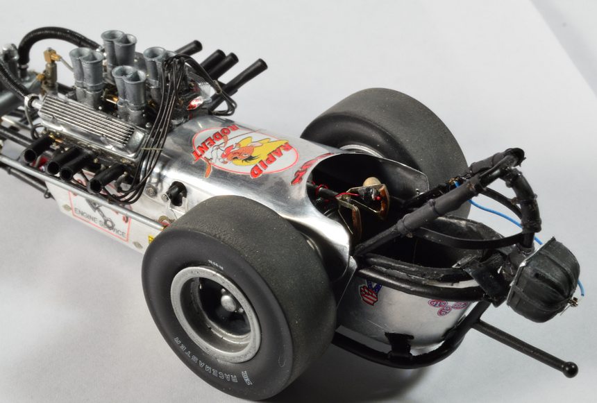

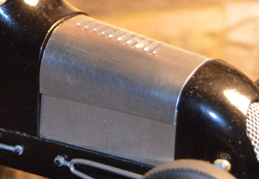

Straightliner59 Posted August 24, 2021 Posted August 24, 2021 I use aluminum flashing for most of my sheet work... 1
