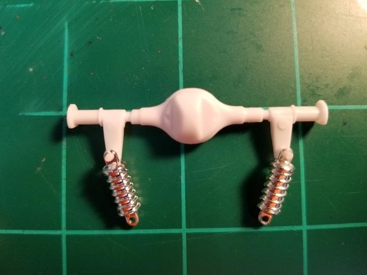

Zippi Posted August 31, 2021 Author Posted August 31, 2021 This is the look I'm going for. Nice and clean.

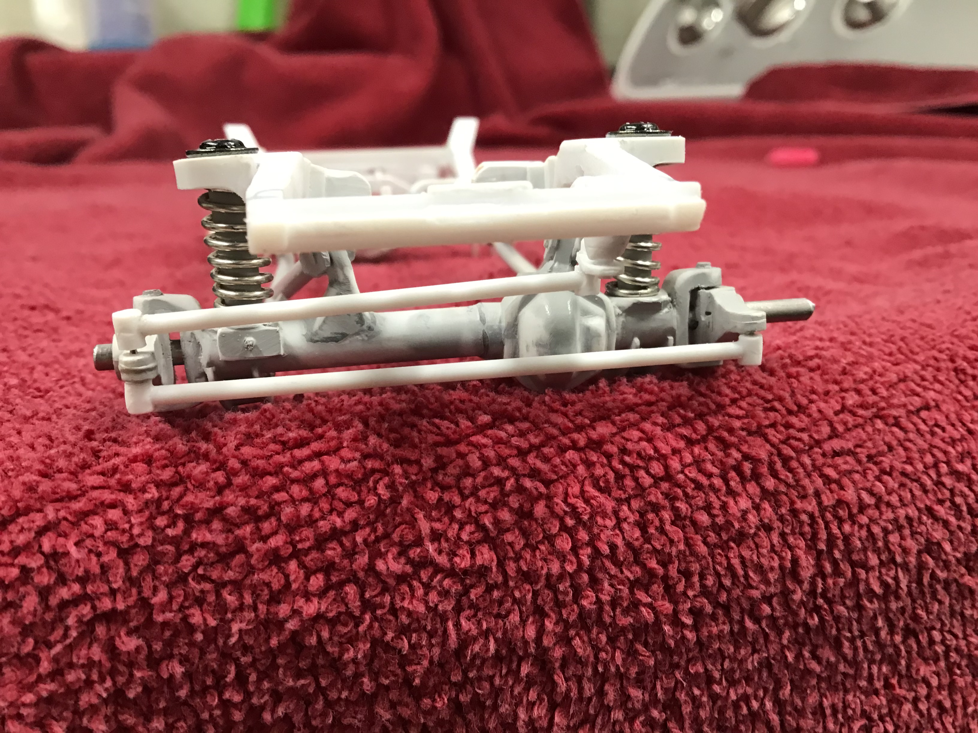

Zippi Posted August 31, 2021 Author Posted August 31, 2021 I came up with a solution that looks ok. 1
Zippi Posted August 31, 2021 Author Posted August 31, 2021 I couldn't have seen the shock well enough without the use of my headset magnifying glass. This headset get used a lot and was well worth the money. 1

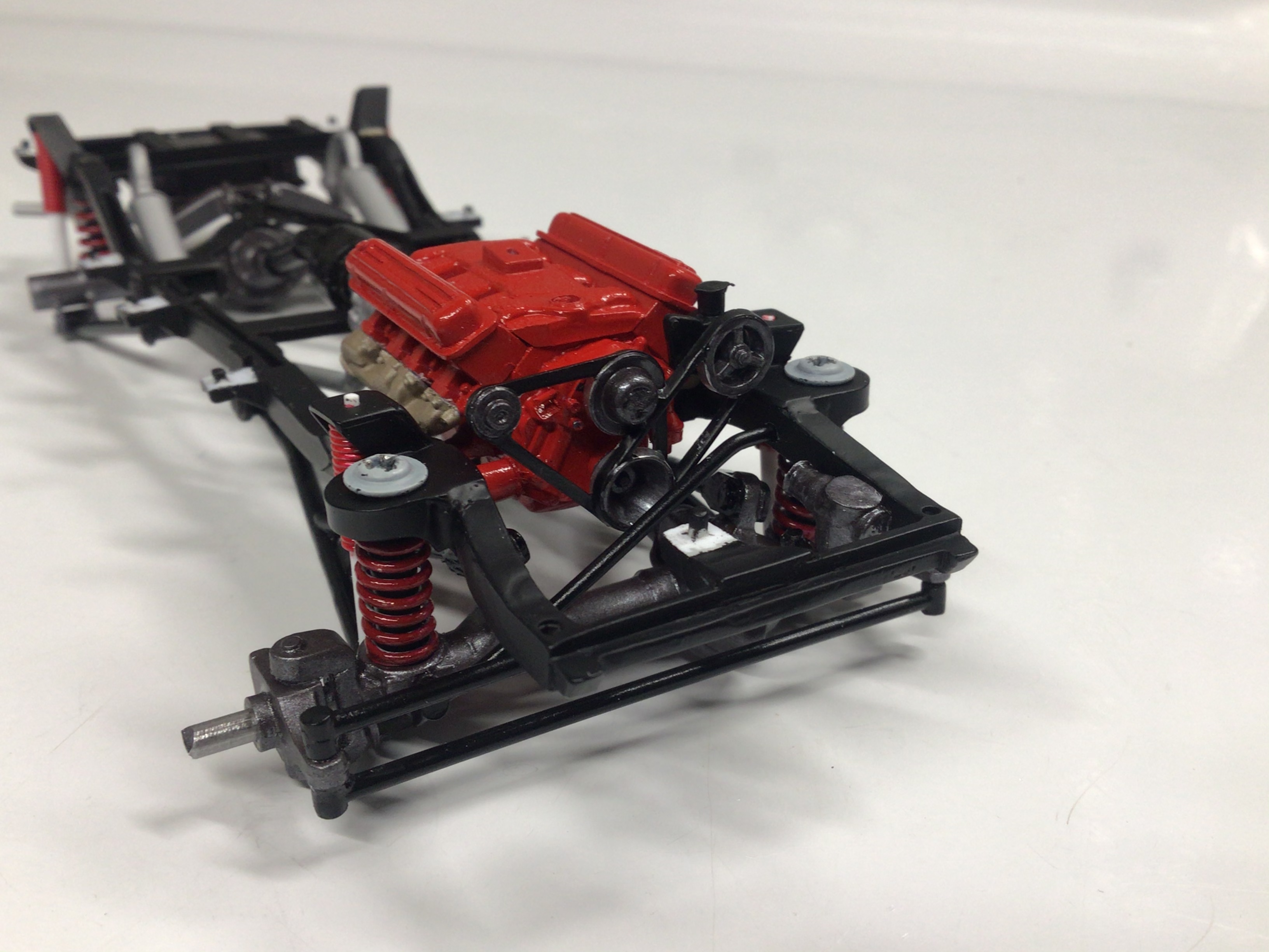

NOBLNG Posted August 31, 2021 Posted August 31, 2021 I just painted the valleys and cleaned up a bit with a Q-tip if needed. I have also used real springs. 1
Casey Posted August 31, 2021 Posted August 31, 2021 1 hour ago, NOBLNG said: I have also used real springs. This, but more specifically, use a metal wire to make your own springs instead of trying to source a matching pair from something existing. Use the correct gauge metal wire in a softer, more malleable material than steel, then wrap the wire around a machine bolt of the correct thread pitch and diameter. This also eliminates the need to sand the mold seam off of every coil spring loop on the kit part, which most people don't do, and which also sticks out like a sore thumb after you paint the recess black. Yes, you'll nee to make your own shock body and perches to fit inside the coil spring. 1
Zippi Posted August 31, 2021 Author Posted August 31, 2021 2 minutes ago, Casey said: This, but more specifically, use a metal wire to make your own springs instead of trying to source a matching pair from something existing. Use the correct gauge metal wire in a softer, more malleable material than steel, then wrap the wire around a machine bolt of the correct thread pitch and diameter. This also eliminates the need to sand the mold seam off of every coil spring loop on the kit part, which most people don't do, and which also sticks out like a sore thumb after you paint the recess black. Yes, you'll nee to make your own shock body and perches to fit inside the coil spring. Thanks for the info on making coilovers. Ill keep that in mind about the solder.
jchrisf Posted August 31, 2021 Posted August 31, 2021 (edited) I like what Clay does here at 3:04 with a wash over the painted shocks. Edited August 31, 2021 by jchrisf
NOBLNG Posted August 31, 2021 Posted August 31, 2021 (edited) 2 hours ago, Casey said: This, but more specifically, use a metal wire to make your own springs instead of trying to source a matching pair from something existing. Use the correct gauge metal wire in a softer, more malleable material than steel, then wrap the wire around a machine bolt of the correct thread pitch and diameter. This also eliminates the need to sand the mold seam off of every coil spring loop on the kit part, which most people don't do, and which also sticks out like a sore thumb after you paint the recess black. Yes, you'll nee to make your own shock body and perches to fit inside the coil spring. Yes. I don’t know why I posted that pic. I did make my own for the TJeepster from soft aluminum wire. Copper or aluminum would work nice and still hold it’s shape. I wrap thin wire around styrene rod to make shock boots also. Edited September 1, 2021 by NOBLNG
