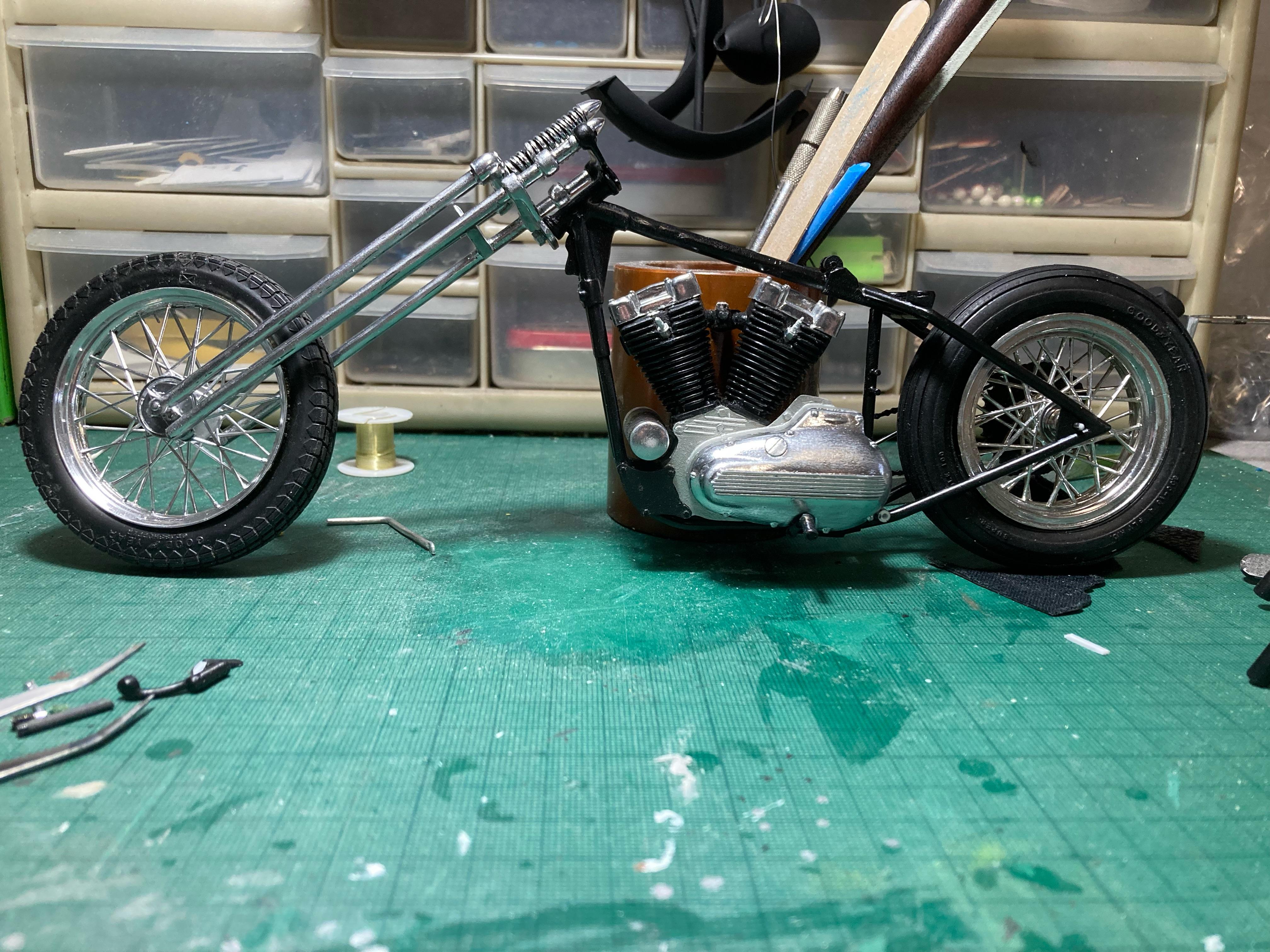

I started with a Thunder Chopper glue bomb I got a NNL East a while back when I lived in New Jersey. After removing all the parts and cleaning off the glue I cut the frame and added a scratchbuilt hardtail frame. I also cut off the neck and raked it to the proper angle.

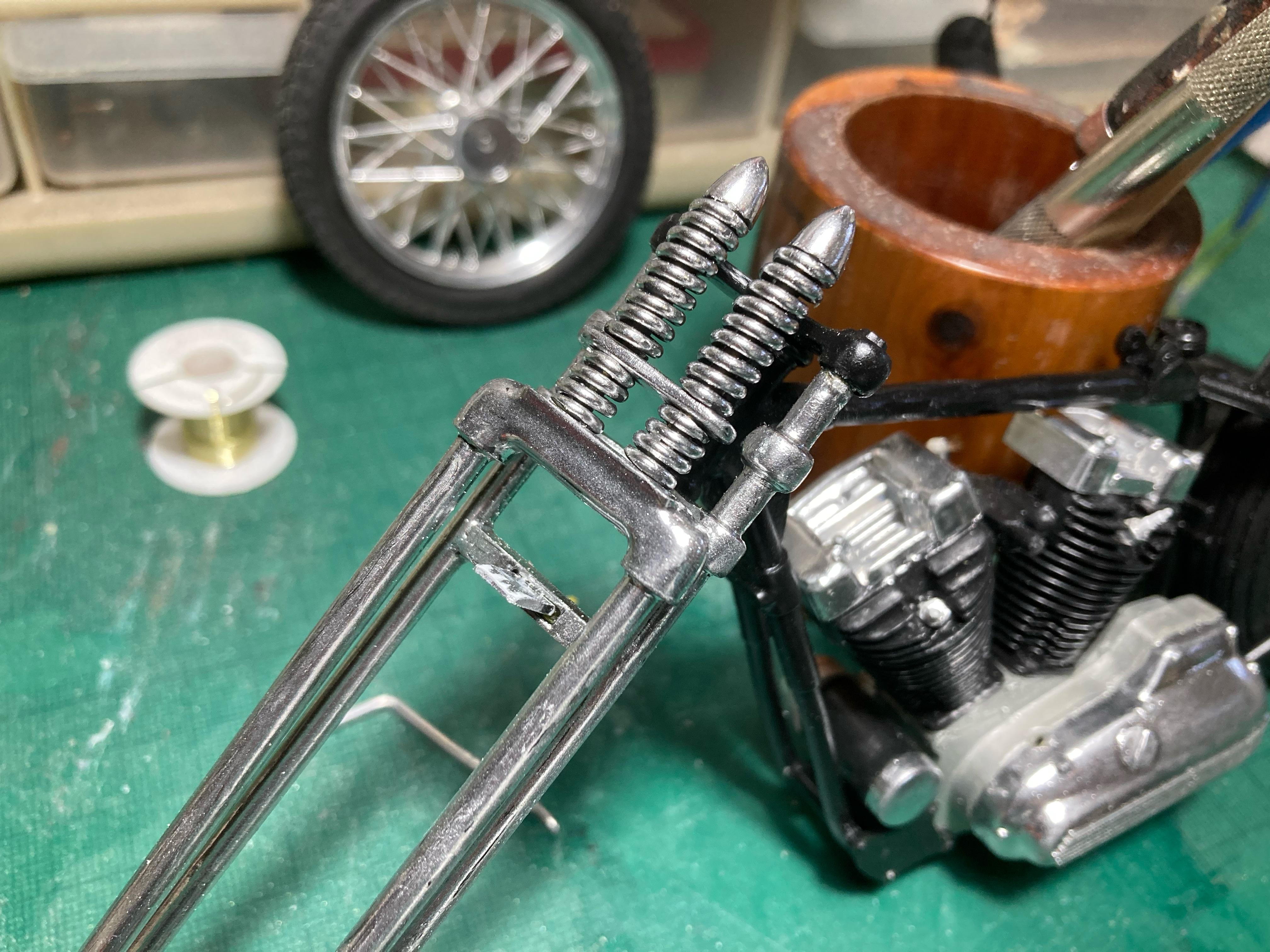

I took apart the forks and never liked the springer part. It just looks to be the wrong scale. So I cleaned up the forks and shortened them. I also removed the springs and made my own. To make the springs I have several sizes of wood screws. I choose the correct scale of screw thread and find the correct scale aluminum wire and wrap the wire around the screw threads. After getting the correct amount of coils I cut the wire and separate the coils with the back of my Exacto knife.
For the fenders I used a nightlight I got from the dollar store years ago. I actually bought about 7 of them as I use them for other projects. The radius is a bit large so I cut the side of the curve off on both sides and its thin enough to bend to the correct radius. I add a slice of evergreen stock to the middle and round off the top with putty. Then I cut it to fit the tire. I’m not sure I want the front wheel with the drum brake, I may not want any front brake.
I couldn’t find a premade gas tank and the one that comes with the kit wasn’t what I was looking for. I ended up taking two of the same tanks from the motorcycle parts box and glued them together. The parts box ones had flat bottoms and I wanted a curved bottom (nothing wrong with a curved bottom!).
For the handlebars I used wire solder and form it using a trace of the bends. I used the correct size tubing for the hand grips. I cut off a hand control from a handgrip from the parts box and drilled a small hole in the end of the handle to insert the cable wire when the time comes. I glued it to the grip.
I didn’t want use the oil tank that came with the kit as I didn’t like the shape for the chopper look. I took the big mufflers from the kit and altered them to create the oil tank.

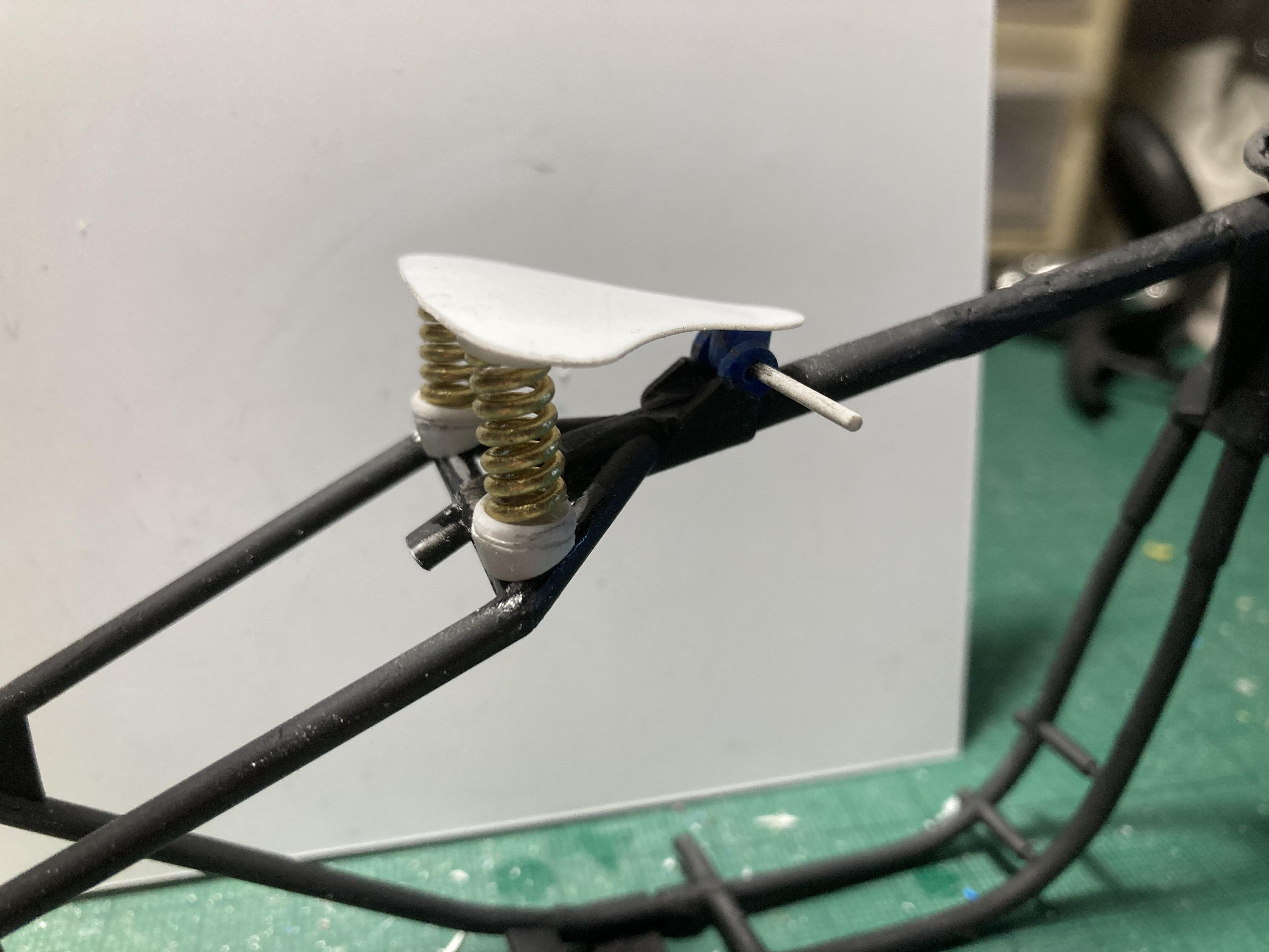

I started working on the seat. The springs are made and now I will form it pad it and cover it.

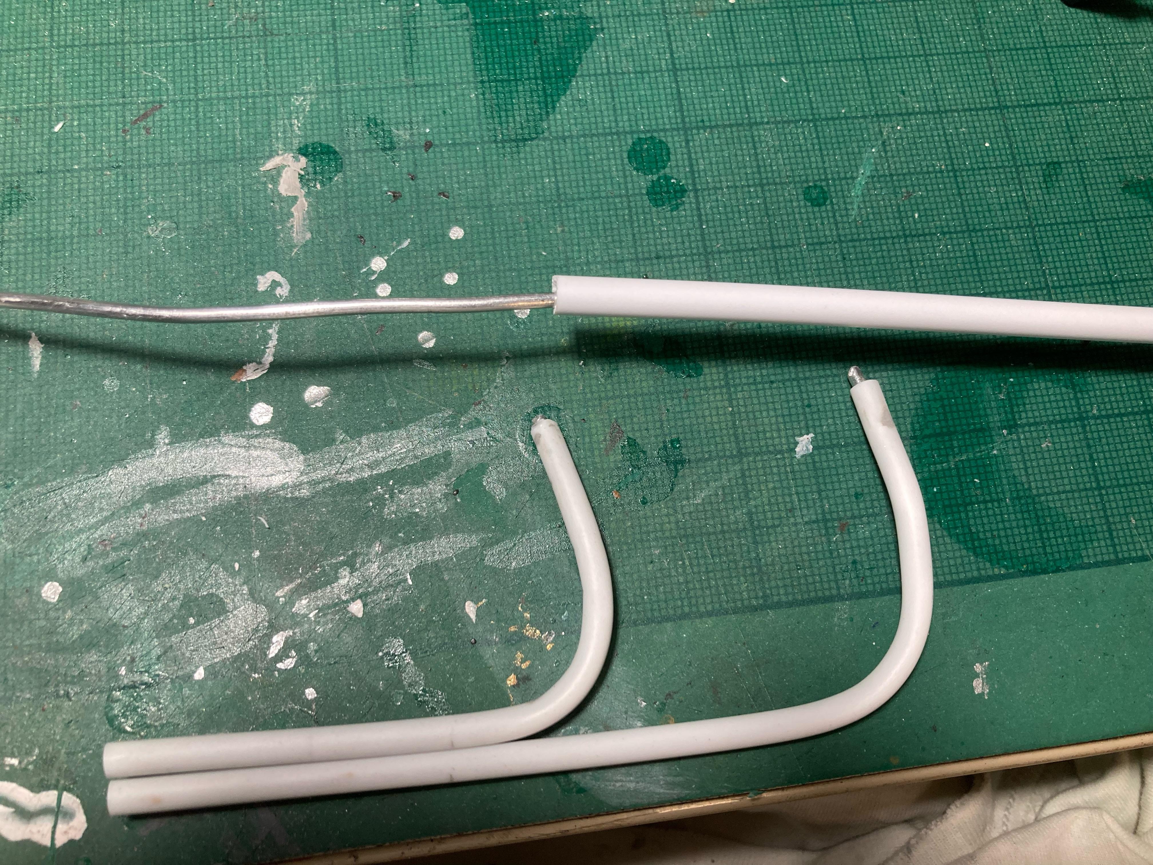

Did a bit more work on this project.
I made exhaust pipes from inserting an aluminum piece of wire into a plastic tubing and bending it to fit. I left an end of the wire sticking out of the tube to be able to connect to the cylinder after drilling a hole in the cylinder.
I finished the front forks and springs and chromed them.
