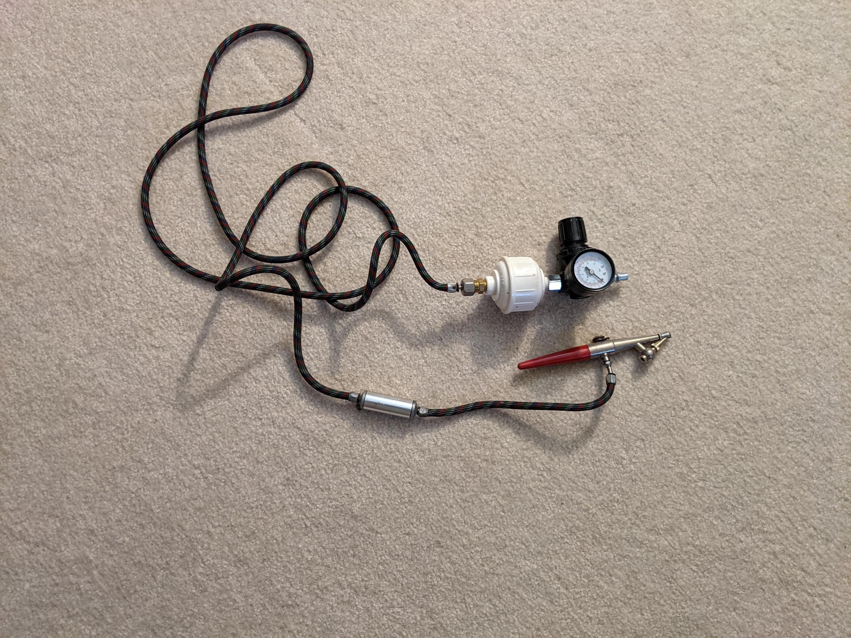

Rodent Posted September 11, 2021 Posted September 11, 2021 Here is my c.1980 H, its original cloth-covered hose, and the water trap that the friend at the hobby shop made me buy at the time. The rest is a filter, regulator, and fittings from an auto parts shop to allow me to attach it to the hose on my garage compressor and dial the pressure back. Opening up a whole 'nother can of worms here, but IMHO you can't paint a semi-trailer or anything large with an H3 needle setup. Discussion welcome.

robdebie Posted September 11, 2021 Posted September 11, 2021 2 minutes ago, Rodent said: Opening up a whole 'nother can of worms here, but IMHO you can't paint a semi-trailer or anything large with an H3 needle setup. Discussion welcome. I've been working with my new Paasche H for just a few weeks, but I would not hesitate to use it for something large. In fact it would be my clear first choice from a total of four air brushes (Badger 200 and 150, Iwata HP-CS and Paasche H). But maybe you're saying you would use the H5 needle? It came with the set I bought, but I haven't tried it - I'm still getting used to working with the H3 needle. One thing I don't like so much is that the turning part of the needle set has no markings to show how much you opened it. As an interim solution I painted two stripes on it. For the Donn Yost method, I use -0.8 turns while applying a color coats, and then ~1.5 turns for the wet gloss coats. Rob

Rodent Posted September 11, 2021 Posted September 11, 2021 Just now, robdebie said: But maybe you're saying you would use the H5 needle? It came with the set I bought, but I haven't tried it - I'm still getting used to working with the H3 needle. Yes, this. My original H3 stuff had been dropped a few too many times. Someone on the Scale Auto board suggested that I buy H5 replacement parts and I did. IMHO they work better overall than the H3 on larger parts, even 1:24/25 bodies. As always, what works for me in California won't always work for folks in New Jersey, Alberta, Netherlands, Brazil, Hawaii, or even Oklahoma.
