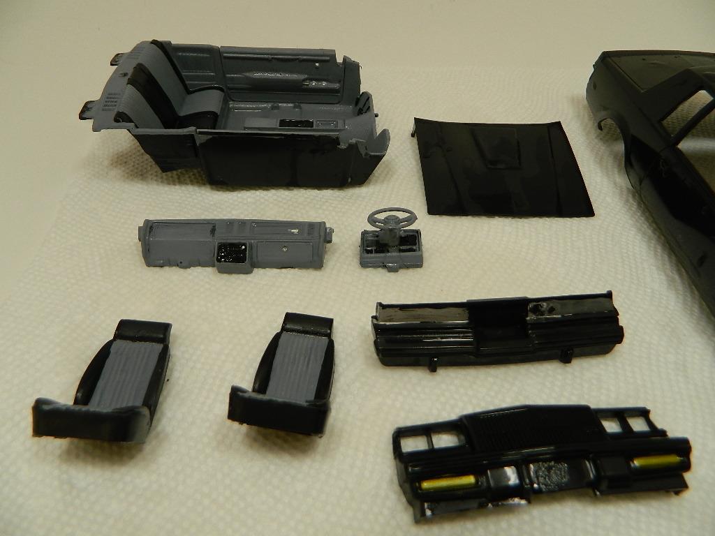

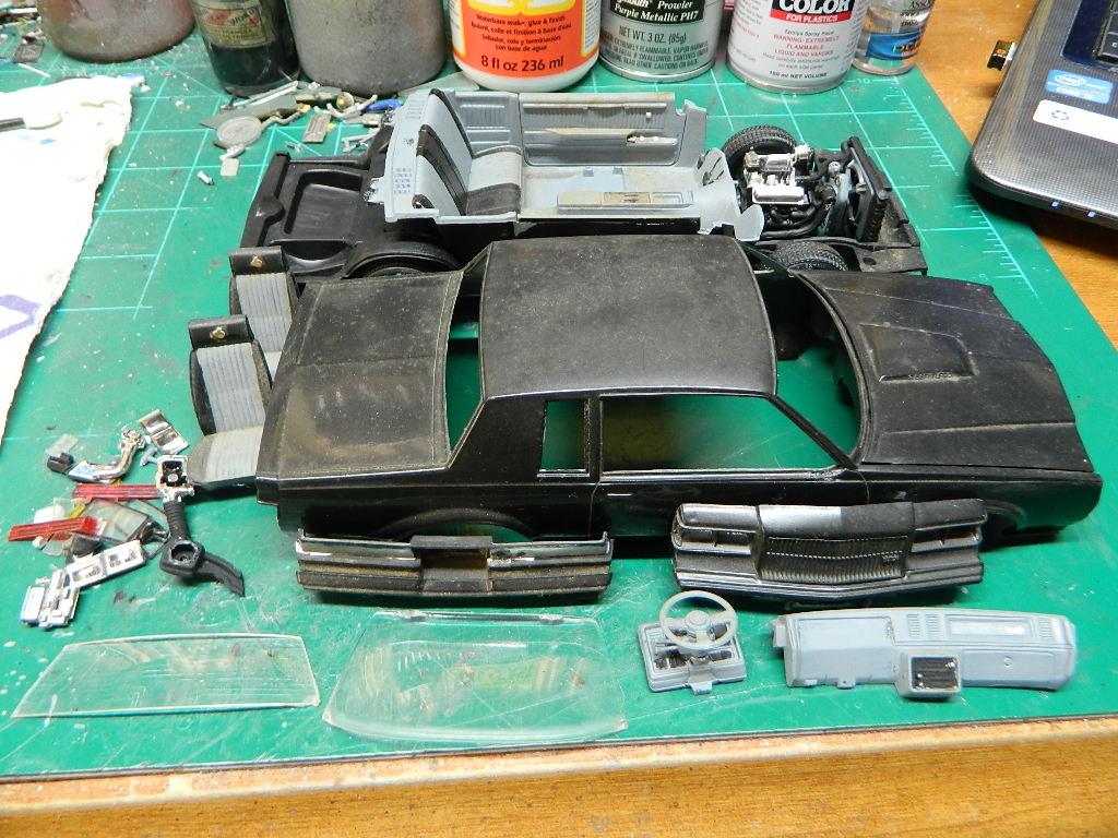

mrmike Posted September 18, 2021 Posted September 18, 2021 I am trying to get myself out of a rut with this build. I haven't done anything with my builds for at least a month and maybe this will get me back on track again. This is a '87 Buick Grand National that has been sitting on the shelf for many years untouched and unloved. My plans are to paint it Tamiya TS-18 Metallic Red with the current gray and black interior. Plans call for the engine to be wired, chrome bumpers, some repainting and touchups. It will be known as a Buick Regal T-Type since I have removed all of the GN decals, but the car will be a Grand National underneath. First stop, the kitchen sink for a bath! More Buick to come... 1

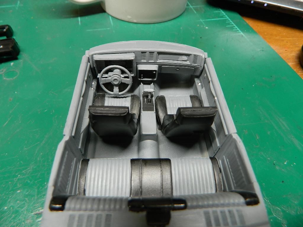

mrmike Posted September 23, 2021 Author Posted September 23, 2021 (edited) Thanks David! I've been working at the T-Type for a few days. I finished the interior. The chassis is partially complete. It got me to wondering about certain mounting points on the rear suspension. I compared the T-Type with my GNX and the GNX has a Panhard bar and a rear axle stablizer and the T-Type doesn't have any. Which came first the Grand National or the GNX? The front and rear bumpers were seperated from the grille and rear panels, cleaned up and are ready for some Alclad II Chrome paint. ore Buick to come... Edited September 23, 2021 by mrmike

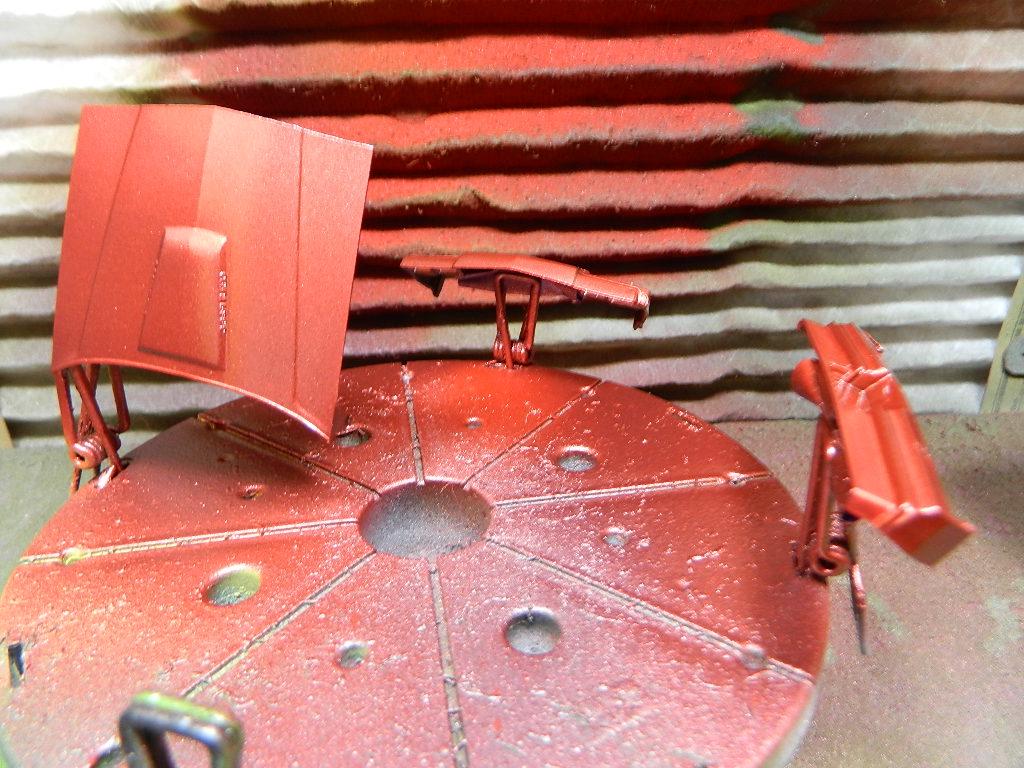

mrmike Posted September 26, 2021 Author Posted September 26, 2021 Thanks guys! I painted the Regal T-Type today with Tamiya TS-18 Metallic Red and chromed the bumpers with Alclad II Chrome paint. More Buick to come...

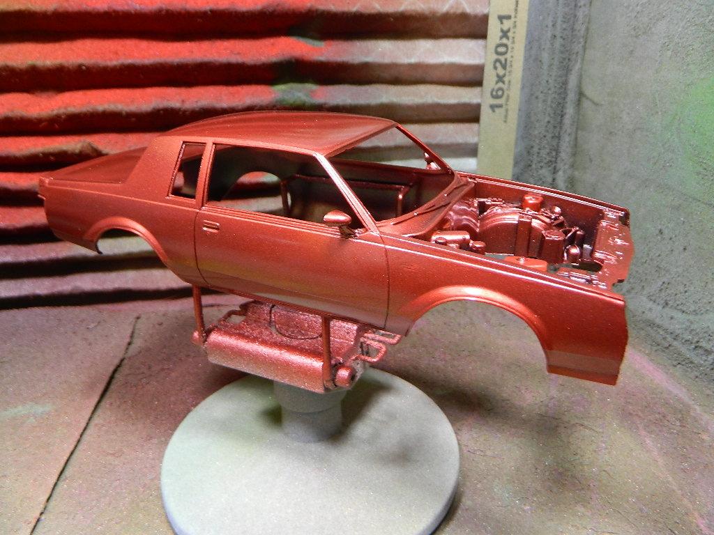

mrmike Posted September 29, 2021 Author Posted September 29, 2021 Thanks Jordan! Now to mask off the body so I can paint the engine compartment and then I can paint the interior roof.
mrmike Posted September 30, 2021 Author Posted September 30, 2021 I got the front and rear panels ready for assembly along with my license plates. The blob of glue on the rear license plate was removed after the picture was taken. The engine compartment was masked off and painted with Tamiya TS-29 Semi Gloss Black. More Buick to come...
