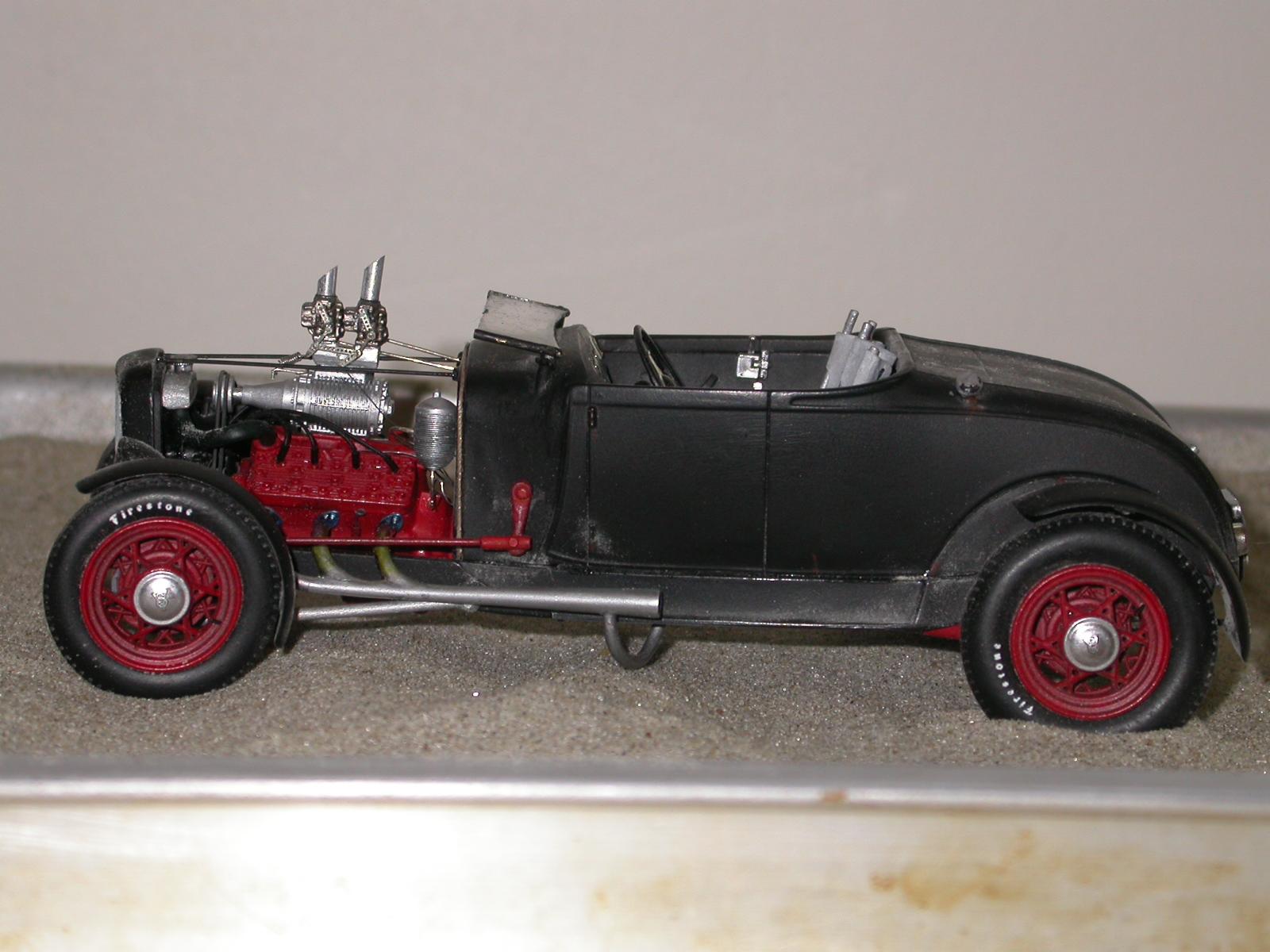

Paul Payne Posted September 27, 2021 Posted September 27, 2021 I have never tried to use decals on tires, but to get that lettering I would certainly try some! Here is a pic of the Firestone Shabo lettering on my A-V8. 1

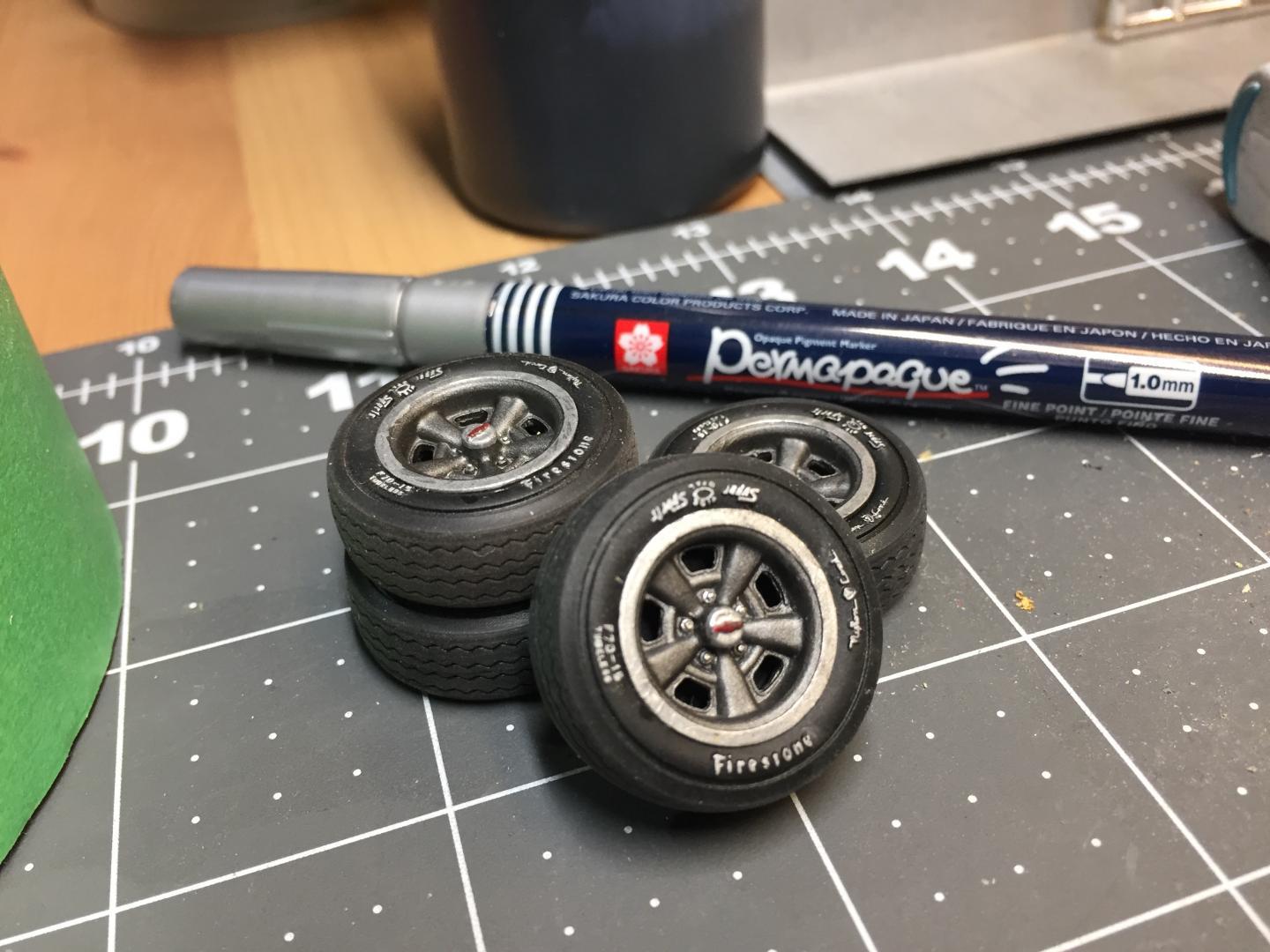

NOBLNG Posted October 20, 2021 Posted October 20, 2021 On 9/18/2021 at 1:11 PM, bbowser said: Looking for tips on the best way to letter racing tires with raised lettering. I know about using acrylic not enamel paint. I'm working on an AMT Indycar and need to letter both sides of the tires. Thanks in advance. I did these by rolling the side of the tip of this pen over the letters. I don’t know if this pen is available in white, but this silver was close enough for me and went on real nice.

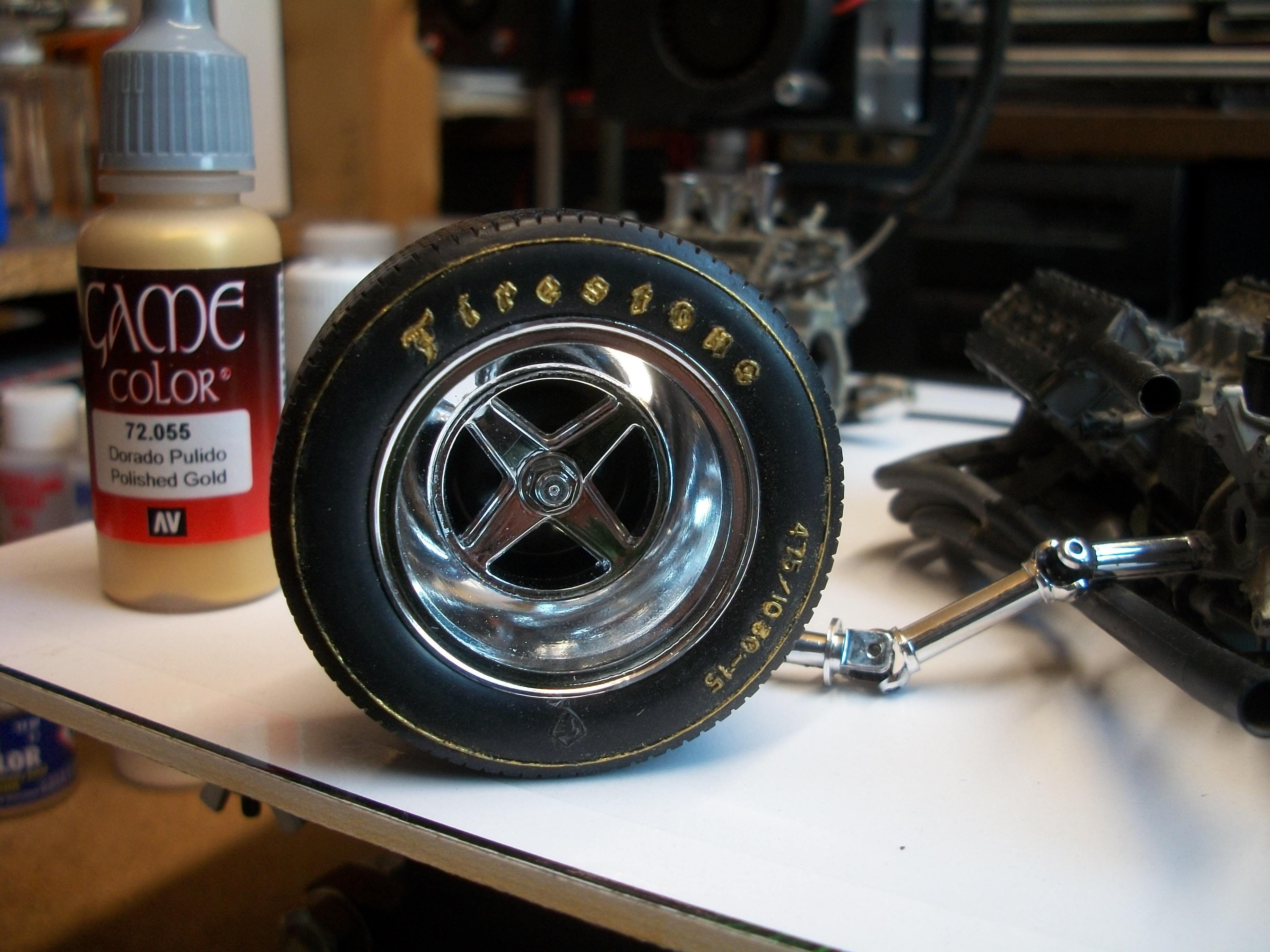

Anglia105E Posted October 21, 2021 Posted October 21, 2021 I used a toothpick / cocktail stick to apply some Vallejo Polished Gold acrylic onto ' Firestone ' tyre lettering, for my Lotus F1 car in 1:12 scale. This procedure does take a long time and a steady hand though, so I am always on the lookout for alternative methods ! All the suggestions in this topic are useful, so thanks guys. David

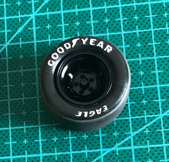

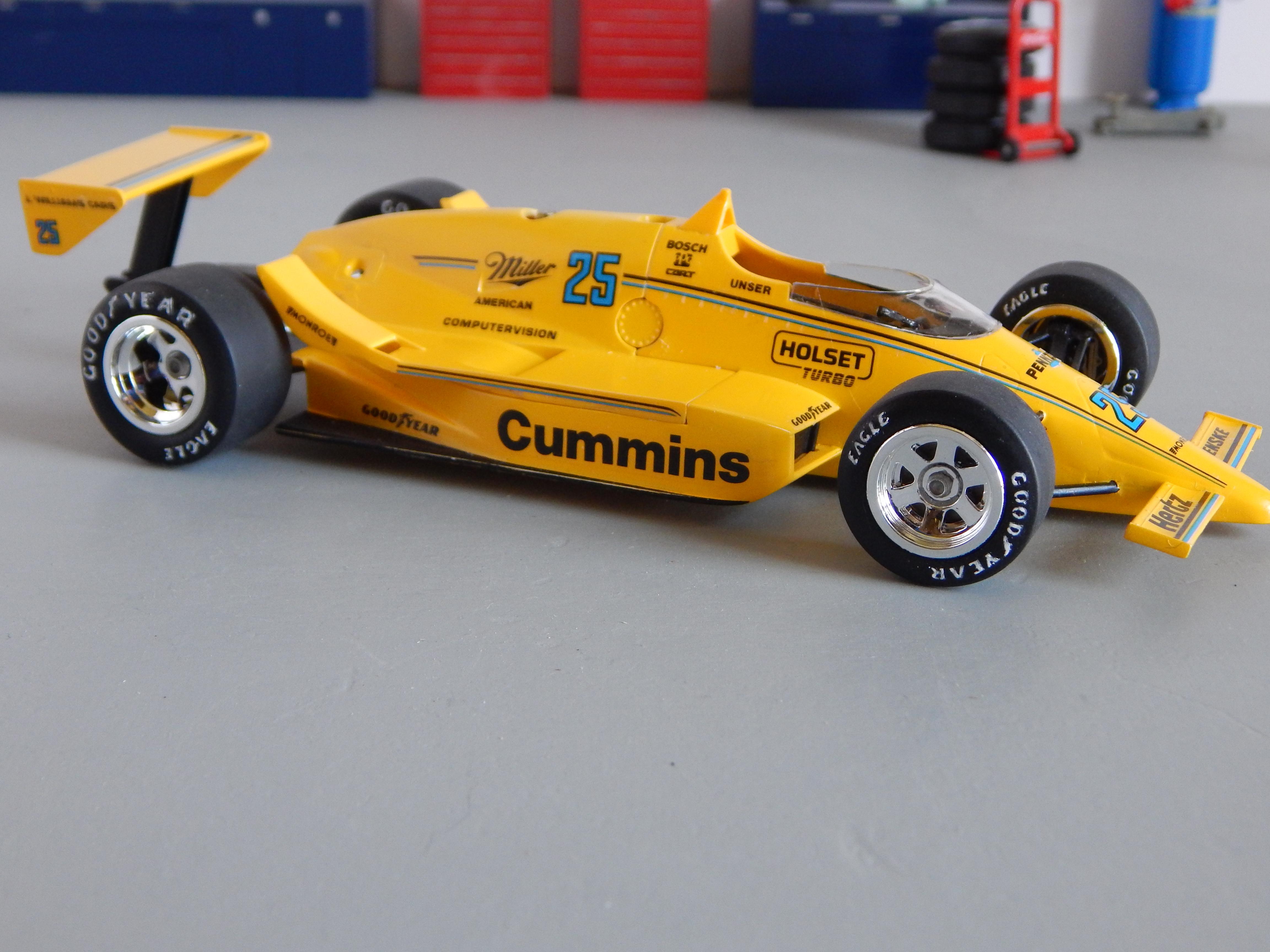

bbowser Posted October 21, 2021 Author Posted October 21, 2021 What I was able to do with the Gelly pen, happy with the results!
