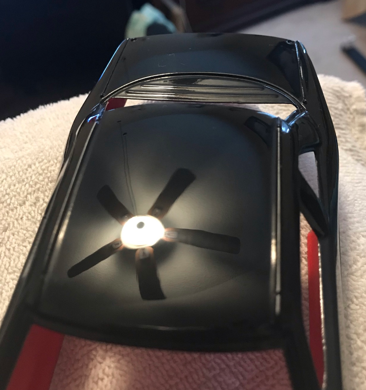

jchrisf Posted September 18, 2021 Posted September 18, 2021 I found it to be a quicker process than normal. 2000 followed by 4000, then Meguiar's Ultra Cut Compound followed by Meguiar's Ultra Finishing Polish. The compound and polish with a wool attachment on my Dremel. The Rustoleum laid down flatter than any Lacquer I've ever used so I didn't have a lot of orange peel. This picture doesn't even do it justice. 1
Bucky Posted September 18, 2021 Posted September 18, 2021 That looks great! I'll hafta consider using some of that. BTW, nice ceiling fan! 1 3

Rick L Posted September 20, 2021 Posted September 20, 2021 I especially like the the ceiling fan you painted on the roof. Even though it’s not centered.? 2

Bugatti Fan Posted September 21, 2021 Posted September 21, 2021 Rick, I guess that comment of yours about the ceiling fan painted on the roof was a tongue in cheek joke about the reflection on the high gloss finish! 1
