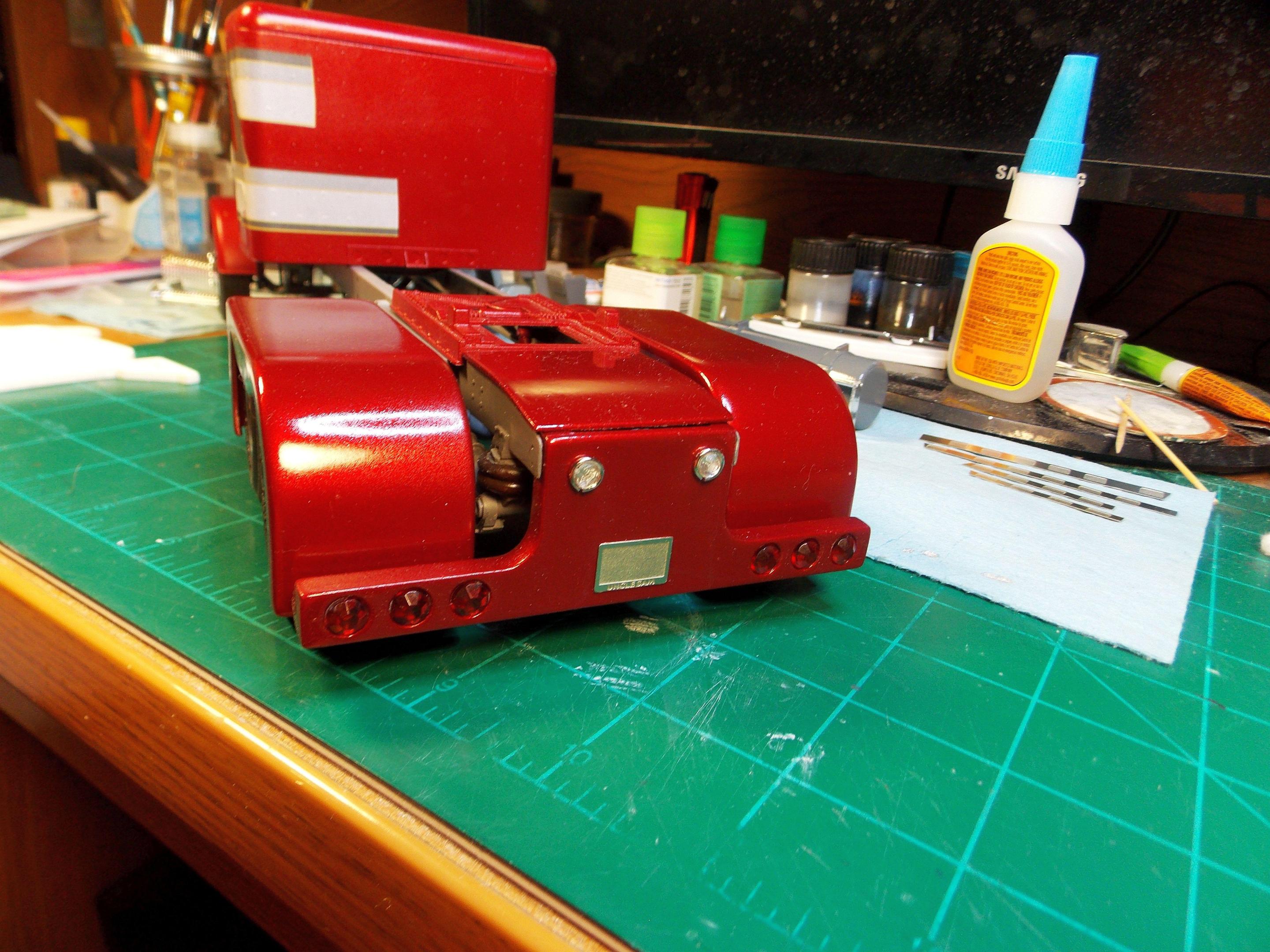

wayne00 Posted October 3, 2021 Posted October 3, 2021 On 9/25/2021 at 11:09 AM, old gearhead said: And, yeah, I was surprised that the 2X didn't eat up the decal. I expected it to. PB. O.K. You guys have me scared now!!!! On my current BRBO build I am using the 2X gloss clear (first pic). I used it on the fenders and rear panel (second pic). I haven't put any clear on the cab parts yet. The color coat is Duplicolor Perfect Match over Rust-oleum 2 in 1 gray primer. Now I'm afraid that the 2X Gloss will eat the decals, I did use 2X satin and semi-gloss on the trailer with no ill effects to the decals. So do I have anything to worry ABOUT??? Thanks Rog? P.S. All of the decals I am using are from Modeltruckin. I have already had to order a 2nd set because of my mistake and I don't want have do a 3rd.
old gearhead Posted October 4, 2021 Author Posted October 4, 2021 5 hours ago, wayne00 said: O.K. You guys have me scared now!!!! On my current BRBO build I am using the 2X gloss clear (first pic). I used it on the fenders and rear panel (second pic). I haven't put any clear on the cab parts yet. The color coat is Duplicolor Perfect Match over Rust-oleum 2 in 1 gray primer. Now I'm afraid that the 2X Gloss will eat the decals, I did use 2X satin and semi-gloss on the trailer with no ill effects to the decals. So do I have anything to worry ABOUT??? Thanks Rog? P.S. All of the decals I am using are from Modeltruckin. I have already had to order a 2nd set because of my mistake and I don't want have do a 3rd. Maybe you should do the spoon test as Espo (David) suggests. When I tested 2X on a spare car body, it didn't attack the decal I applied per se, but, as I mentioned, the test enamel and decal had a coat of TS-13 over them. The TS-13 attacked the (Testors) enamel but had no effect on the decal. The X2 attacked the TS-13 and really burned into the enamel that was under the TS-13. I can't say if the 2X affected the decal under the circumstances in which I tested it, although I do spray my inkjet decal paper with an acrylic lacquer (Krylon) to seal the decals without harm. Paint-wise, it looks like you're OK with the X2 because you're dealing with lacquer-on-lacquer, but I would test the X2 over some spare/scrap decals, for sure.
