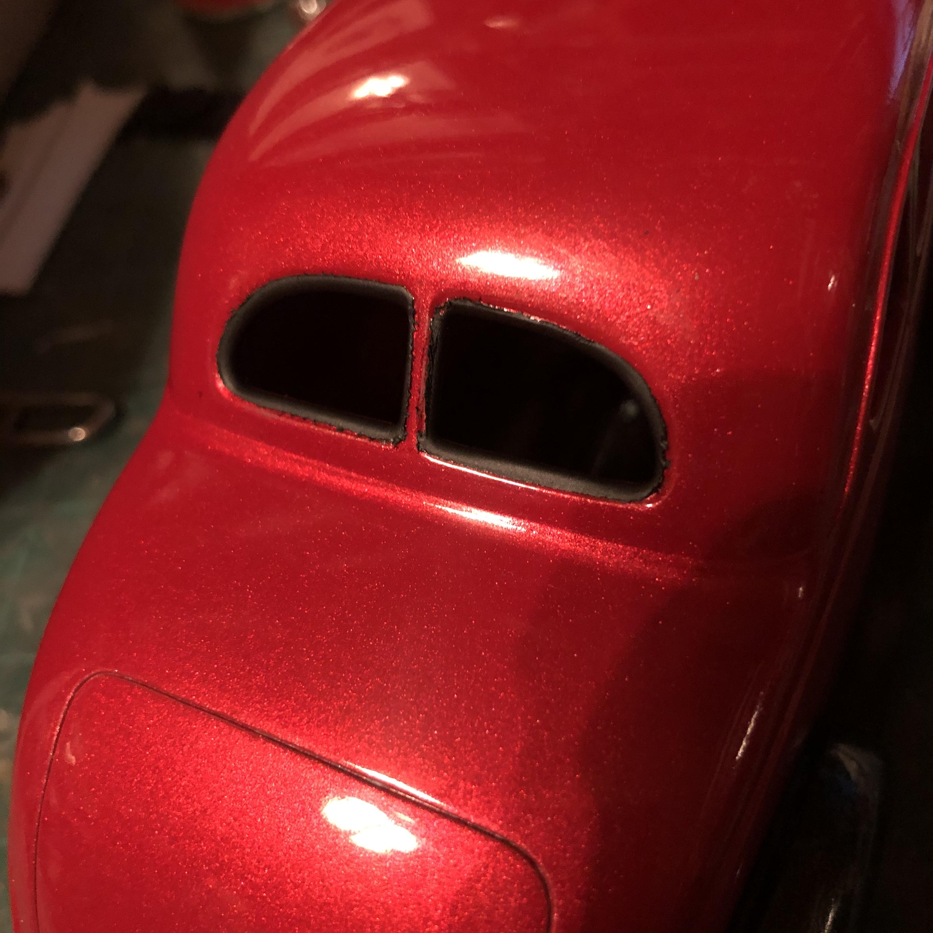

Dpate Posted September 26, 2021 Posted September 26, 2021 So after letting 2K clear coat fully dry it had decent amount of orange peel. So after using micro mesh 3200-12000 not skipping a single stage i than use Meguiars scratch 2.0, and the gloss is back and looking nice. BUT there was still orange peel in the finish so i went back through the entire process of micro mesh this time 2400-12000 without skipping a step, and followed up with meguiars scratch 2.0. This time the orange peel is completely gone, and looks really good until you hold it at the right angle at a light. You'll see i guess you could call it "superficial" scratches all over the body like exactly how you see on a 1:1 car in the sun. No amount of scratch 2.0 i use will remove the super fine scratches, so I'm thinking i need a different product or I'm screwed? Did i even need to use scratch 2.0 after doing micro mesh? Should i get and try mequiars ultimate compound and polish or just the polish? I'm thinking after micro meshing up too 12K i should of used a polish without cutting properties? Any help would be greatly welcomed.

Dpate Posted September 27, 2021 Author Posted September 27, 2021 (edited) 21 hours ago, stitchdup said: Did you alternate direction when using the micromesh pads? If you did all the rubbing in one direction you will get the small scratches while alternating direction seems to negate this. Yes but maybe i didn't do good enough job. 21 hours ago, StevenGuthmiller said: If this is the case, your job is done! What better result could you ask for than "looking exactly like a 1:1 car"? Steve lol Yeah like someone who didn't know what they where doing. It looks like the picture on the turtle wax bottle in the picture but cleaner. 16 hours ago, Bills72sj said: Add rubbing compound step between the last sanding and the Meguiar's 2.0. I thought meguiar's 2.0 was a rubbing compound? I haven't added any wax yet cause I would like to fix this issue before hand. If I'm not able to fix it i guess i will have to settle with it. Like in the picture below but cleaner and running left to right exactly how i was rubbing the meguiars 2.0. There are zero swirl marks its just light scratches in the clear coat spaced out a tiny bit. Edited September 27, 2021 by Dpate
