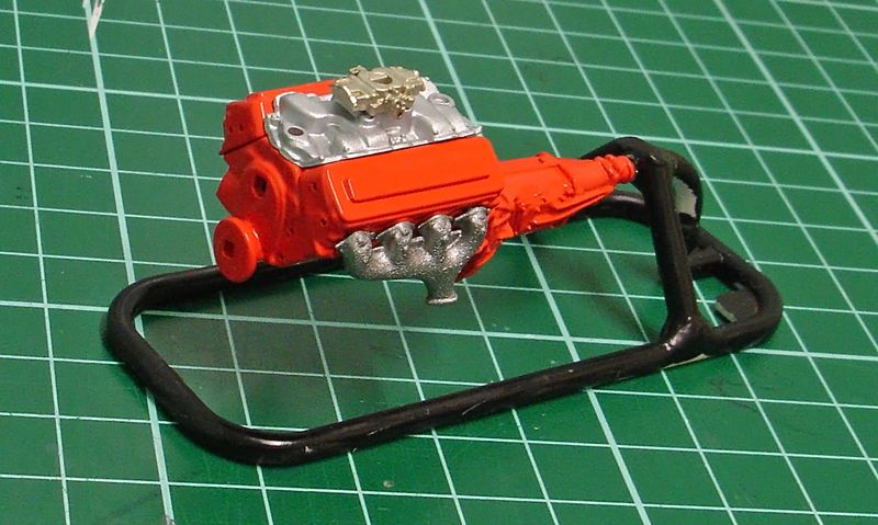

roadhawg Posted September 30, 2021 Posted September 30, 2021 12 hours ago, NOBLNG said: I guess I should be more specific. I want something to paint exhaust manifolds with…like a flat cast iron colour. Preferably in a lacquer paint. I guess I could add a little black or dark grey to some flat aluminum? Go to an auto parts store (Advance, Autozone, Napa, etc) and get a spray can of cast iron paint. While you'll need to prime the parts first, it's perfect for blocks, exhaust manifolds, and anything else that's supposed to be cast iron. It dries flat.

roadhawg Posted September 30, 2021 Posted September 30, 2021 Not the greatest pictures in the world, but these manifolds are the auto cast iron spray paint I spoke of.
