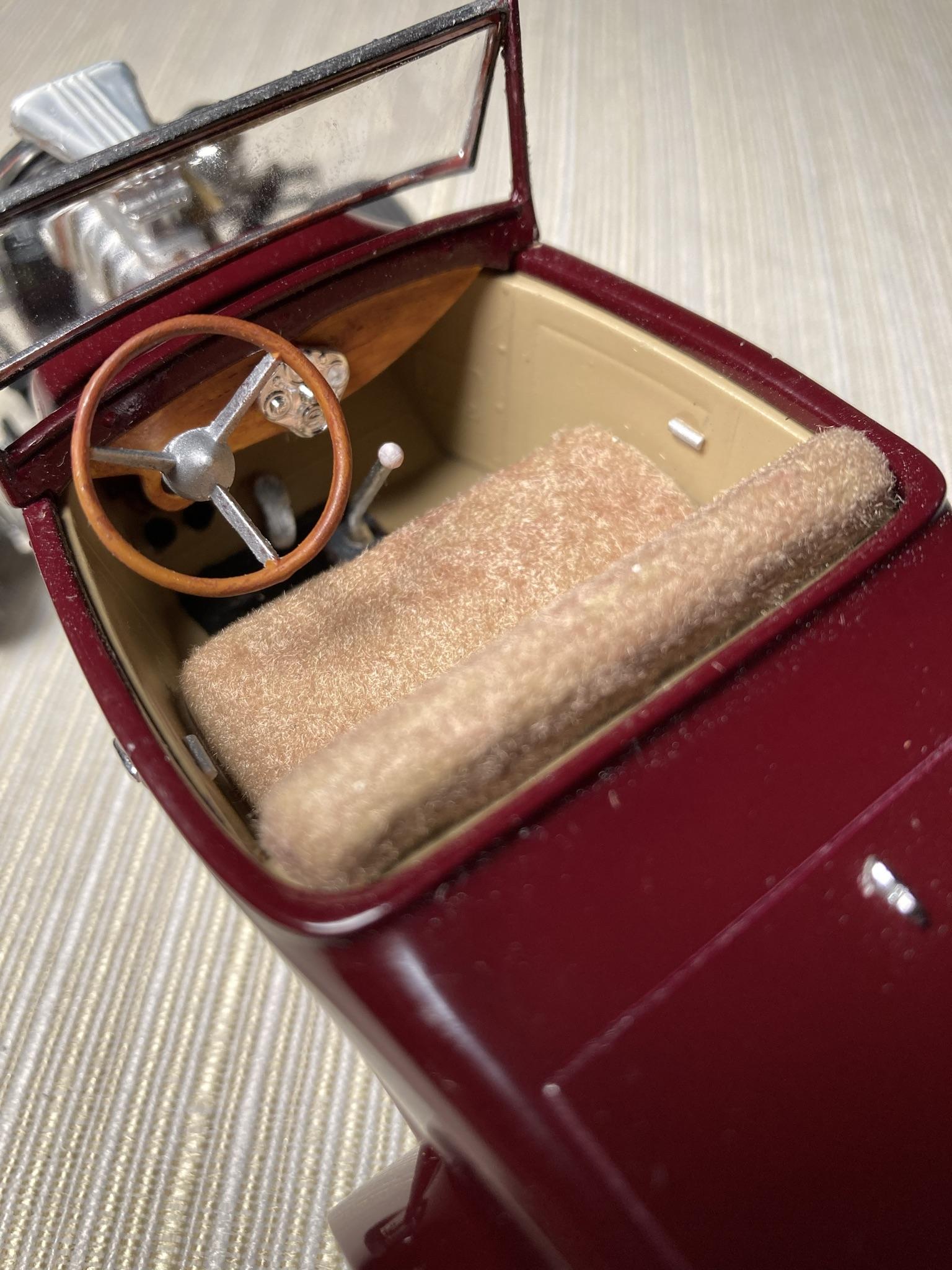

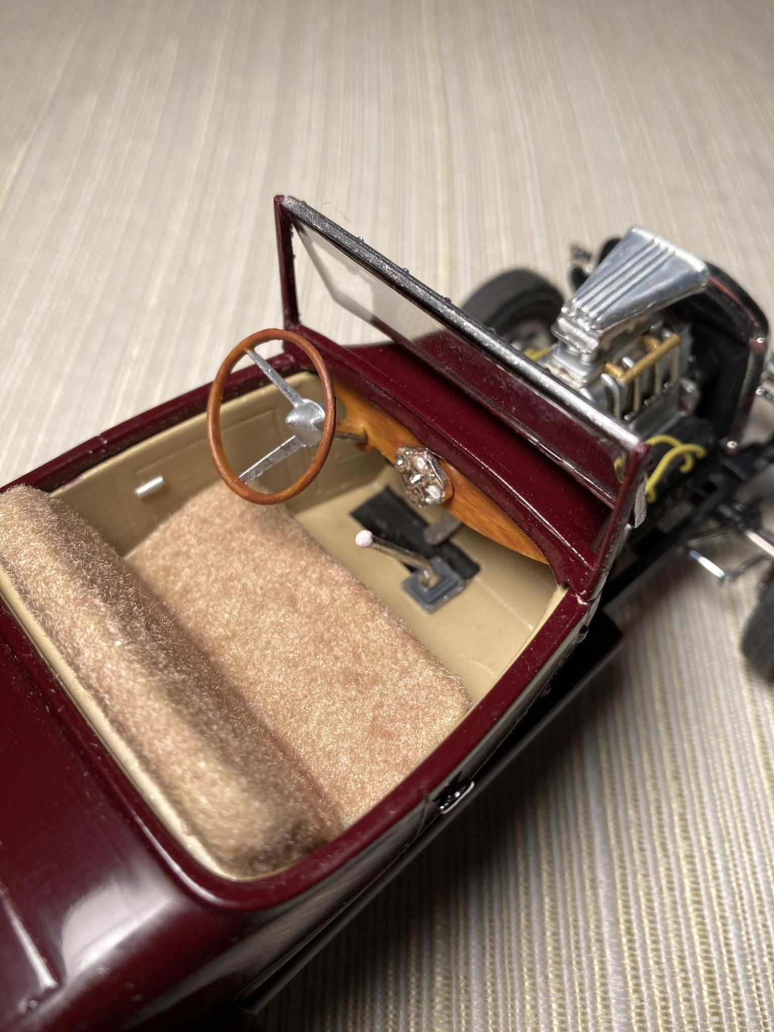

Rick L Posted October 4, 2021 Posted October 4, 2021 I bought this felt material at Hobby Lobby. The best way I can describe it is in powdered form but I don’t remember what it was called. I remember painting a base color then using 1/1 combo of Elmers glue and water, brushing it on then dumping the felt onto the seat. Tamp it down VERY lightly all around, let dry, then tap out the excess.
