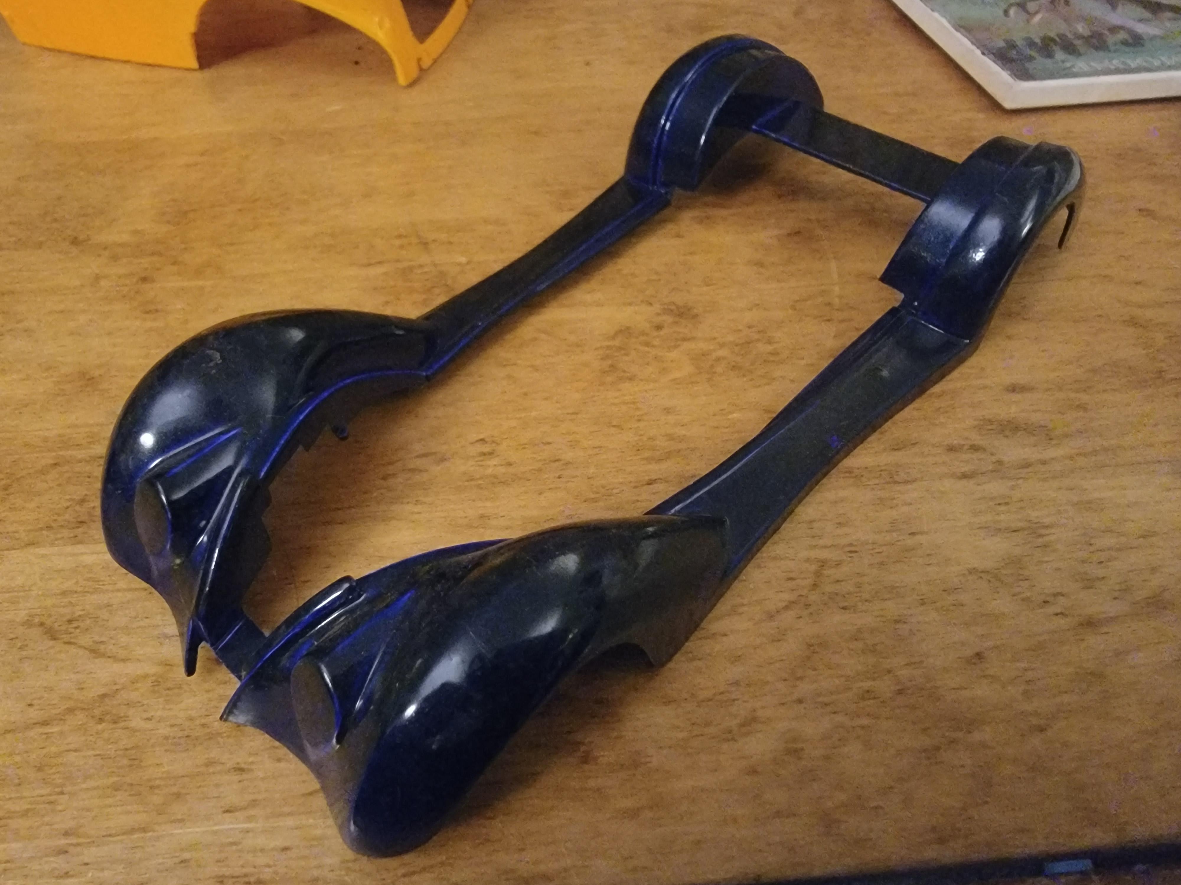

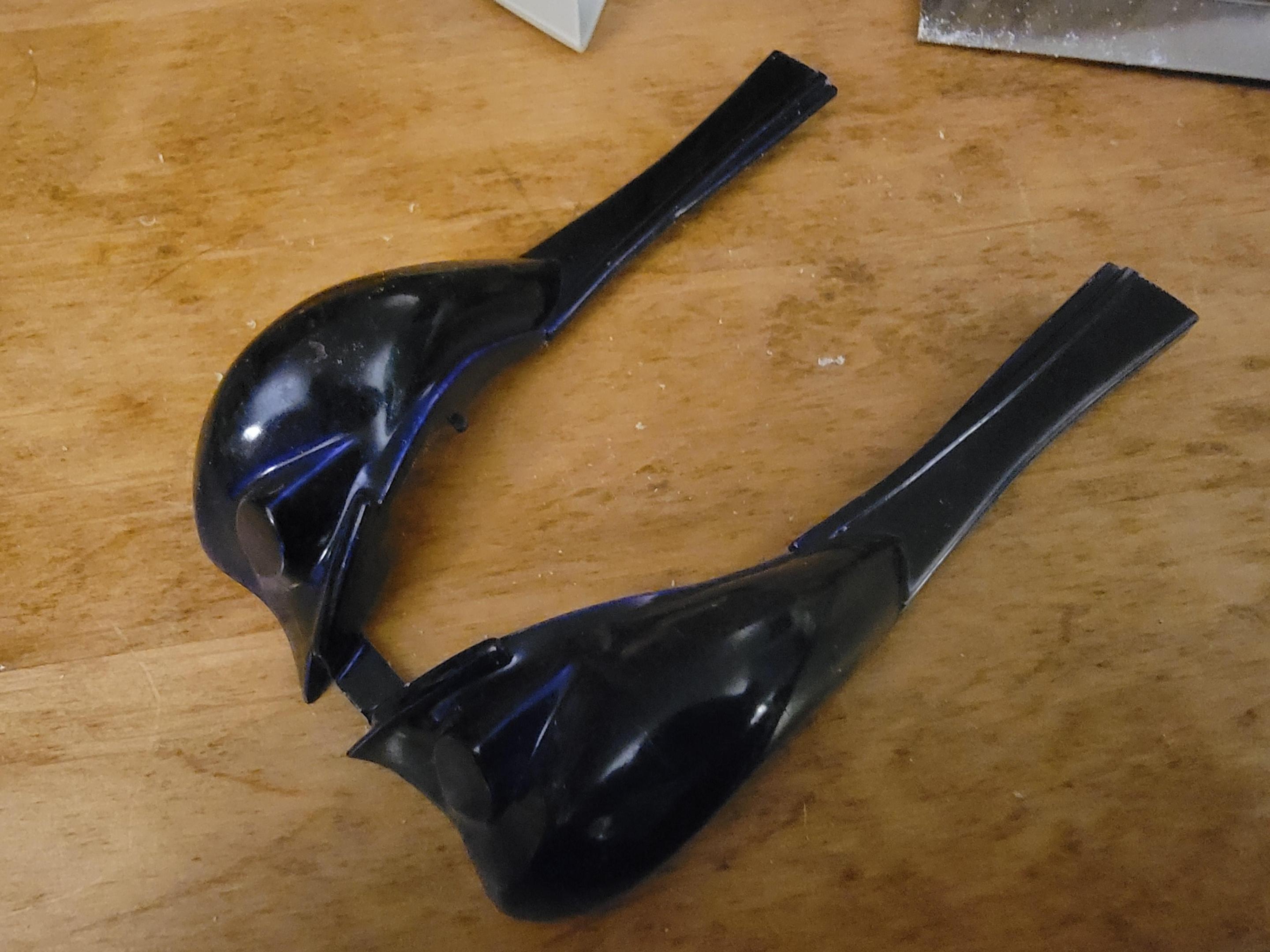

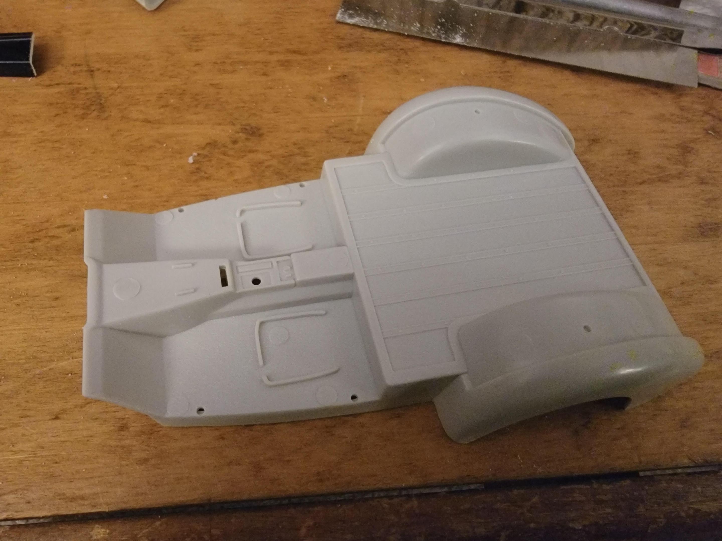

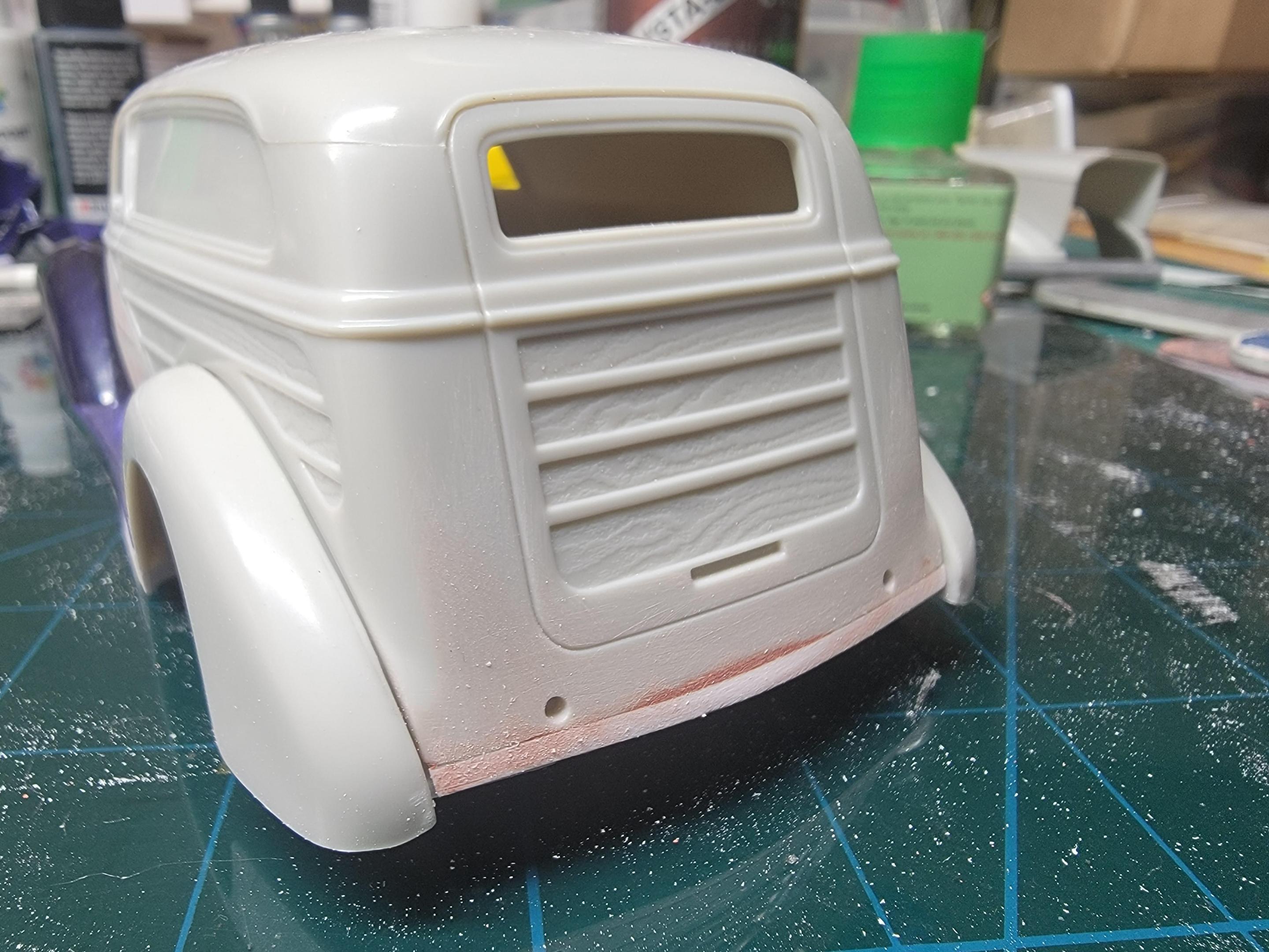

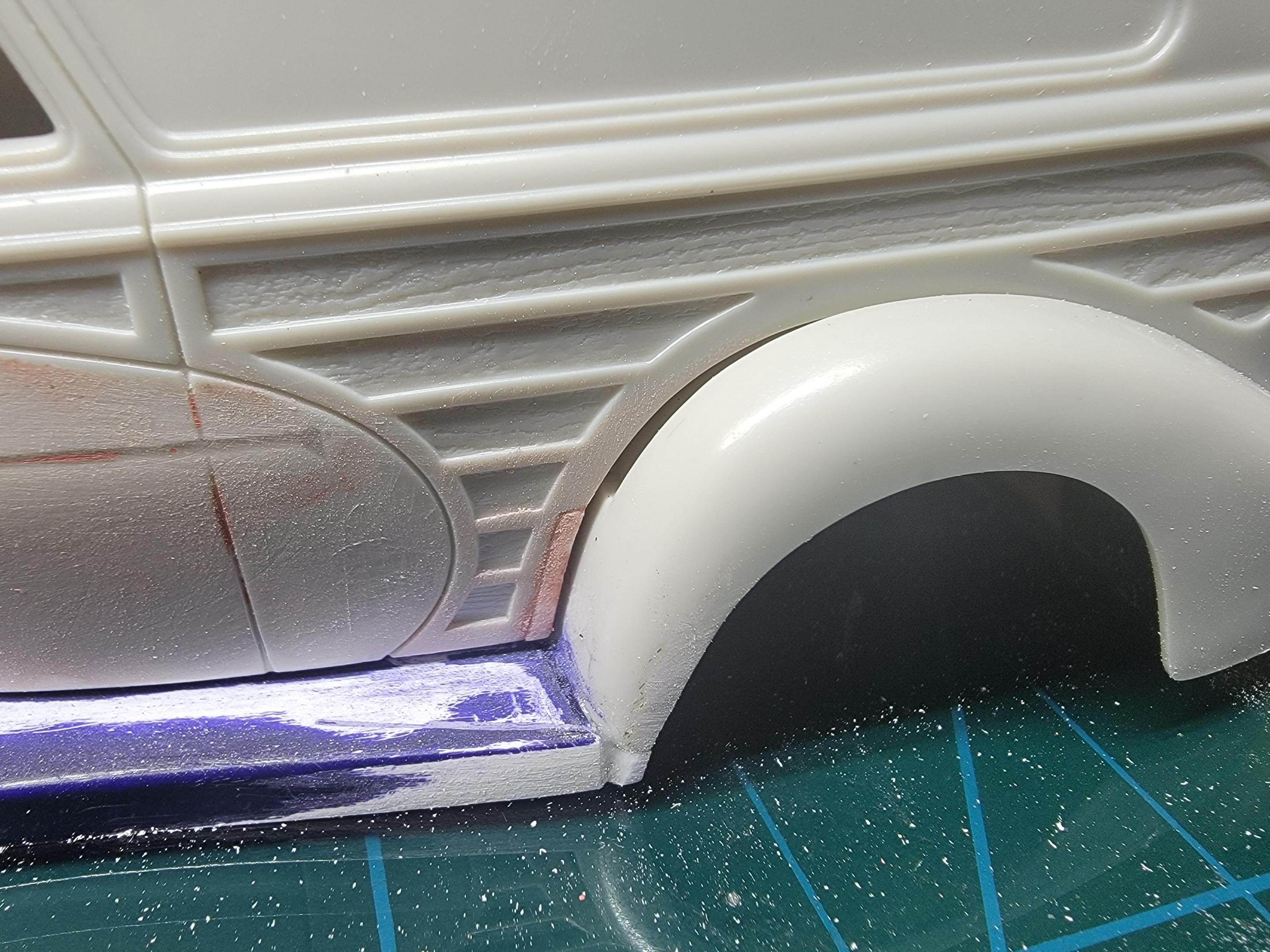

Modlbldr Posted October 16, 2021 Posted October 16, 2021 I got some body and fender units off of FB Marketplace a few days ago. One of them was this Testors Vantastic fender unit. I thought that it may go well with the body from a WagonRod for a custom chopped 37 Ford Woody Sedan Delivery. I thought that for a bit more of a custom.look I would go with the smooth curved running boards from the Vantastic.I With a bit of swapping of the front clip and running boards all that is really left of the slicing is to fabricate the hood sides. Unfortunately, I am missing everything else from the Vantastic kit. Anybody have one to trade? Later-
Zippi Posted October 16, 2021 Posted October 16, 2021 37 is looking pretty good. I like the mods. I'll be watching this one.

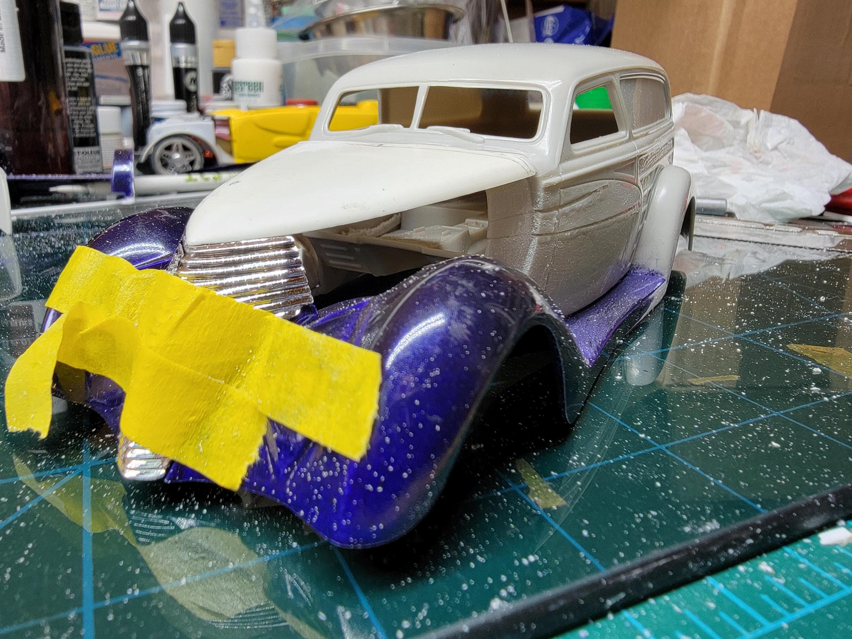

Modlbldr Posted October 16, 2021 Author Posted October 16, 2021 Thanks Fellas! Just had to work on something for a bit last night and this is what came up. Now to find the grill and hood for the Testors Vantastic. Anybody got some.... Later-

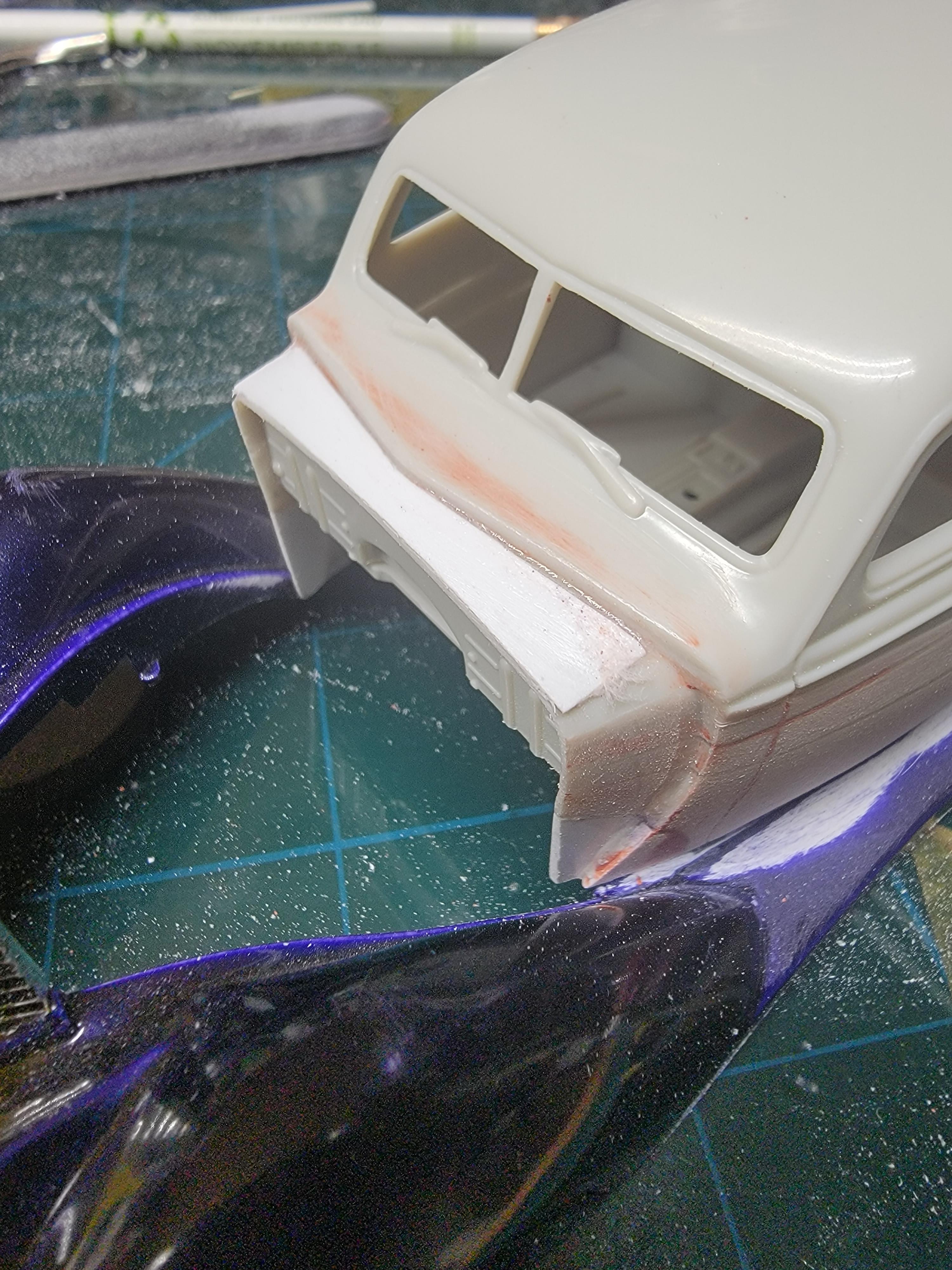

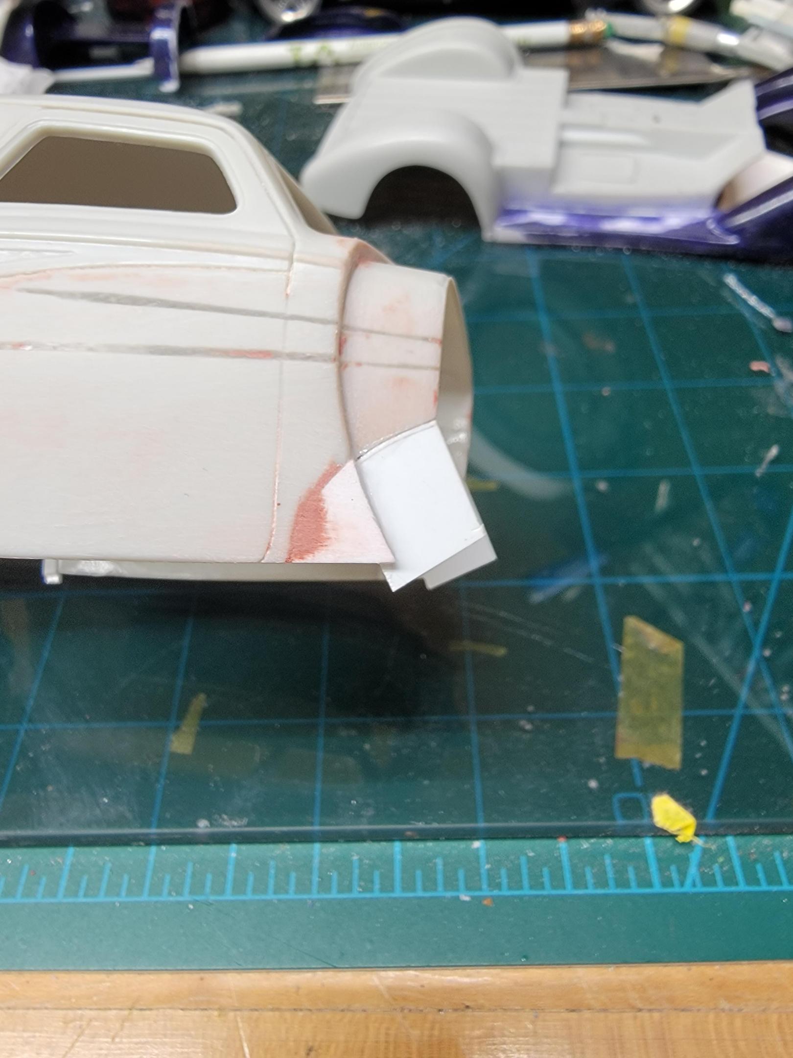

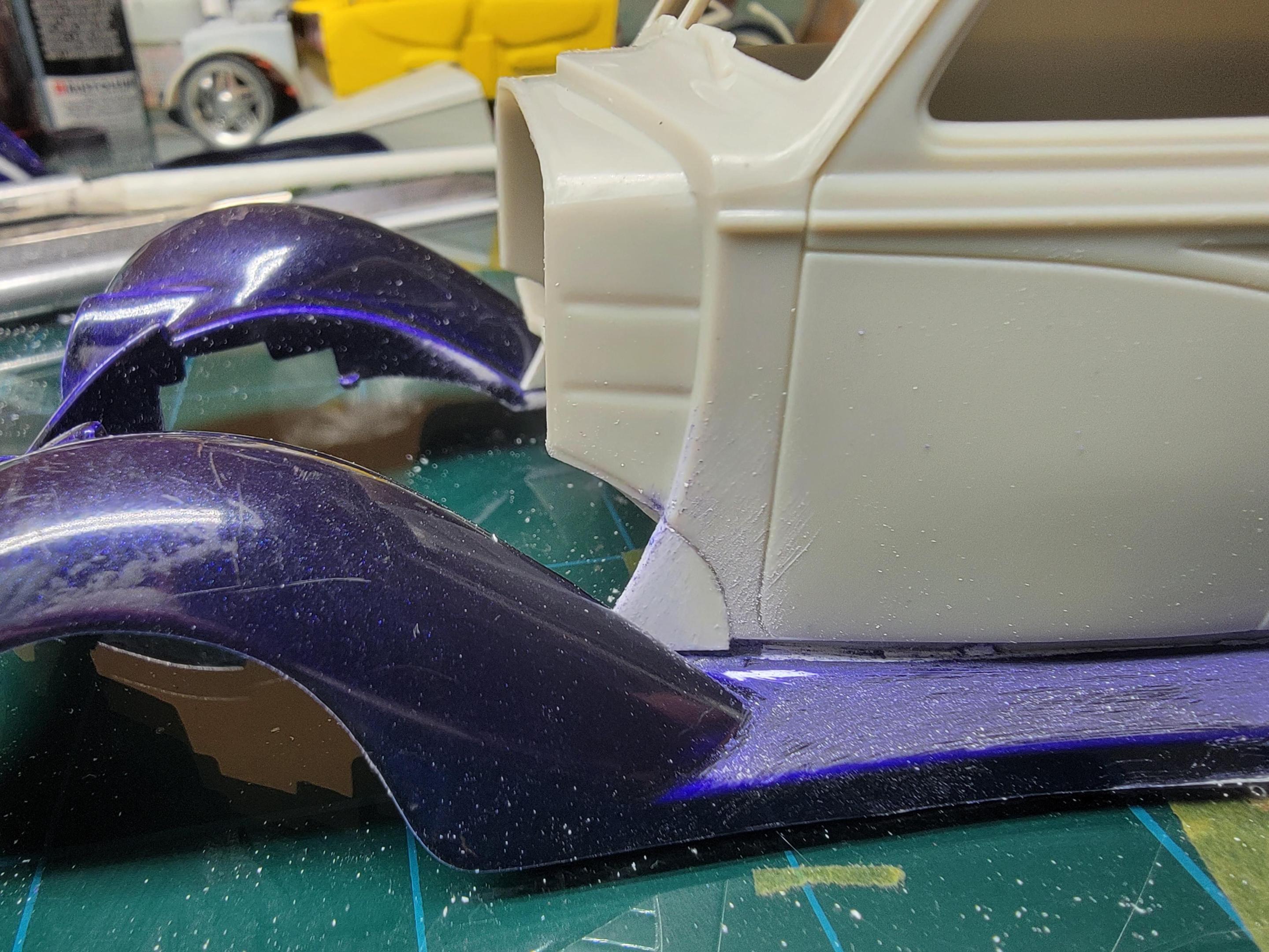

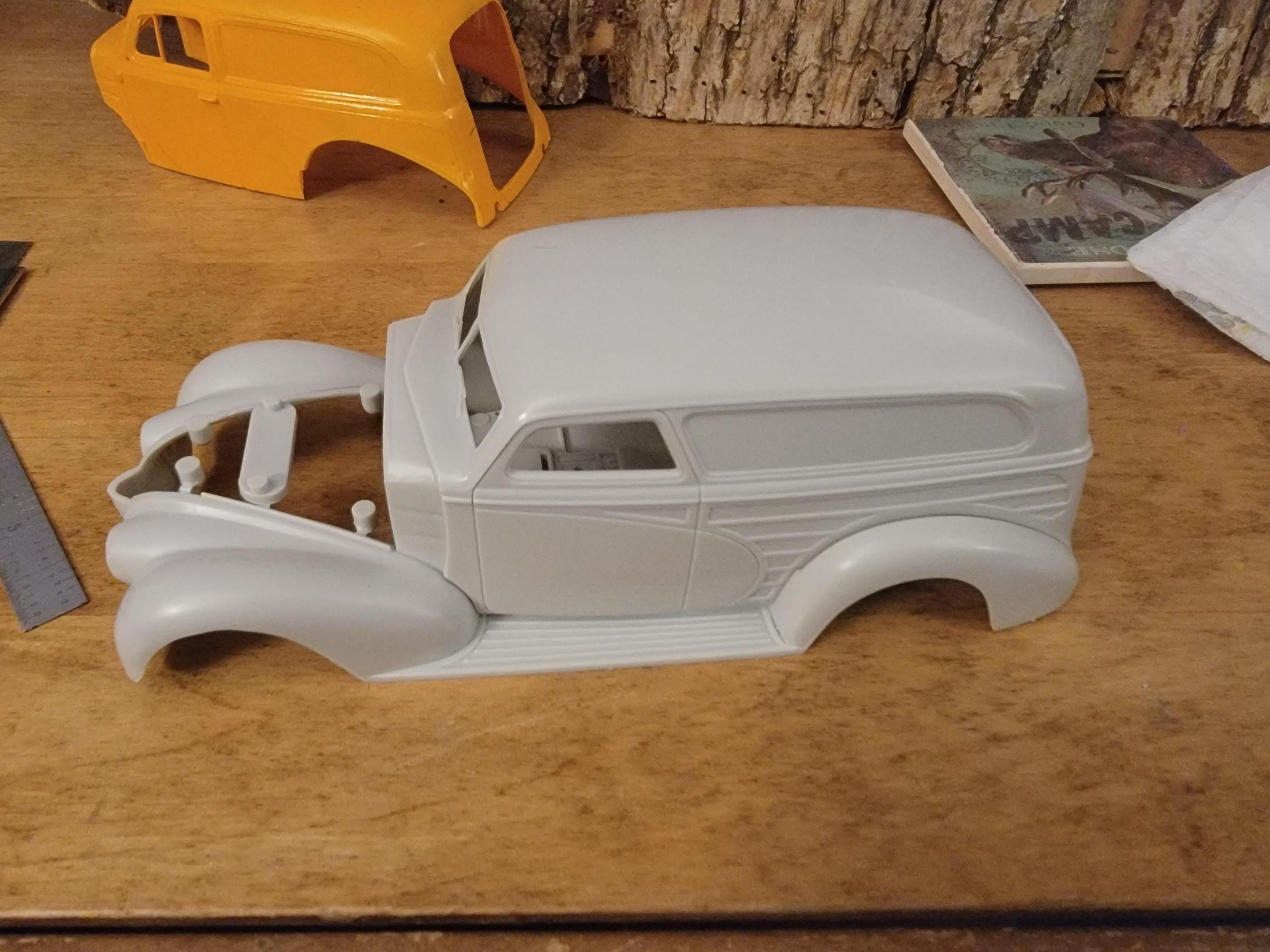

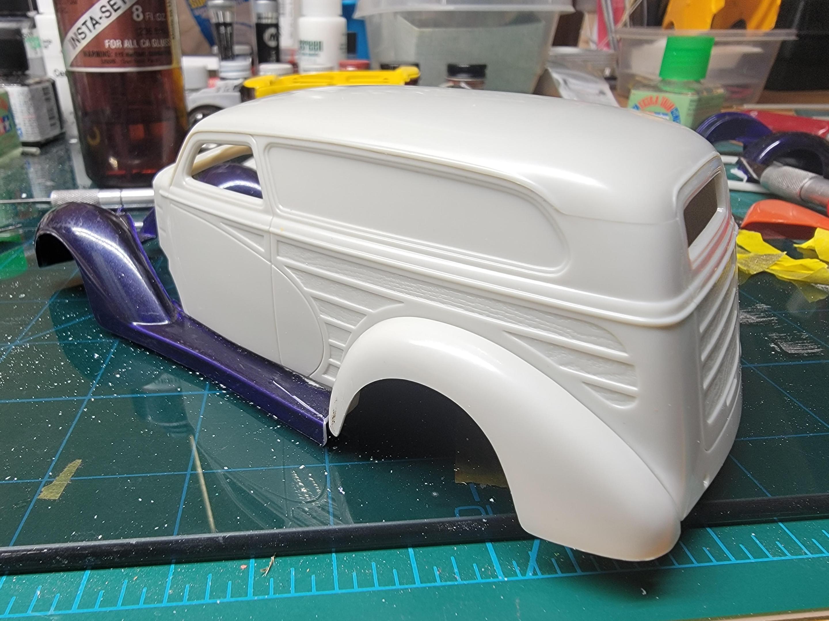

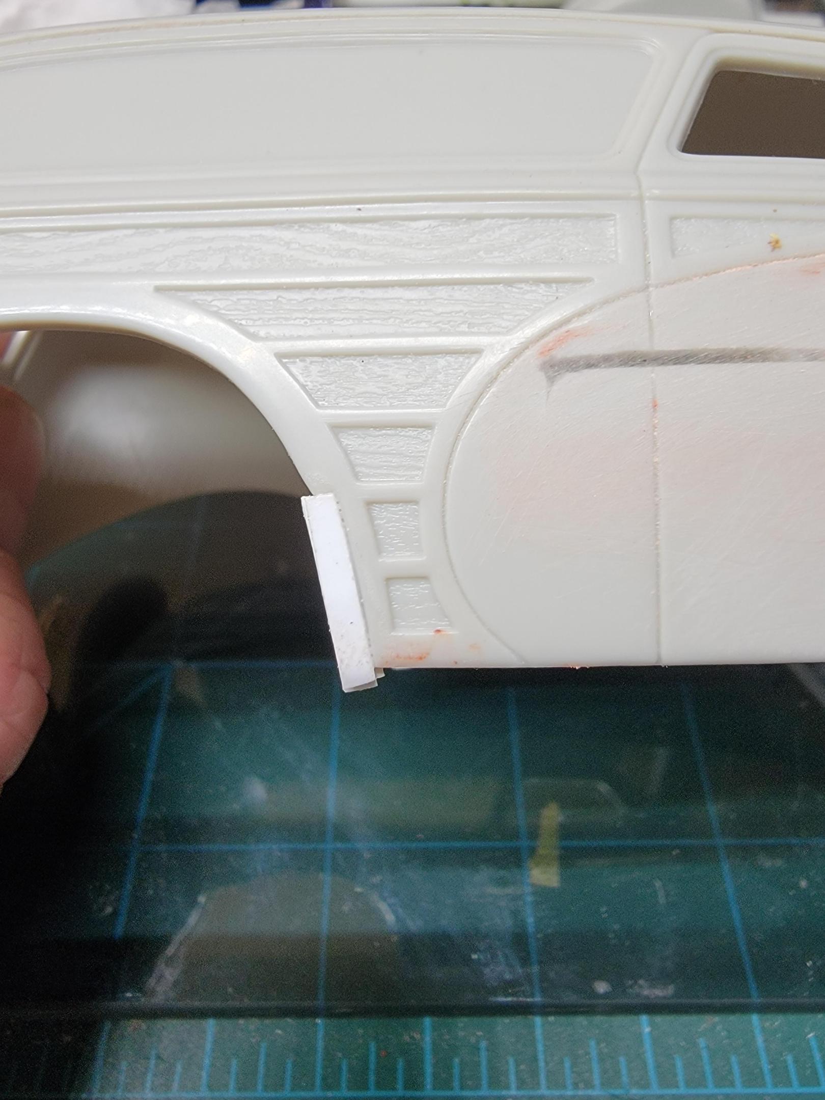

Modlbldr Posted October 23, 2021 Author Posted October 23, 2021 Spent a bit of time on this one today. Got a Vantastic and Coupster kits in trade today with fordf-100 (Phil). The Wagonrod body is much taller than the Vantastic so I had to do some slicing of the body and cowl to get the hood to not look like it was sitting vertical. I didn't want to ruin the woodwork on the body sides so I stopped short of the character line when sectioning. The second pic shows that the hood still had too much angle, requiring another section of the body and cowl.The hood looks much better now. Now for the clean-up. Later-

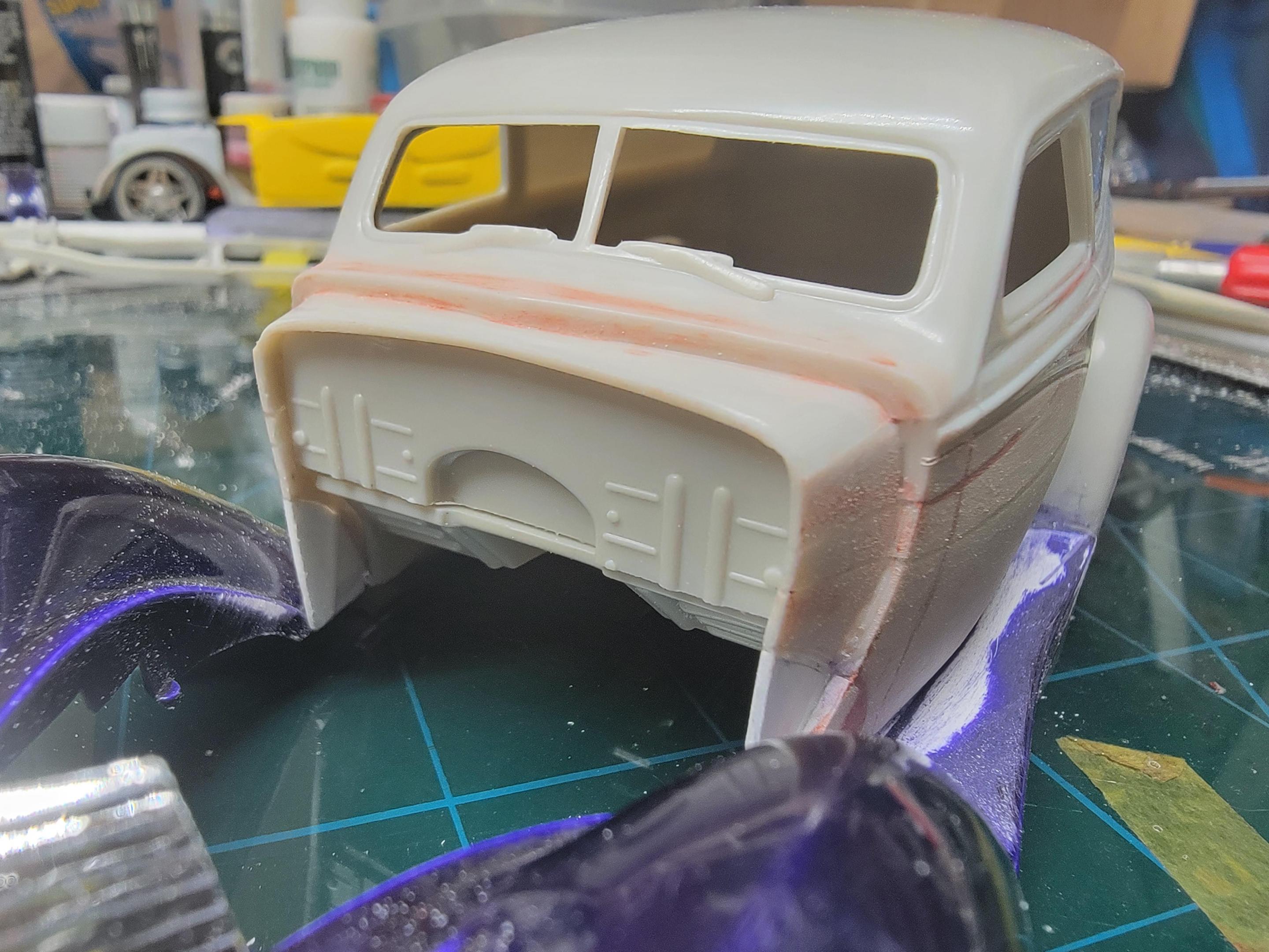

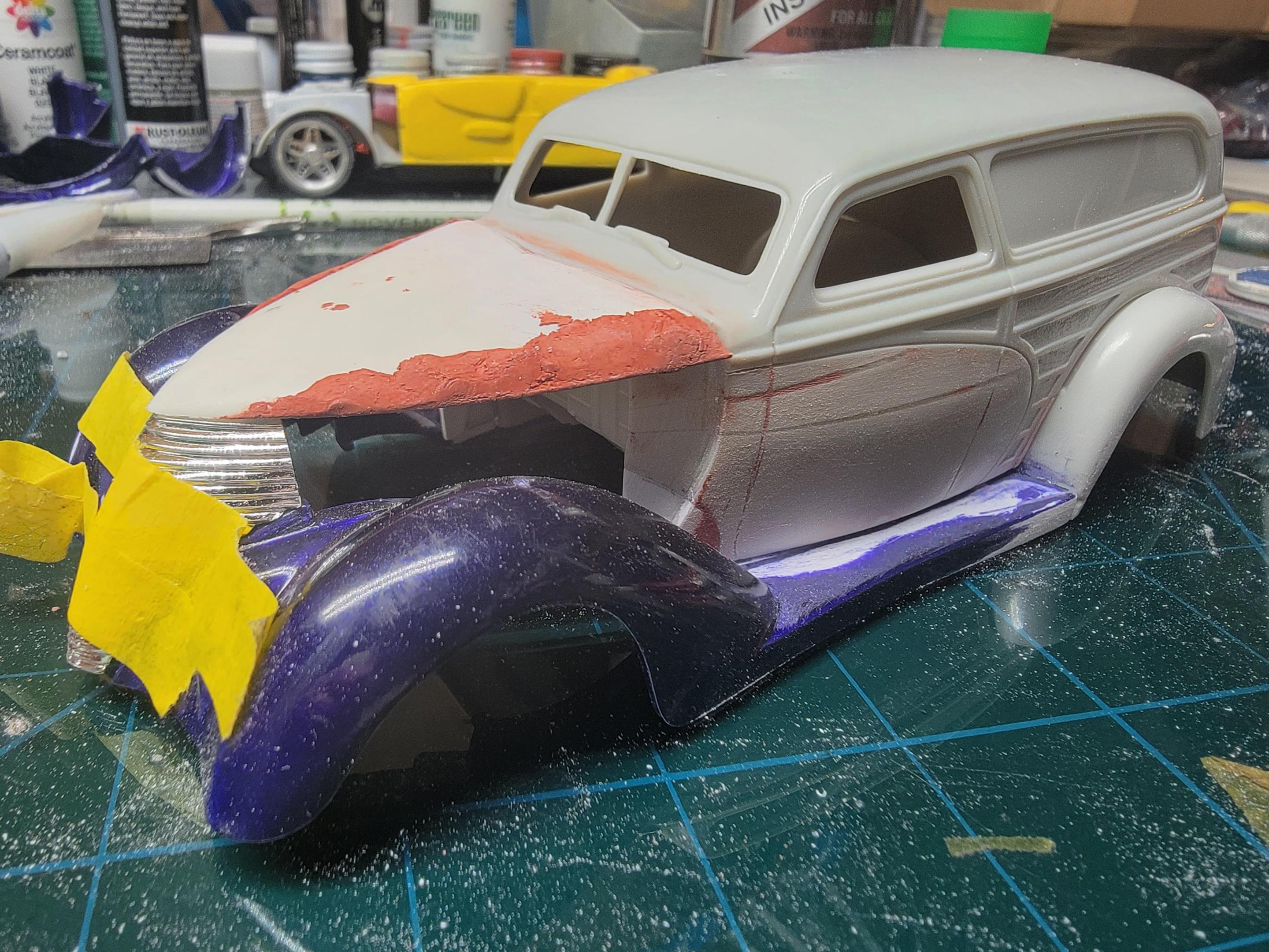

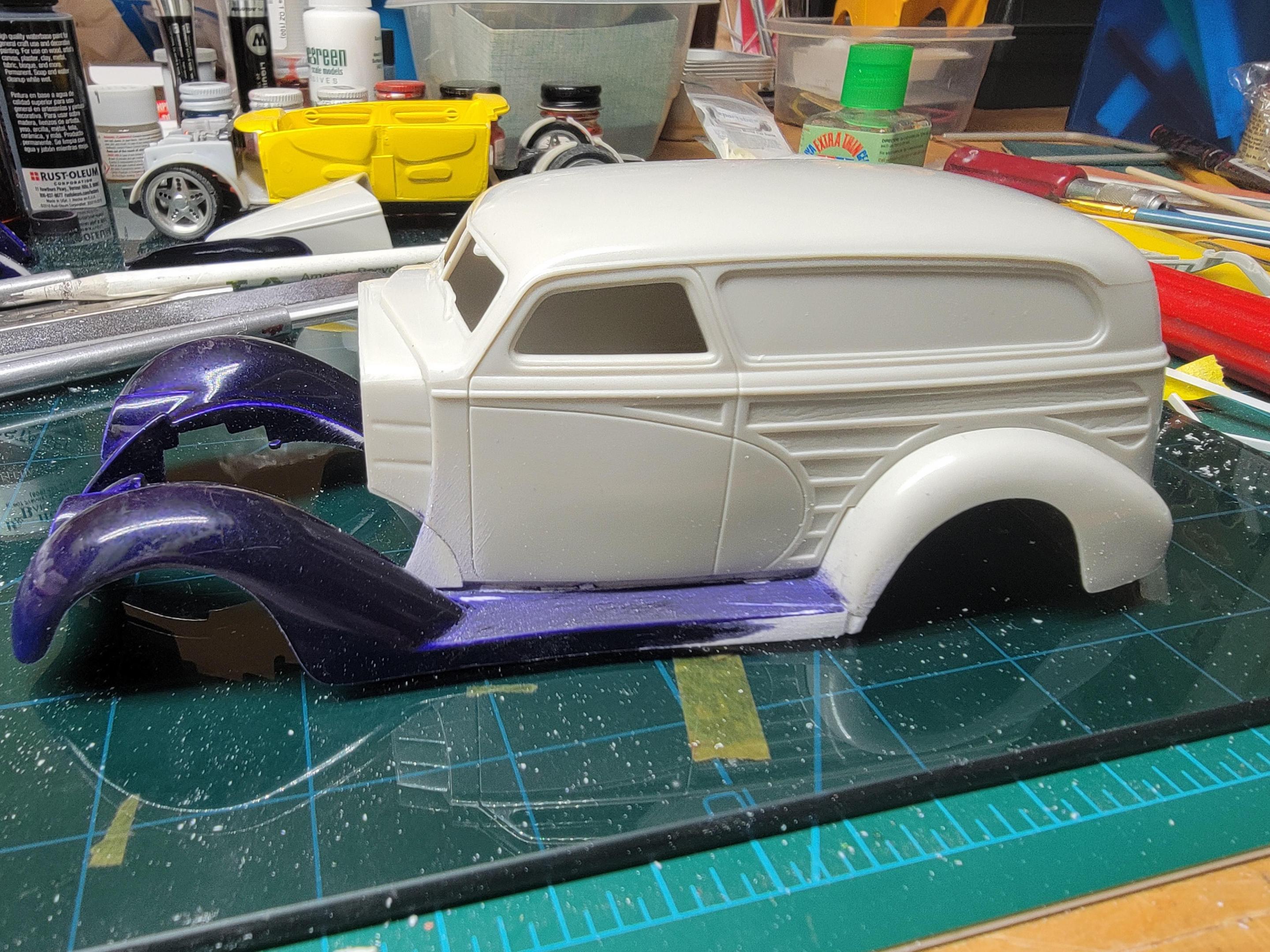

Modlbldr Posted October 31, 2021 Author Posted October 31, 2021 Thanks for all of your kind words Fellas. I made a bit of progress tonight. Got the firewall sectioned and installed and filled some small areas to clean things up a bit. While throwing a bit of putty I added a small strip of styrene along the edges of the hood starting from the grill and extending to the cowlso that the hood would meet the top of the body chrome. At the same time the styrene strip was used as a ledge for super glue and putty so that when sanded out would widen the hood a bit. The body chrome will eventually extend from the cowl to the grill with a piece provided in the Vantastic kit. Next session should consist of shaping the hood and making hood sides. Thanks for looking in. Later-

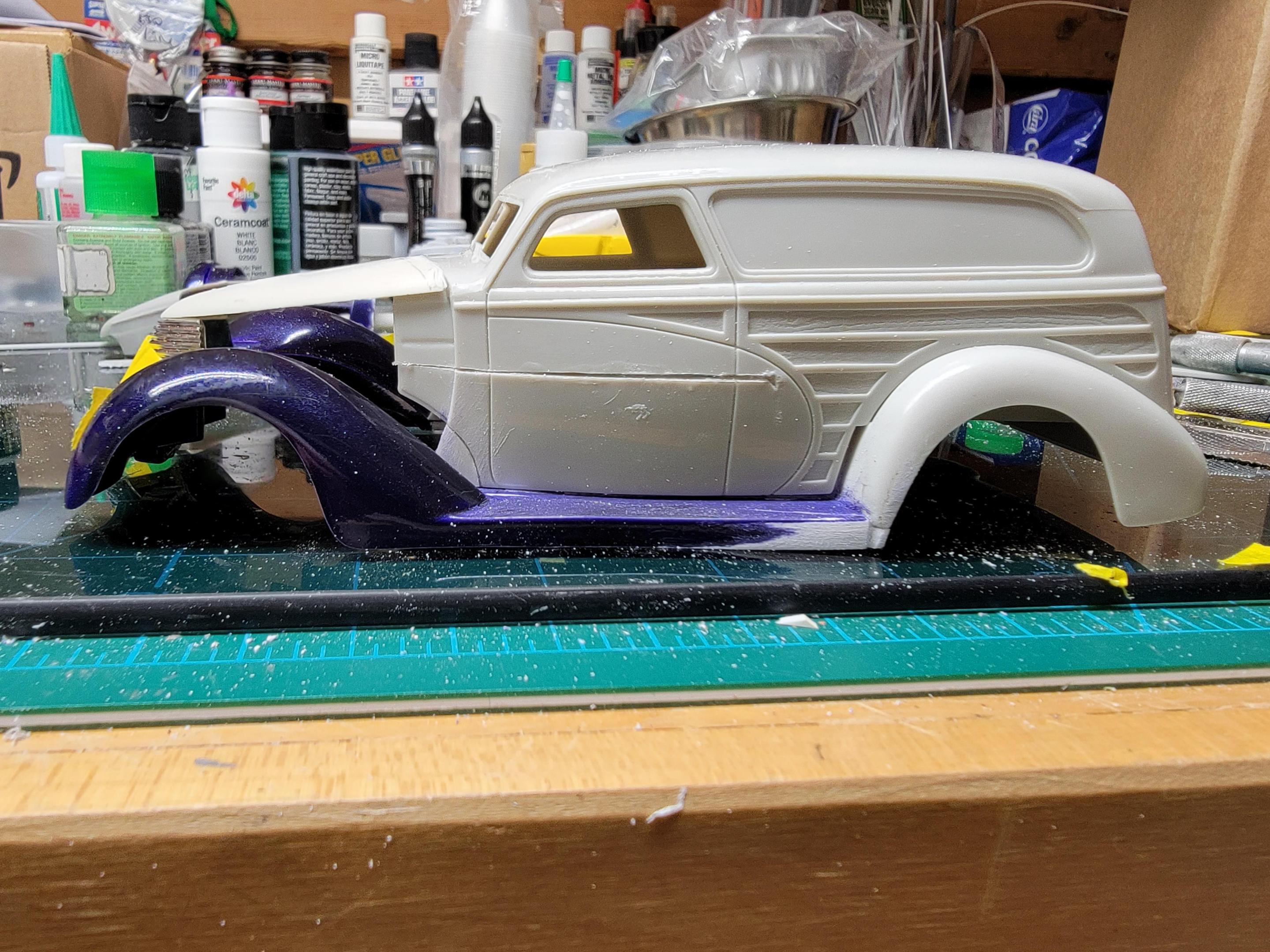

Modlbldr Posted October 31, 2021 Author Posted October 31, 2021 (edited) Thanks Sam. For a build that I had no plan to do, I think it's coming along. Just started throwing it together on a whim to see what it would look like. Mary said last night that she liked the purple so I may have to figure out what paint that is and go with that color. Later- Edited October 31, 2021 by Modlbldr

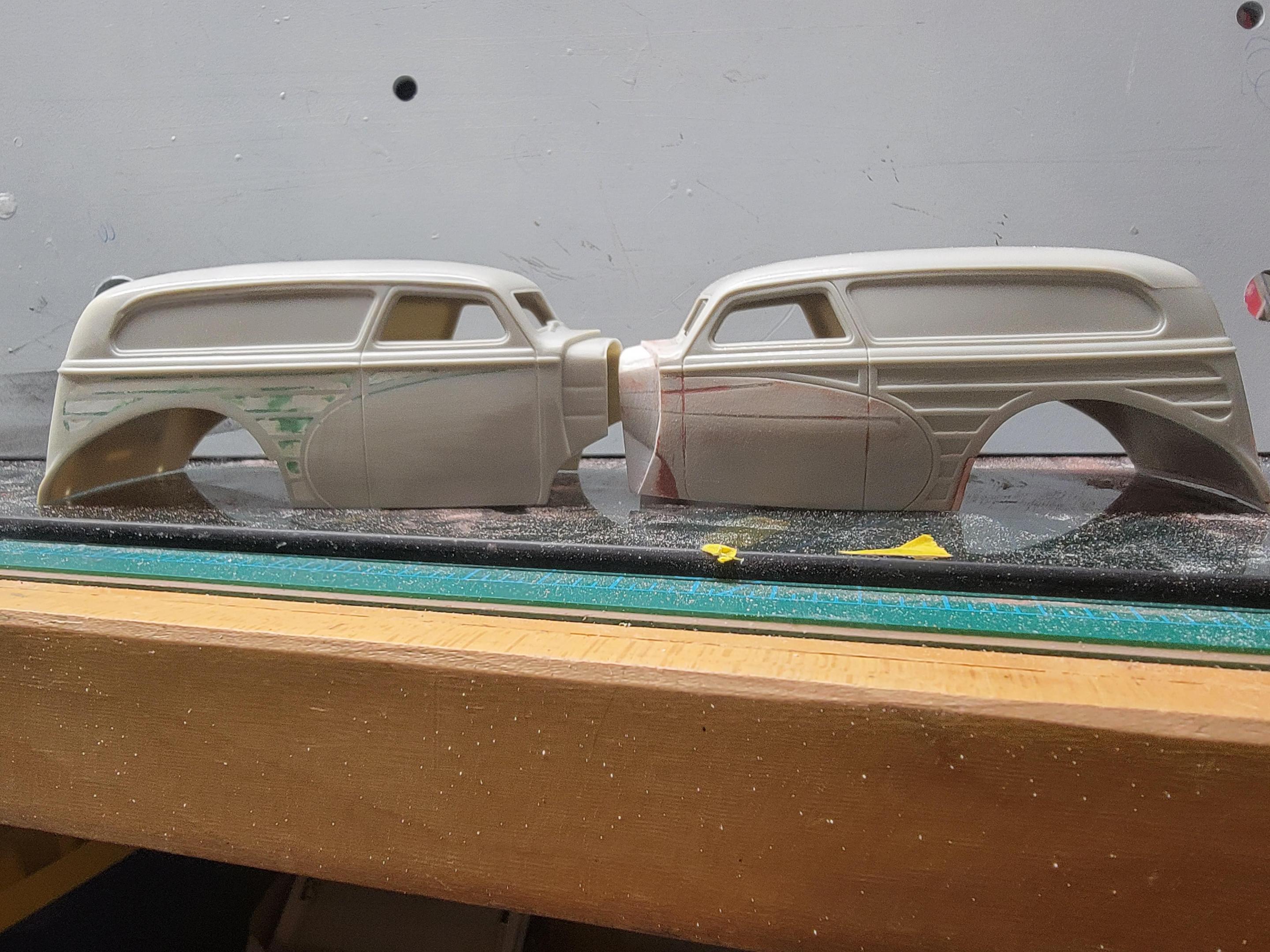

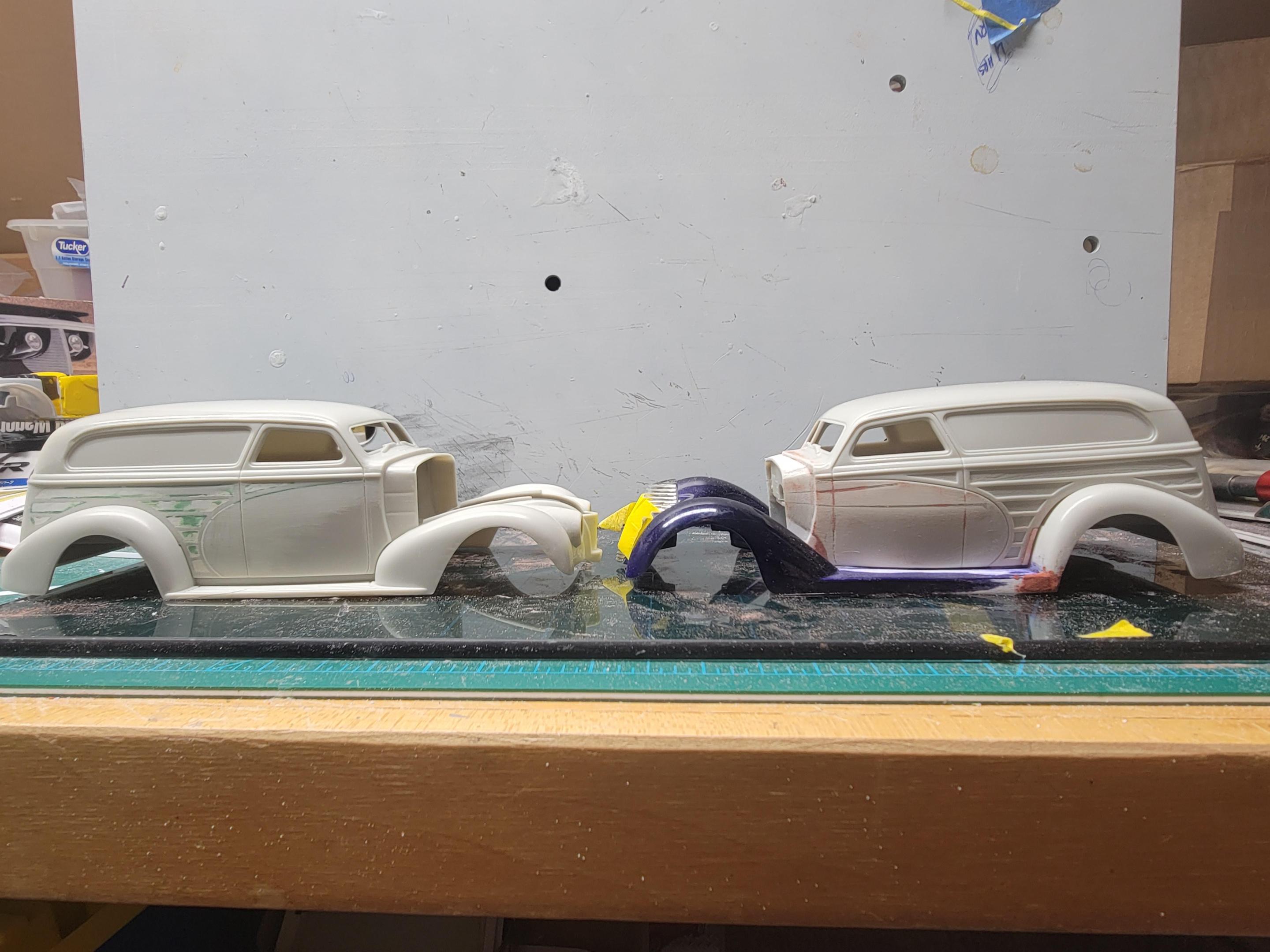

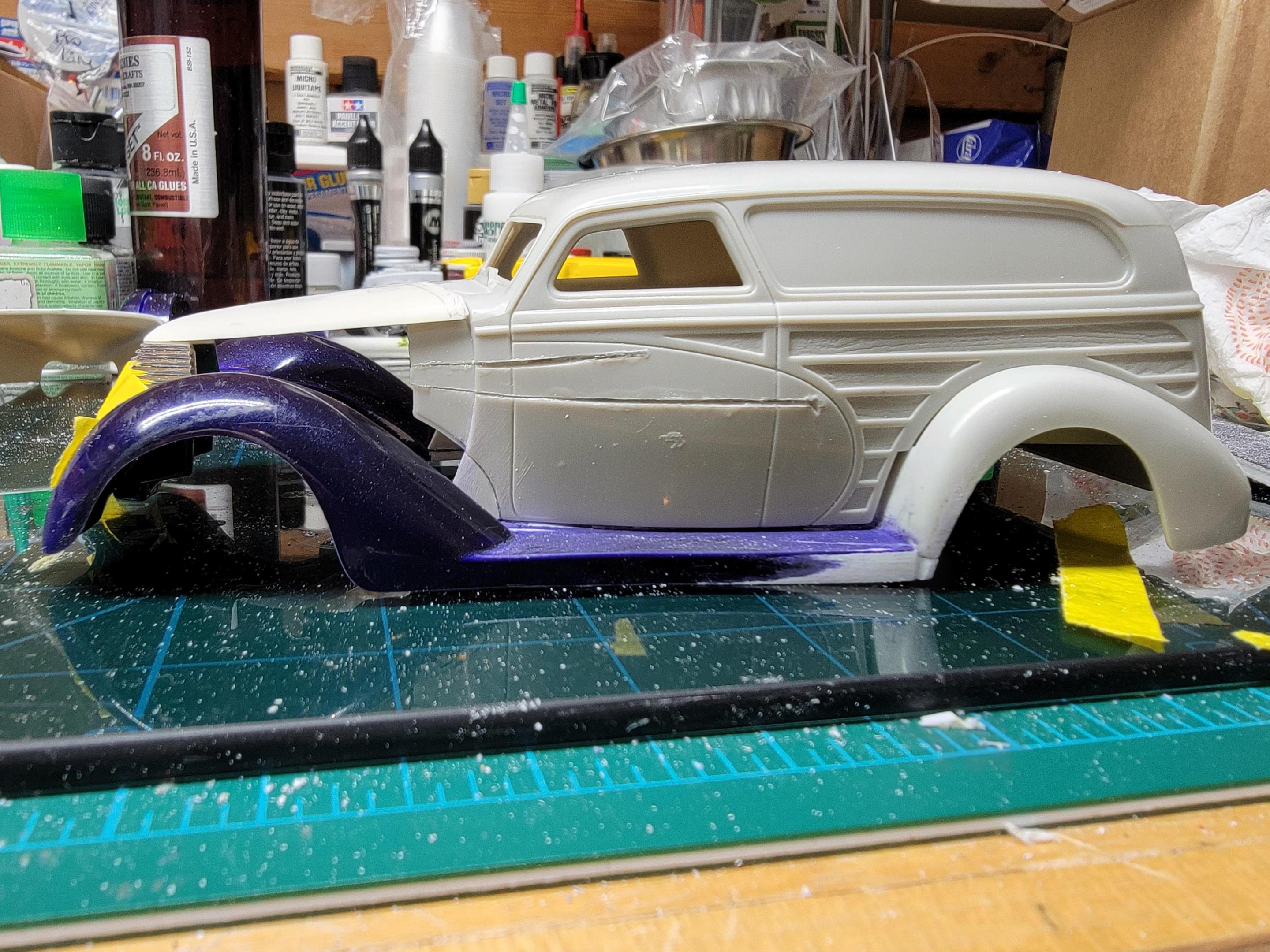

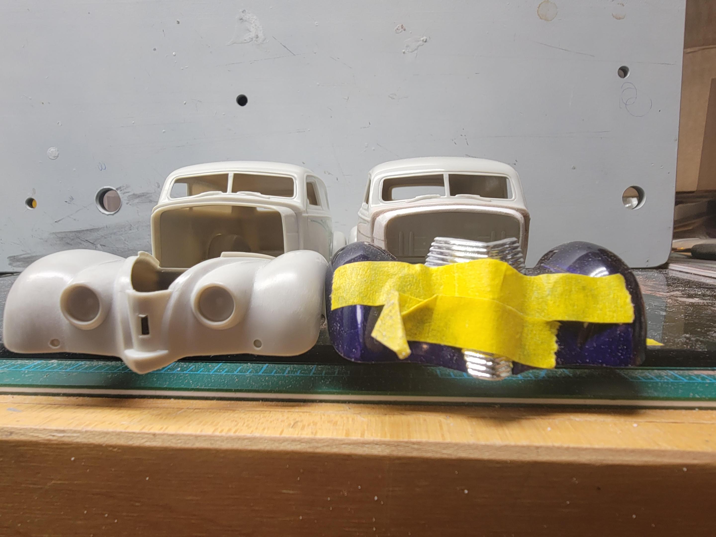

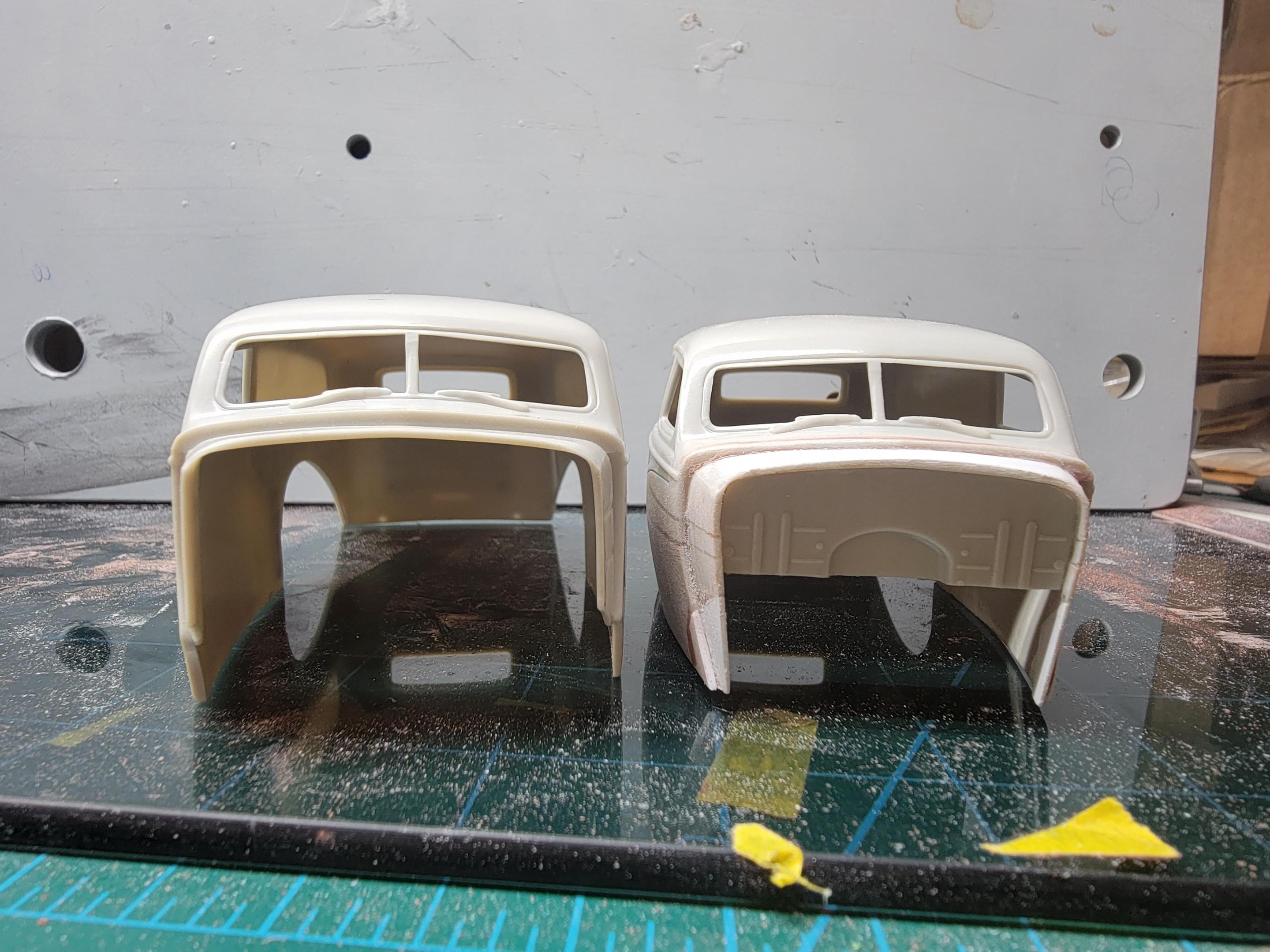

Modlbldr Posted October 31, 2021 Author Posted October 31, 2021 So, this morning I was curios about how much change I had really made in the body with my modifications. I dug out another body (the previous owner had filled in the wood) to take comparison shots. There is a marked difference so far. Later-
