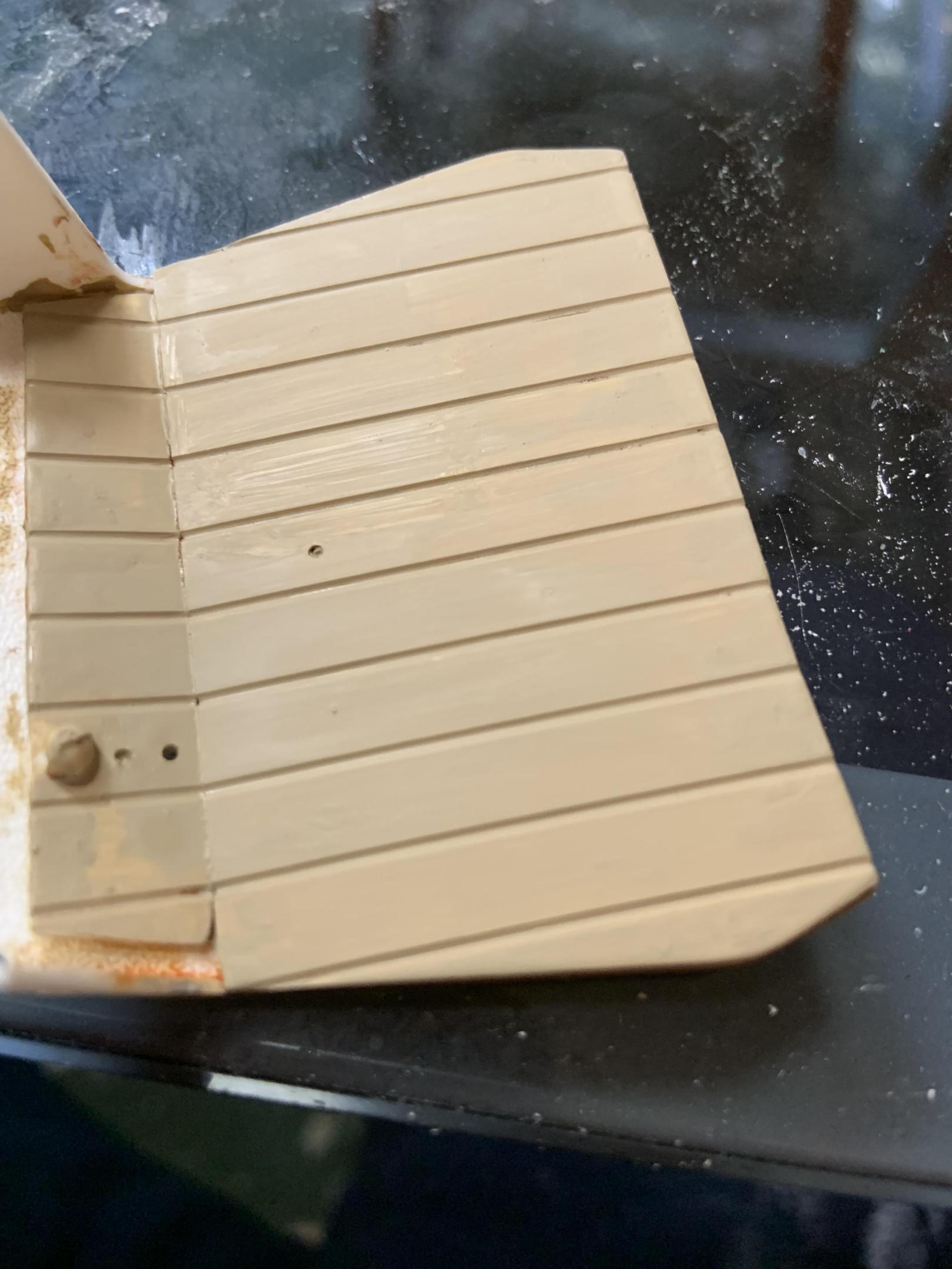

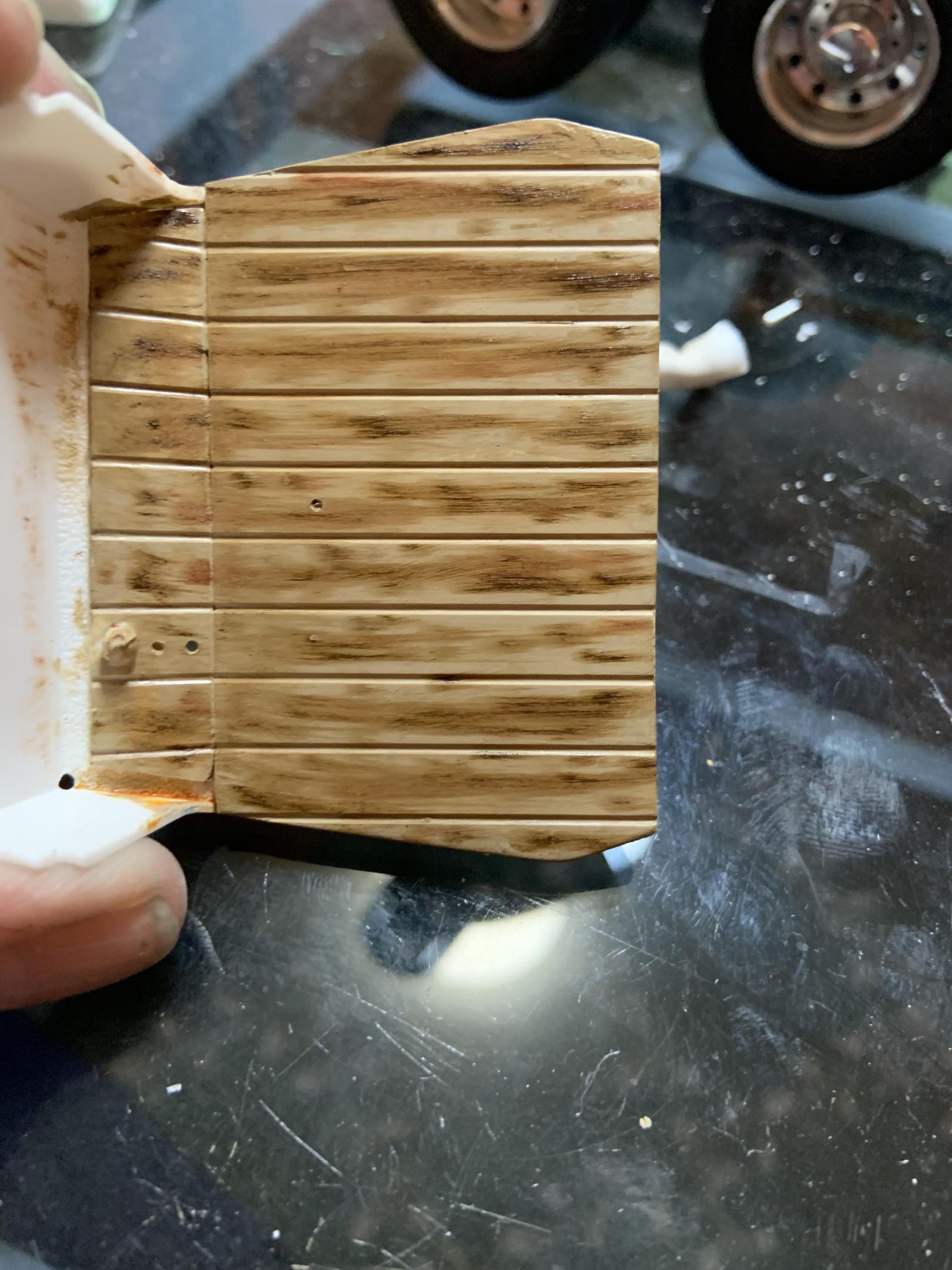

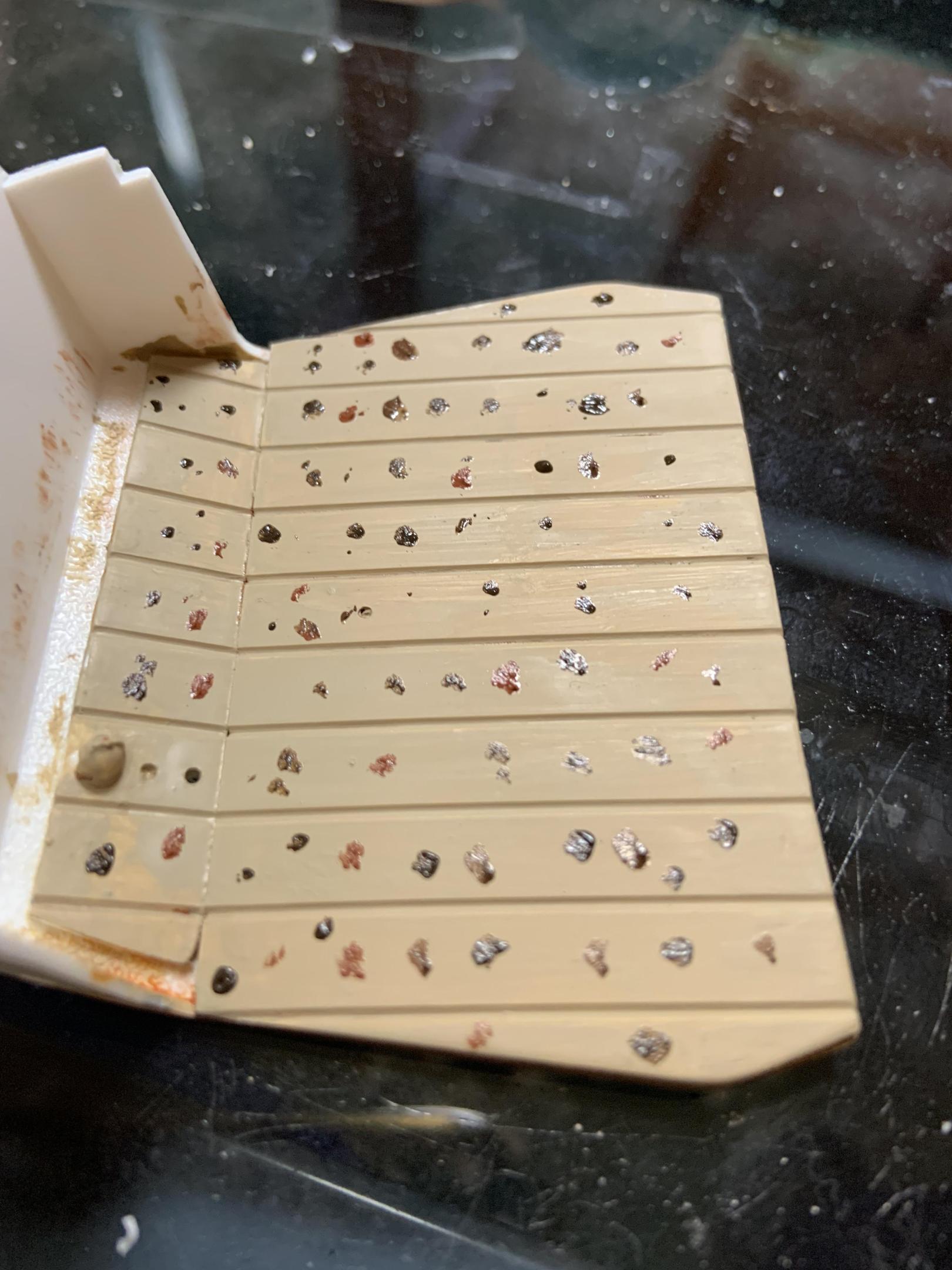

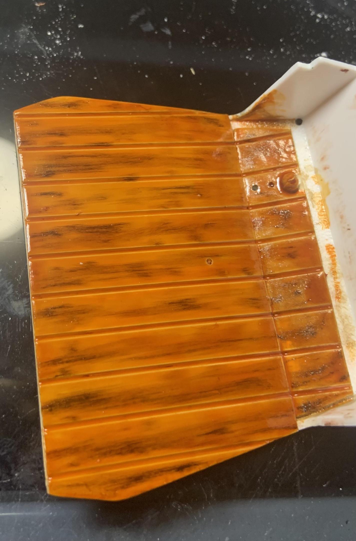

Fantom Posted October 26, 2021 Posted October 26, 2021 So I thought I’d make a short tutorial on how I do wood grain…I’m using this for a wood floor in my Peterbilt. step 1 I apply a coat of Tamiya xr 57 buff, but any acrylic light tan would work, let this dry completely. step 2 Using oil paint, I don’t on small spots of burnt umber ,raw umber, burnt sienna raw sienna, all different shades of brown. step 3 Before the oil paint dries, drag a soft wide brush through the spots, lightly blending the browns. Let this dry for several days and make sure it’s completely dry. step 4 Apply coats of Tamiya x26 clear orange. Coat until your happy with the color Hope this helps, would work well in a truck bed.

ChopSauce Posted October 31, 2021 Posted October 31, 2021 (edited) Great technique. The final coat of clear orange is what makes the outcome really look like varnished (pine) wood. I wish I could know some more about the brush you used, though : I have the feeling that a soft brush would lay/blend the color but your pictures show strikes instead, like the brush was rather pretty hard? Edited October 31, 2021 by ChopSauce
Cin0s3 Posted November 2, 2021 Posted November 2, 2021 On 10/31/2021 at 3:32 AM, ChopSauce said: Great technique. The final coat of clear orange is what makes the outcome really look like varnished (pine) wood. I wish I could know some more about the brush you used, though : I have the feeling that a soft brush would lay/blend the color but your pictures show strikes instead, like the brush was rather pretty hard? I would guess a fan brush if you have one its very wide and extremely flexible, impossible to paint with but easily used to drag
showrods Posted November 4, 2021 Posted November 4, 2021 On 11/2/2021 at 9:41 AM, Cin0s3 said: I would guess a fan brush if you have one its very wide and extremely flexible, impossible to paint with but easily used to drag I don't know anything about this type of oil paint but can you just run a brush over it and have it spread properly? Would it not have to be thinned?
Fantom Posted November 4, 2021 Author Posted November 4, 2021 26 minutes ago, showrods said: I don't know anything about this type of oil paint but can you just run a brush over it and have it spread properly? Would it not have to be thinned? No it does not need to be thinned….. and really whatever brush you use to blend or wipe it doesn’t really matter as long as it’s wide enough to create whatever look your going for
