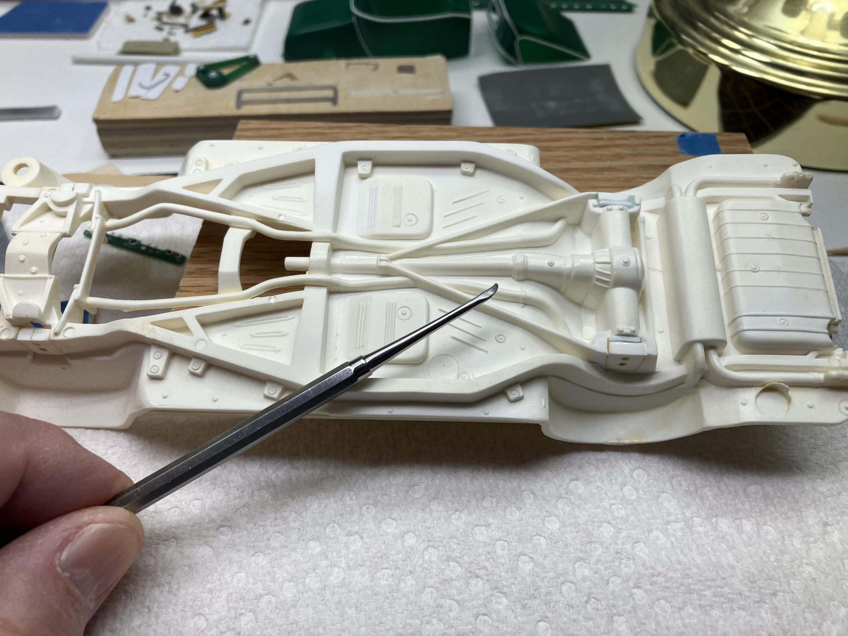

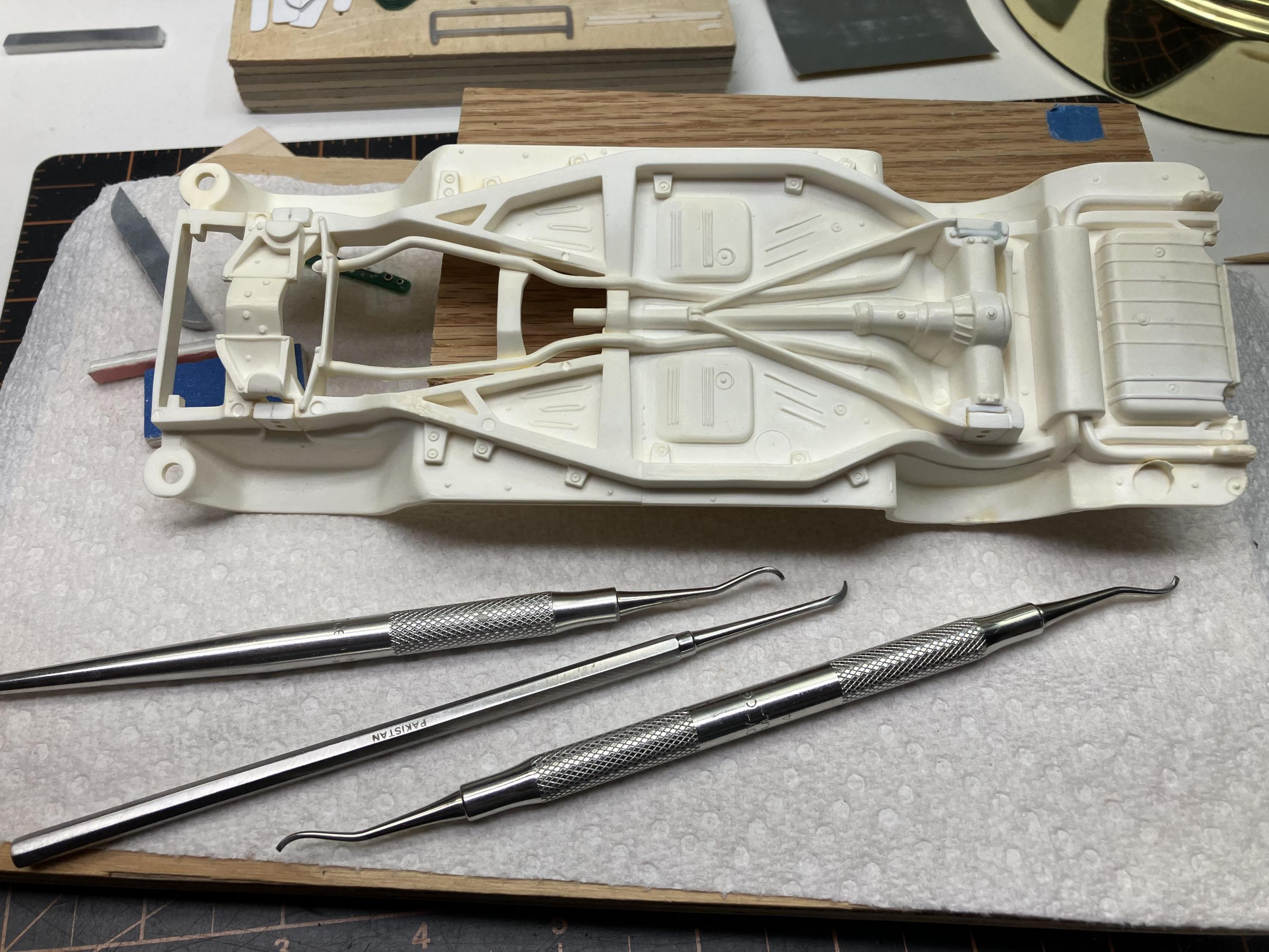

Joe Nunes Posted January 29, 2023 Posted January 29, 2023 On an old model kit build or restoration, like the original issue AMT 1960 Buick Invicta HT, kit 5560 ‘60 149, that I have been working on, I want to keep the original “look” of the model including the one piece chassis. I am using a scriber and a couple of dental tools along with a #11 dull point blade to carefully remove plastic from around the items that I want to be a bit rounded where the plastic meets the chassis. This should provide a shadow effect when painting the chassis…or at least clean it up some. ? Joe 2
doorsovdoon Posted February 2, 2023 Posted February 2, 2023 On 1/29/2023 at 6:28 PM, Joe Nunes said: I am using a scriber and a couple of dental tools along with a #11 dull point blade to carefully remove plastic from around the items that I want to be a bit rounded where the plastic meets the chassis. This should provide a shadow effect when painting the chassis…or at least clean it up some. ? Joe That's a good idea! I'm building the AMT 1970 Impala, and although the exhausts are separate, the chassis and fuel tank are moulded to the floors. I'm gonna try that.? 1
