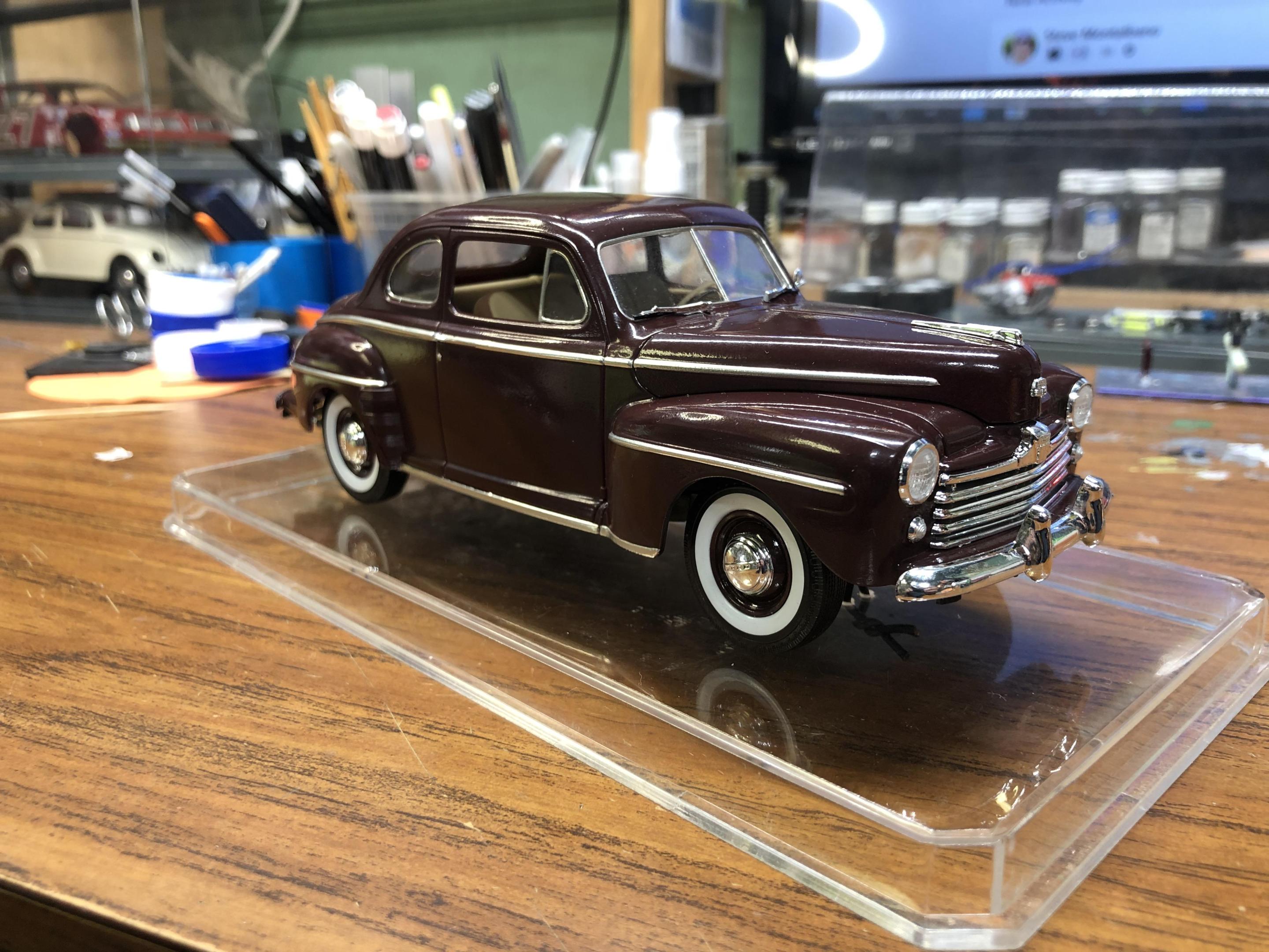

Zippi Posted October 30, 2021 Posted October 30, 2021 I use craft acrylic paints on all my bodies. Since I use Rust-Oleum Flat Gray primer I like the Anits's brand since it is made by Rust-Oleum. I also use the Delta Ceramcoat paint. I just finished this 34 pickup and it was airbrushed with FolkArt acrylic paint since the Anita's brand didn't have the color I wanted.

Dave G. Posted November 1, 2021 Posted November 1, 2021 On 10/30/2021 at 7:18 AM, Zippi said: I use craft acrylic paints on all my bodies. Since I use Rust-Oleum Flat Gray primer I like the Anits's brand since it is made by Rust-Oleum. I also use the Delta Ceramcoat paint. I just finished this 34 pickup and it was airbrushed with FolkArt acrylic paint since the Anita's brand didn't have the color I wanted. Nice color combo, great job !
Zippi Posted November 1, 2021 Posted November 1, 2021 1 hour ago, Dave G. said: Nice color combo, great job ! Thank you sir.

Zippi Posted November 2, 2021 Posted November 2, 2021 HL is where I get all my acrylic paints. I like the Delta Ceramcoat paints as well as Anita's and FolkArt now since it came out pretty good on my 34 pickup.

Andrew McD Posted November 14, 2021 Posted November 14, 2021 Zippi - Love the tow truck. Color choices and quality of build look outstanding!
