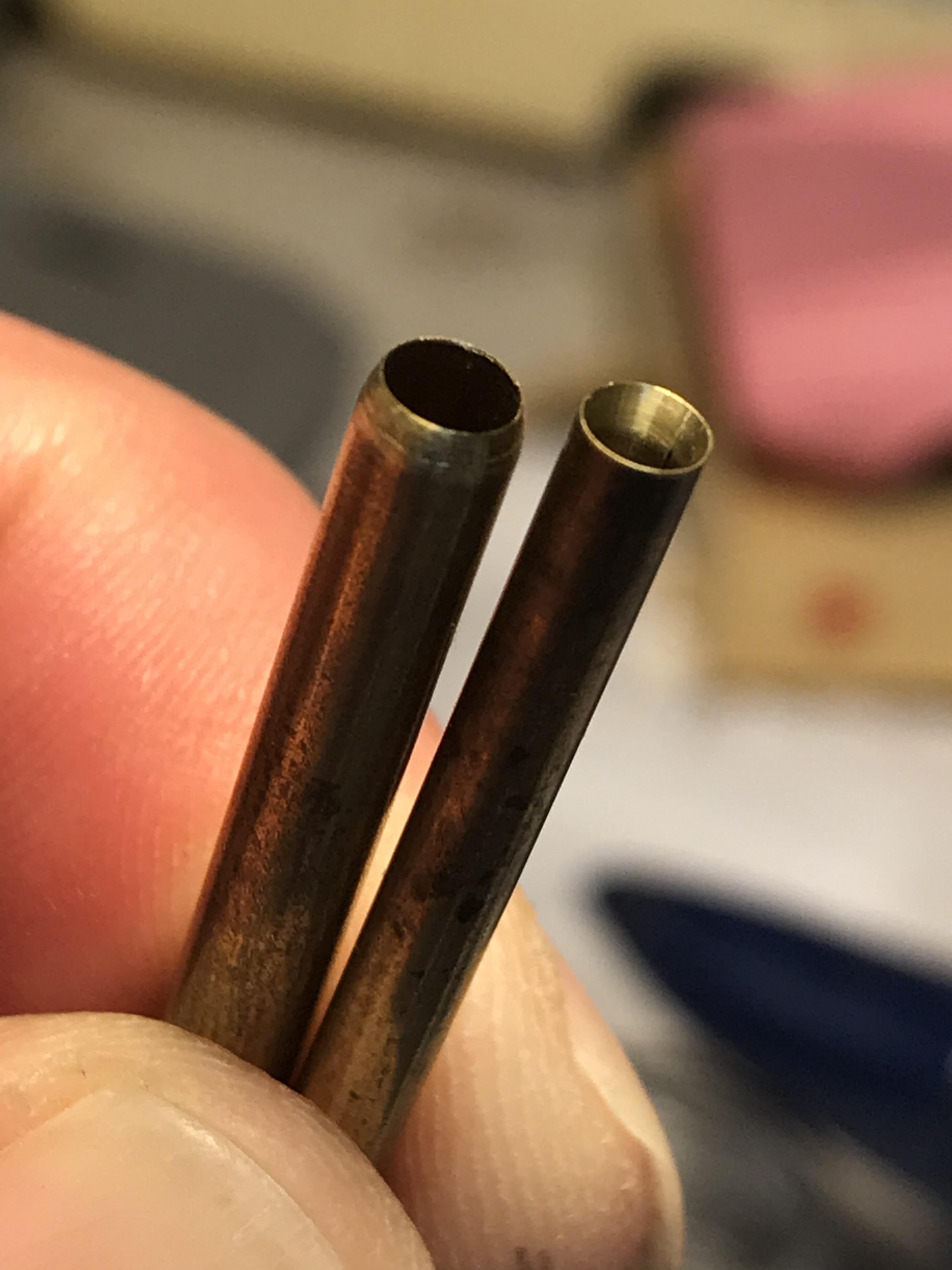

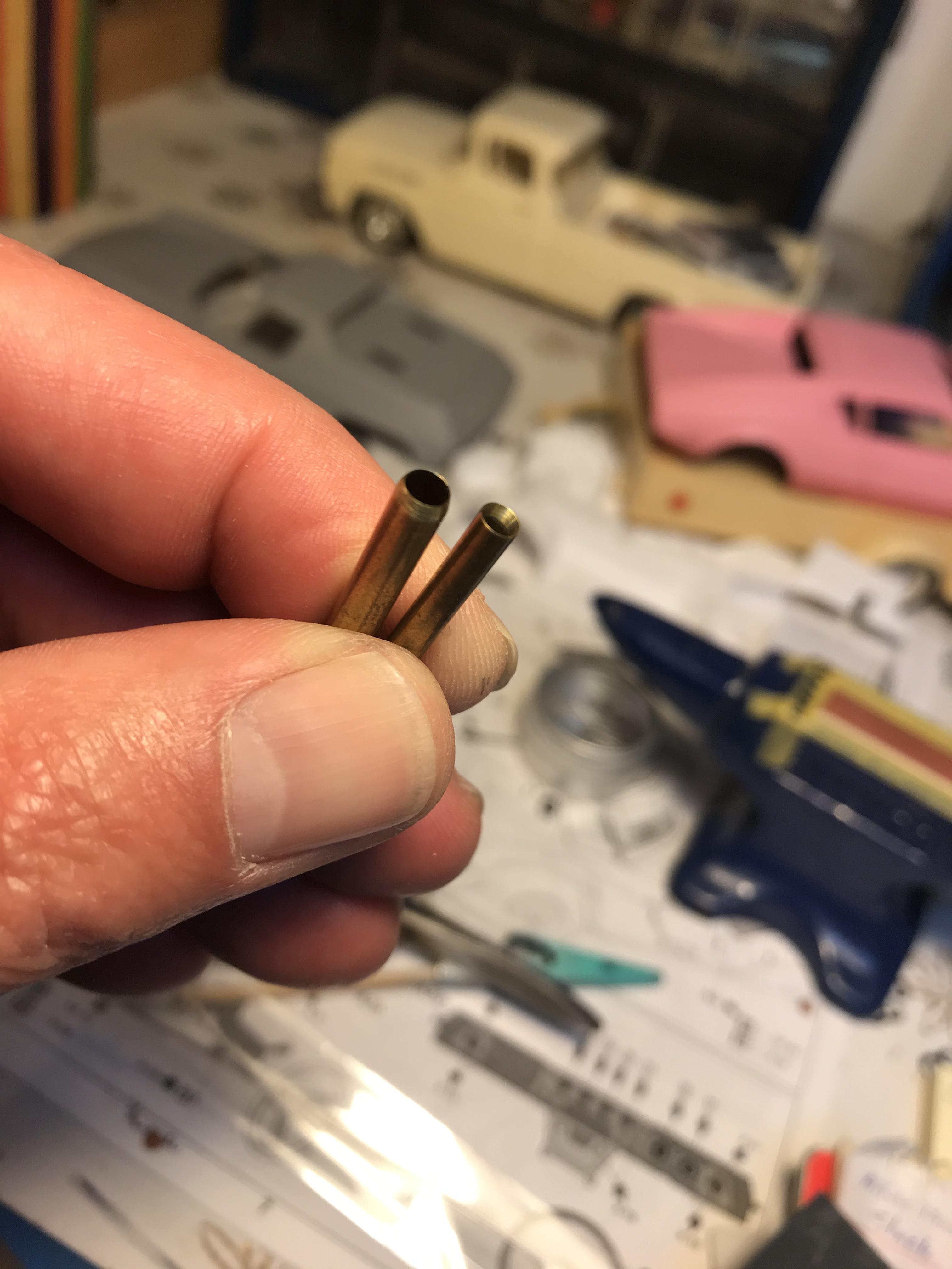

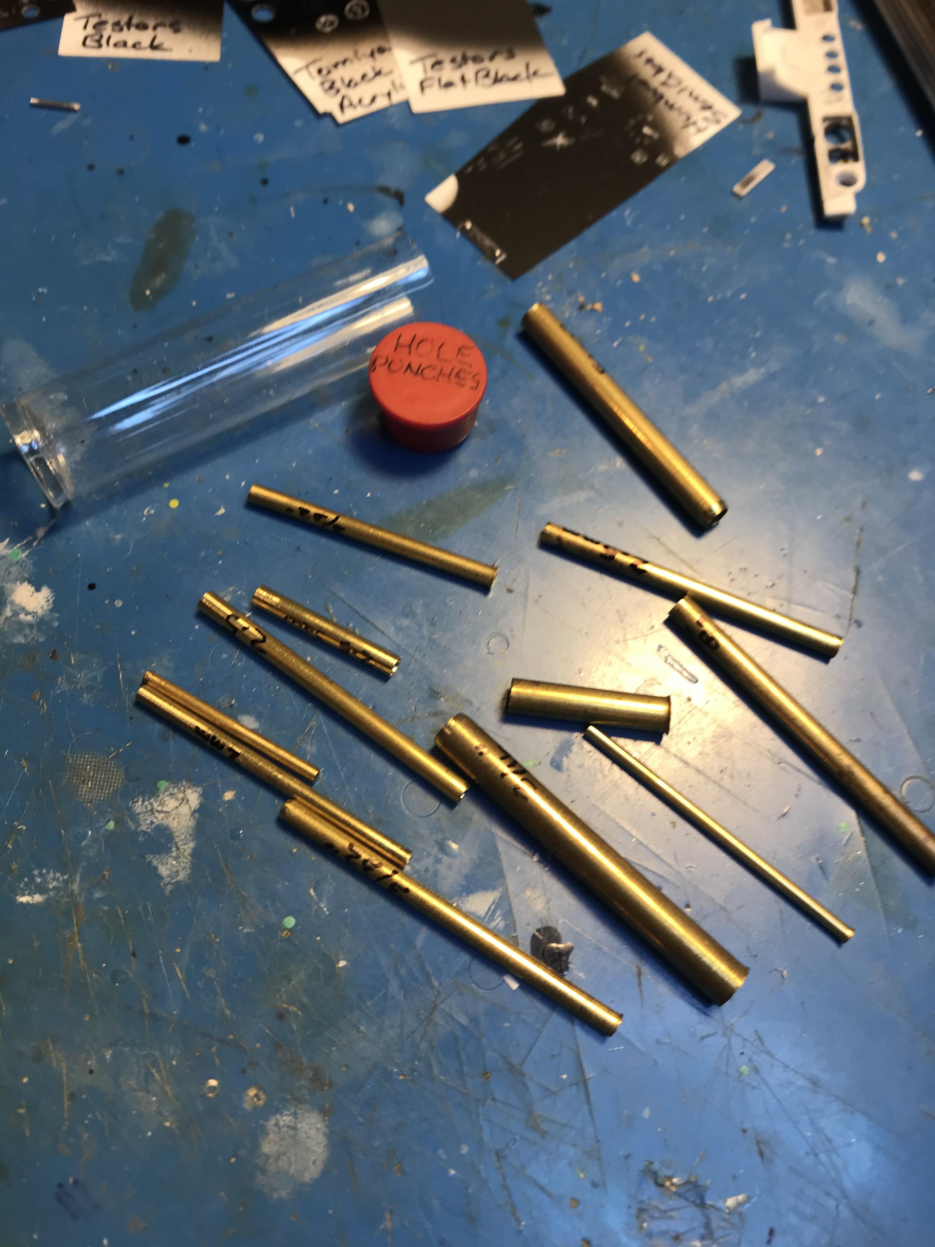

peteski Posted October 30, 2021 Posted October 30, 2021 (edited) To have a wide variety of sizes (for things like gauges) I make my own punches by sharpening the ends of K&S Metals telescoping brass tubing I chuck a piece (that has a square-cut end) in a Dremel (or larger drill for larger diameter tubing) and using a file, file an edge while the tubing is spinning. I sometimes follow up with fine grit sandpaper to make the edge sharper. I then us them by hand on thin material like paper. I just place the tubing over the item I want to cut, then spin it with my fingers while also putting downward pressure on it. That results in clean cuts. Edited October 31, 2021 by peteski 2
Bainford Posted October 31, 2021 Posted October 31, 2021 Like Pete, I make punches from K&S brass tube. Some are fashioned so they cut on the ID and others on the OD. Which is used depends on whether you want the hole or the disc. It also increases the number of hole sizes you can punch. I use a small hobby hammer on them, punching into the end grain of a piece of hardwood. A block of lead works good for this purpose too. The cutting ends hold up better than expected. I cut plastic sheet up to .010”, decals, different tapes, sand paper, and even thin aluminum. Occasionally the end will need to be dressed. I also have a couple made from hypodermic tube, one as small as .010”, for the holes in the leather strap holding the bonnet of a Jag XK120. I’ll replace some of the brass punches with hypo tube as I get more sizes. They will last longer than the brass, but are more difficult to form the cutting end.

Straightliner59 Posted November 2, 2021 Posted November 2, 2021 I have several sets of punches (Harbor Freight, Micro Mark, Tandy), and a few loose ones, and some I made from tubing. I don't think you can ever have too many tools.
