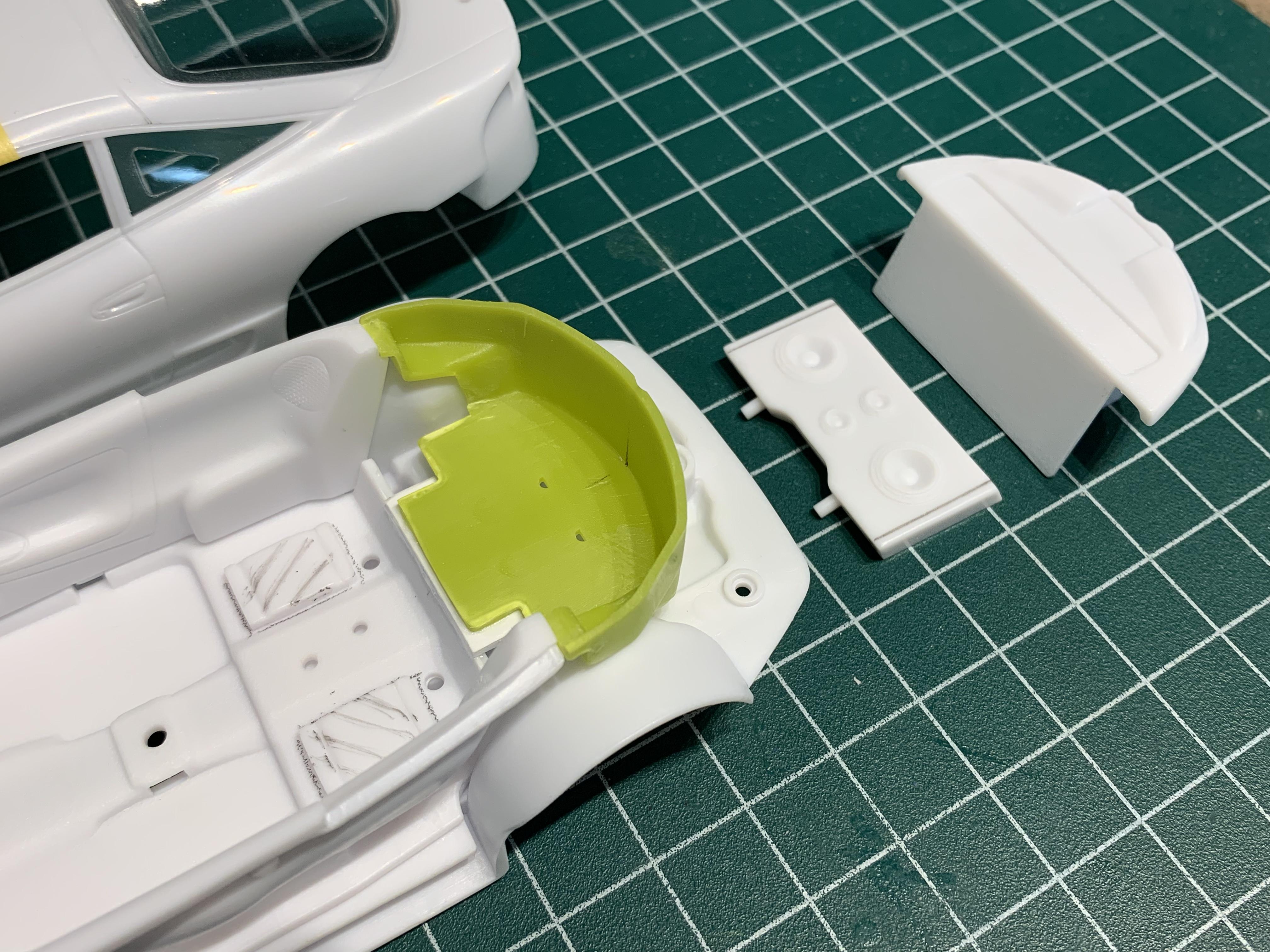

The rear interior of both kits did not accurately show what was behind the front seats, so I decided to add all the missing details to this model and used the AMT’s rear interior and amalgamated them both.
I will remove the stereo amplifiers and place them in the rear hatch. The back seat mounted sub woofer wall will be converted into a sub woofer box and will also be moved to the back hatch area with the amplifiers. The rear seat wall and hatch cover will be repurposed into a deck that will cover up the rear seats and provide a place for the two NOS bottles to be mounted to.

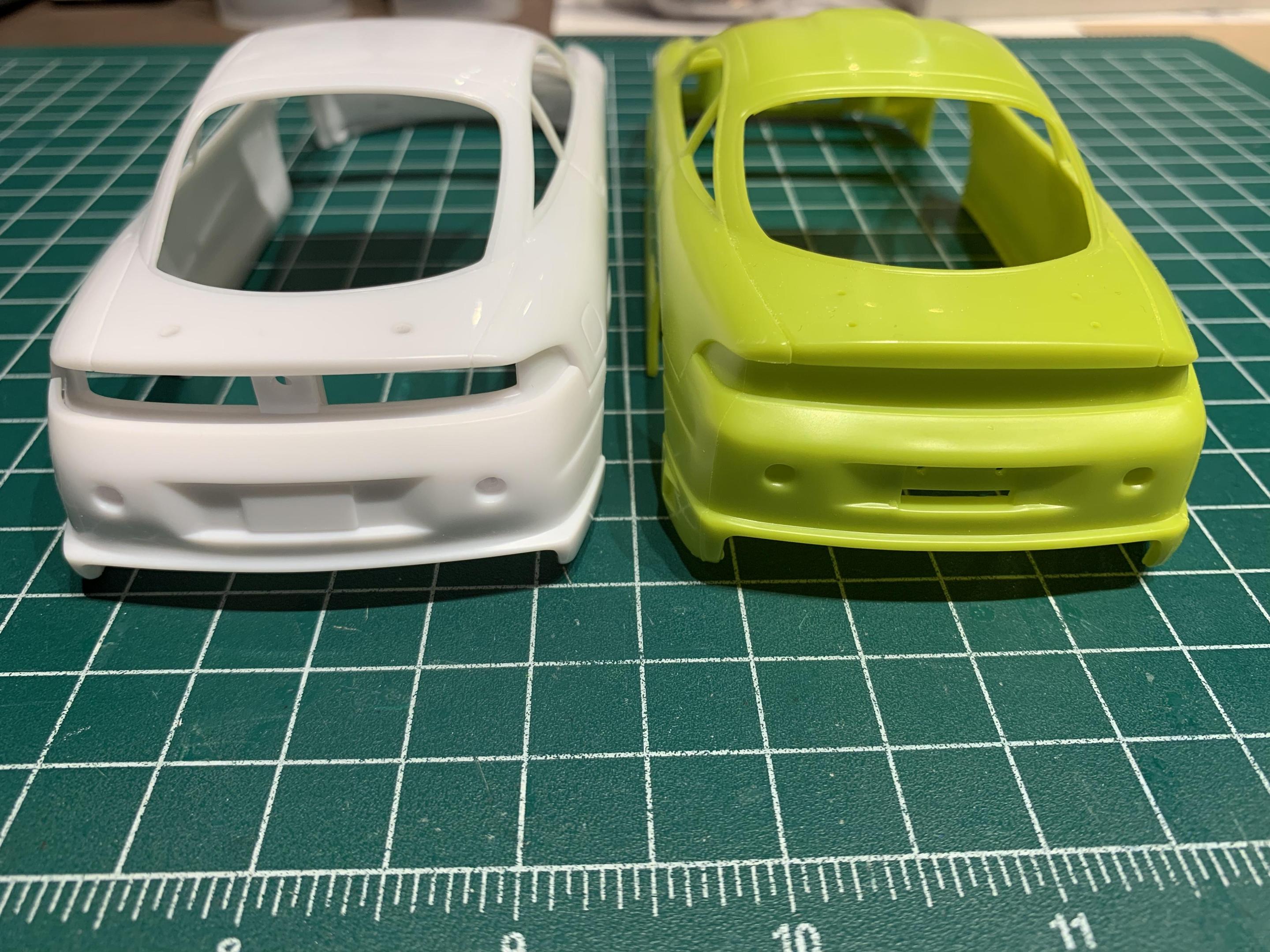

I have always preferred Revell kits over AMT, as I think the Revell kits have cleaner molds. However, this AMT kit was released in 2004 and the quality is much better than their earlier releases.
The AMT kit has more parts that are true to the movie car. Examples would be a more detailed rear deck wing, aftermarket rear view mirrors, hood pins and aftermarket engine gauges installed in the passenger airbag location.

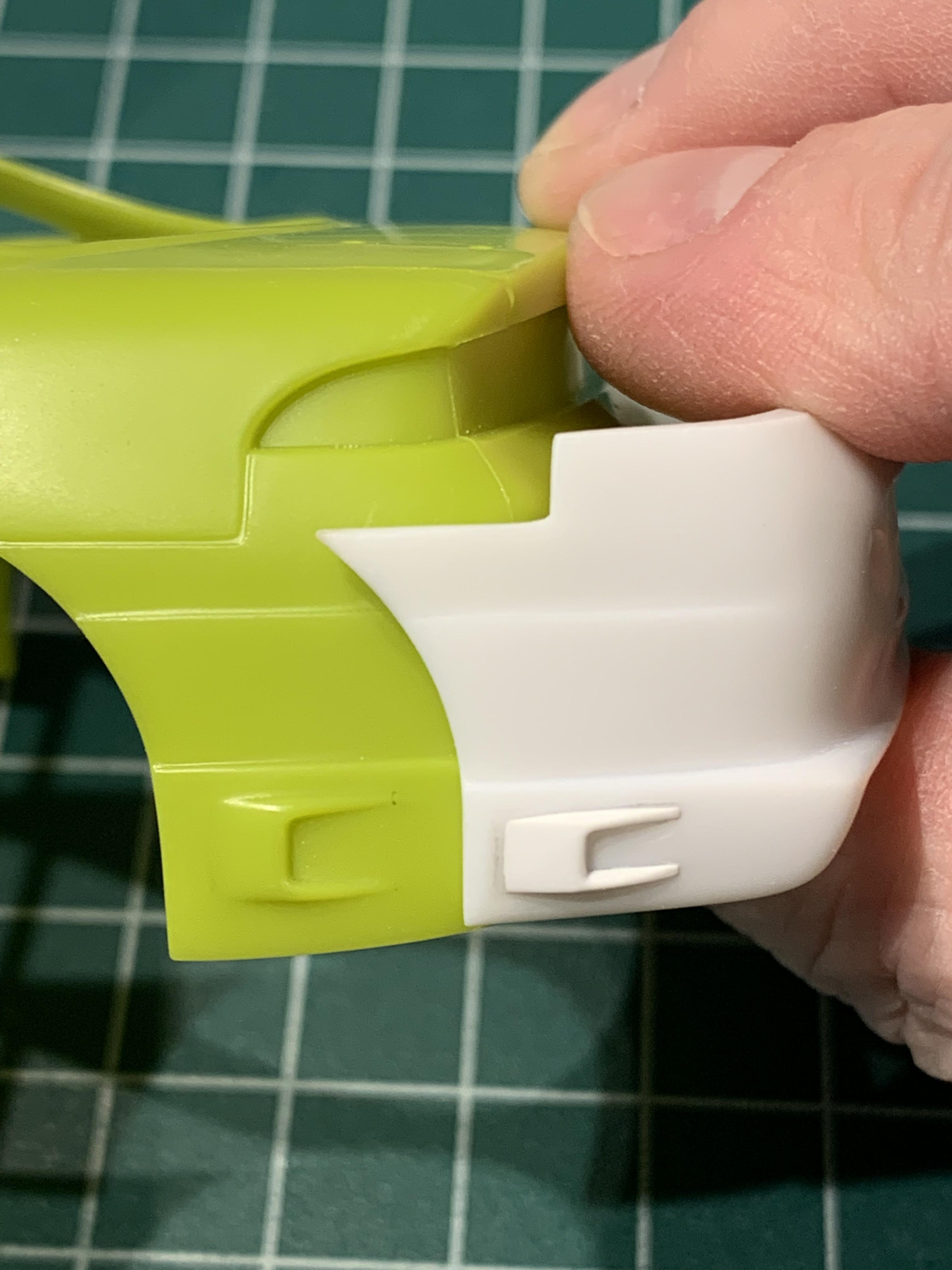

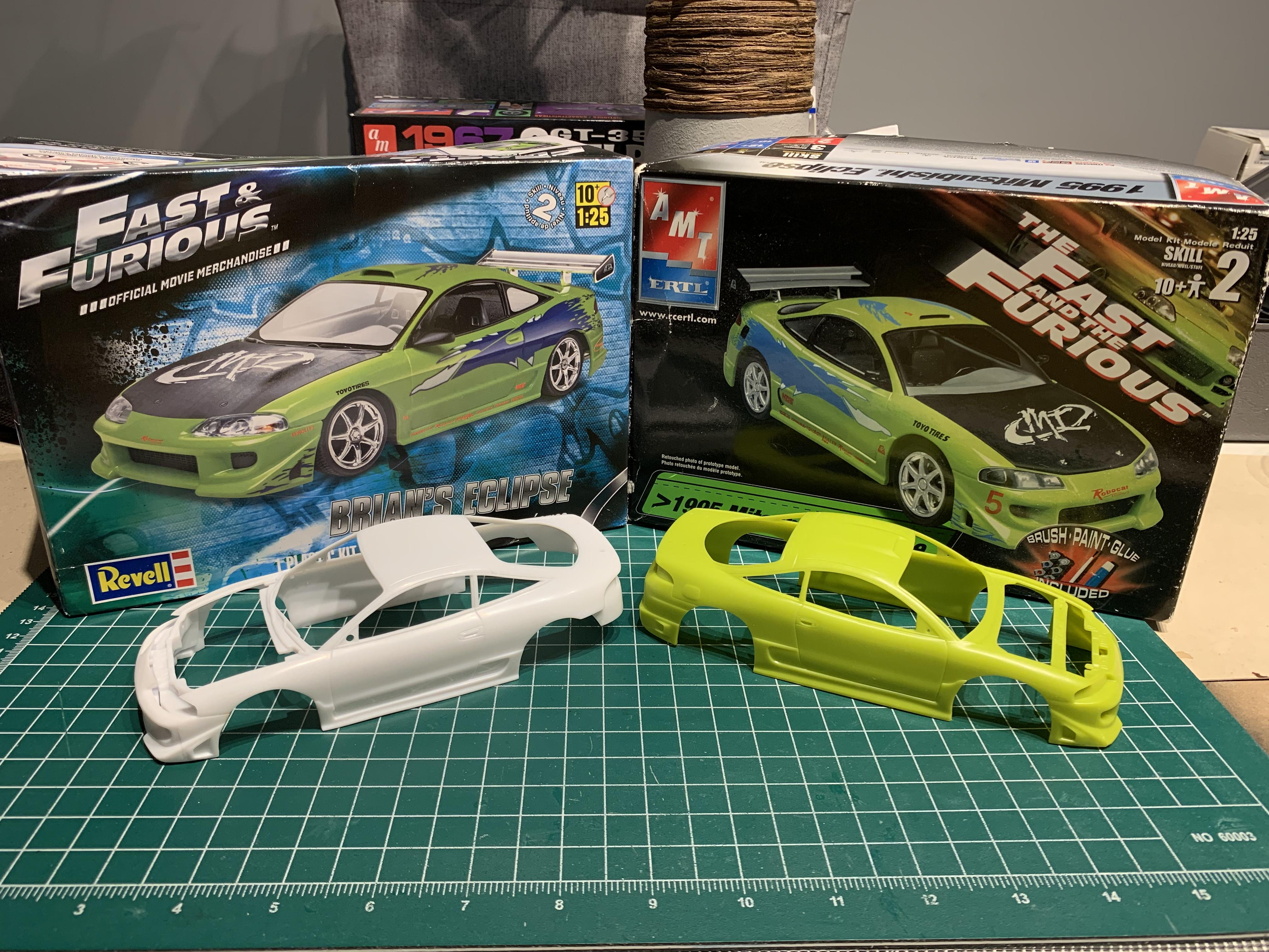

The decal sheet for the Revell kit has more decal options and the colour blue is more true to the blue on the original car (but still not accurate). I have attached some photos that show the differences in the two kits below.

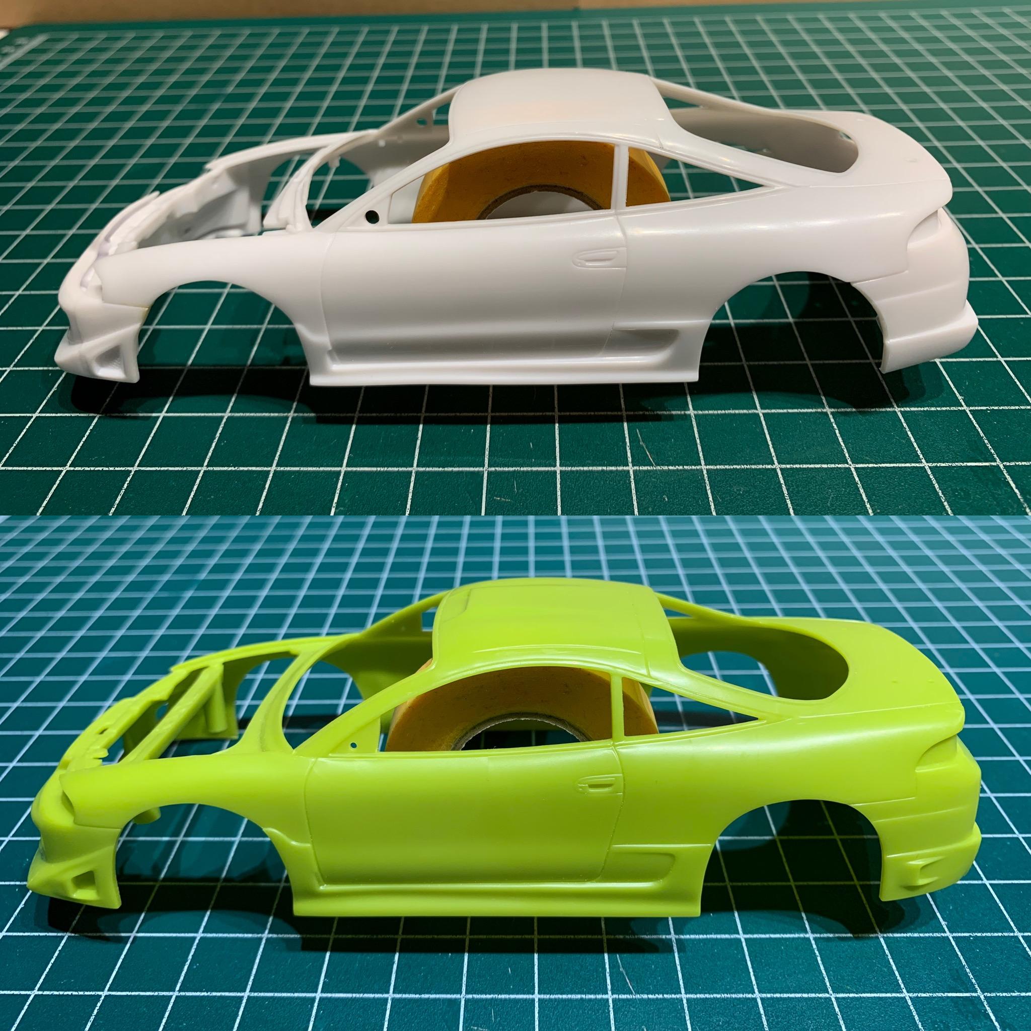

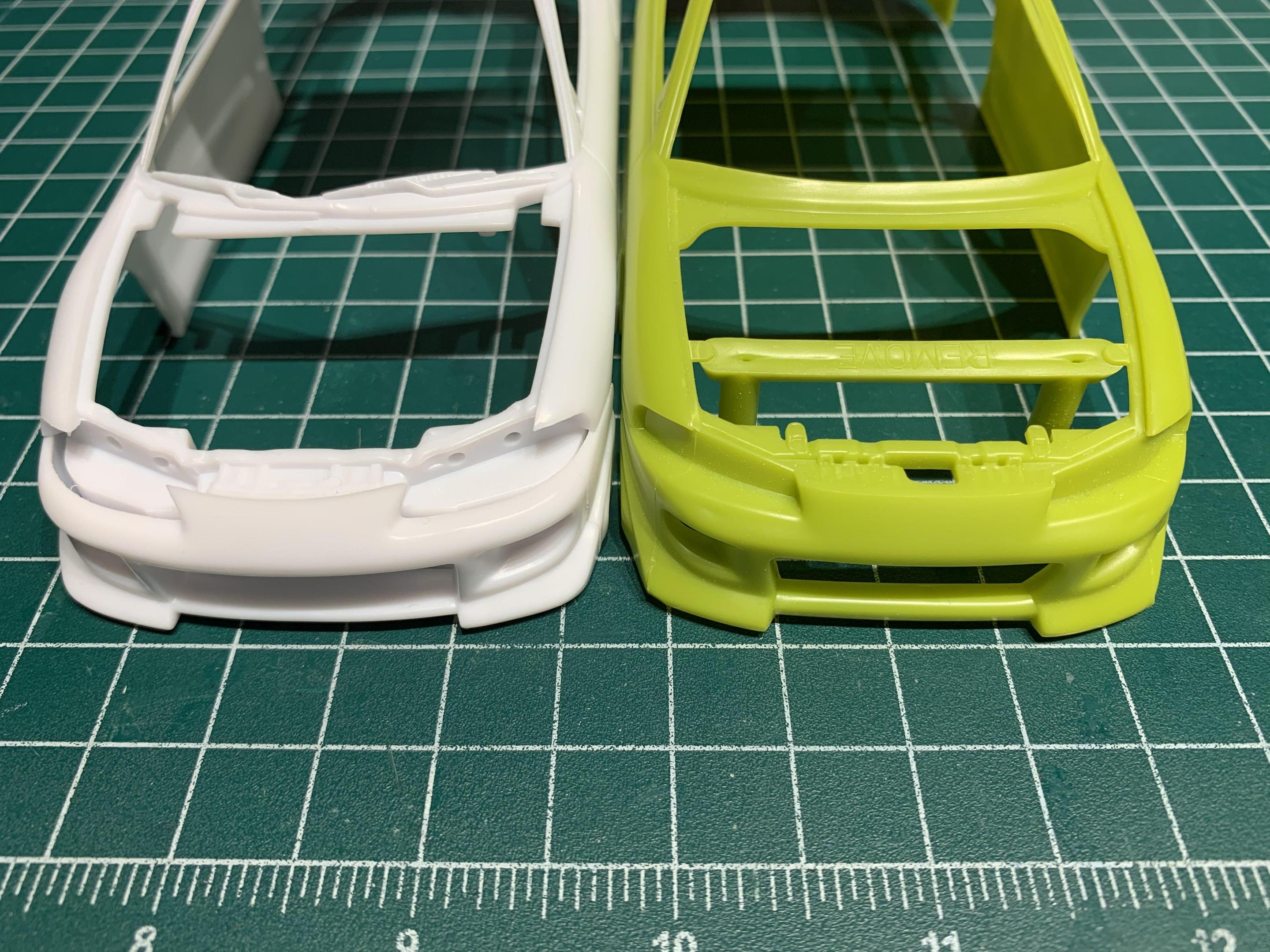

The Revell kit (above) has a two-tier wing molded into one piece with the legs as one solid piece.  I will use the AMT wing, as it is far better with more detail.
The roof vent on the AMT kit is molded into the body and looks better that the “peel & stick” one from the Revell kit.  I will be molding this part into the roof and changing the angle of the front vent from 90 to 20.
Overall kit bodies are very similar.

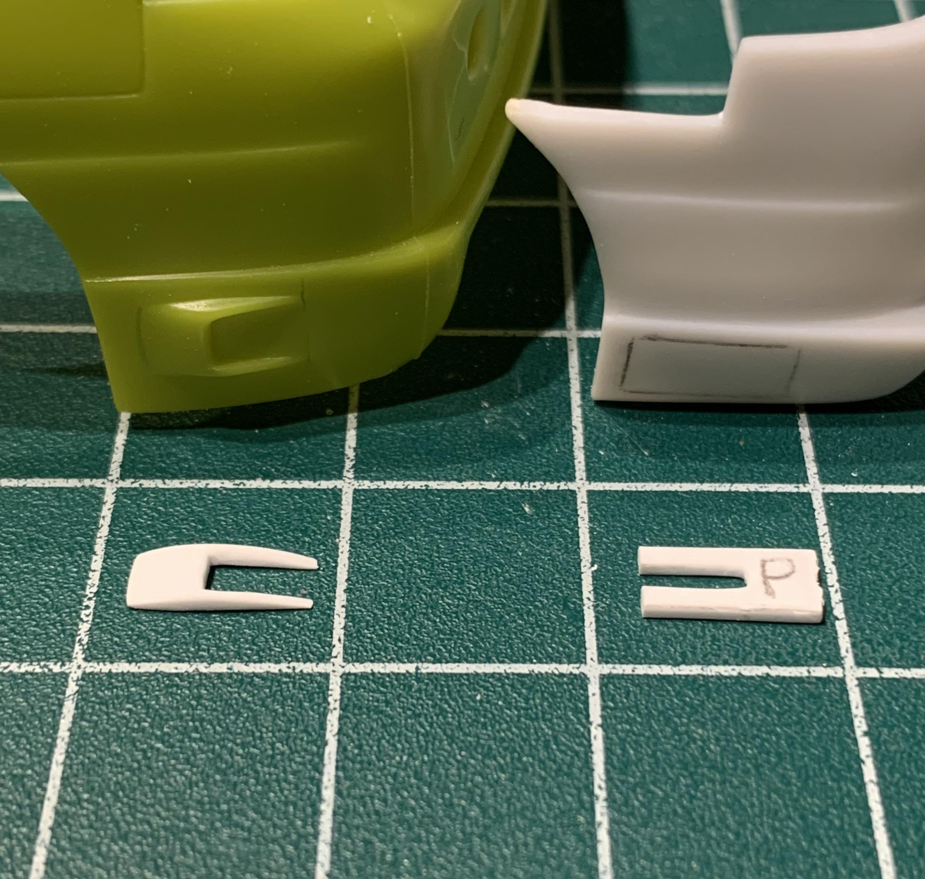

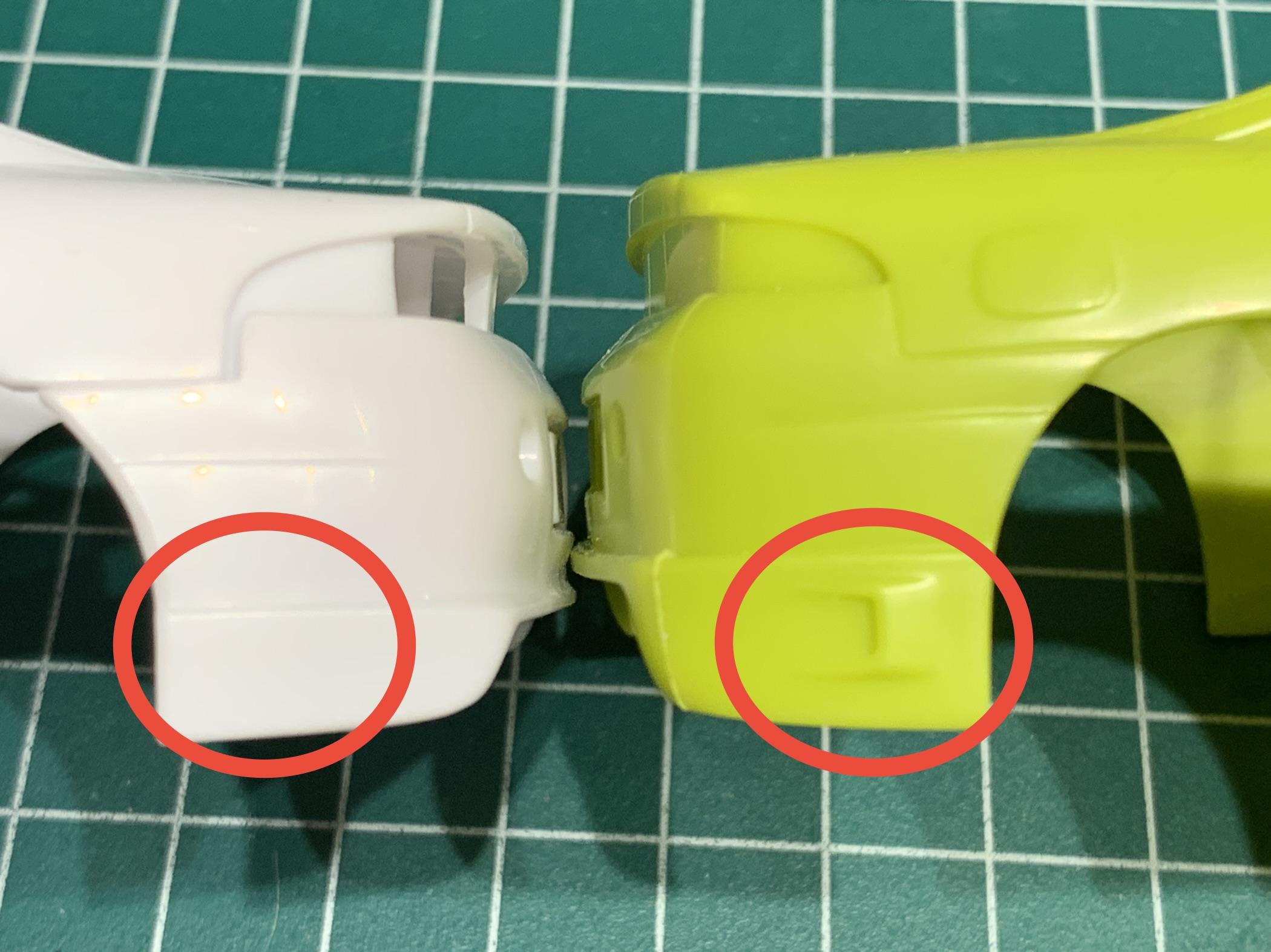

This was a very obvious fail. I will have to scratch build a faux vent to install onto the rear body kit.
The Revell kit decal sheet had higher details and options for a alternate version Eclipse to build.
Overall, I will be building the Revell kit and using parts from the AMT kit and choosing decals from both kits as well.  Also adding various aftermarket parts to make this the most detailed and correct Eclipse from the first F&F movie.

Is it just me or is the AMT(green) body taller especially in the back?
edit: just noticed by watching pictures here on the forum that the engines are very different. The Revell one seems right for the Eclipse, cam drive on DRiver side, and the AMT one seems right for a lancer, cam drive on passenger. Have I understood this right?

Yes correct. The Revell engine was another reason why I choose that kit.
The AMT body seems taller only because of the molded in roof vent. In the back though, it is very very slightly taller.

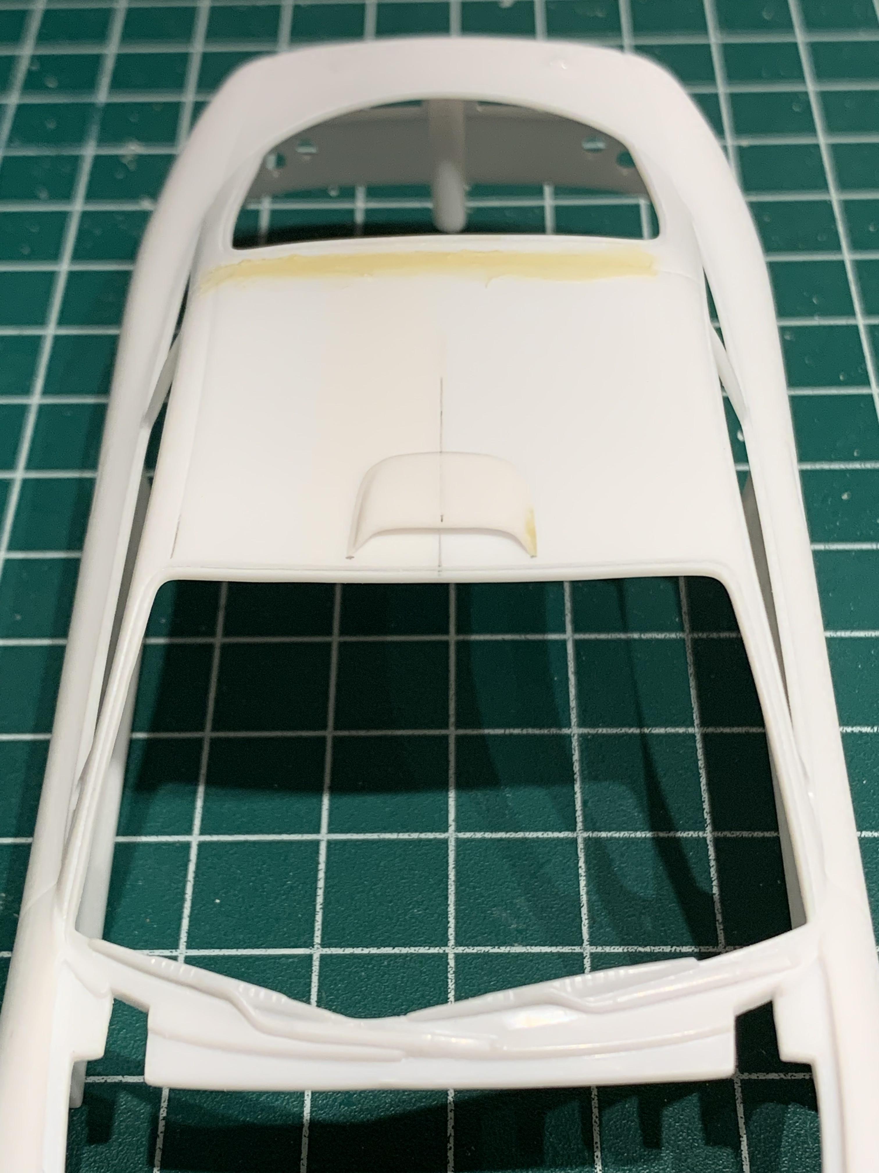

I don’t like the “peel n stick” version of this roof scoop. So, I will and some putty and mold this into the roof. Here is a reference photo.

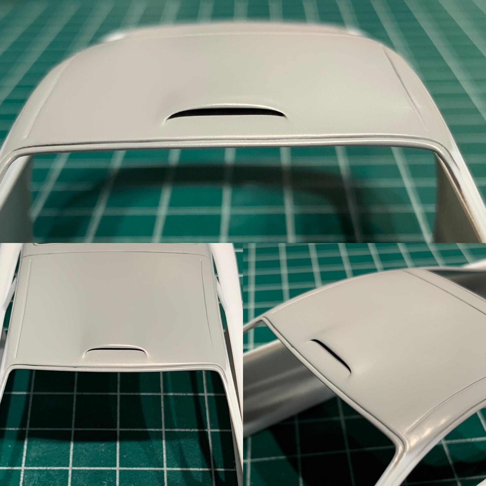

Well, I’m very happy with the results on this roof scoop. It molded in nicely. Not sure if I should prime the rest of the body with the grey primer, or if I should give it a coat of flat white. Or do both, before I spray the primary colour Kawasaki Lime Green on the body? Suggestions ?

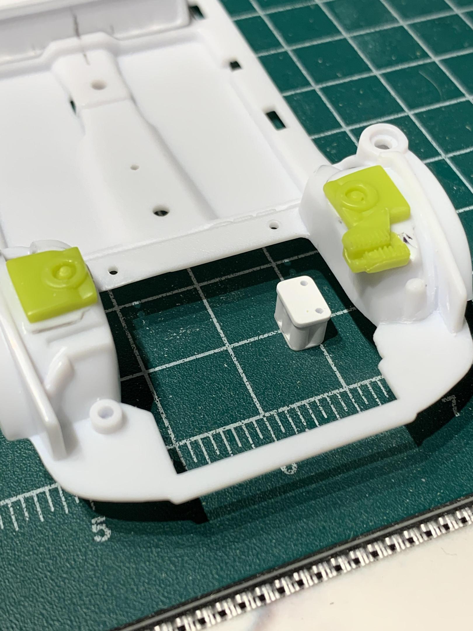

After further research, I can identify the Revell kit engine as the Mitsubishi DOHC 4G63-T which was in the Eclipse GS-T
The AMT kit engine is the 420A DOHC 2.0L 16valve which was in the original Eclipse GS (Brian’s Hero Car).
With some modifications, I was able to do a  engine swap between the two kits and also replace the strut towers.
See photo below.

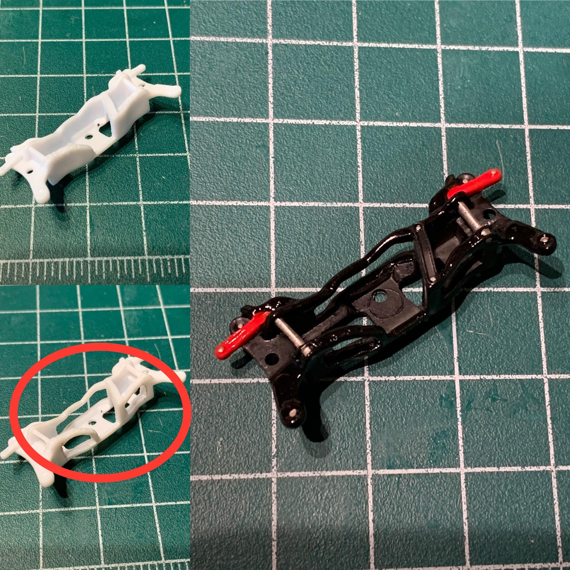

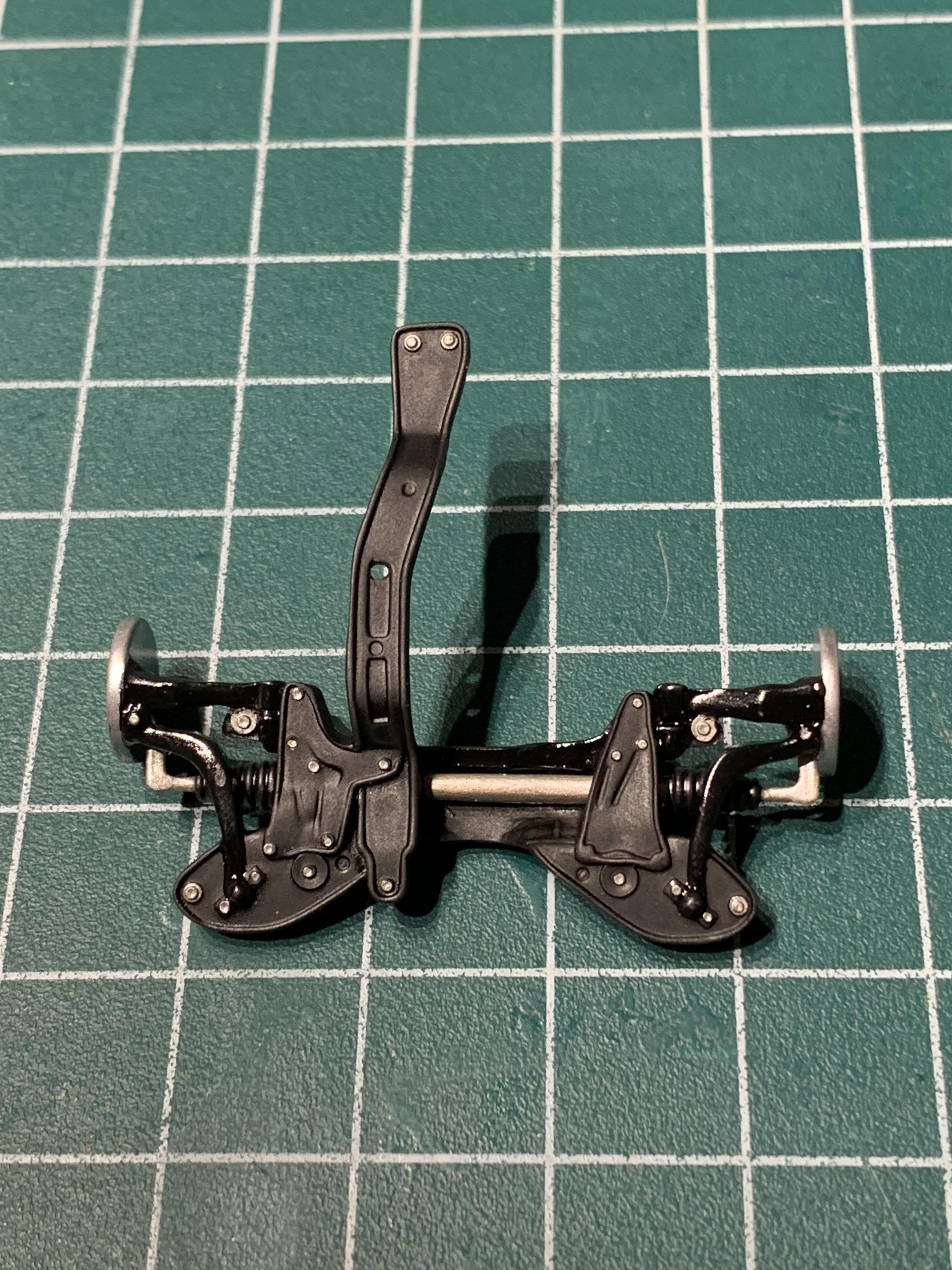

Suspension work. I removed all the excess material from the rear suspension. Thought it would give it more of an accurate look, otherwise that’s a lot of excess metal.
