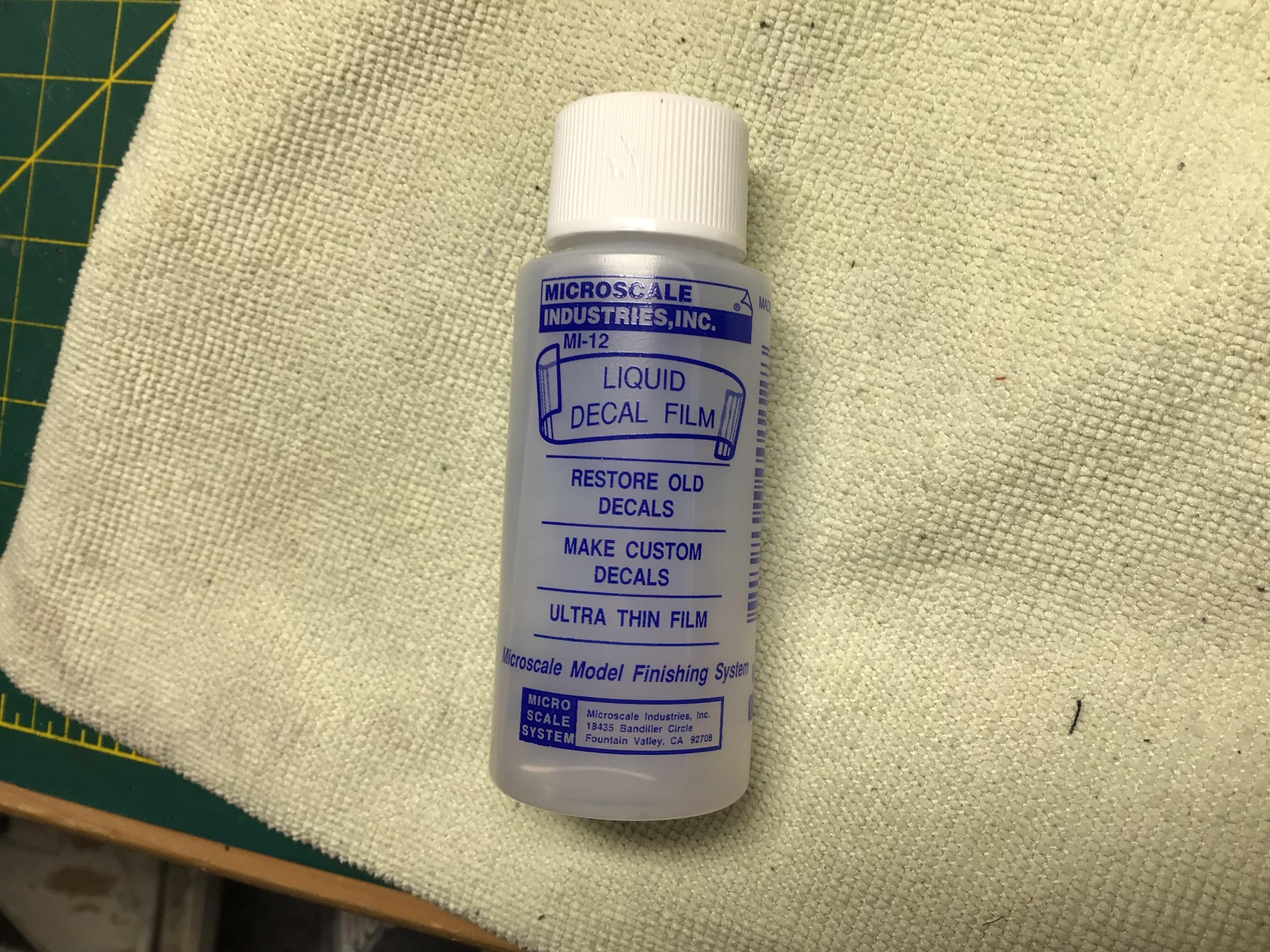

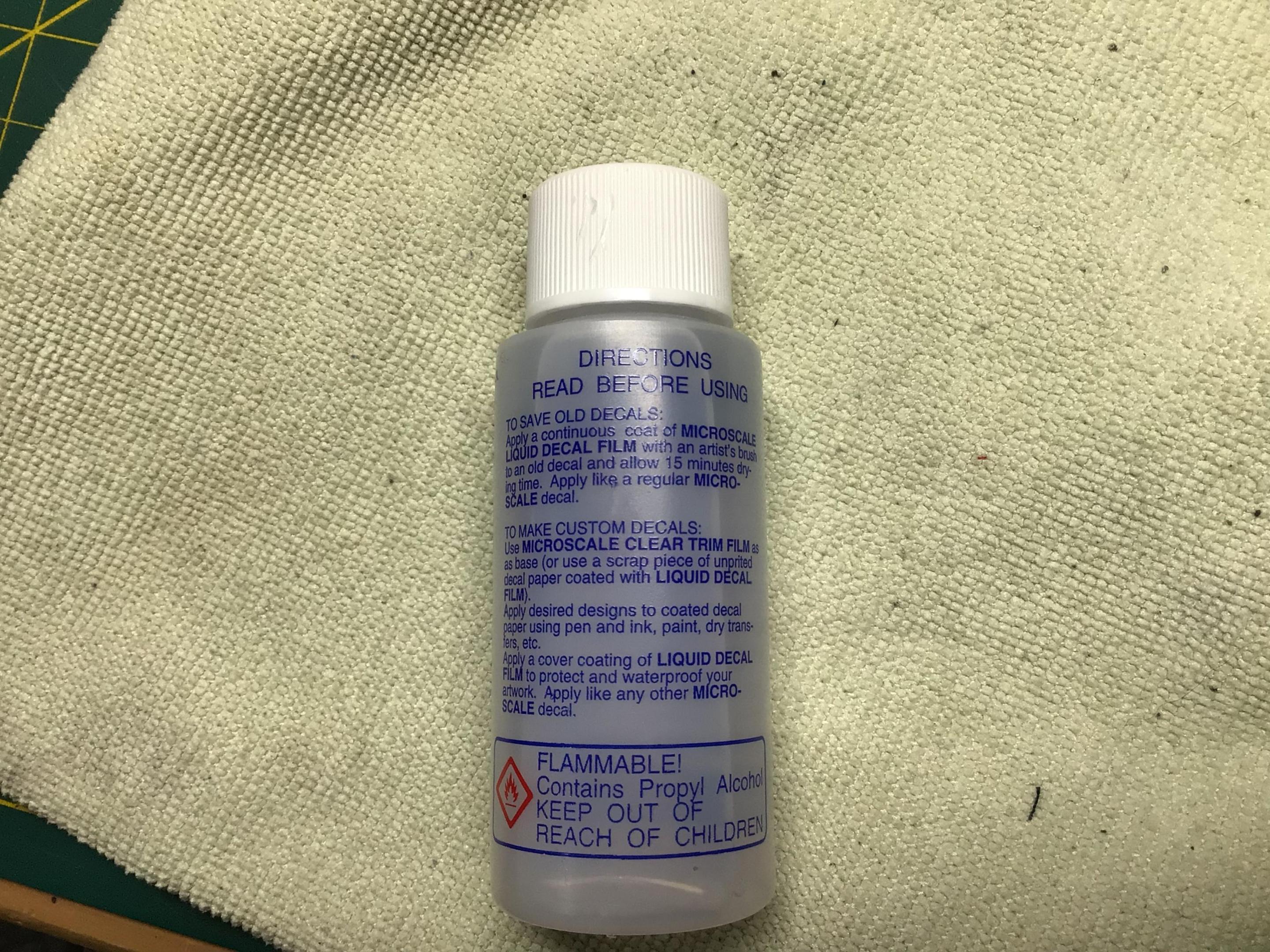

NOBLNG Posted November 4, 2021 Posted November 4, 2021 I am no expert with decals, but I did use this on some really old decals and it seemed to help.
Mike C. Posted November 4, 2021 Author Posted November 4, 2021 That's the stuff I've seen before. I think I might have to try that stuff.
