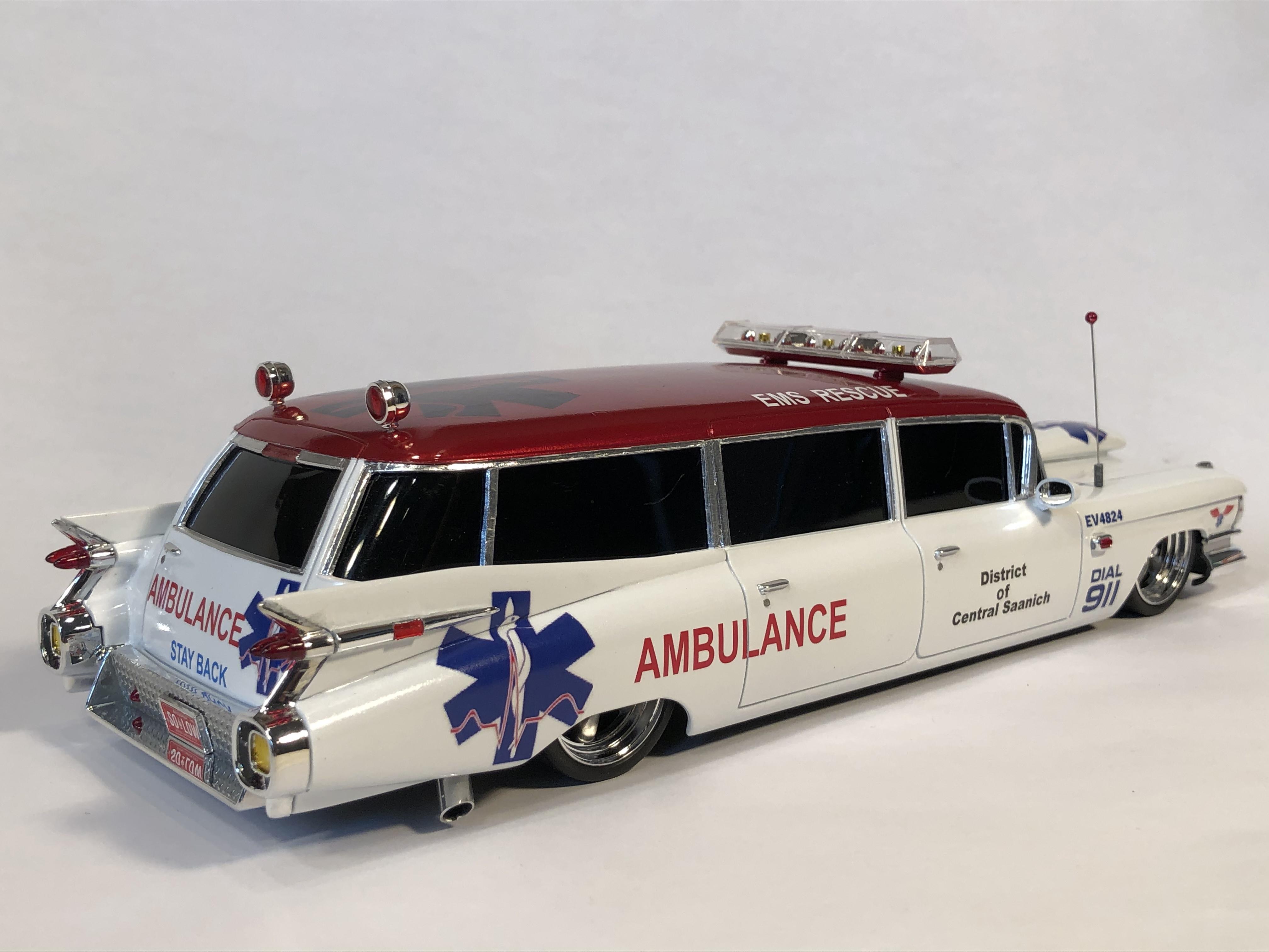

Hi David, this will be a fun build. Like Gareth, I modified one of these, mine became a custom ambulance. Look forward to seeing more of your progress.
Cheers, Steve
Cheers, Steve
Thank you Steve, I appreciate your comment. If you have any photos of your ambulance conversion, feel free to post them. I'd love to see 'em.
