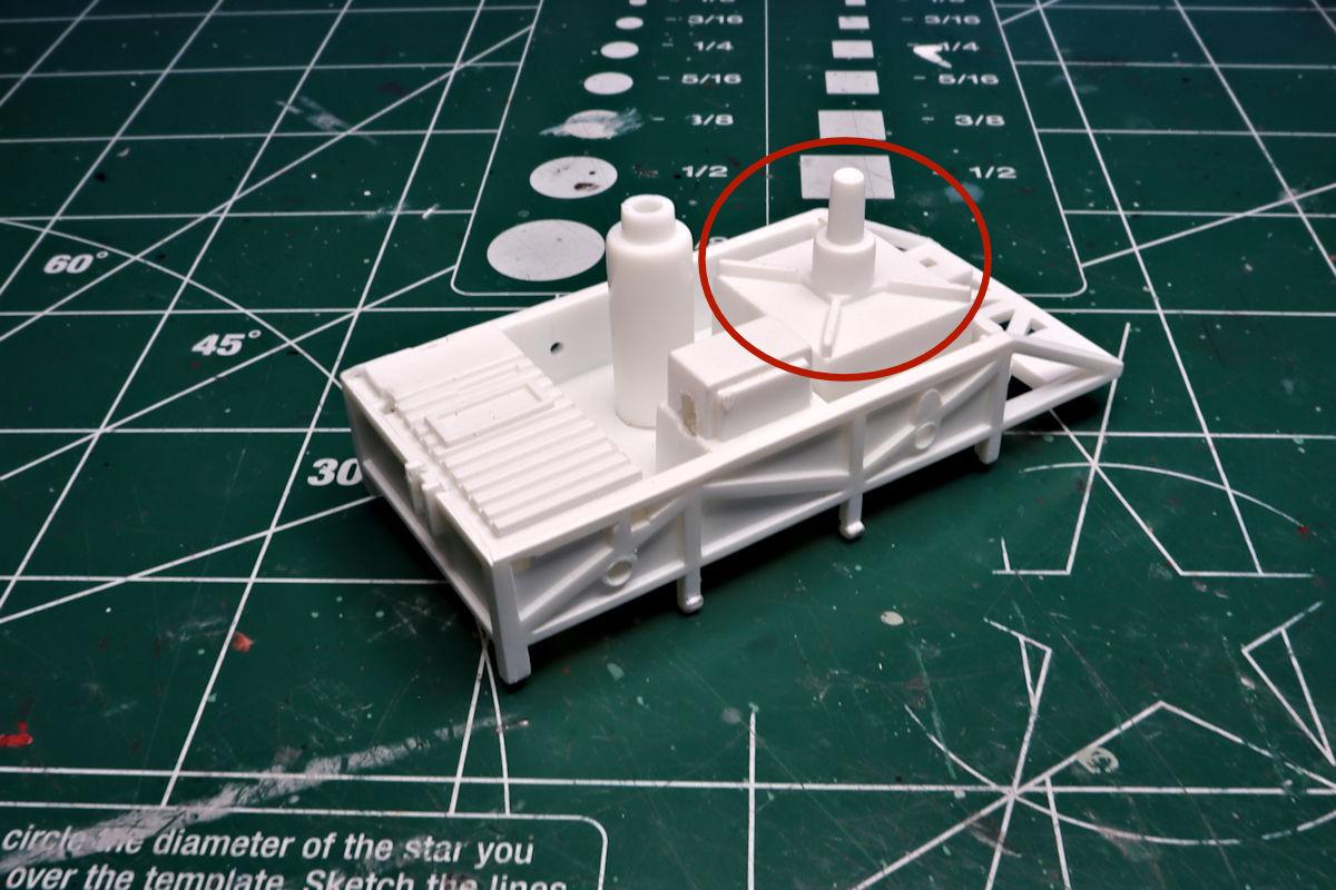

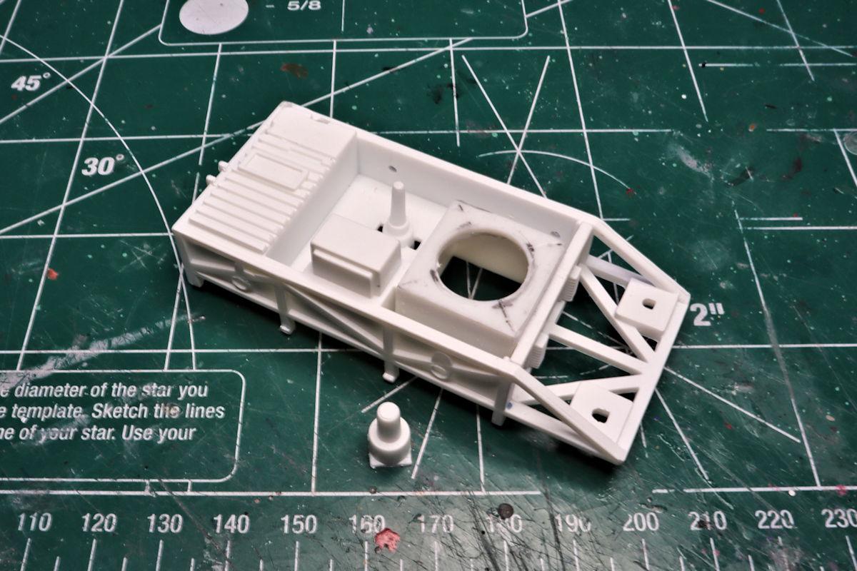

Steve H Posted December 12, 2021 Posted December 12, 2021 On 12/11/2021 at 4:28 AM, David G. said: Hello Everybody! I've been spending some of my bench time working on the roof carrier. There's one main feature that I've decided I just can't let go unaddressed. This... Thing. My research indicates that it is supposed to be an HVAC unit. Which makes sense considering that all the vintage computer equipment on board would require some cooling to remain functional. It's difficult to find a photo of what the unit is supposed to look like. This one is close to canon but from what I can make out from the movie stills, the motor in the center should be white or light metallic, maybe aluminum like a motor casing would be. So here we go, jumping down yet another rabbit hole! Now that the damage is done, I need to make a motor housing and find a way to mount it using wire supports. I also have some ideas for a fan to go under the motor. Suggestions are always welcome. As always, thanks for taking the time to look. David G. David, that literally looks like a rabbit hole… Seriously though, this is really cool, loving all the fabrication you are doing. Keep up the great work. Cheers, Steve

David G. Posted December 18, 2021 Author Posted December 18, 2021 Hello Everybody! I did manage to find a suitable fan in the ol' parts box. I did have to clean it up and paint it but at least I don't have to scratch build one. To mount the fan I started by making a back plate for the base of the roof carrier. I then measured and eyeballed the center of the hole onto the base plate below. I then drilled a hole on the mark to accommodate a 1mm styrene rod on which I could mount the fan. It did require a bit of fiddling with the baseplate to get the fan properly centered but I'm rather pleased with the results. Now I need to come up with the motor and its mounting struts. I also painted the frame of the carrier along with a number of the other equipment pieces, which will be seen as the build progresses. Thanks for taking the time to look and please feel free to post your comments. David G. 1

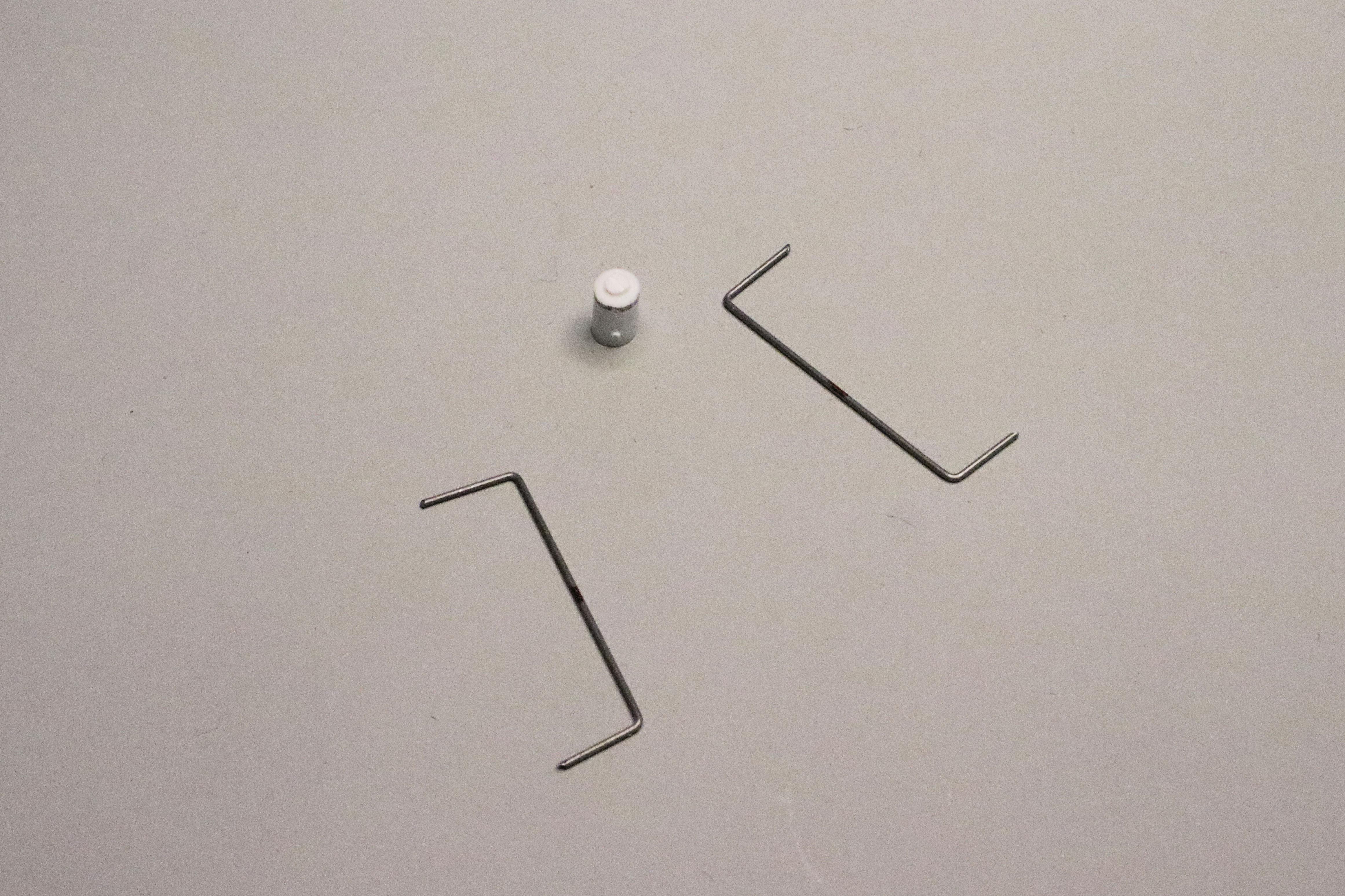

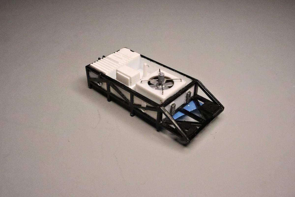

David G. Posted December 21, 2021 Author Posted December 21, 2021 Hello Everybody! I got the motor assembly and fan finished enough for a test fit. I used some styrene rod and tubing sleeved together and cross-drilled for the motor housing. The support struts are made from .020 music wire. I think I can be happy with this. Now it's time to focus on finishing up the interior details. As always, thanks for taking the time to look and please feel free to comment. David G. 2
slusher Posted December 21, 2021 Posted December 21, 2021 Real nice work on the fan David, more realistic..
David G. Posted December 22, 2021 Author Posted December 22, 2021 23 hours ago, slusher said: Real nice work on the fan David, more realistic.. Thank you Carl, it's kind of you to say so. David G.

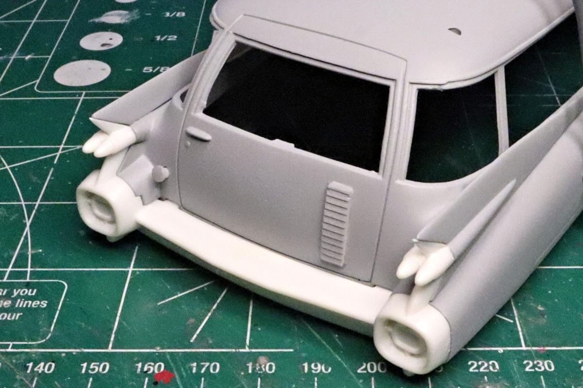

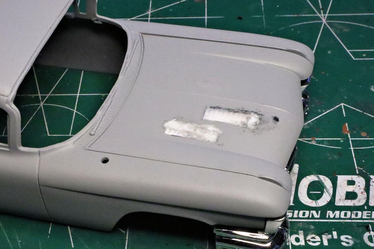

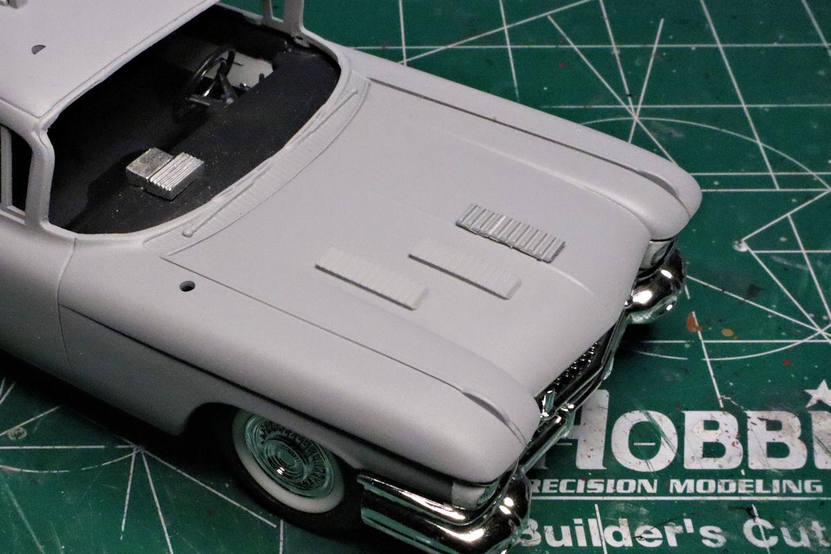

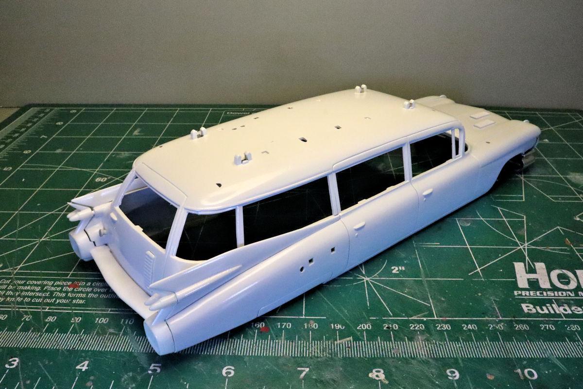

David G. Posted January 9, 2022 Author Posted January 9, 2022 Hello Everybody! I'm still working on fabricating the gurney that will hold the Proton Packs. As near as I can figure, I'm about halfway done with that. Once that's completed I'll be done with the interior... I think. I'll have to see how it looks once it's all together. Given that, I wanted to get the body ready for paint. I just wasn't happy with the louvers I added so having found a better looking alternative, I removed the old ones. The replacements are cut from Evergreen Clapboard Sheet Styrene. It has a 1.3mm spacing for the clapboards which, to my eye looks a bit more in scale. The relief isn't as prominent but I think I can punch it up a little with a wash. I included an example of the old set for comparison. While I was in fabrication mode, I whipped up a fuel filler neck and cap for the back. That's all for now. As always, thanks for taking the tie to look and please feel free to post a comment. David G.

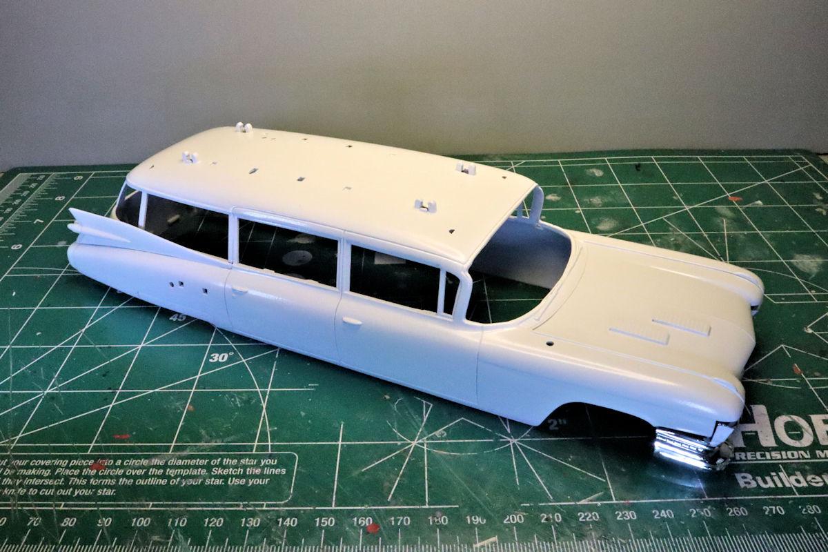

David G. Posted January 13, 2022 Author Posted January 13, 2022 Hello Everybody! I got some paint shot on the Ecto-1. There are some minor flaws so it's going to need a little sanding and a second coat. But it feels good to be that much closer to completion. As always, thanks for taking the time to look and please feel free to comment. David G.
FLHCAHZ Posted January 13, 2022 Posted January 13, 2022 Looking sharp! Cant wait to see it all come together.
David G. Posted January 14, 2022 Author Posted January 14, 2022 23 hours ago, FLHCAHZ said: Looking sharp! Cant wait to see it all come together. Thank you Chaz, you and me both. David G.
