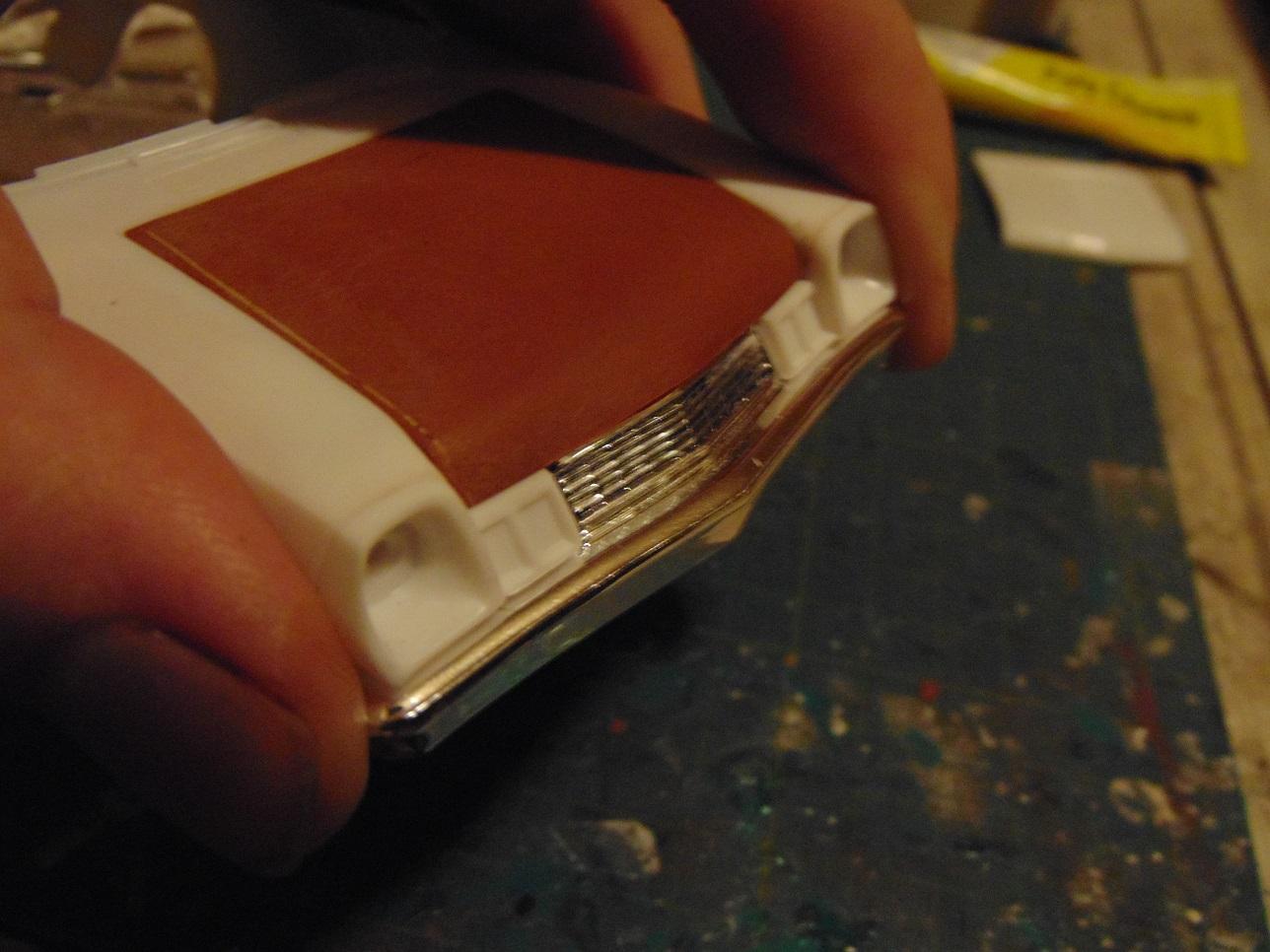

doorsovdoon Posted November 9, 2021 Posted November 9, 2021 (edited) Just when I thought there couldn't be worse out there than the MPC Country Charger I come across this little gem! There are fit issues everywhere. The hood has huge panel gaps so I made my own from a custom option '65 Pontiac GP which has an almost identical shape but obviously twice the size, so I cut it to fit and worked out great. I might fix the original hood by adding some styrene to it to fill the gaps as it has that slight raised line down the centre, whereas the Pontiac hood doesn't. Another mod was to cut out the centre piece behind the grill, it's not needed anyway and actually interferes with the fitment of the grill and bumper, this brought the whole piece back enough to sit under the hood and also makes the bumper look cleaner by bringing it in closer to the car. More to come:) Edited November 9, 2021 by doorsovdoon

doorsovdoon Posted November 9, 2021 Author Posted November 9, 2021 Thanks guys, and thanks, Tim, for the tips, I missed a few of those. Continuing the mods, I cut the one piece glass into individual pieces cos that did not fit at all and I modified the rear bumper to fit closer to the car, I hate those 70's girder rails! Firewall was fitted further forward to support the hood. It looks far better and might actually be the way it's supposed to fit as the instructions are some of the most vague I've seen!

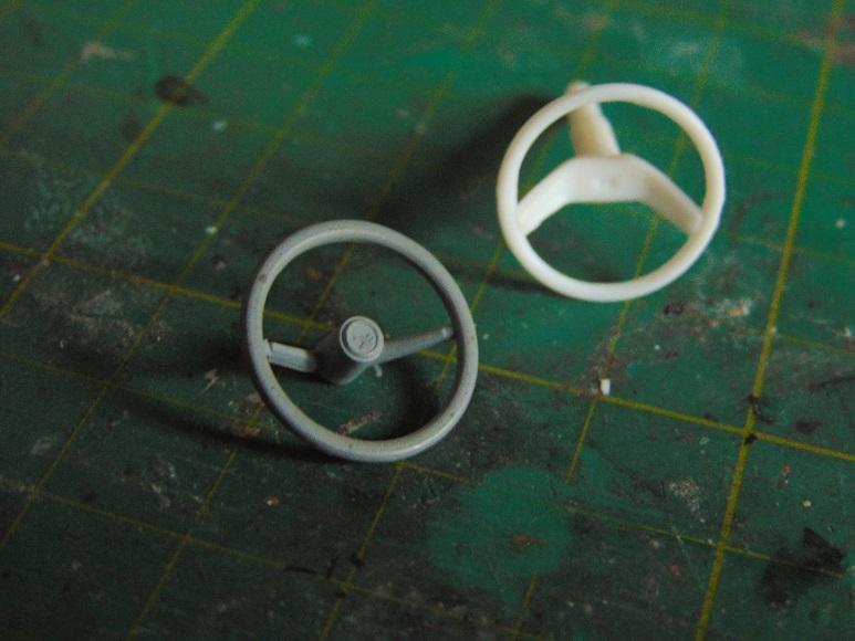

doorsovdoon Posted November 9, 2021 Author Posted November 9, 2021 (edited) Fixed the panel gap on the stock hood so now I have a choice between stock or custom. The instructions say the radiator support should be glued to the chassis but it looks like it sits too low then when the body is fitted. Gluing it to the body pushed the hood up so I trimmed the ends and that fixed it. Also found a steering wheel that looks closer to what's on the real car. Edited November 9, 2021 by doorsovdoon

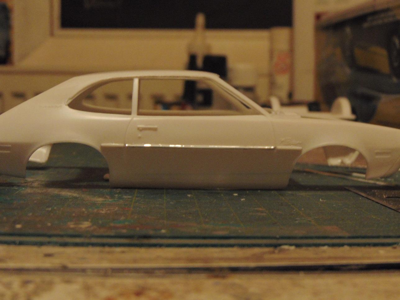

doorsovdoon Posted November 9, 2021 Author Posted November 9, 2021 Got the side trim done. I used a custom grille from the '57 Fairlane in my spares that has very fine horizontal bars. I sanded the back of the grill until it was super thin and then cut the bars out individually, cut them to fit each panel and glued them on.

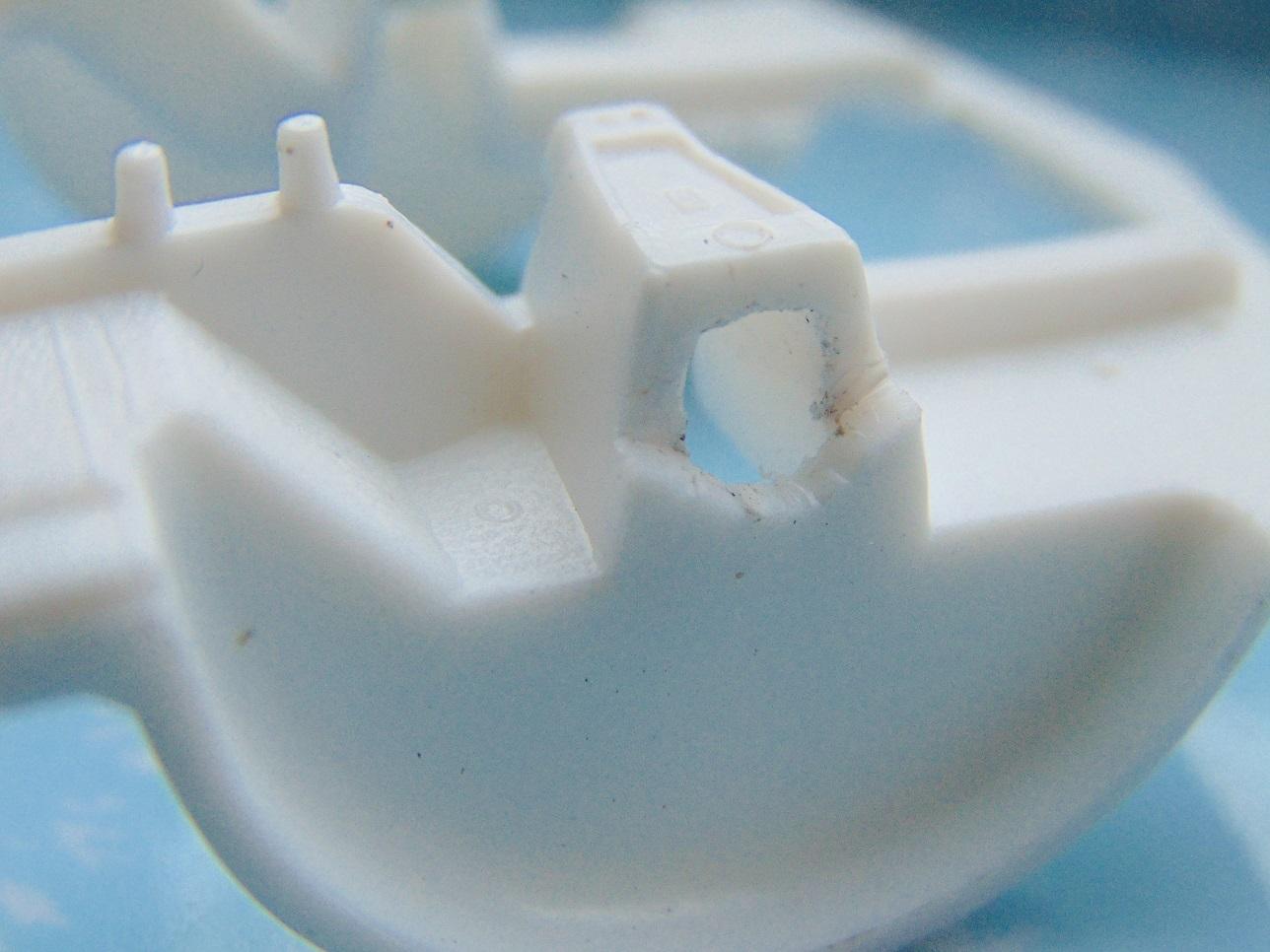

doorsovdoon Posted November 10, 2021 Author Posted November 10, 2021 Put the ejector pins in the middle of the glass why not!
Oldmopars Posted November 10, 2021 Posted November 10, 2021 Every time I pull this kit out, I have to remember it is an old, old tool and it is nice just to have a model of a pinto. while a new modern tool of a Pinto would be nice, it will never happen, who would buy one? So, I see it as a challenge to make this old kit into something decent.

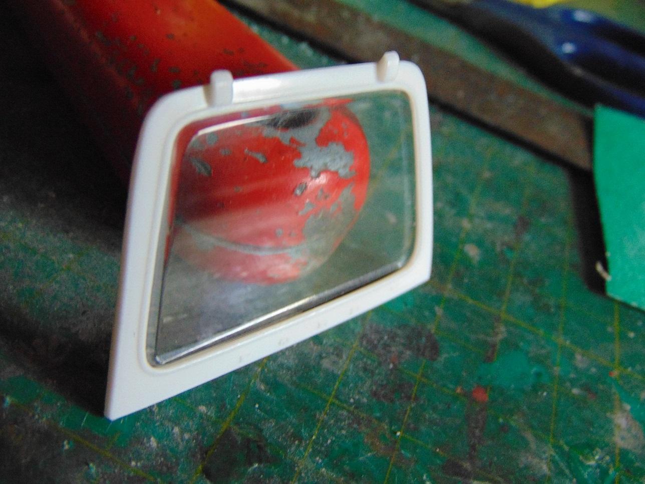

doorsovdoon Posted November 10, 2021 Author Posted November 10, 2021 (edited) Managed to sand and polish the ejector pin marks out of the side glass. The rear hatch glass was almost the size of the hatch itself! The glass literally looked like it was just pressed against the hatch from behind as apposed to fitting in the frame, so I trimmed the glass to fit inside... but I trimmed too much off and had to throw it:( Solution? cut up my old water filter jug to make a new one, Lol! Edited November 10, 2021 by doorsovdoon
doorsovdoon Posted November 10, 2021 Author Posted November 10, 2021 The plastic water jug is twice as thick as what the kits glass is, so I had to bevel the rear of the hatch's window frame and the glass itself for it to fit flush.
