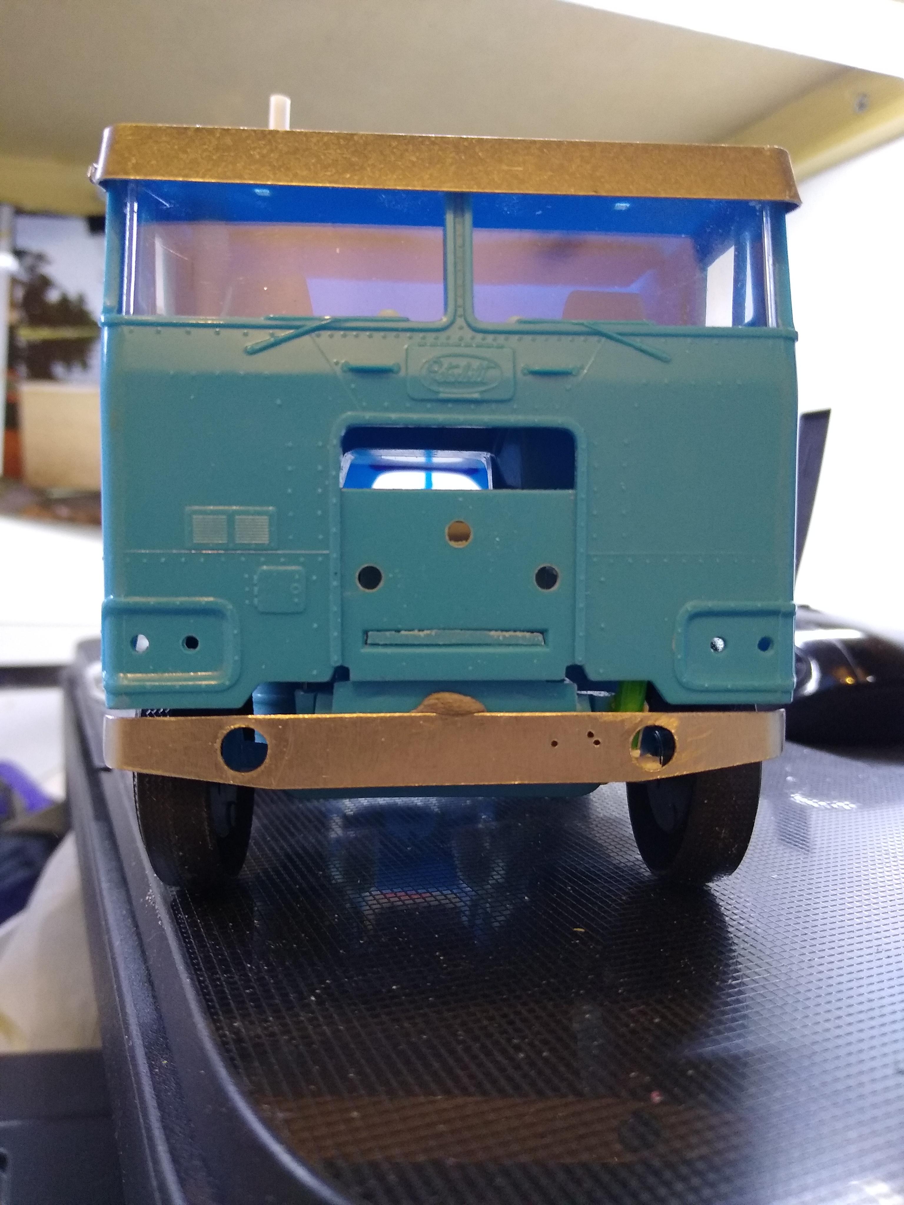

Decided I really don't like the kit bumper.
I would prefer the thinner version too so I marked one out on a sheet of aluminium. I used a Sharpie instead of engineers blue. Sadly my 5mm drill that I used to finish off the spotlight holes was as blunt as could be, leaving huge burrs on the holes and distorting the piece slightly. However, even in a slightly mangled state it looked better than the kit piece. I will try again but I may just use styrene sheet instead. The ali is too thin.
I got two bites at the cherry this week. Wanted to sort this bumper situation. I laminated three strips of plastic card together and let them set properly. Then I shaped the basic bumper but I was hesitant about drilling and shaping the tow lug cutouts because they're very close to the top of the bumper. So I made it 1mm smaller than required, filed two notches for the tow lug holes and then put strip of card across the top. Rounded all the corners off and it looks ok.
Then I decided I wanted the spotlights too, so I took the kit bumper and cut to the top off, then let the tow lug holes in again and put a strip across the top. Rounded the edges again and I think this is the one I'll be using.

I don't like the way the grille juts out proud of the cab shell. It doesn't do it on a real Pete. It's because of the snap nature of the kit.
I cut the backing plate out, fitted two strips of plastic card either side of the grille opening and then refitted the backing plate with card behind to sink it in. Had to drop the locating tab on the chassis back too. Fitted the grille and it makes a bit of a difference when compared to the other kit I built out of the box.

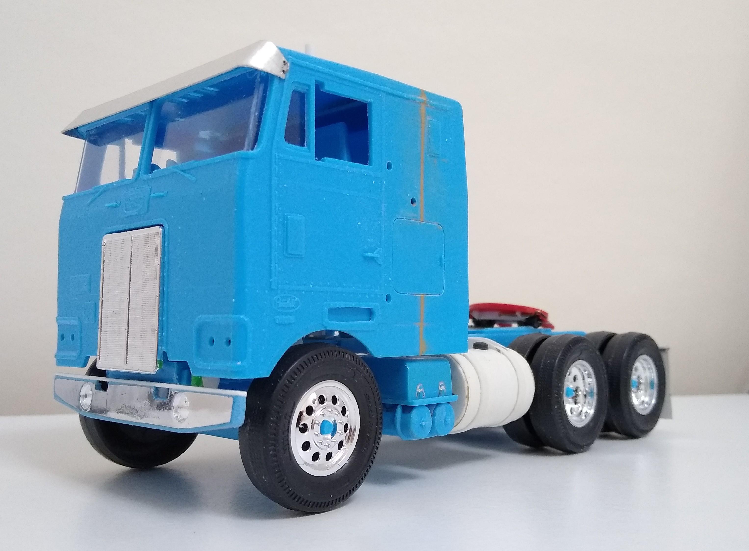

I can't believe what's happened to the cab of the 352 since I painted it.
The paint was hard enough to handle the cab with no issues. I stood it on a shelf and next to it was some of that non-slip matting you can get. This was just touching the cab it seems. When I picked it back up today there were little pieces of the mat embedded in the paint! I rubbed it off with a cloth but it's left a sort of "burn" in the places where it touched the cab( ringed in the photo). I'll see if I can polish them out in a few days. I'm so annoyed. First of all I drop it and now this!
