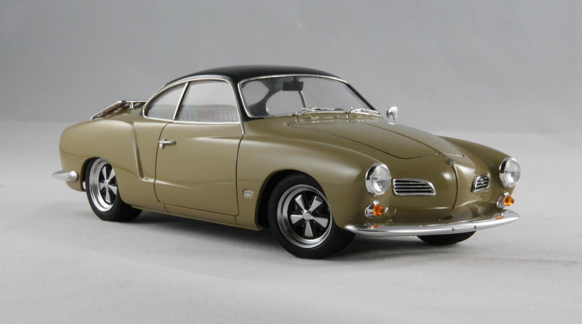

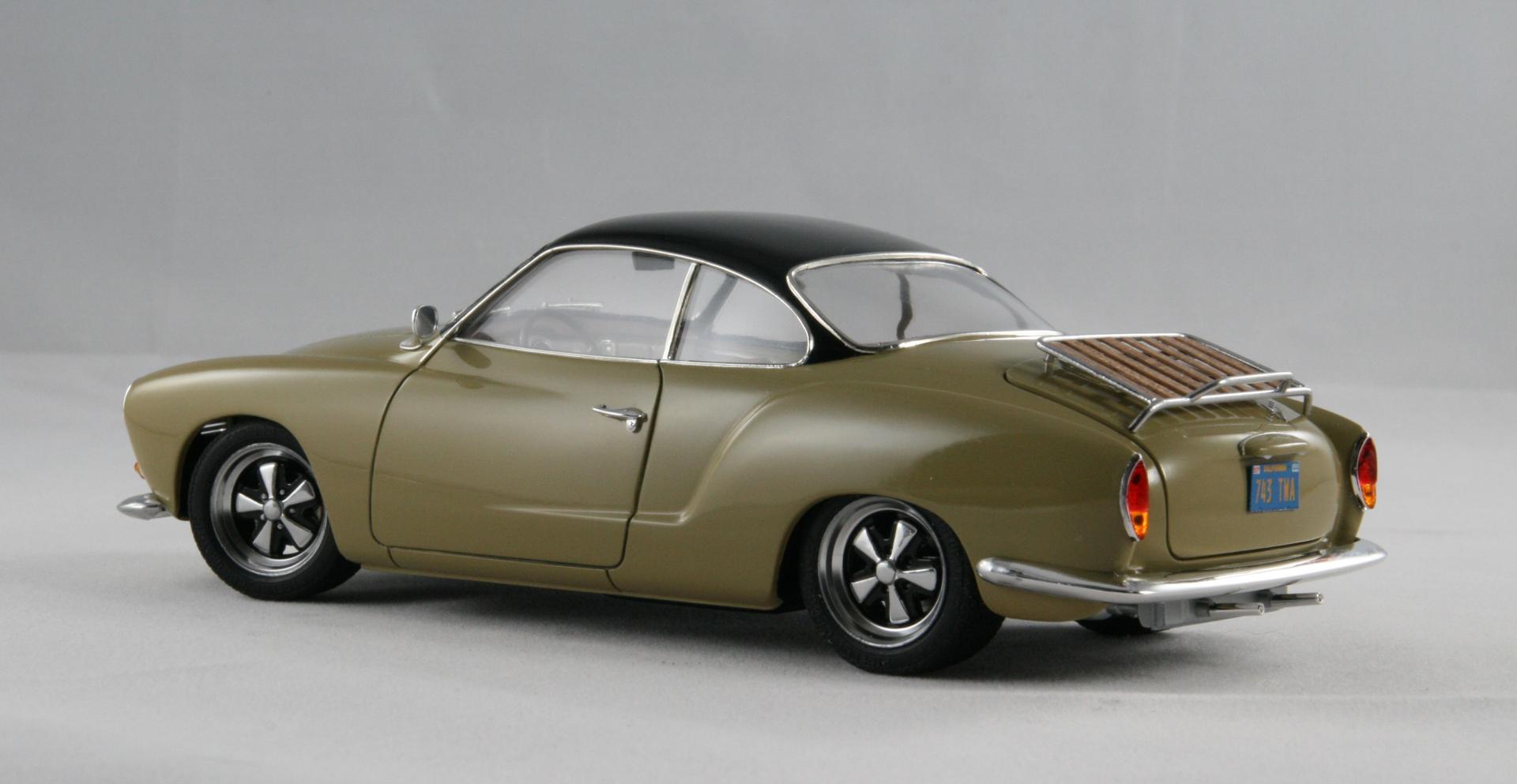

jaymcminn Posted December 1, 2021 Posted December 1, 2021 No photos of pearl clear over TS3, but I did this Tamiya Karmann Ghia in TS13 over TS3. The flat TS colors make a great base color under clear coats. 2

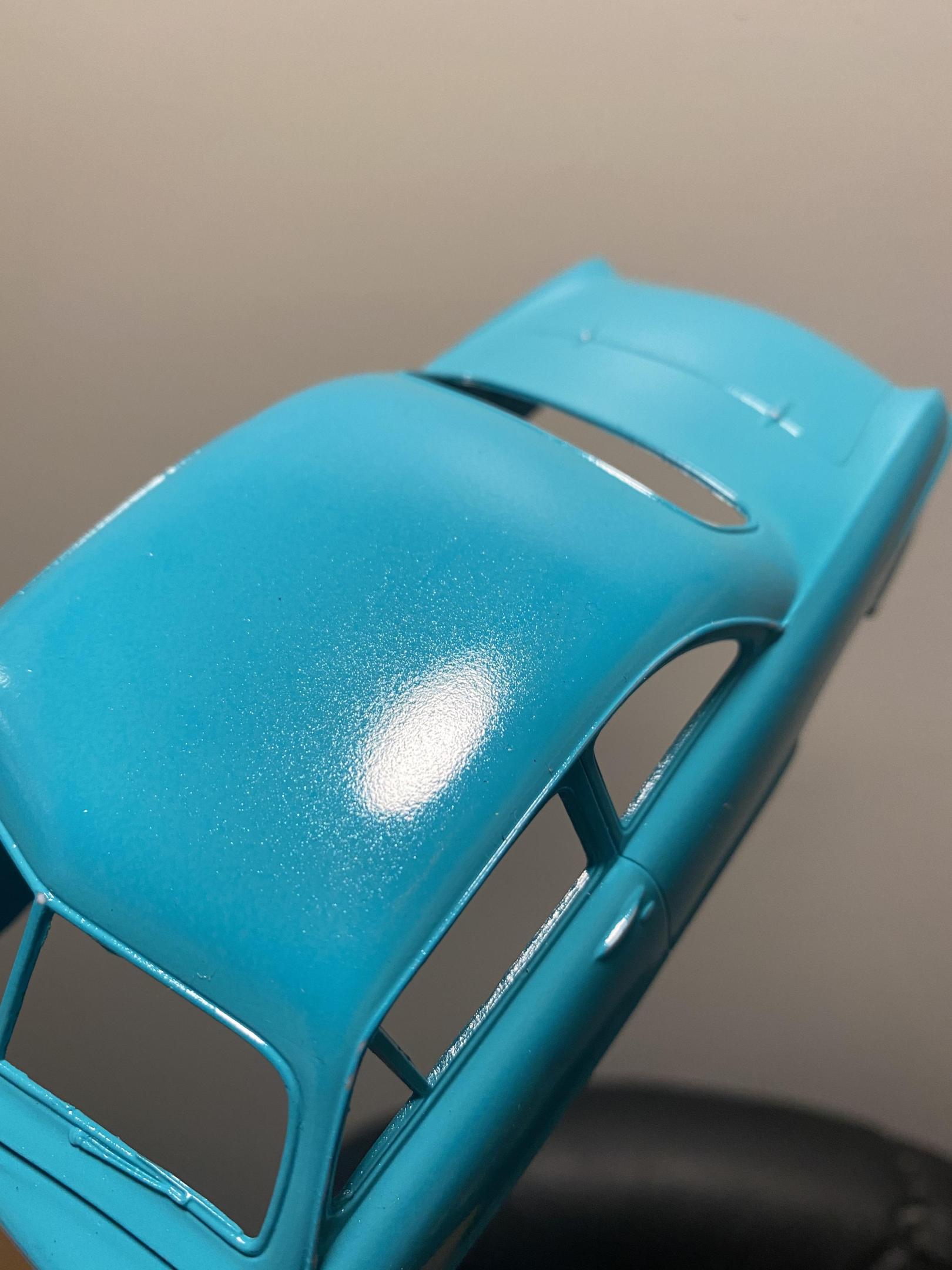

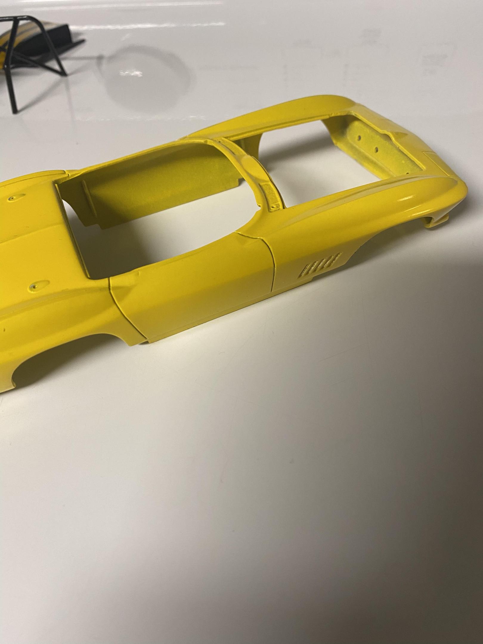

kymdlr Posted December 2, 2021 Posted December 2, 2021 The pearl clear adds a slight pearl effect if you are close up on the model , I wouldn’t equal it to an actual color based metallic paint color. Here is tamiya pearl over yellow and a turquoise.

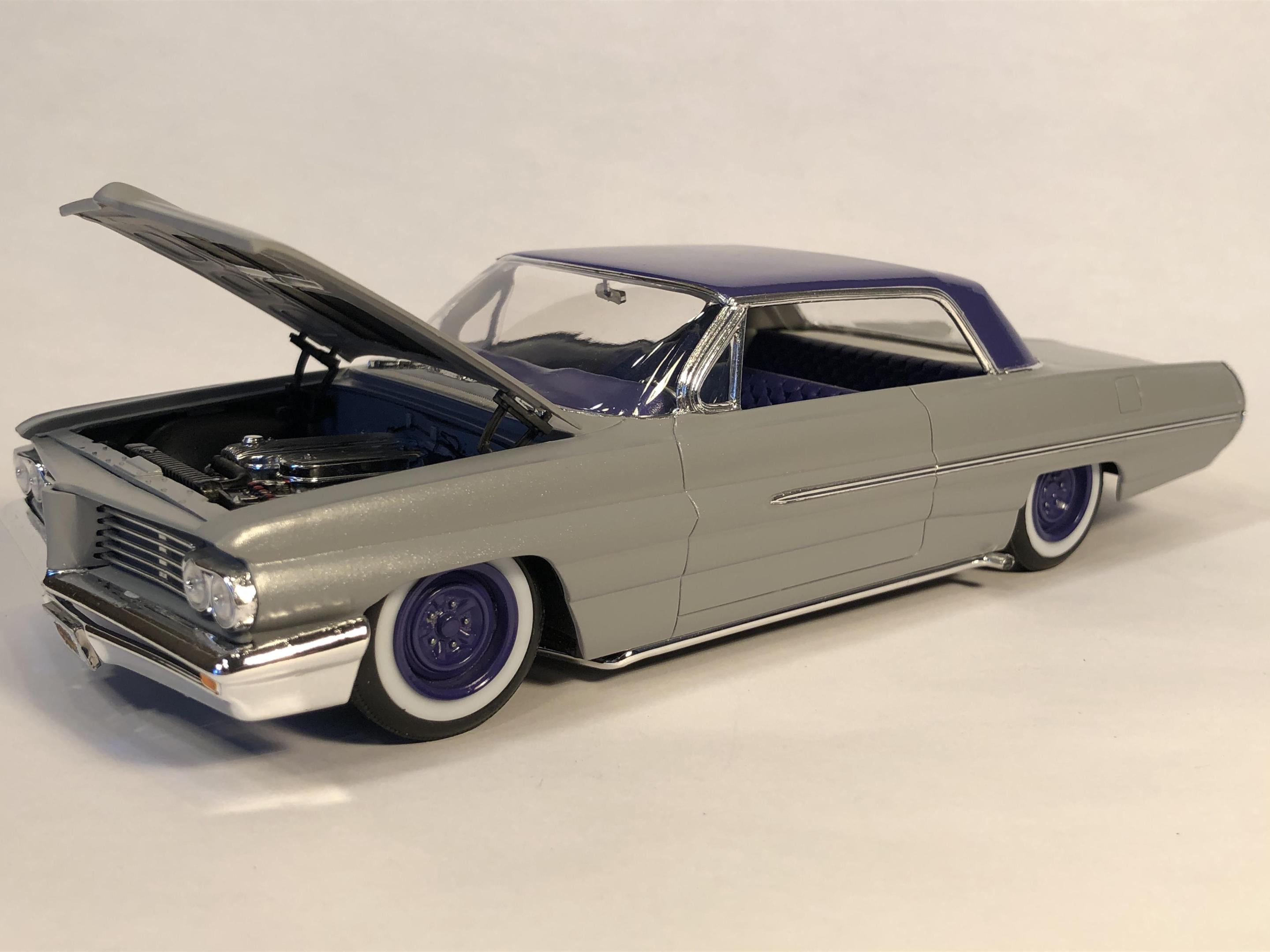

Steve H Posted December 2, 2021 Posted December 2, 2021 Here it is over primer grey and purple. As mentioned, photos don’t really capture it well.

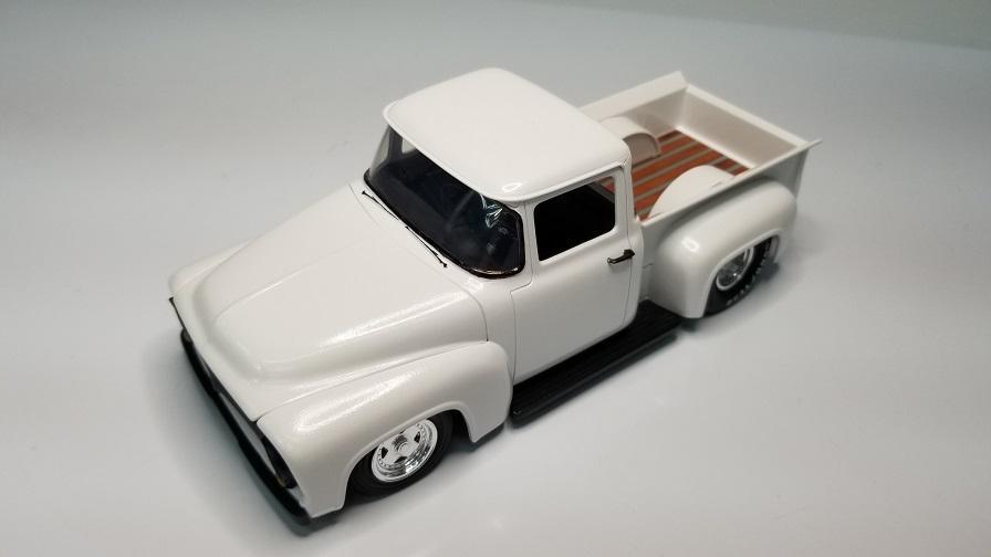

Zippi Posted January 13, 2022 Posted January 13, 2022 Here's my 56 pickup painted with Rust-Oleum flat white primer and cleared with Tamiya TS-65 Peal clear.
