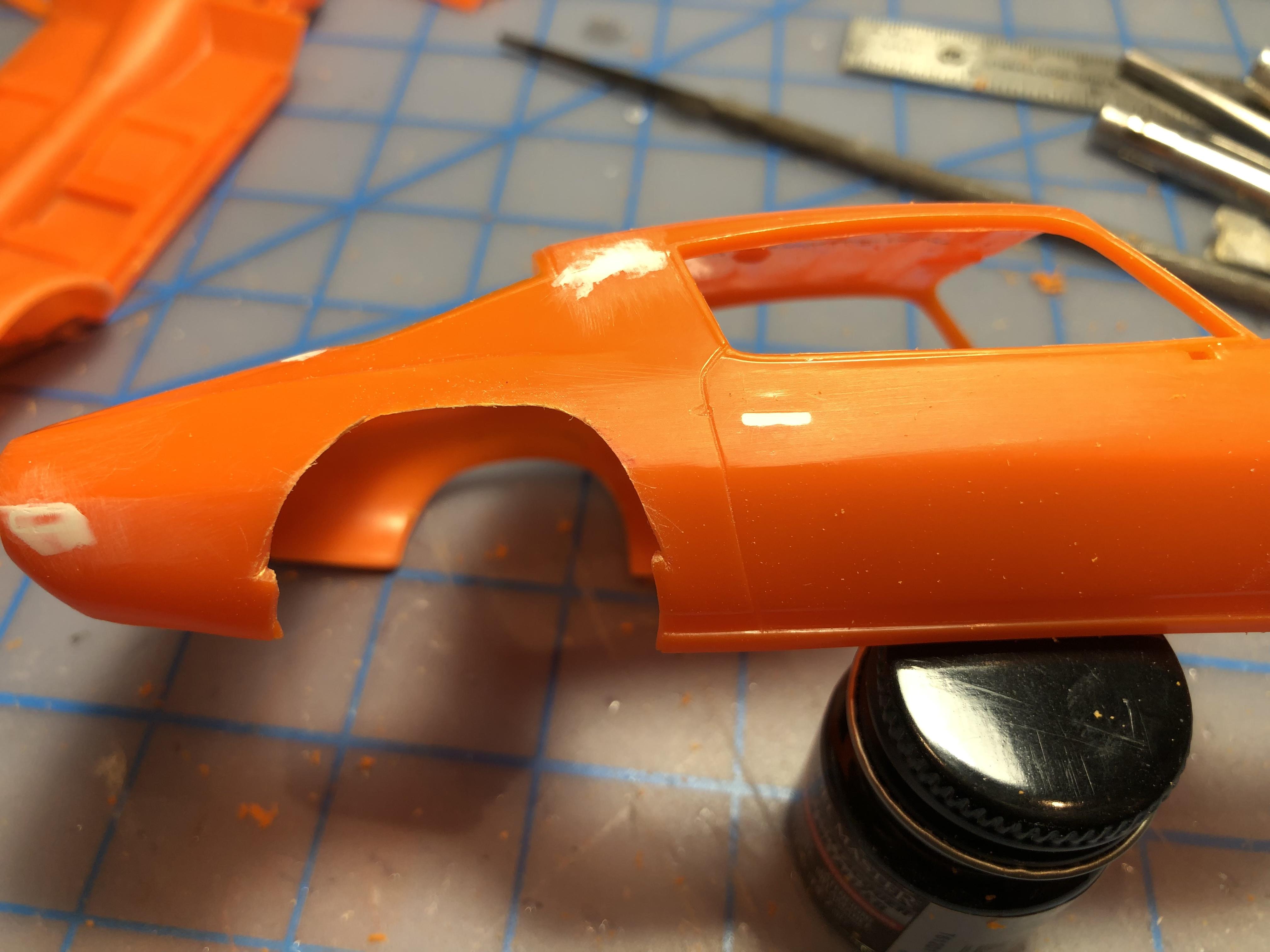

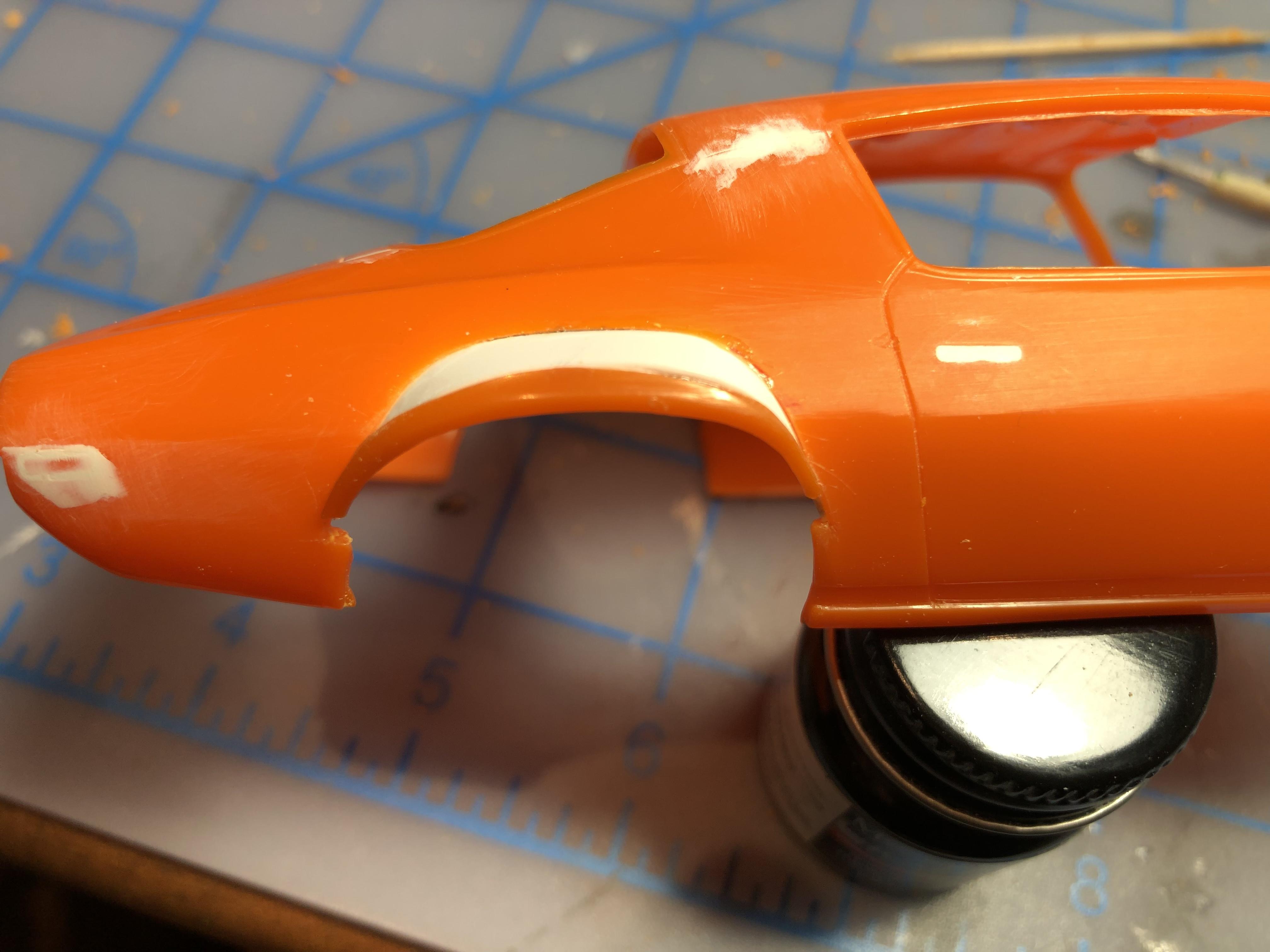

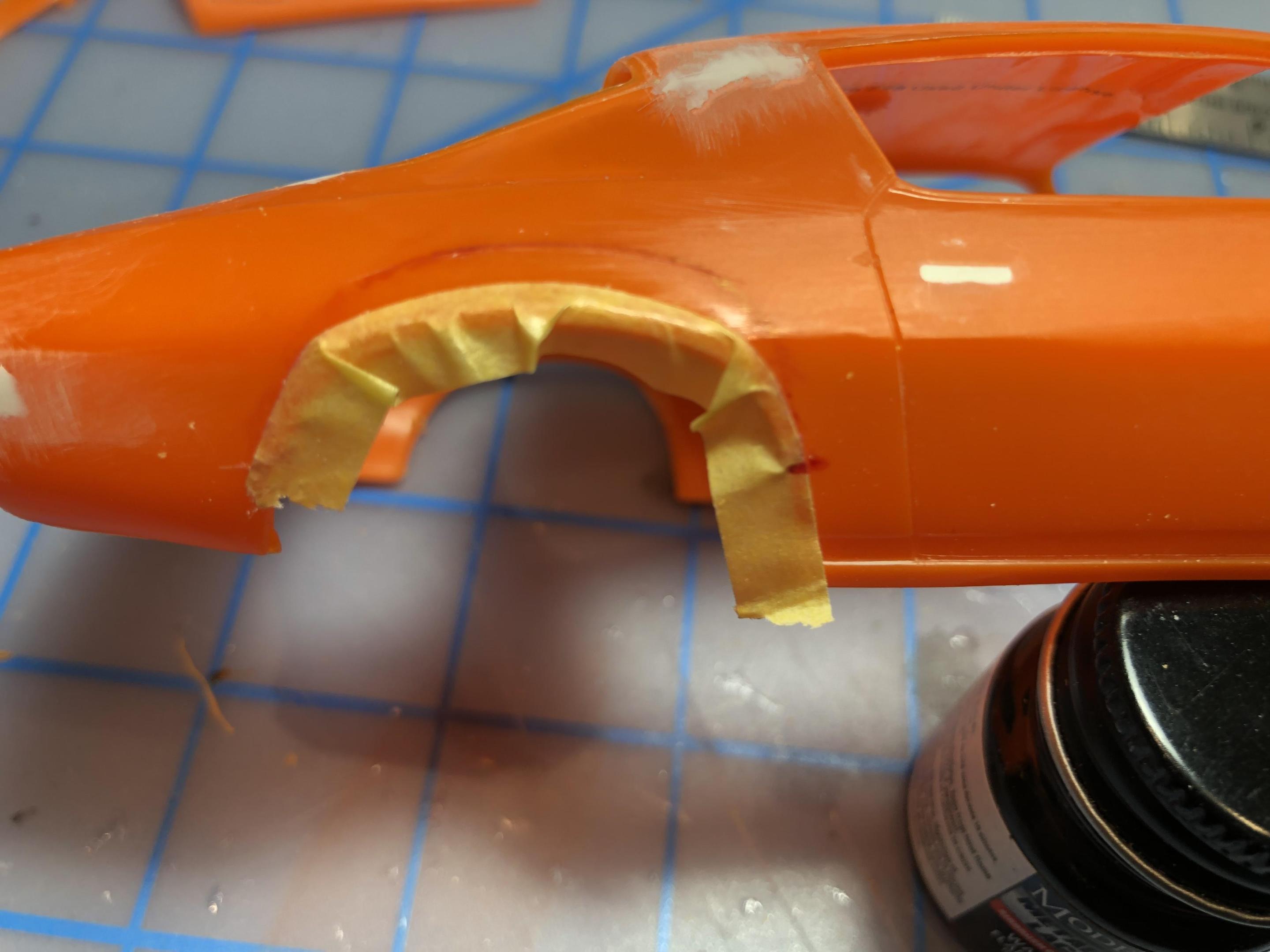

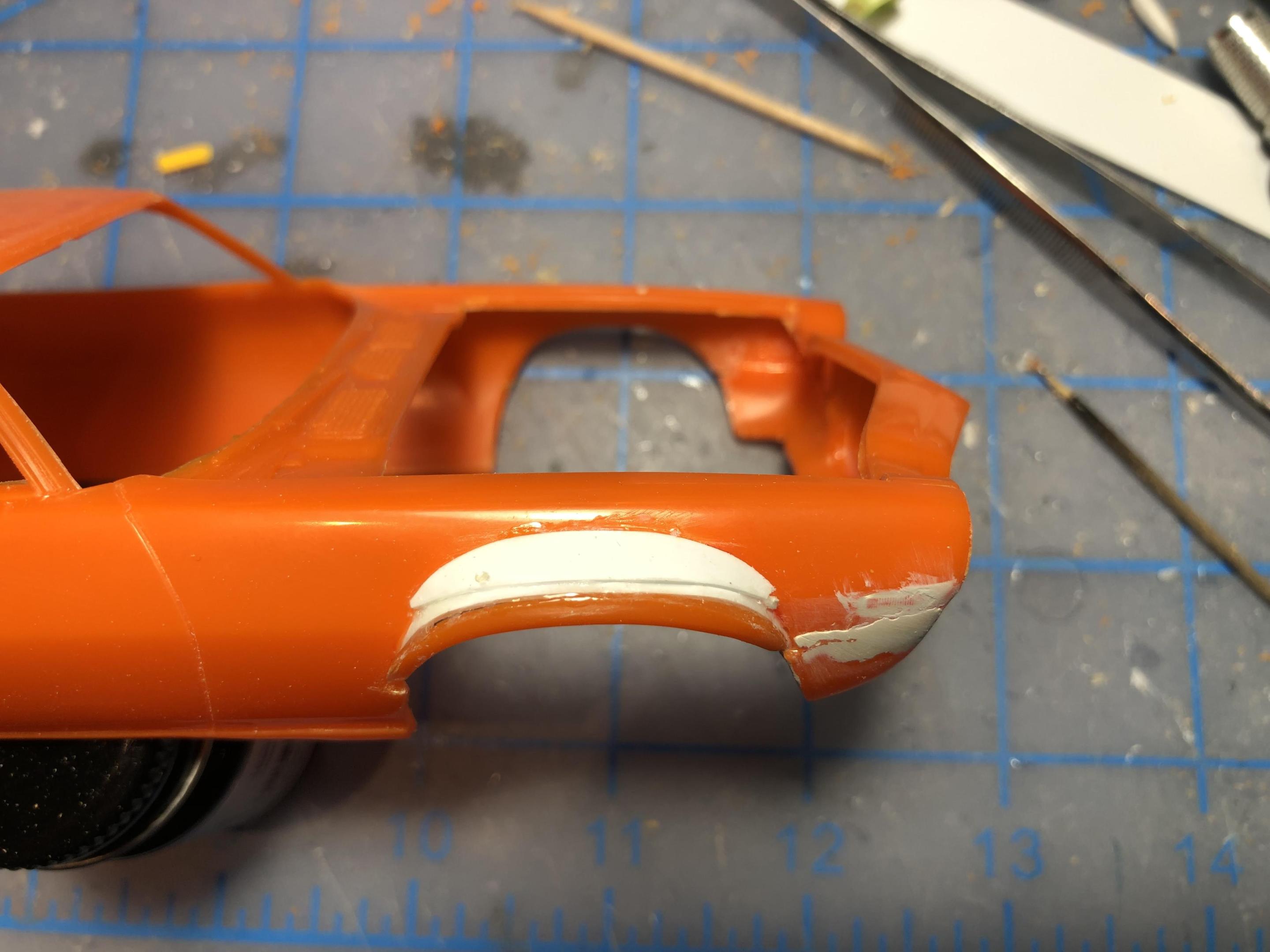

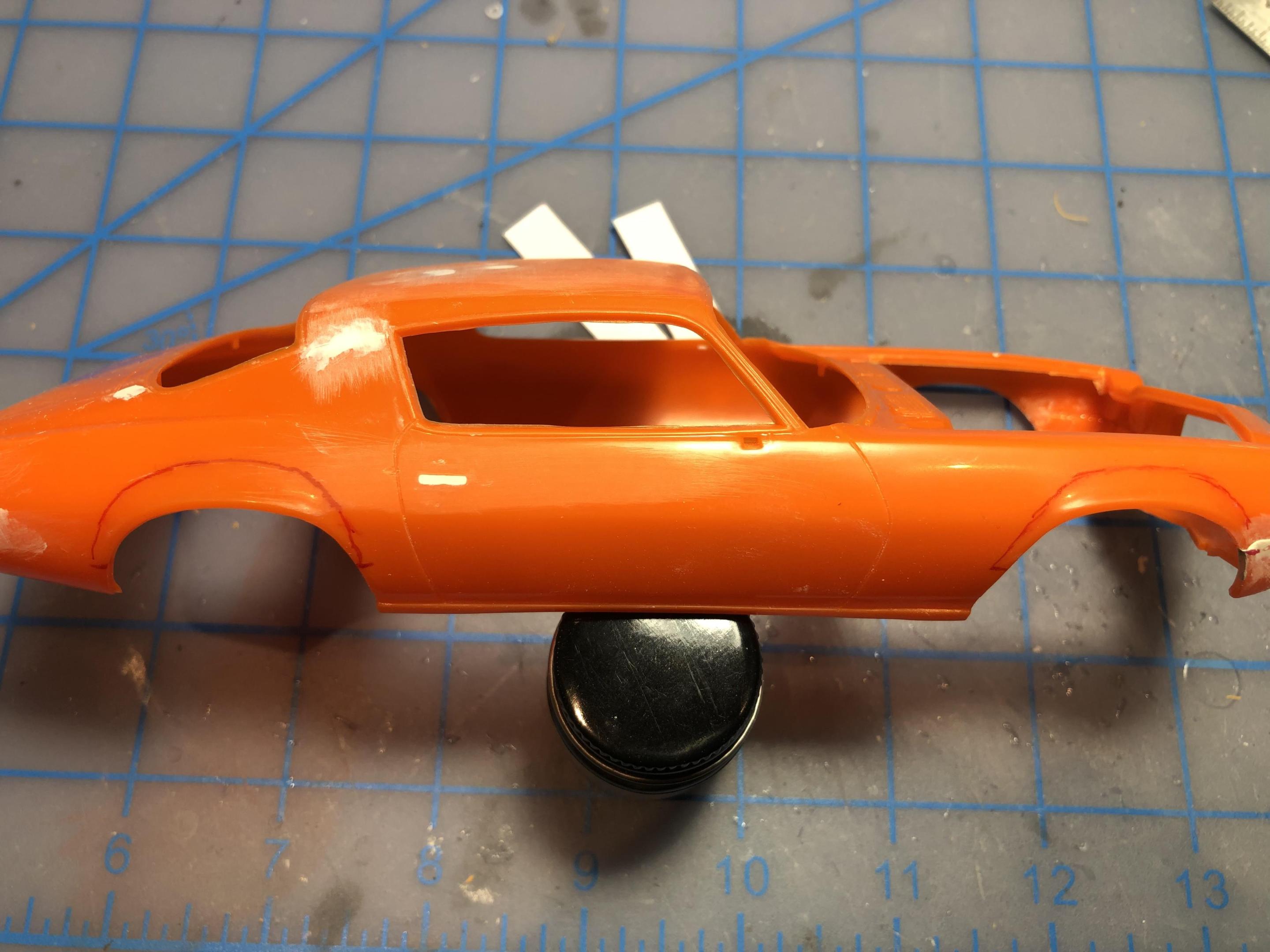

I marked out roughly where the top of new fender opening will be. Pardon the rough Bondo work, that will get cleaned up later…

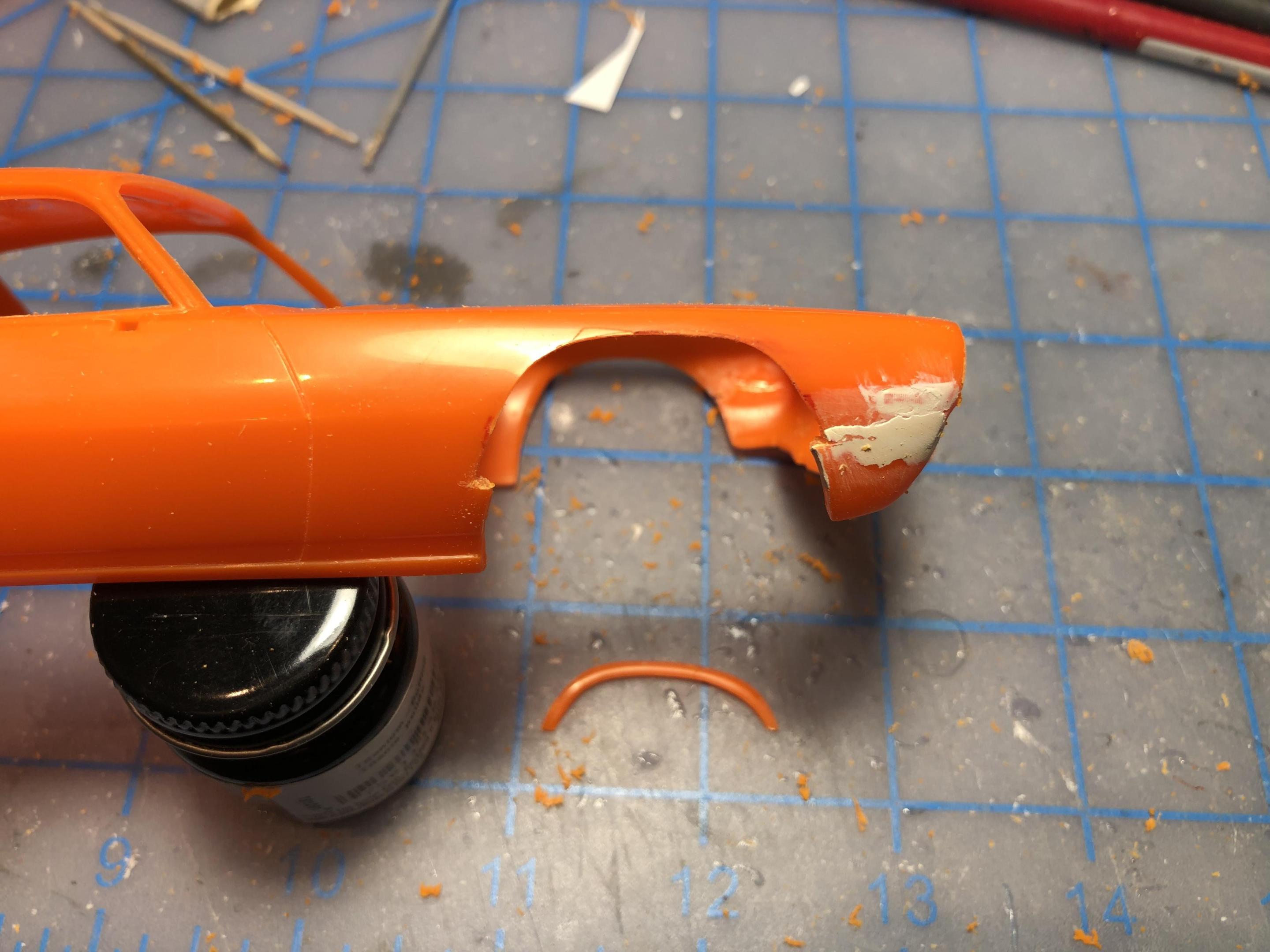

Next I taped around the fender lip as a guide to cut and remove. Scriber was used to remove lip.
Then a sanding drum in the Dremel to remove material

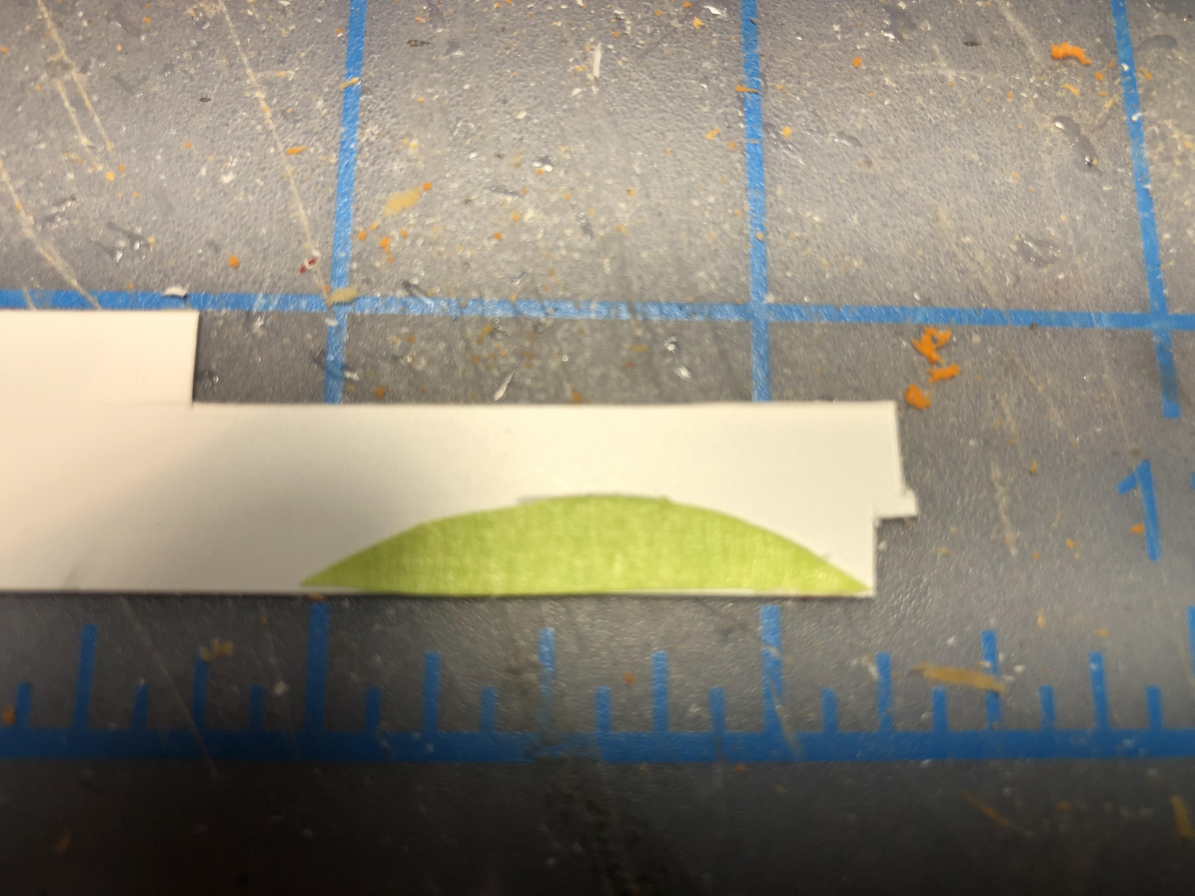

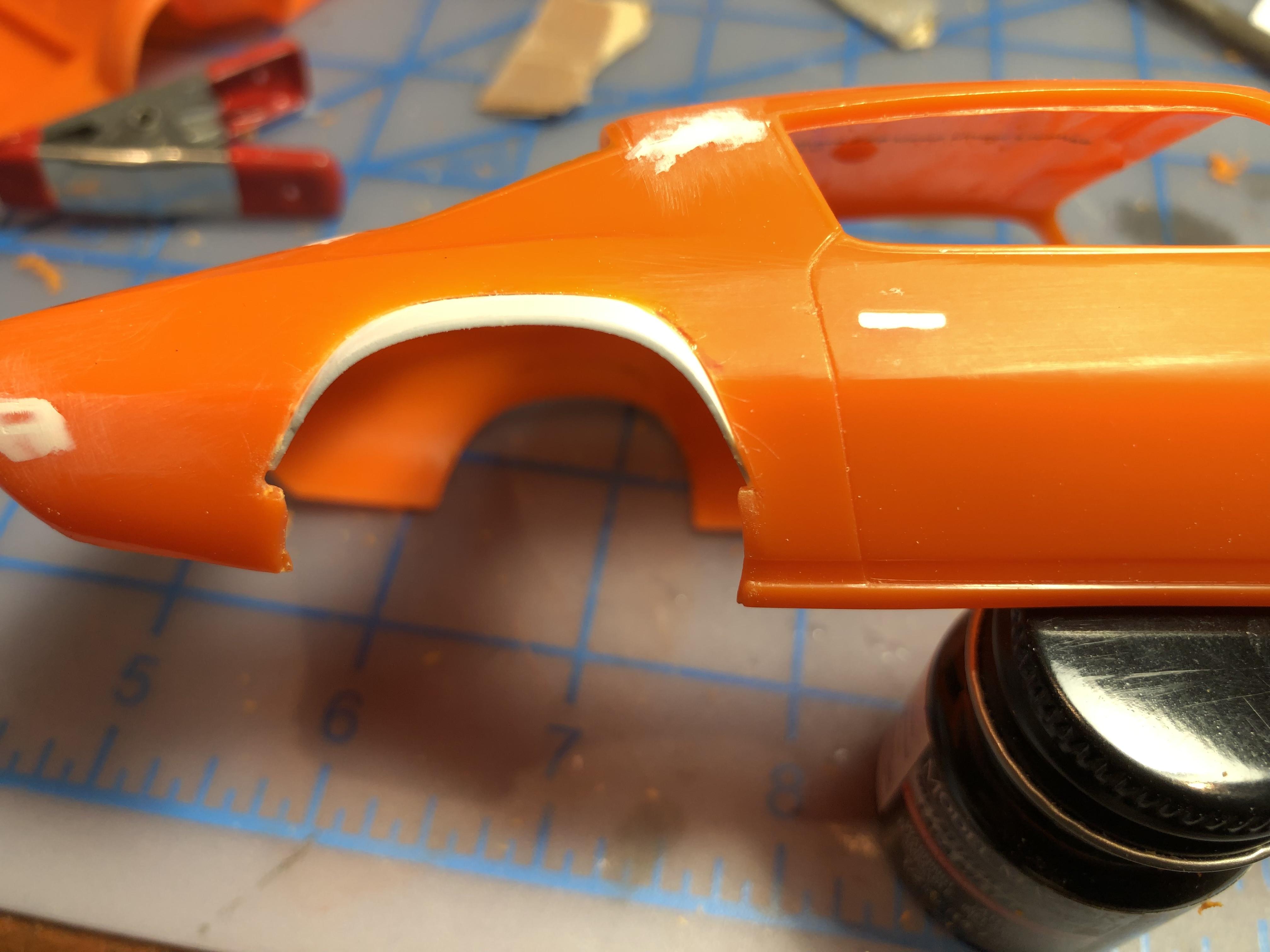

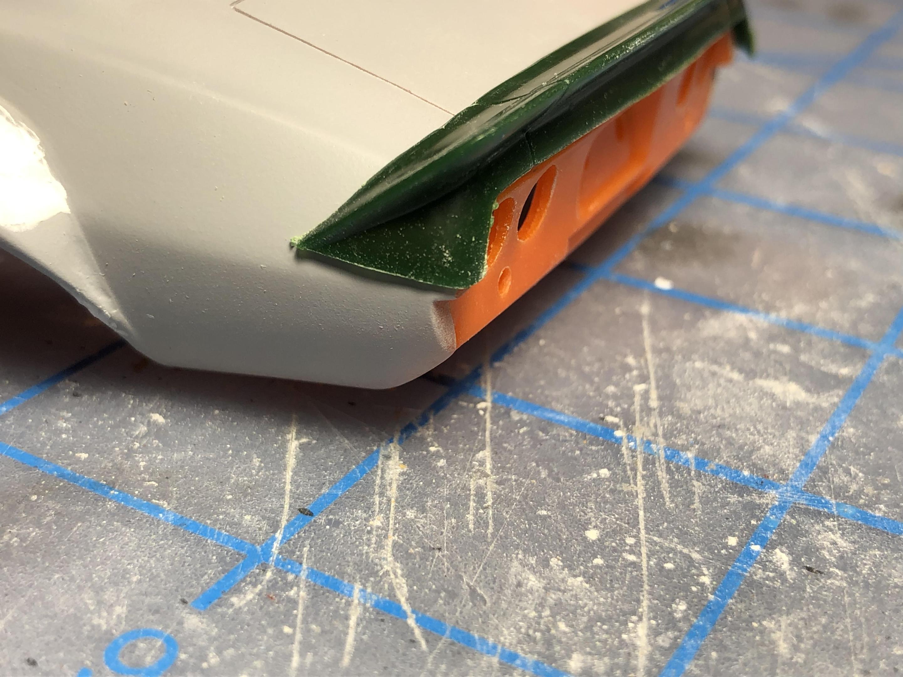

Sheet styrene cut into strips to create flares
BFA04A6F-542A-4018-AAE5-1431C28FA720.thumb.jpeg.0c924796f44088681c7636ec18f0aa5e.jpegE9BDB72B-3176-4E9B-9FE7-777B4856A020.thumb.jpeg.6c8945b4a5104540c2cb62f21fcffc07.jpeg

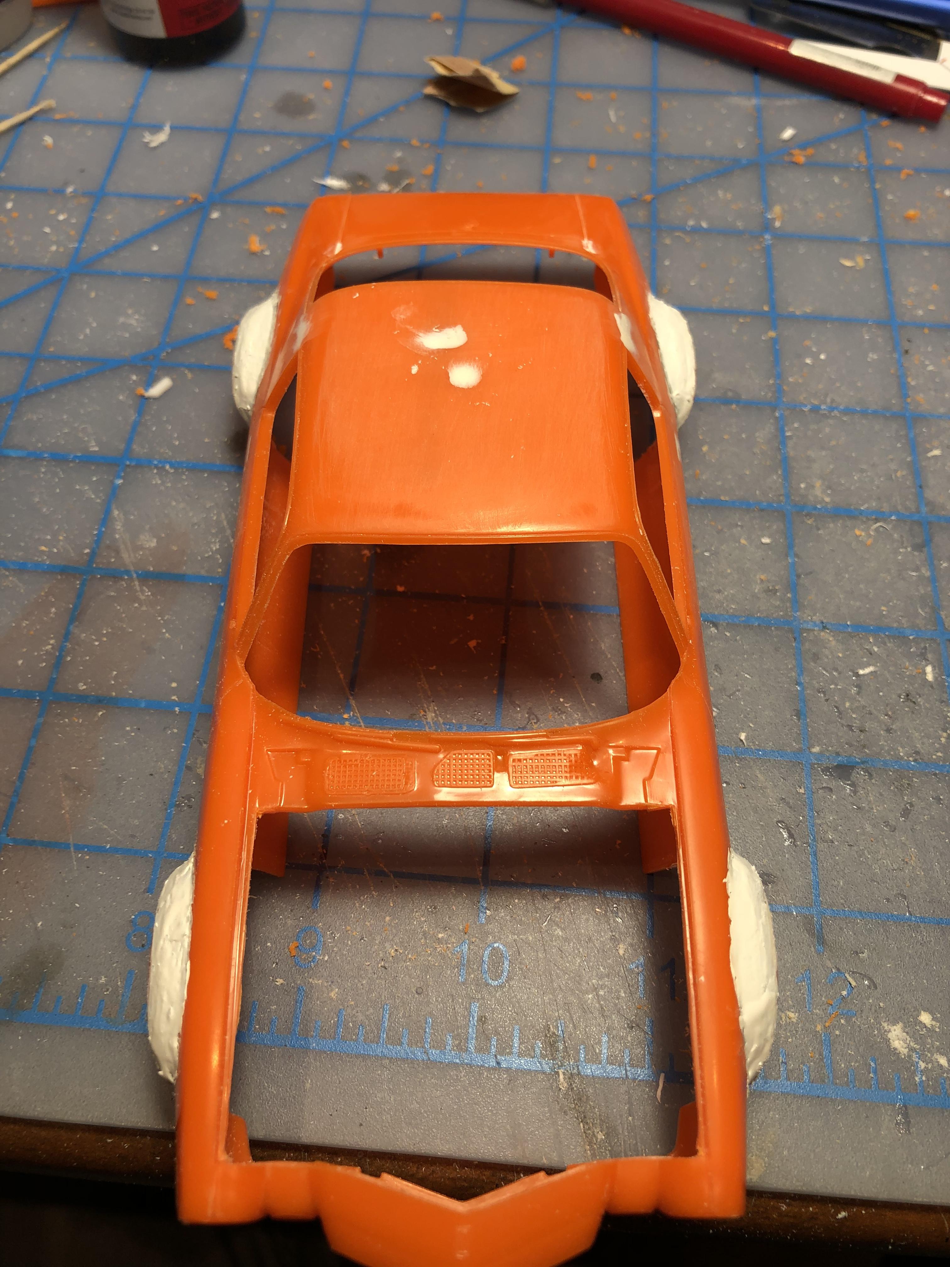

Then re-attach fender lipsC64DF06E-4BA2-404B-8944-FCCEF9650723.thumb.jpeg.72c15ab117223eefefc1b40de9b91243.jpeg
Here you can see that the fenders are raised by about 2 1/2 scale inches at the outer edge, at the body I removed about 5 scale inches. I have since added filler pieces fill that gap. LOTS of clean up and Bondo to go, but it’s a start!

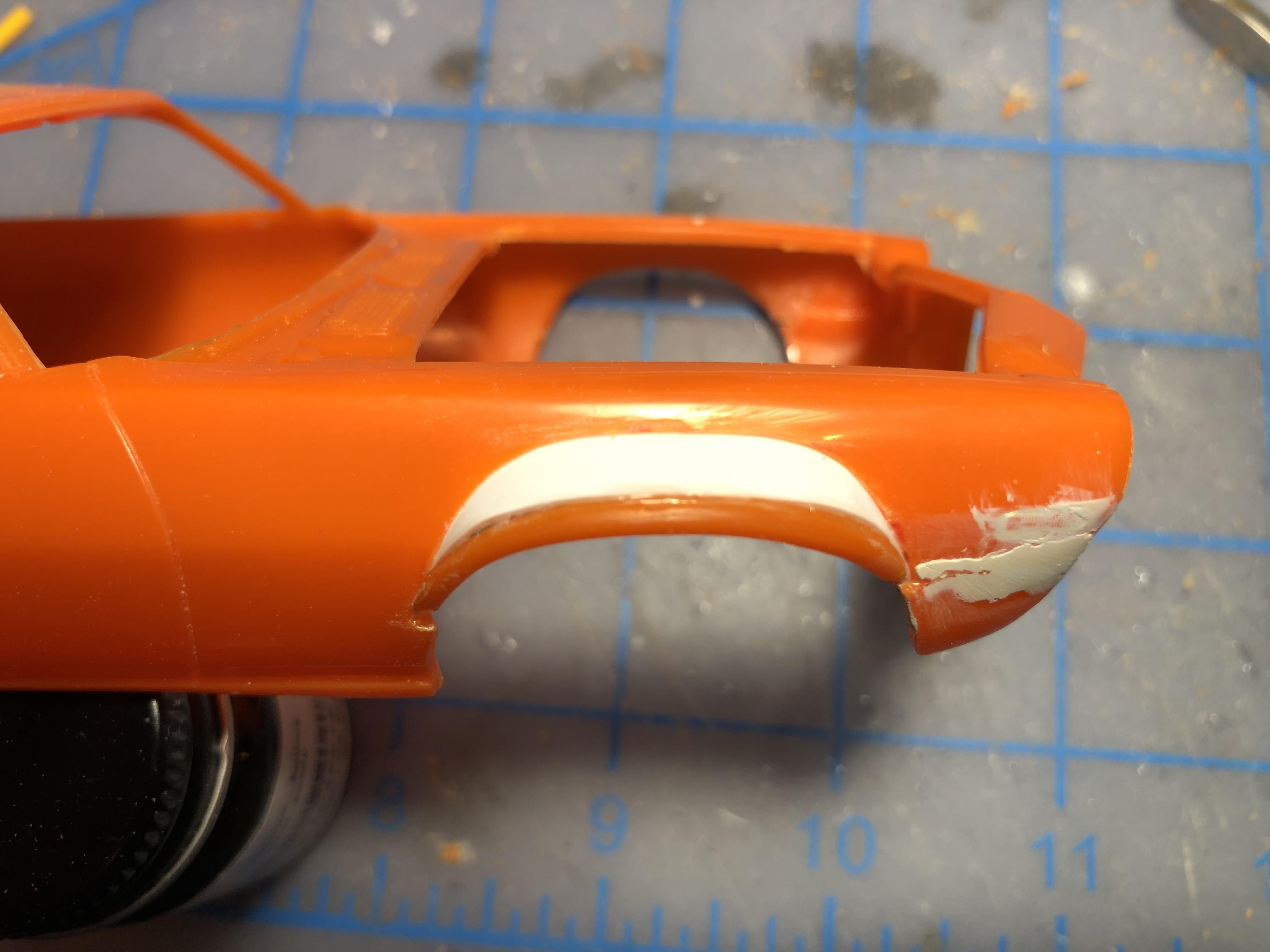

Same process up front..

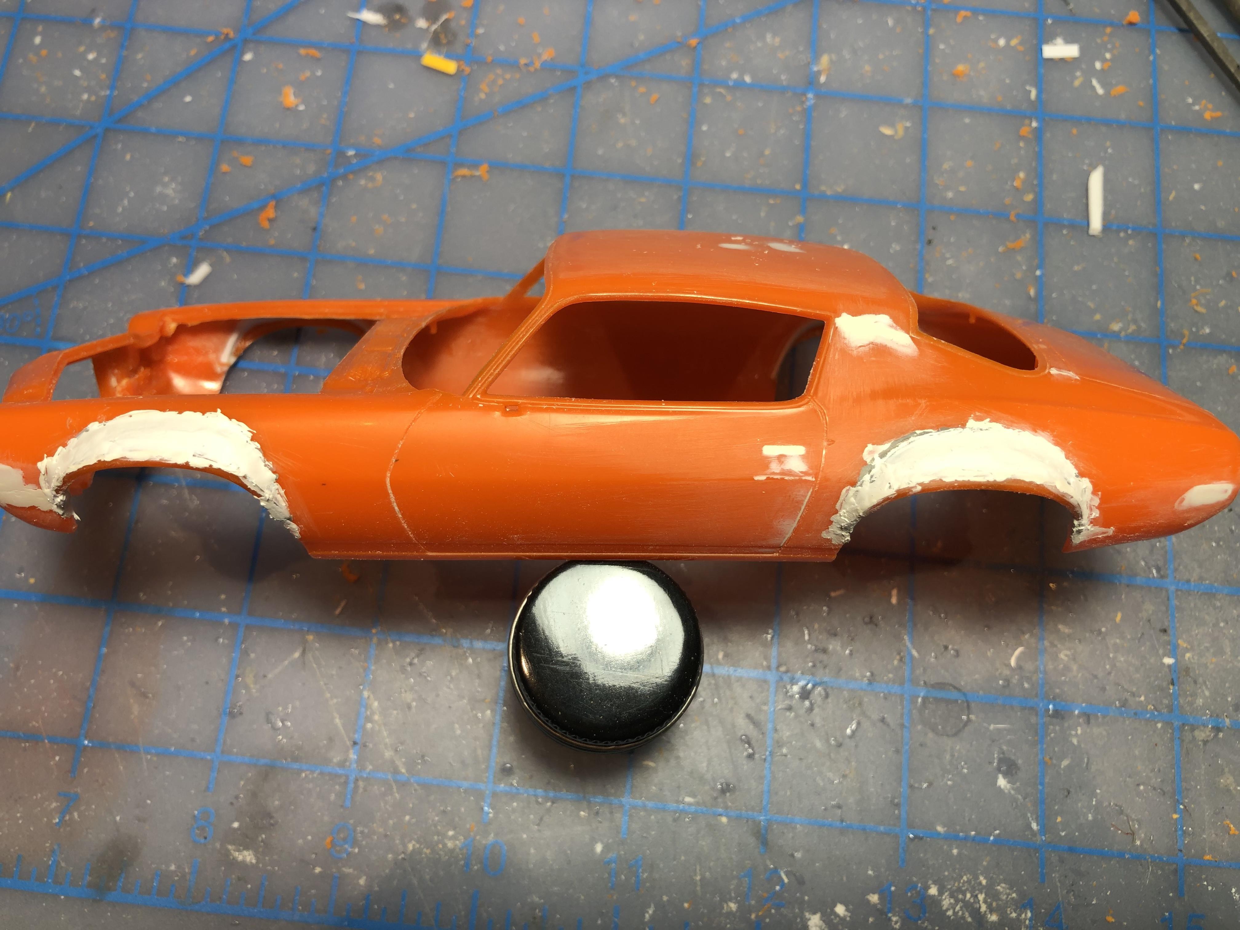

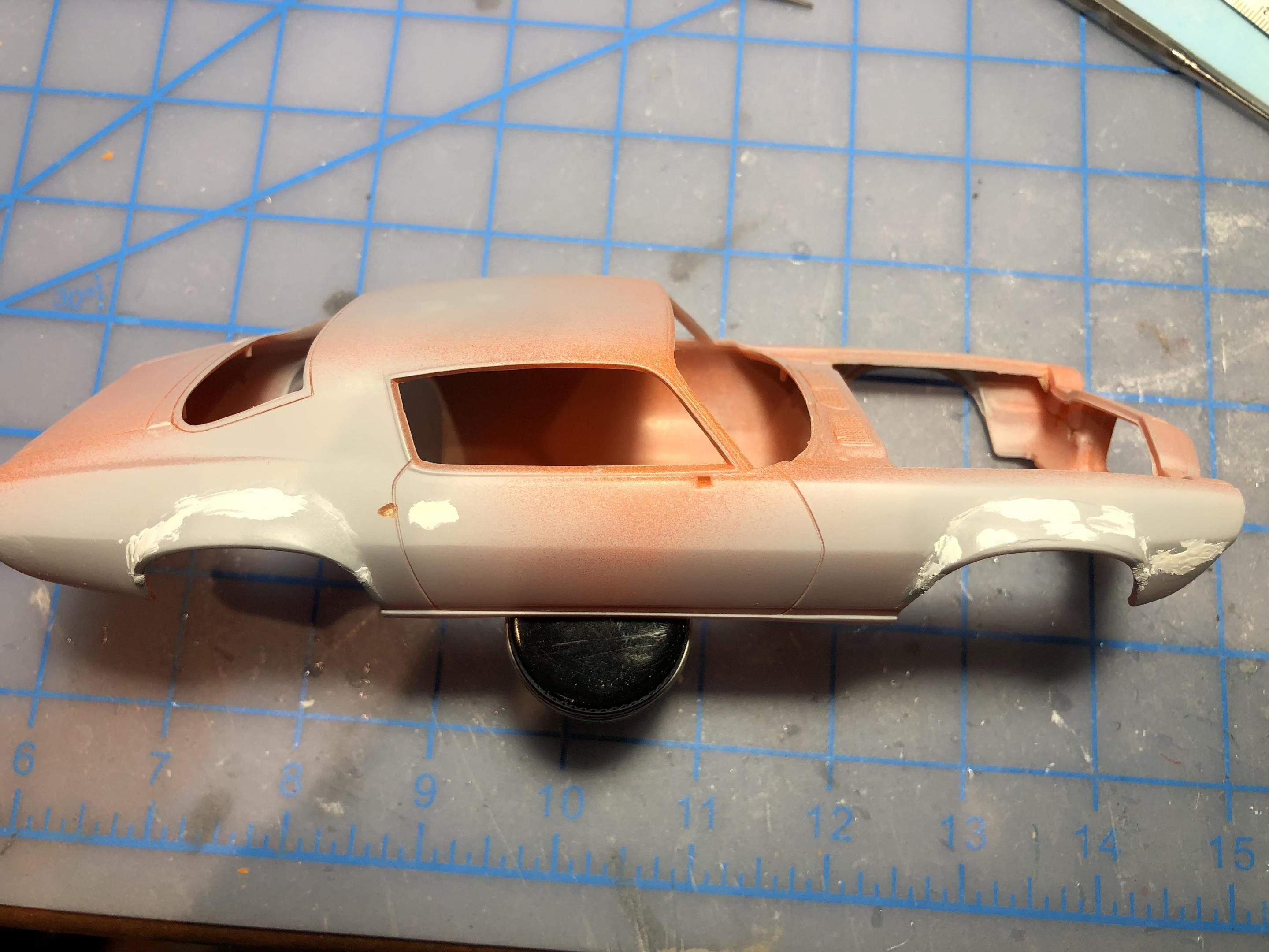

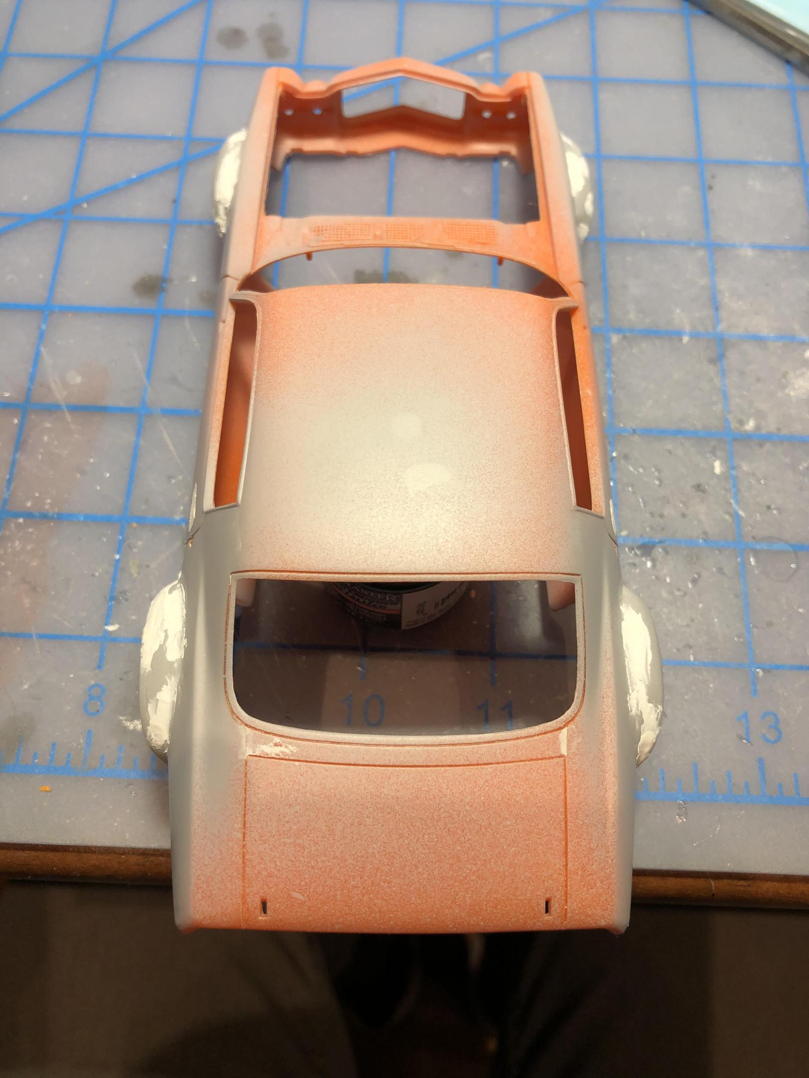

Hi fellas, a bit more progress.

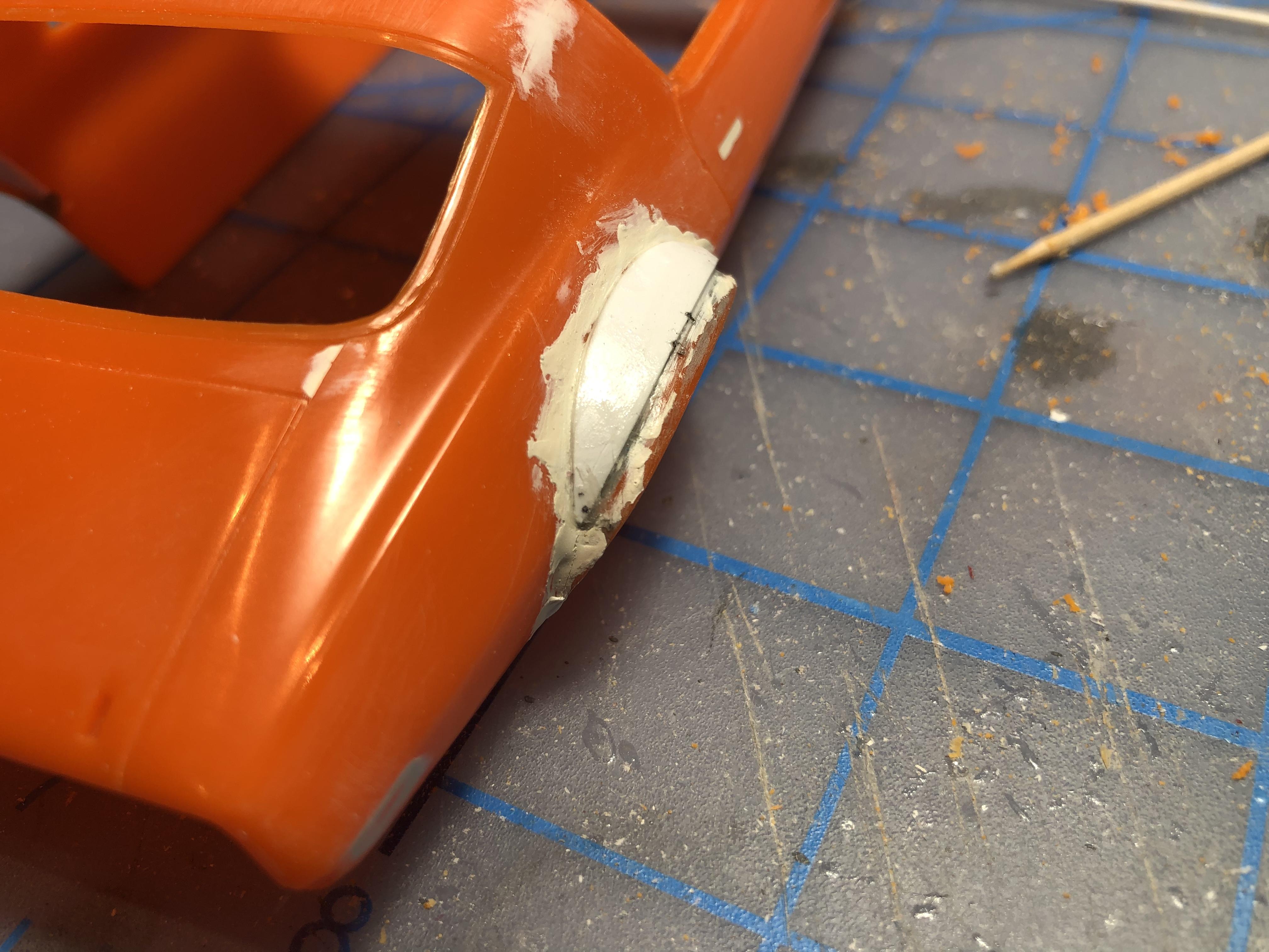

I have all 4 fender flares done, well…. not “finished” just roughed in. Lots of cleanup to do yet. When I started the cutting and shaping, I had plan “A”, with plan “B” on the back burner. Soooooo, plan A was hoping that once attached they would be “perfect”, then reality. The flares were much too flat for my liking. Problem was,  I couldn’t really go higher up into the body as it would mess up chassis fitment, and I wanted the lips of the fenders at the height I attached them. So I cut some styrene sheet and added them on the tops of the flares. This will give the flares a little more slope, and look more like the real car.
Same for the fronts…

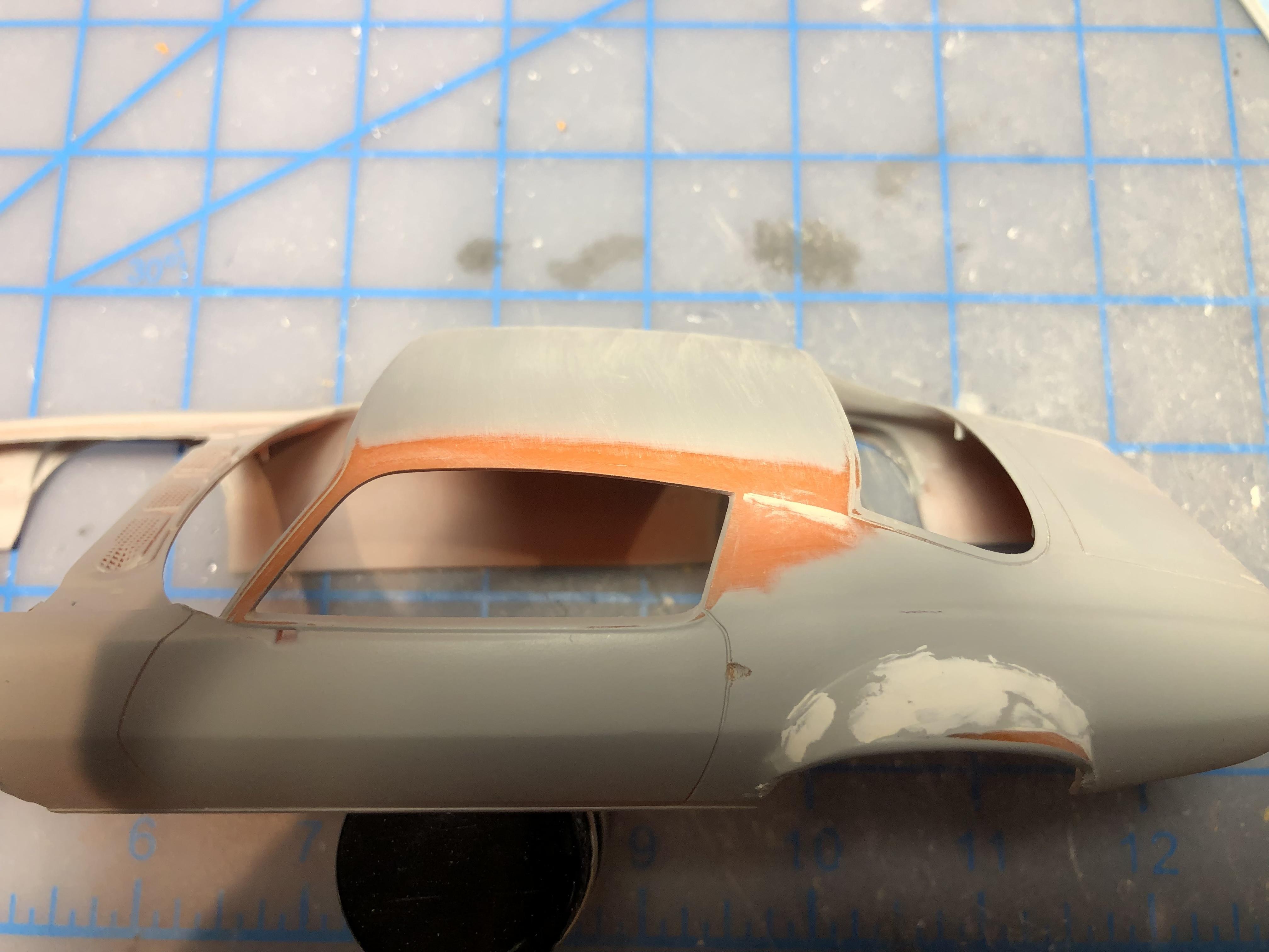

First shmeer of bondo…B785F4F5-E2B5-4296-A159-965B8F8A367A.thumb.jpeg.3b4d4556002fad9bab73e92a88a2f657.jpeg
Yikes, that’s a mess. Don’t worry, I’ll clean it up!

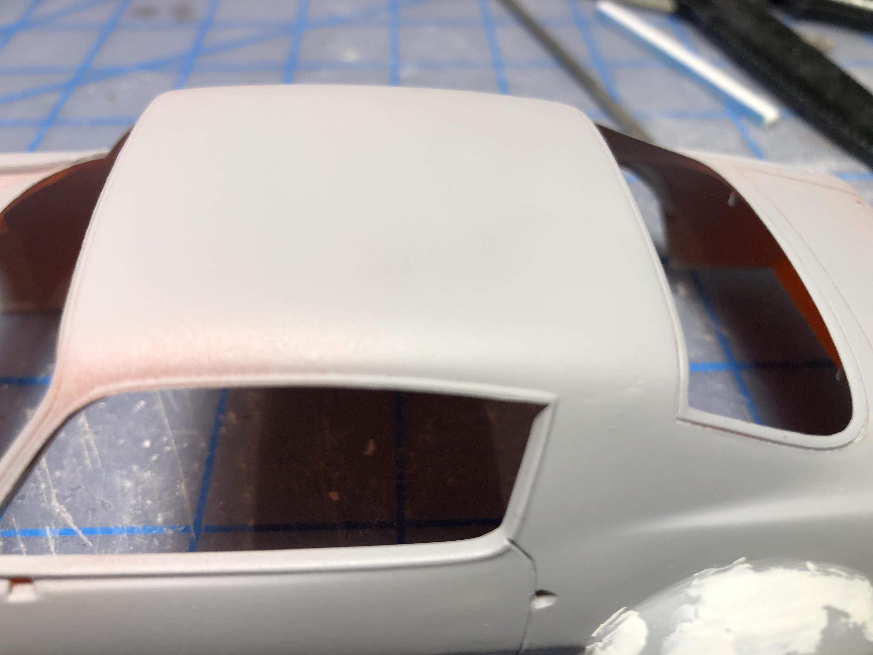

It’s premature for primer I know, but really needed to see what I had after round one. In the next photo you can see I also started on the “door handles”
Here’s a screen shot showing the door handle, and some info on the car.
I still have a lot of sand/fill/prime to do but I’m pleased with the overall shape now. I will do more clean up on the door handles too of course.
Thanks for having a look, more soon!
Nice work on those fenders Steve. I find getting them even is pretty difficult.
You guys keep building these wicked Camaros I might have to dig this one back out. Started 20 years ago and the paint went south on me so it's stripped and ready for new bodywork.  The white paint sure hides the flared fenders though.
111 1198
Hi Steve, yes indeed, I am a bit worried they won’t be even. Everything measures out good, and in this paint looks good by eye. Hopefully once it’s in final paint there isn’t any surprises….

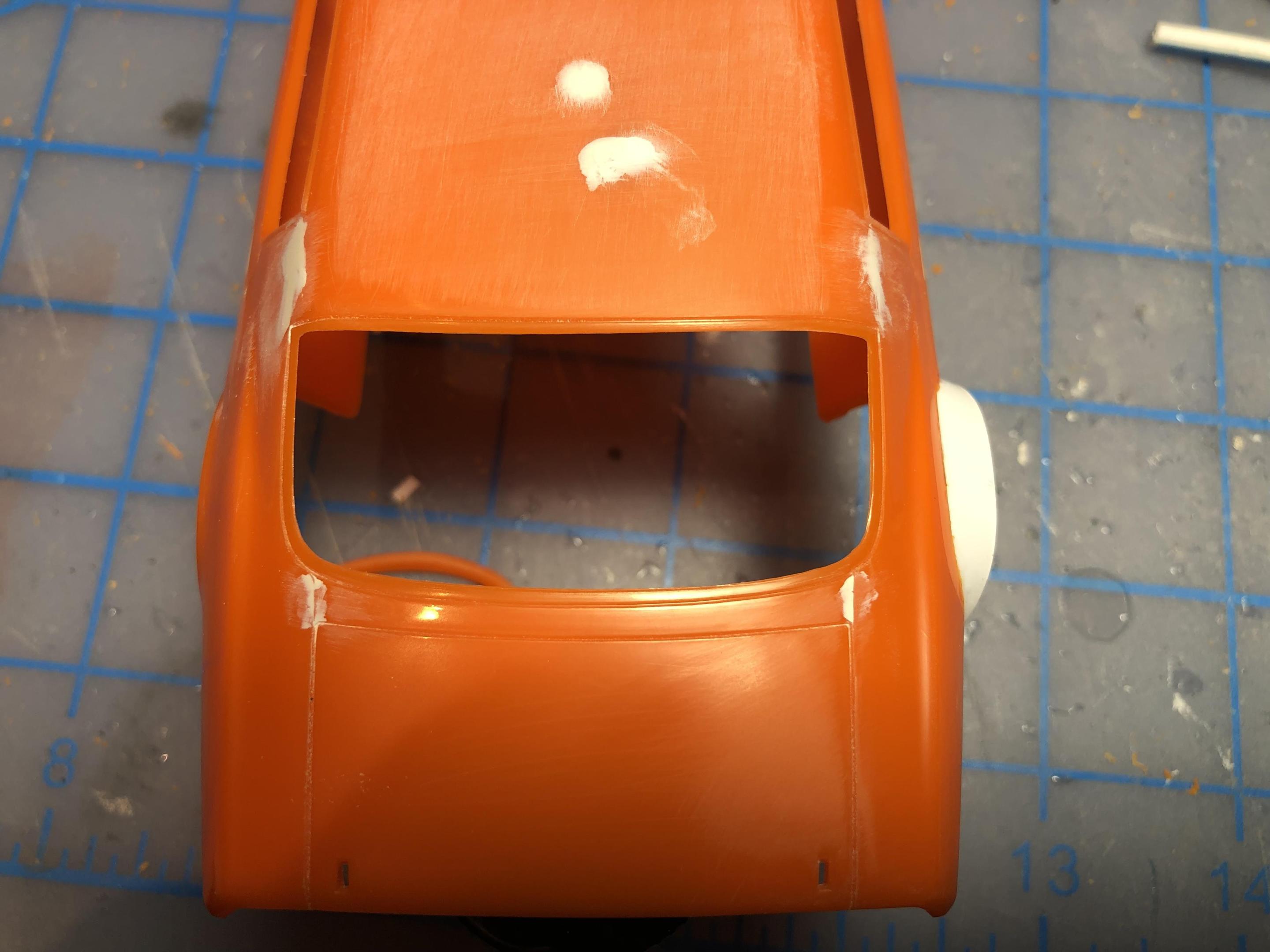

Hi guys, had a reasonable day at the desk.

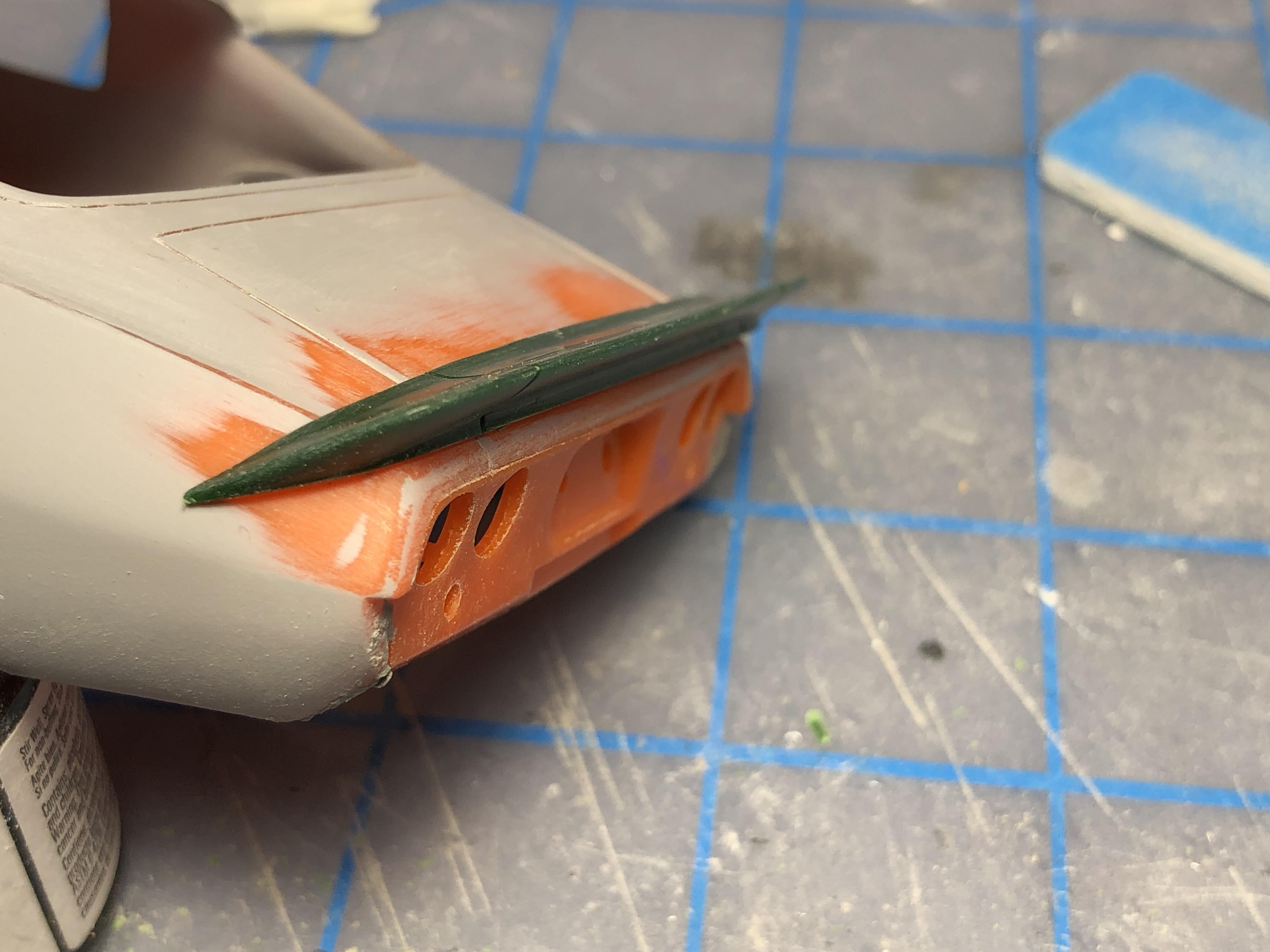

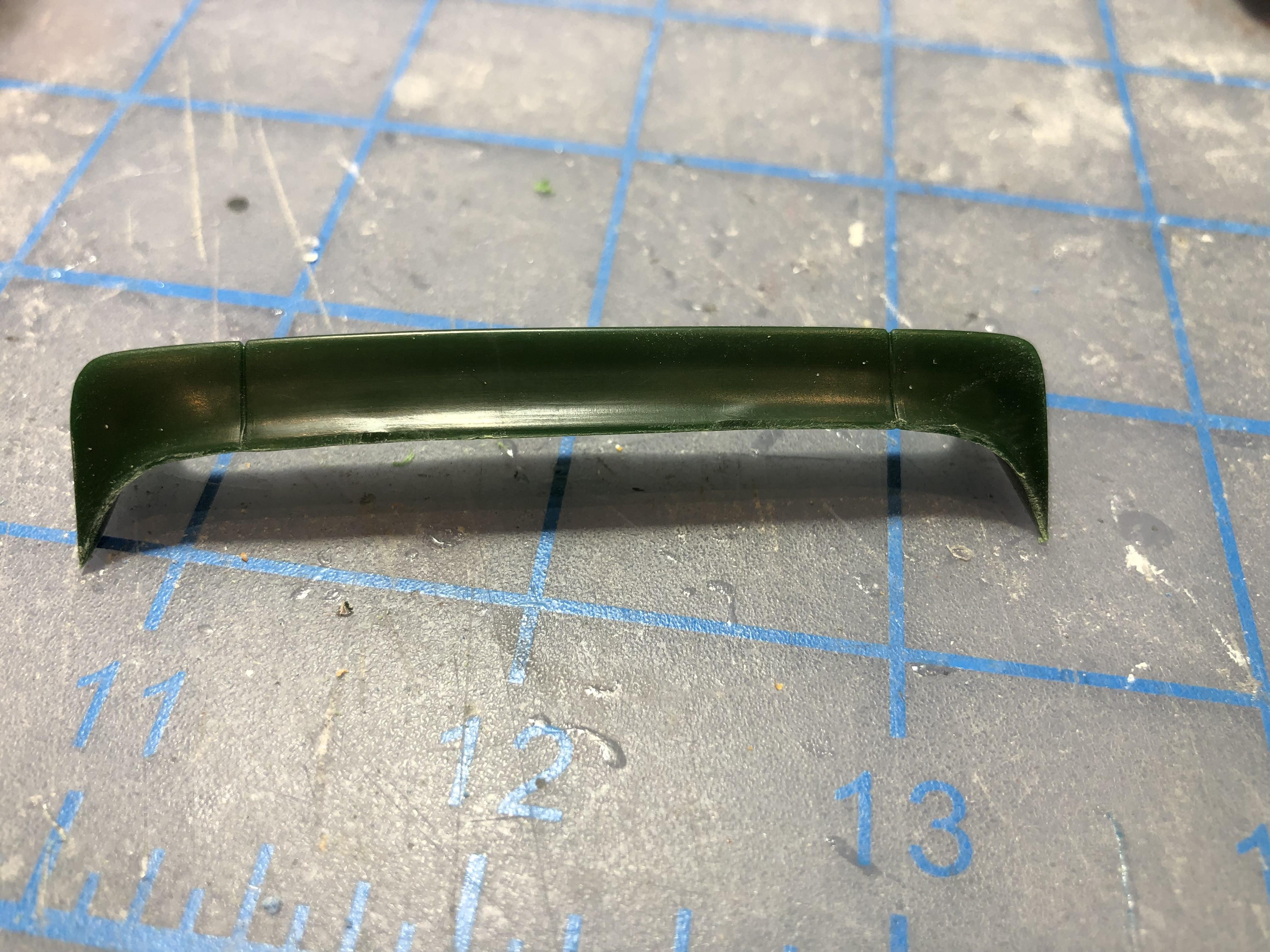

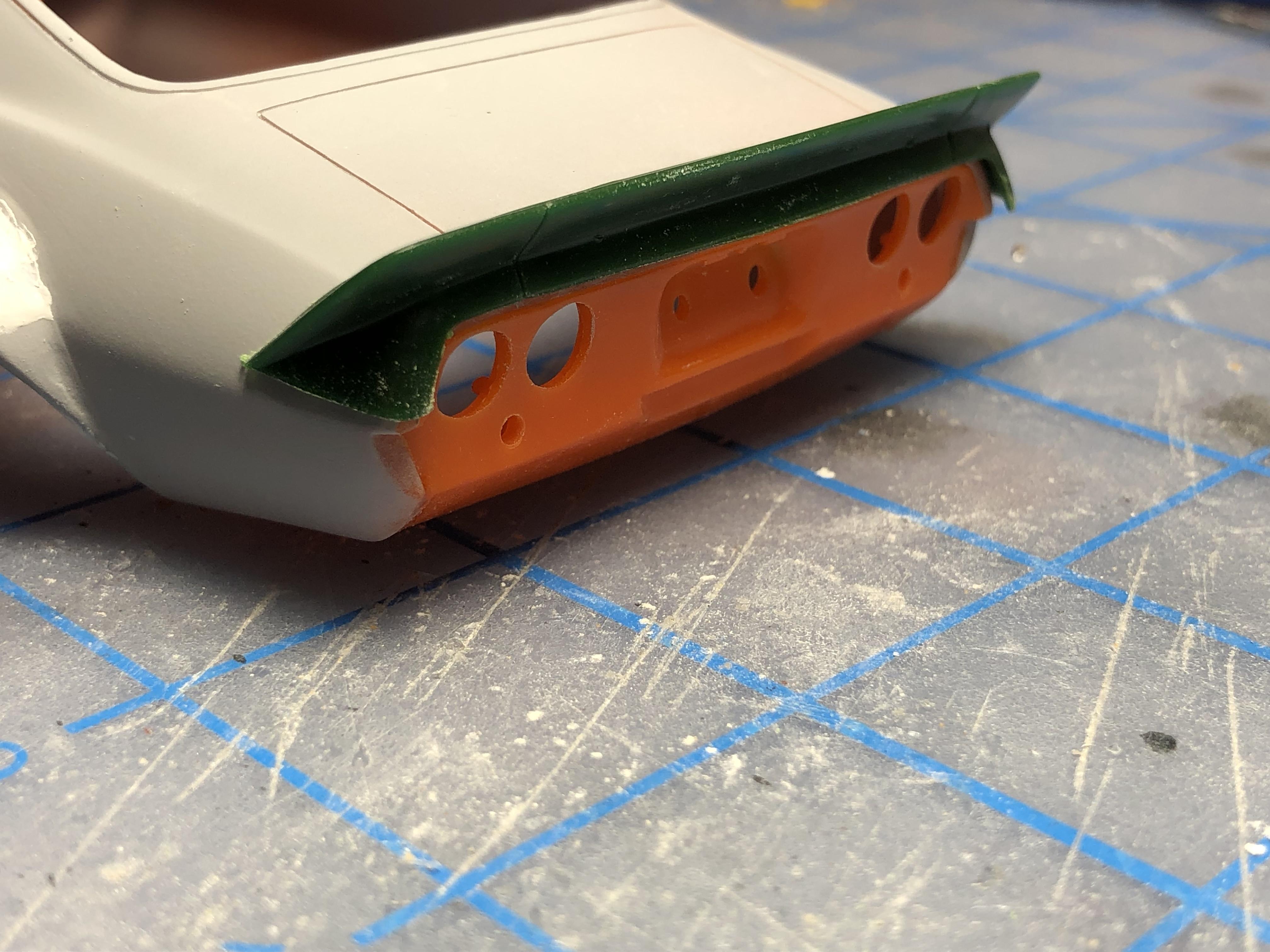

It was time to start playing with the rest of bodywork. I pulled the rear spoiler from Baldwin Motion issue. The rear spoiler needs some work. In my eye, it’s way too bulky, it’s also got some nasty sink marks.
Hard to tell in the photo, but doesn’t conform to the lines of the trunk lid either.
It still needs lots of work, but much better…

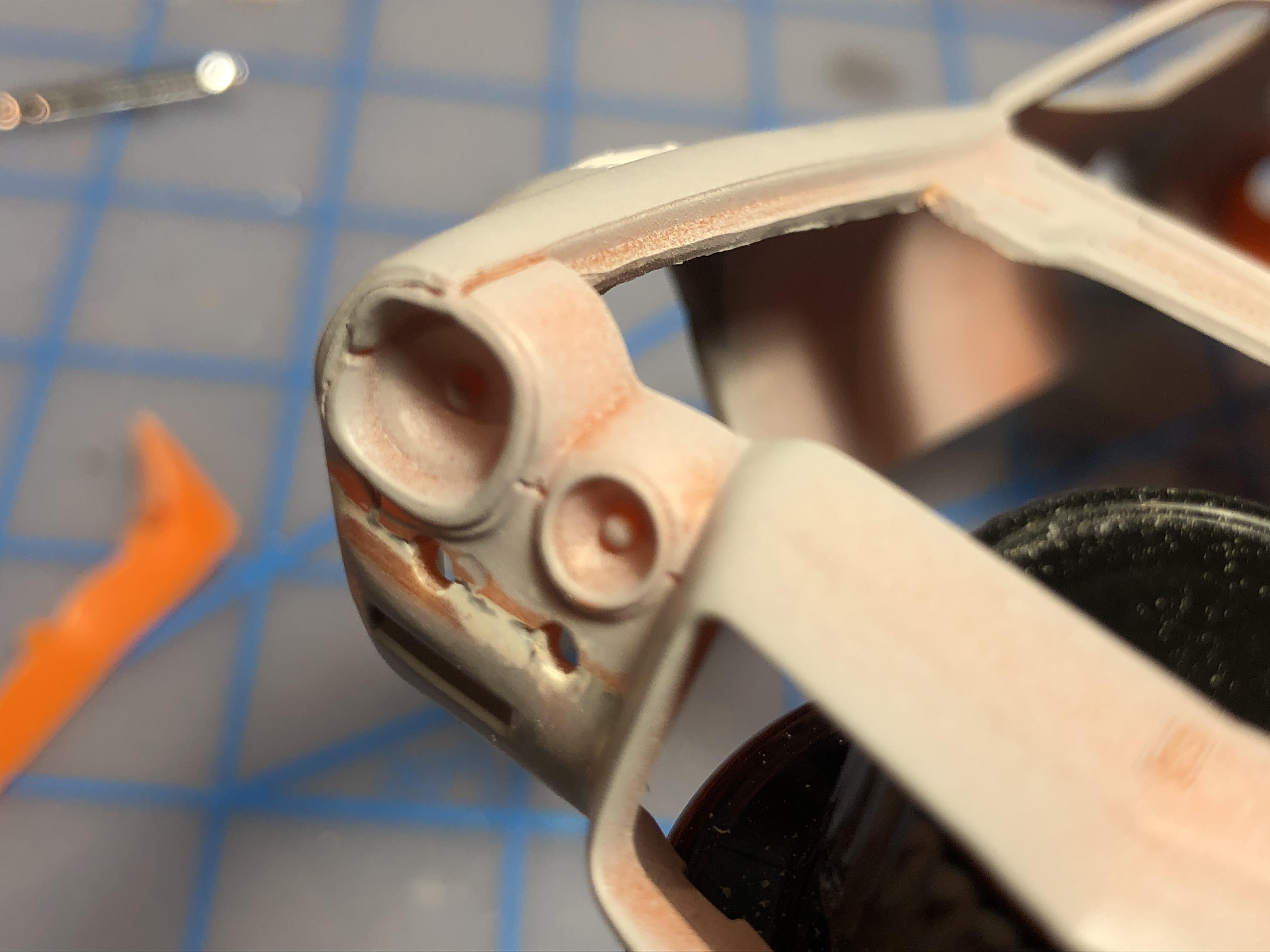

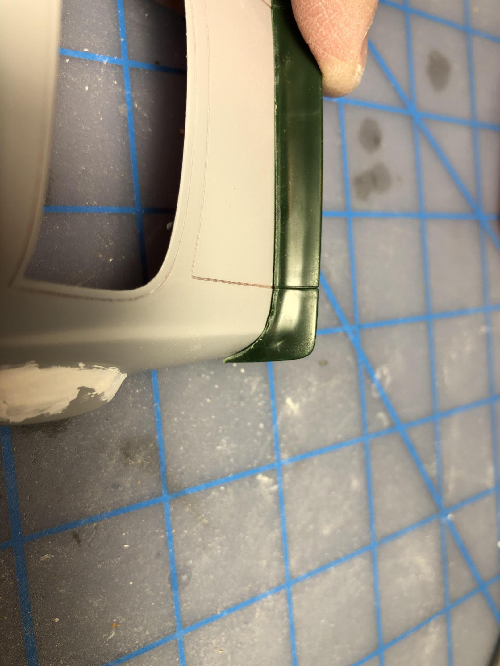

Next up, the drip rails need to go…

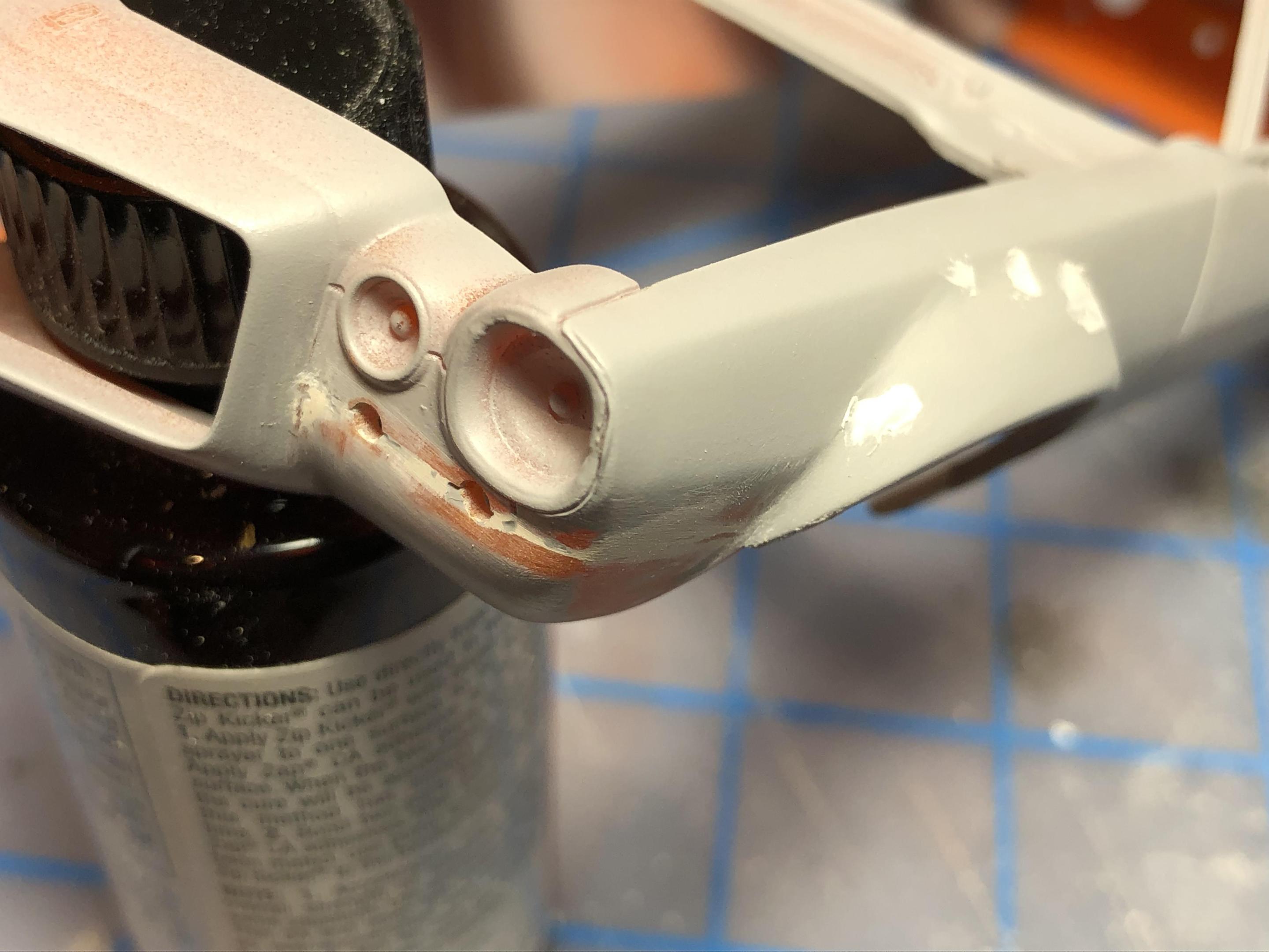

Not sure what to say about the headlight area, yikes!!
I will tackle this and the rear bumper next. LOTS of fidelly stuff to do on the headlight area, not looking forward to it. The rear bumper mods should be easy.
