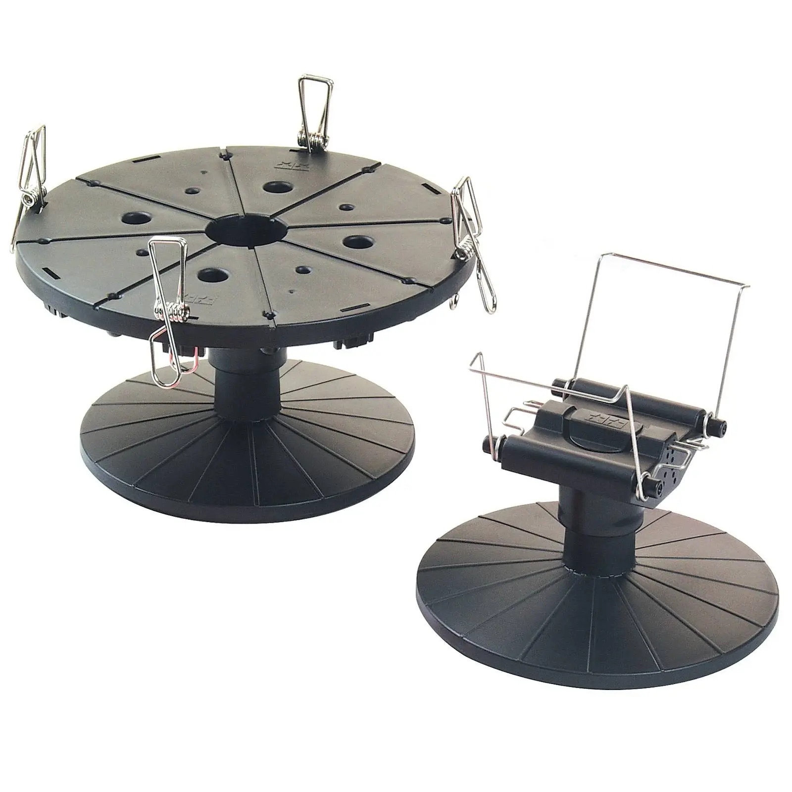

Bainford Posted December 6, 2021 Posted December 6, 2021 Most of the purchased holders used on the forum are from Tamiya From what I understand, the Tamiya stands are quite nice, though I've never used one. Most guys improvise some type of holder. Mine is fashioned from a wire coat hanger. It's pretty much what I've been using for the last 40 years. If I was home right now, I post a photo.
yh70 Posted December 6, 2021 Posted December 6, 2021 (edited) i have had mine fo many years...u can get them from...Amazon, eBay, Hobbylinc, Tower Hobbies, Tamyia sells them direct since its their stand...hobby lobby do sell them must have been out..just about any hobby shop will have them .. Amazon probably your cheapest.... https://www.google.com/aclk?sa=L&ai=DChcSEwiujMTFws_0AhWTK0wKHQThCl0YABALGgJvYQ&sig=AOD64_3Ed_WONCwdNmPxl5-m-A9ueLJwEQ&ctype=5&q=&ved=2ahUKEwjJ8LjFws_0AhWNl2oFHdj1AfkQ9aACegQIAhBH&adurl= Edited December 6, 2021 by yh70
Mike C. Posted December 6, 2021 Author Posted December 6, 2021 Thats the one. I think my local hobby lobby is a victim of the supply chain. I'm tired of the old empty spray paint can with a piece of tape that ends up falling over and destroying my paintjob method. Those things look like just the thing I need.

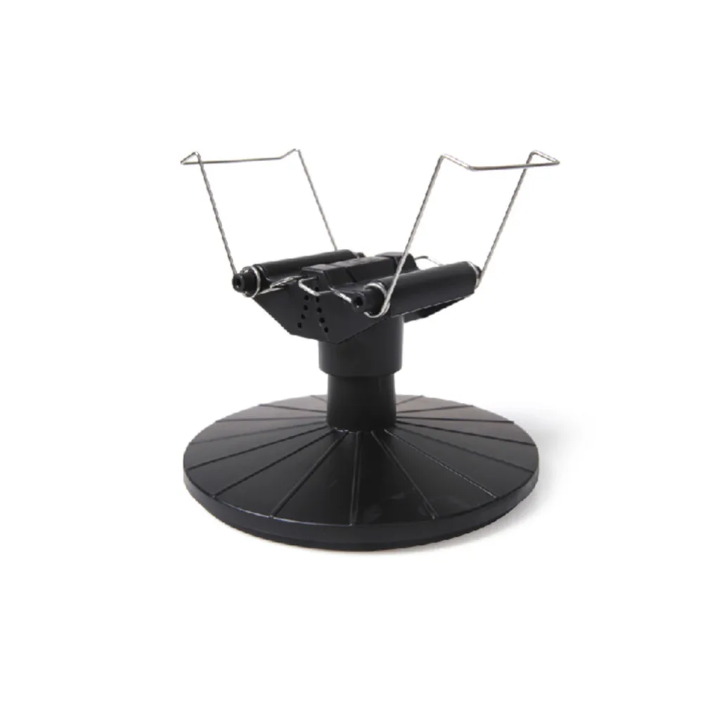

Monty Posted December 6, 2021 Posted December 6, 2021 IIRC, the Tamiya holder is fairly well designed but I've read a number of reviews stating that they come apart fairly easily, especially when in use. (apparently they're snap-fit) Can anyone comment on that?
TransAmMike Posted December 6, 2021 Posted December 6, 2021 We're not talking rocket science or precision instrument here. I works, the base does slip out fairly easily from top part so when you carry it around with a model on it be sure to hold it from the base. Oher than that it's a simple mechanism and works just fine. I like mine. Just my 2 cents here.

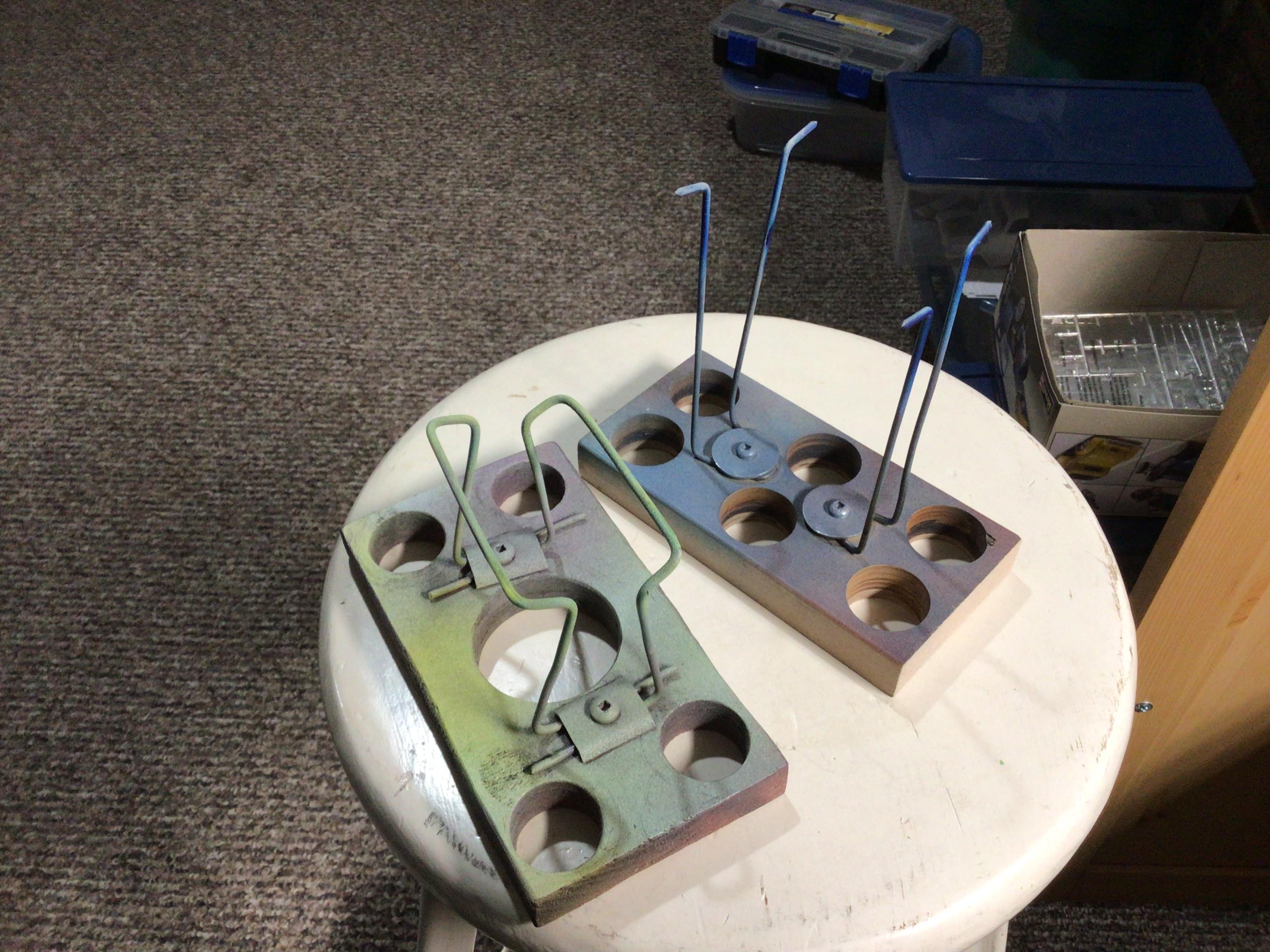

NOBLNG Posted December 6, 2021 Posted December 6, 2021 Here’s a couple I made from a coat hanger and some wood. 2

Straightliner59 Posted December 6, 2021 Posted December 6, 2021 1 hour ago, NOBLNG said: Here’s a couple I made from a coat hanger and some wood. That is essentially what I have--except mine's crude!

iBorg Posted December 7, 2021 Posted December 7, 2021 The only problem with the Tamiya paint stands if you're as anal as I am, you'll be upset about them getting coated with paint. Cleaning primer from them is a bit of a challenge. The purple pond and metal is not a good combination.
yh70 Posted December 7, 2021 Posted December 7, 2021 11 hours ago, Monty said: IIRC, the Tamiya holder is fairly well designed but I've read a number of reviews stating that they come apart fairly easily, especially when in use. (apparently they're snap-fit) Can anyone comment on that? yes they will..they do not snap together they just slide together..i learned the hard way as i was painting a truck cab (with the smaller one) turned it upside down and it came apart..thats the only down fall. they should have made it snap together or screw together. but its a easy fix if u buy it (i love mine) glue it together with some super glue. thats what i used..no more problems.... now i only glued the small one that has the adjustable wire settings on top.. thats the one you gonna be turning upside down..
Keavdog Posted December 7, 2021 Posted December 7, 2021 I have a couple of these. The clips really come in handy for fiddly bits or parts on sprue. If concerned about coming apart it would be easy enough to pin. Mine are covered in 40 colors of paint ?

Rbray47 Posted December 7, 2021 Posted December 7, 2021 I've had bodies slip off the Tamiya stand before. I wrapped wire insulation around the metal where it contacts the car bodies. Helped some, but not enough. Now I just stick a small piece of tape over the metal and onto the inside if the body.

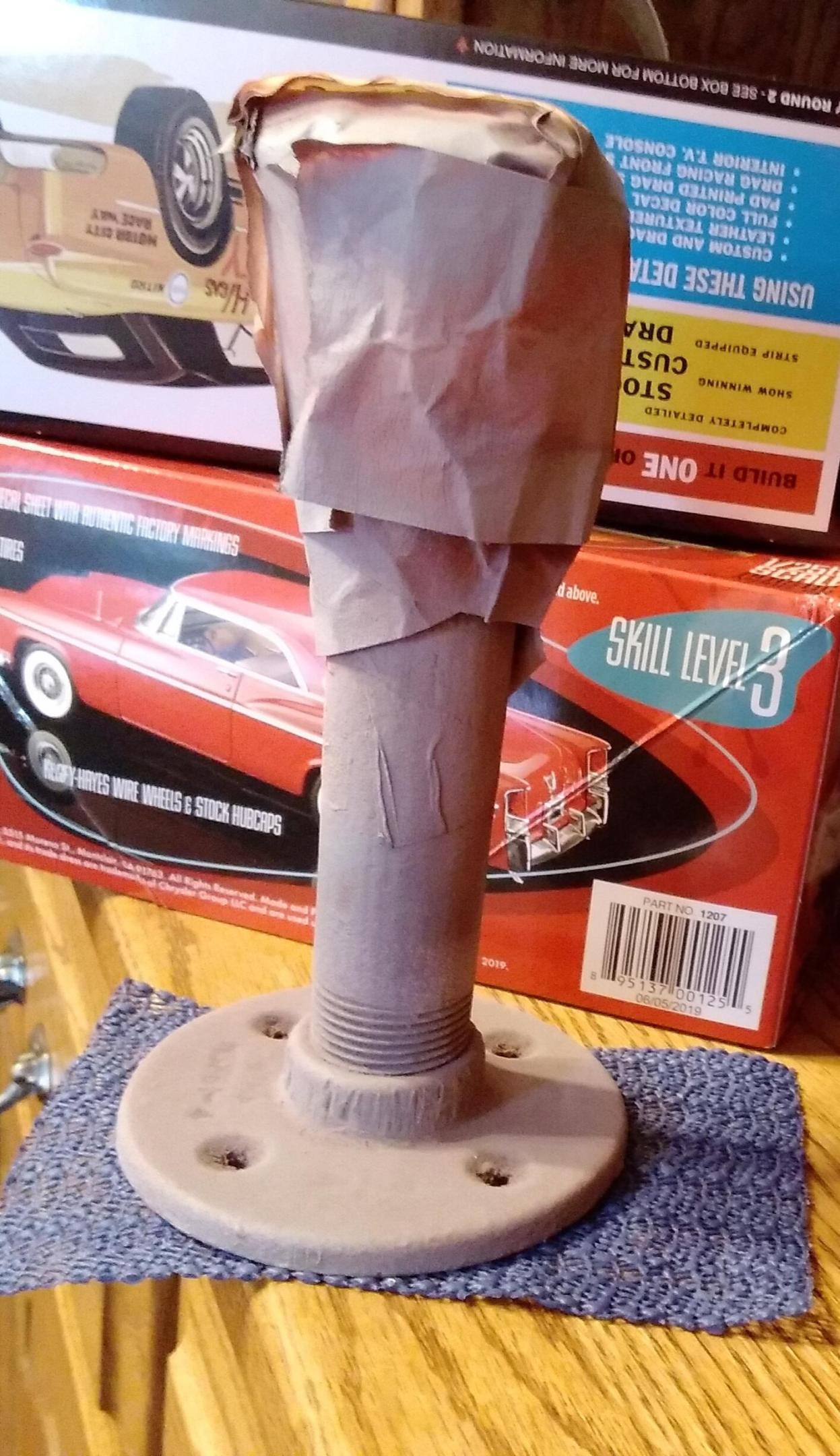

customline Posted December 8, 2021 Posted December 8, 2021 It's not the best but it works. It's heavy enough to be stable and the making tape holds the odd pretty well. Most of us would recognize it for a black iron pipe 6" nipple with a base on one end and a cap on the other. Add enough masking tape to create a little cusion. It's not my idea but I've used it for years and it works for me (and I had all the stuff in my garage ?)
