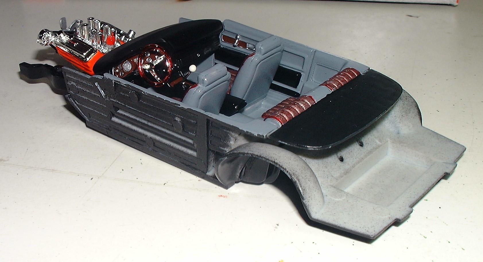

Tom Geiger Posted December 12, 2021 Posted December 12, 2021 20 minutes ago, StevenGuthmiller said: I guess, if that’s your thing...... Here ya go Steve! Chevy pickup interior I got as part of an old parts kit.
SSNJim Posted December 12, 2021 Posted December 12, 2021 1 hour ago, Tom Geiger said: then there are the guys who spray the entire interior flat black and are done with it! ? Guilty as charged. 1
StevenGuthmiller Posted December 13, 2021 Posted December 13, 2021 2 hours ago, Tom Geiger said: Here ya go Steve! Chevy pickup interior I got as part of an old parts kit. Looks great! ? Steve

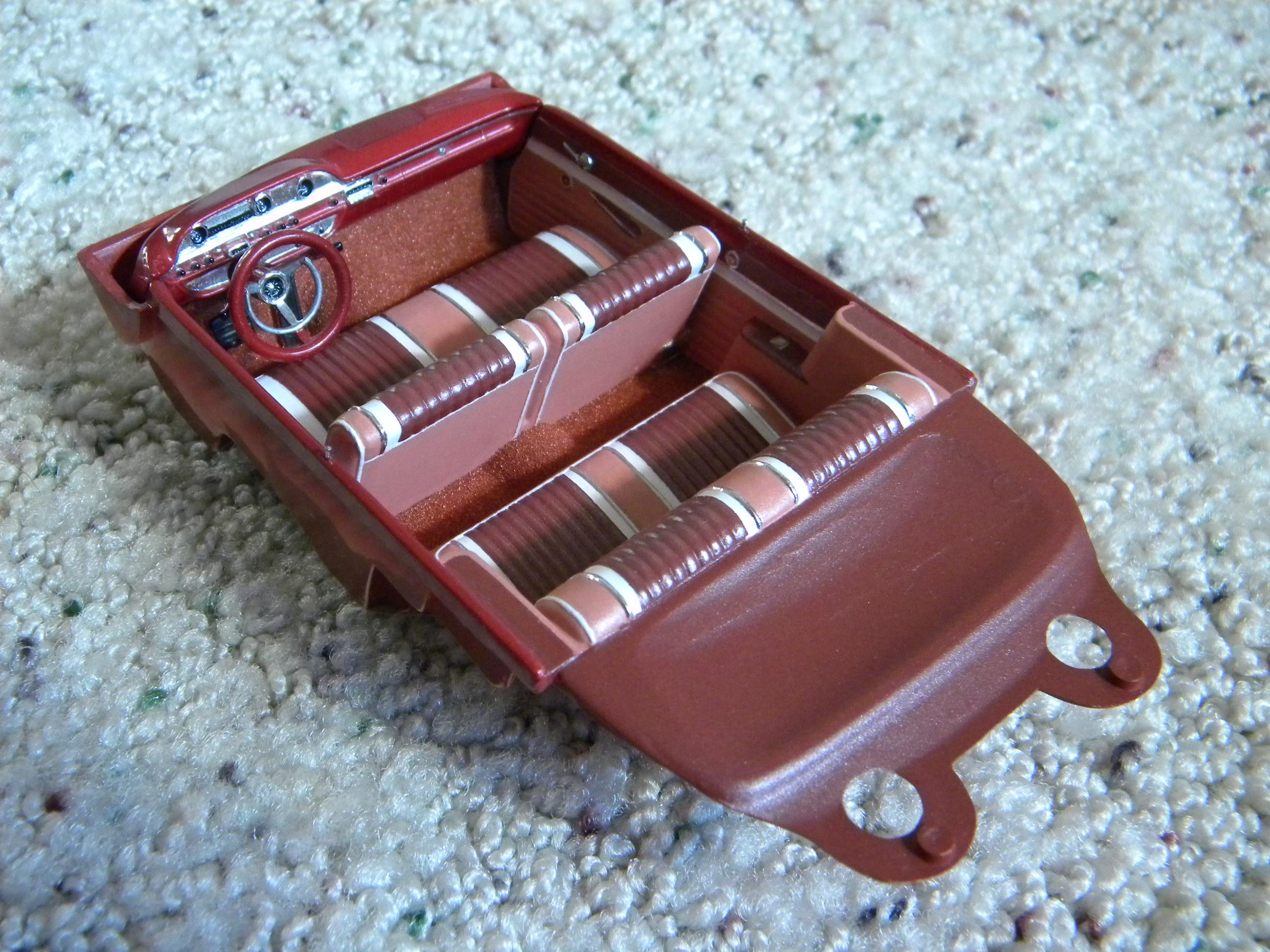

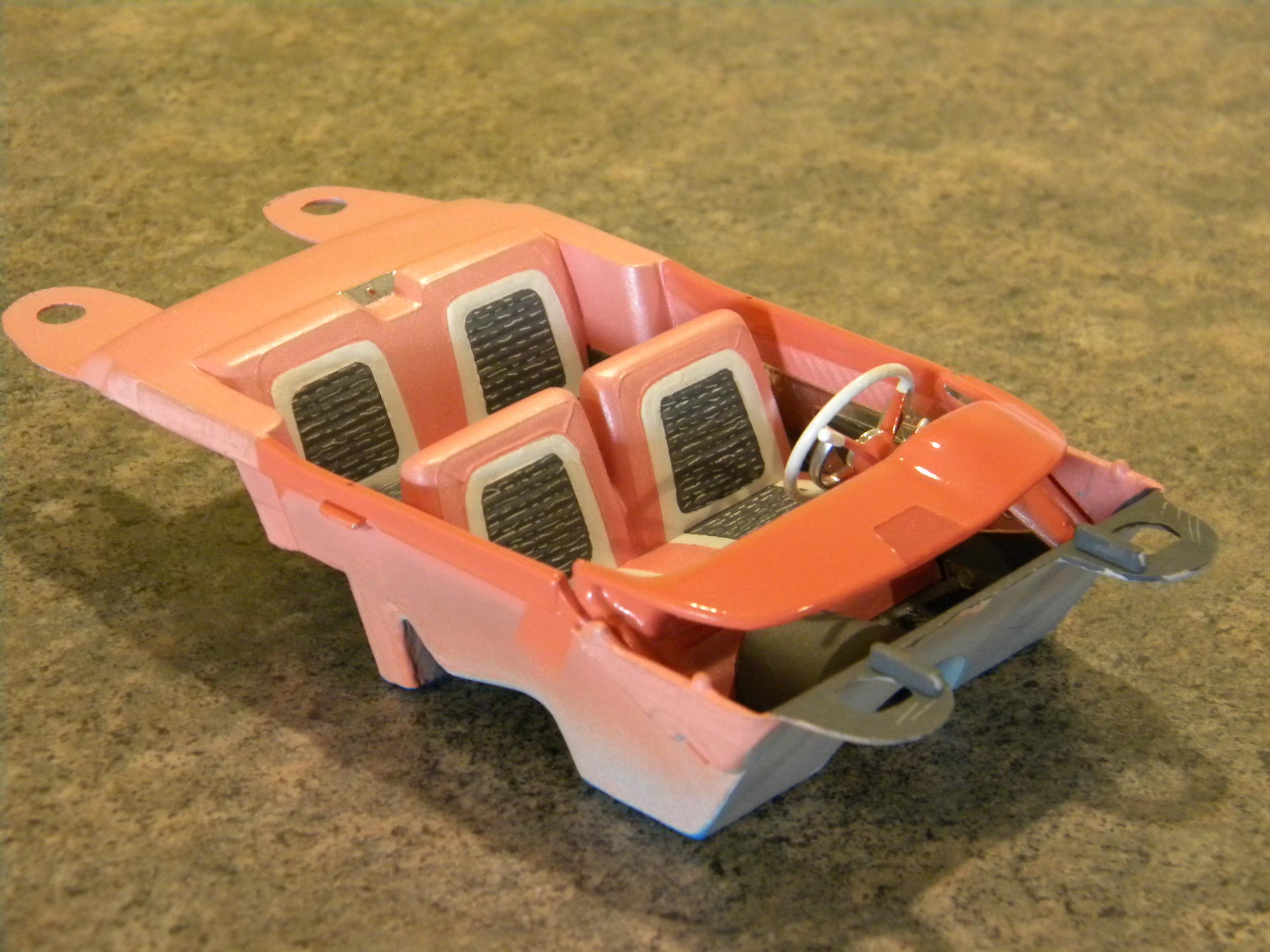

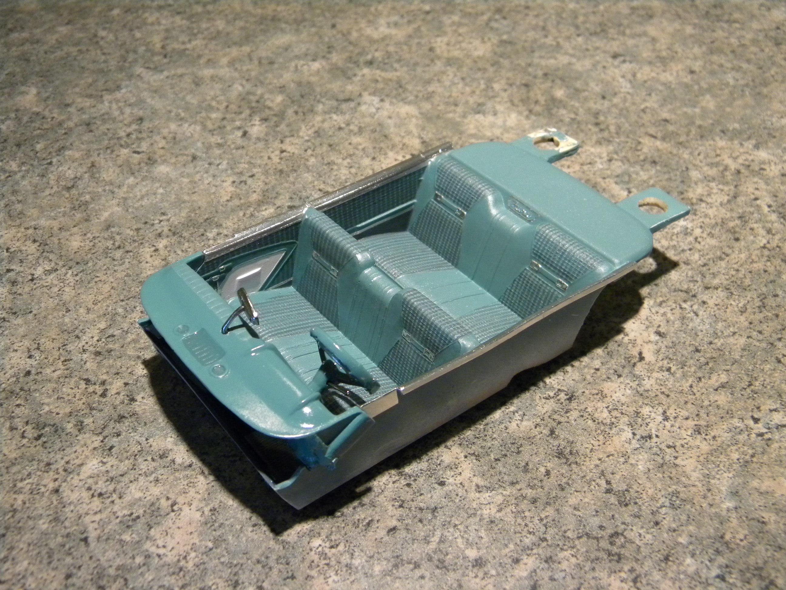

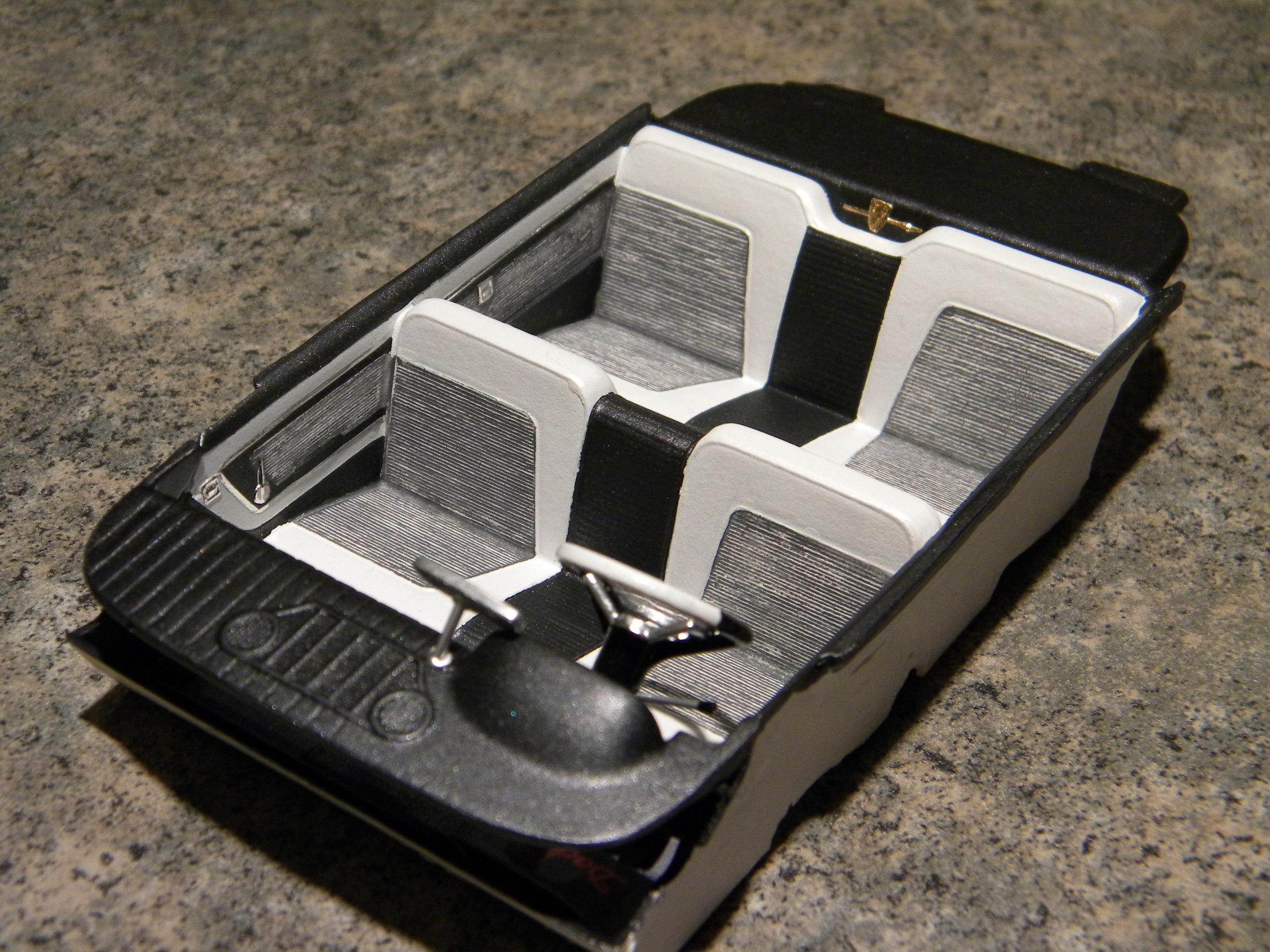

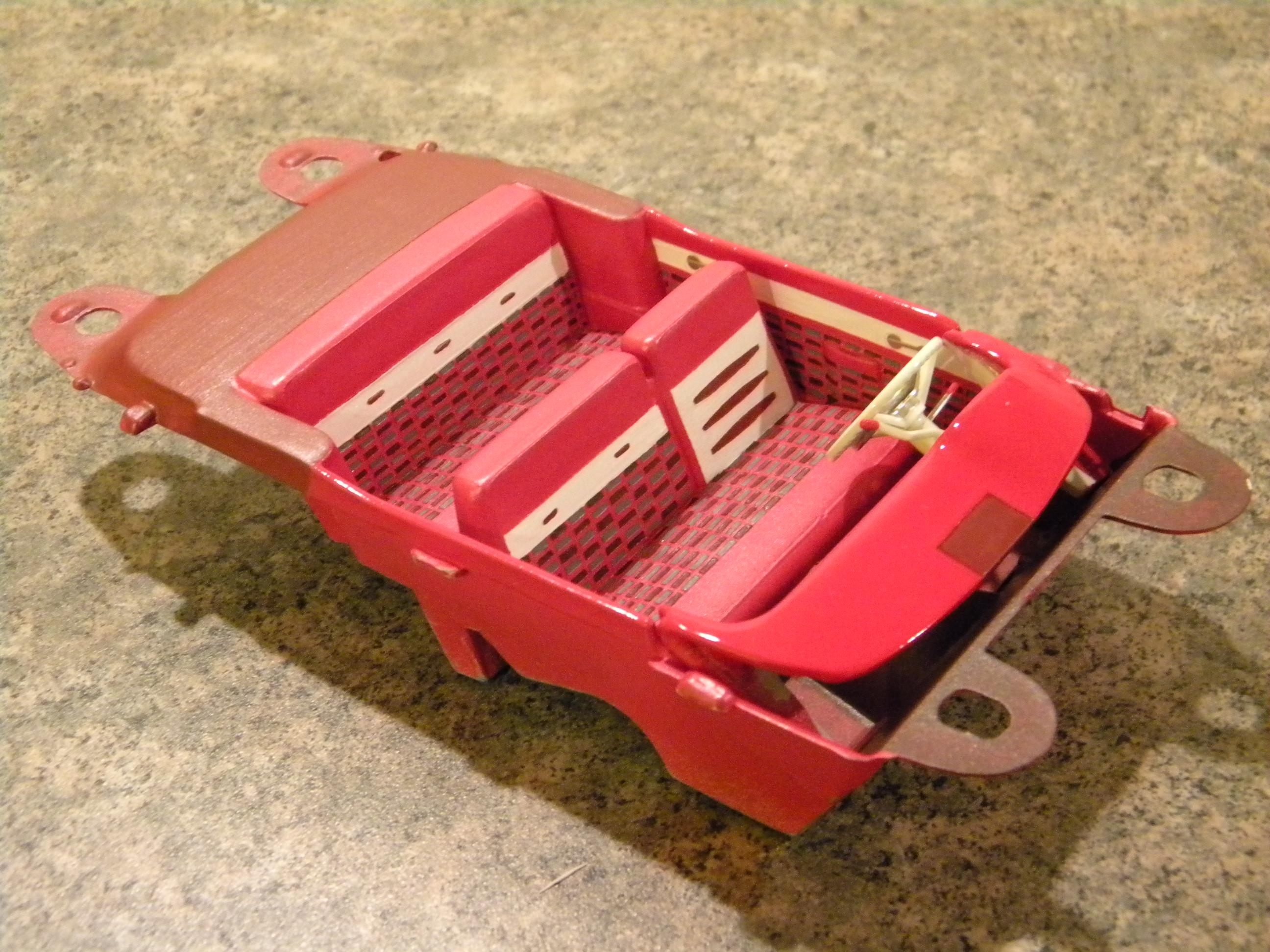

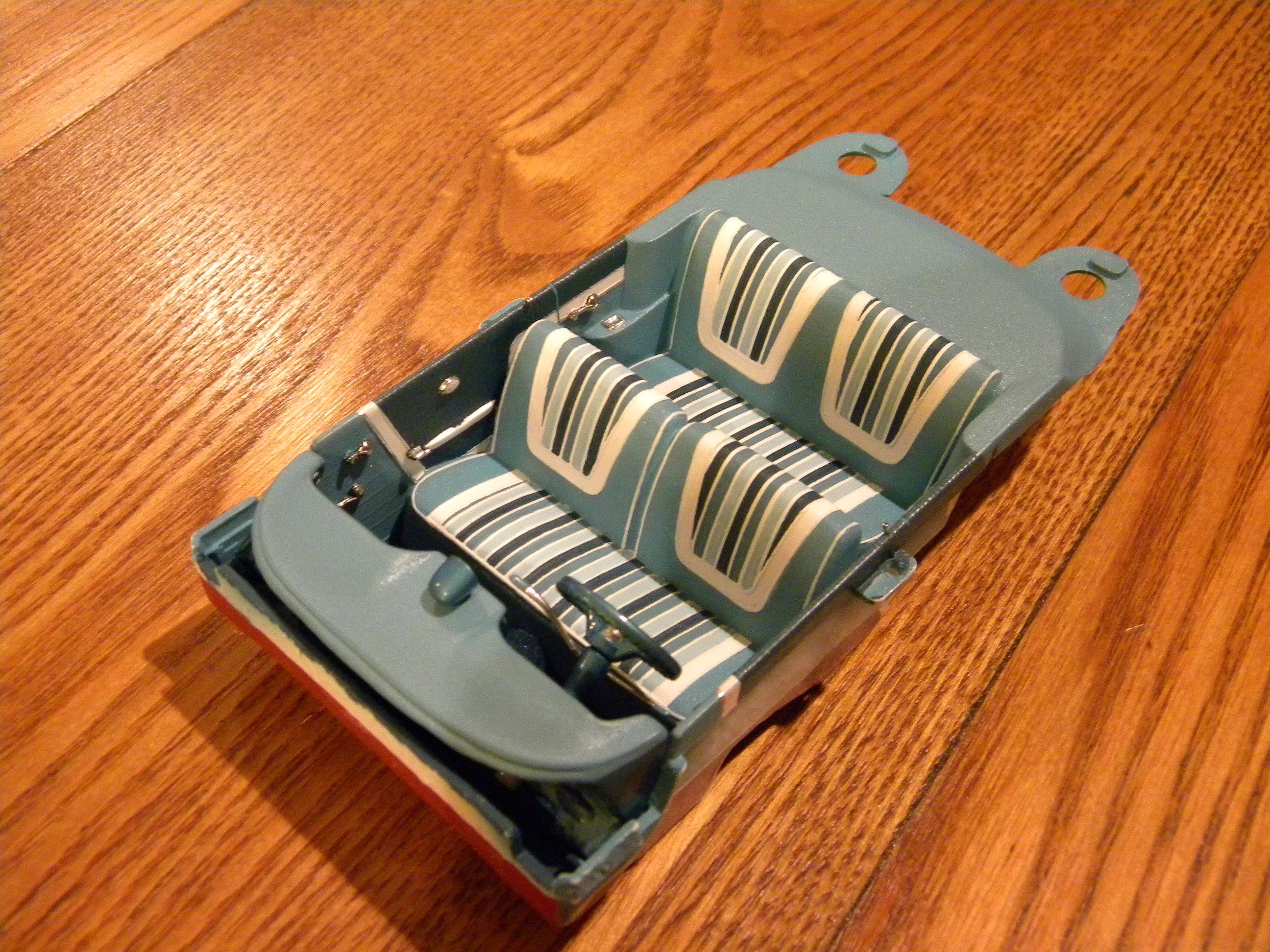

StevenGuthmiller Posted December 28, 2021 Posted December 28, 2021 21 hours ago, charlie8575 said: Is the checked pattern in the Edsel interior painted, or did you use some kind of marker for those? Same question with the Plymouth. I'm planning on doing a '59, and was thinking Scale Motorsports blue plaid decals would be a decent start, if nothing else, it would give me a good grid to work with, and I can dot it in with a blue technical pen. Charlie Larkin They are both paint. The Edsel was just masked vertically and horizontally for each color. The Plymouth is just vertical stripes, bu due to the engraved seat pattern, it appears as a checkered pattern. Scale Motorsports makes fantastic seat upholstery decals! I’ve used them on several occasions. If you can find decals that are close to the pattern that you want to achieve, by all means, use them! A heck of a lot easier than painting them. Steve

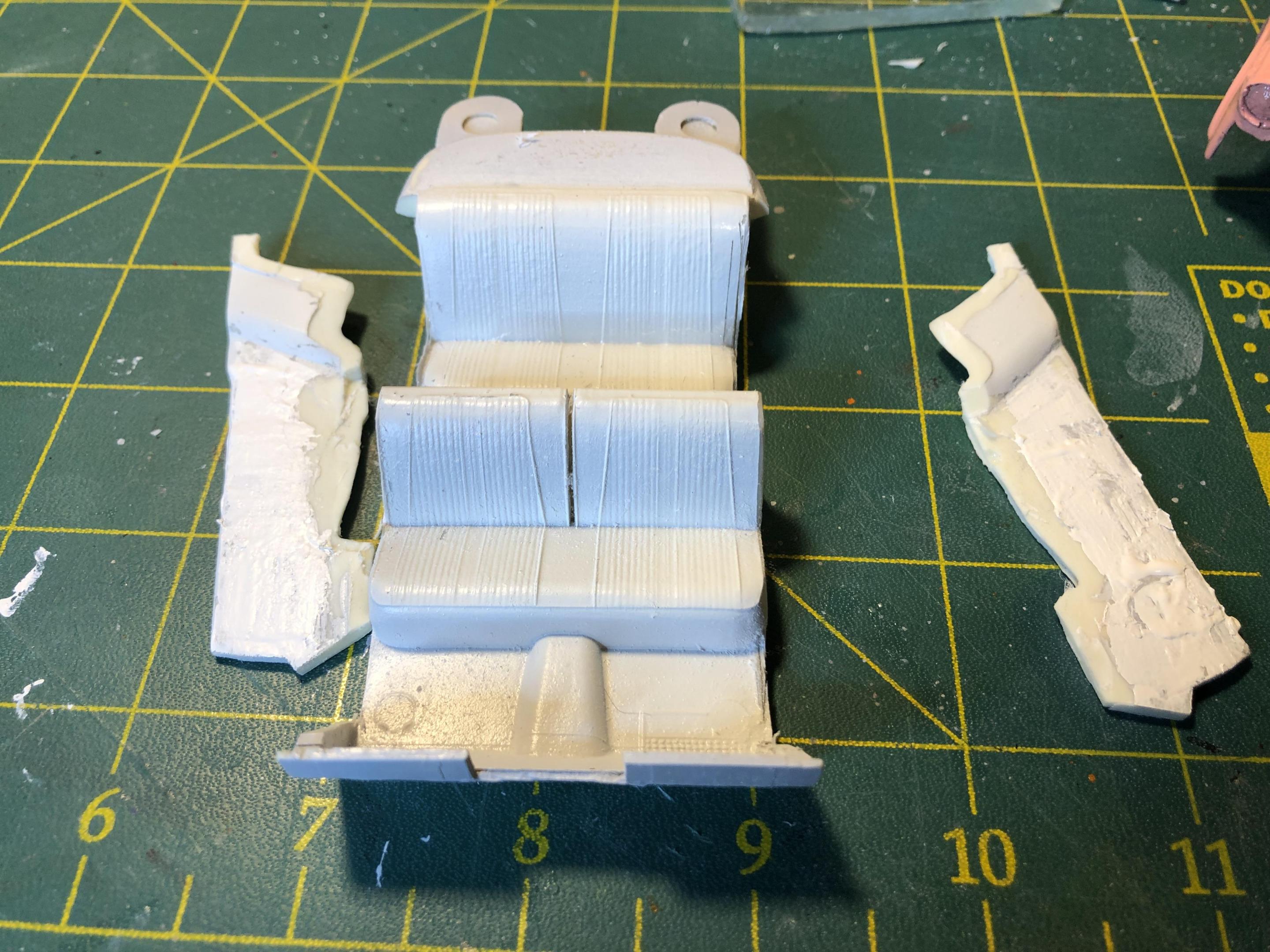

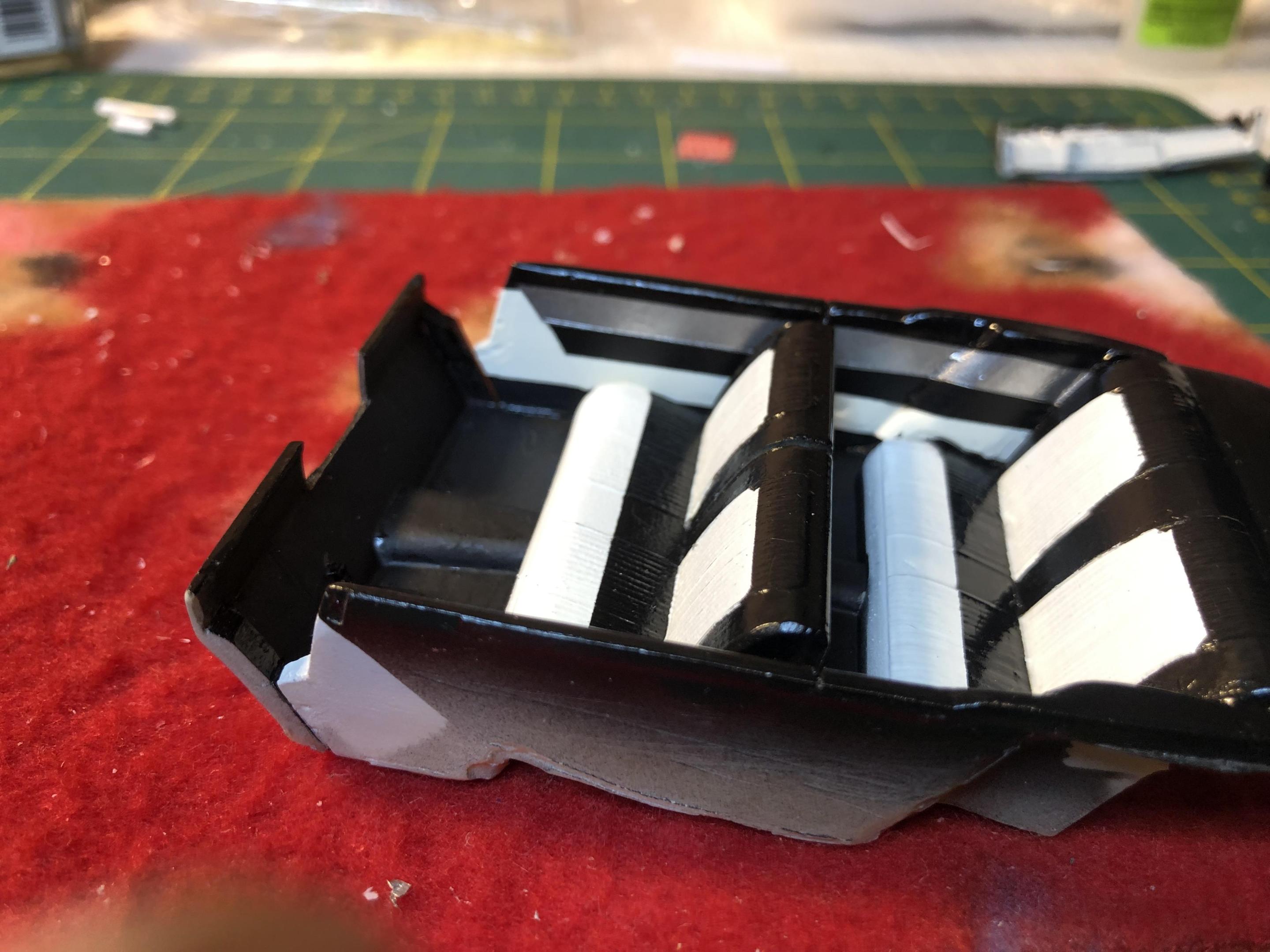

bill-e-boy Posted December 30, 2021 Posted December 30, 2021 To make it easier with the tub interiors I have cut the side walls off to detail these I did this with a 56 Dodge custom Royal Lance resin kit I did a little while ago And Tamiya tape is the go to for this. Foil can pick up paint when you remove the foil - not a great moment when that happens Steve G is the master and and seeing his interiors gives me hope

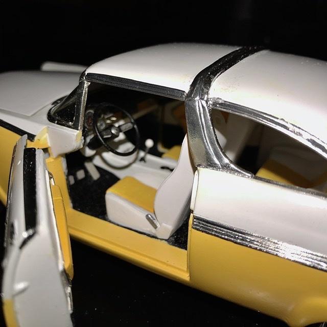

BDSchindler Posted January 4, 2022 Posted January 4, 2022 On 12/9/2021 at 1:18 PM, customline said: A lot of interiors call for only one color but '50s cars and customs are often 2 or 3 colors. I have tried tape, foil (big mistake) and just brush painting but I want a better job and spraying offers the best finish. Masking a complicated color scheme has me pulling my limited hair out. I'm not happy with anything I have done so far. I welcome all comments; please tell me what works for you. I painted the seat centers free-hand in these mustang seats I put in my custom 56 Crown Vic...

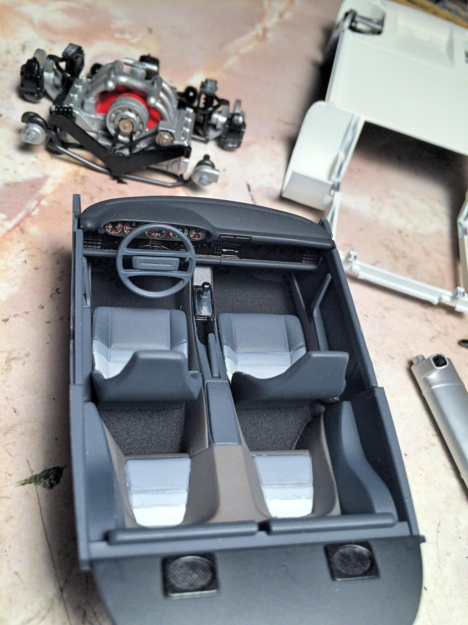

Bills72sj Posted January 4, 2022 Posted January 4, 2022 Free hand works if you have a steady hand and significant lines to guide you. If I were to go all out I would use Parafilm bordered with fine line tape. Parafilm allows you to push the edges around a bit unlike tape. It also has zero bleed under if applied properly. The pick below was free hand.

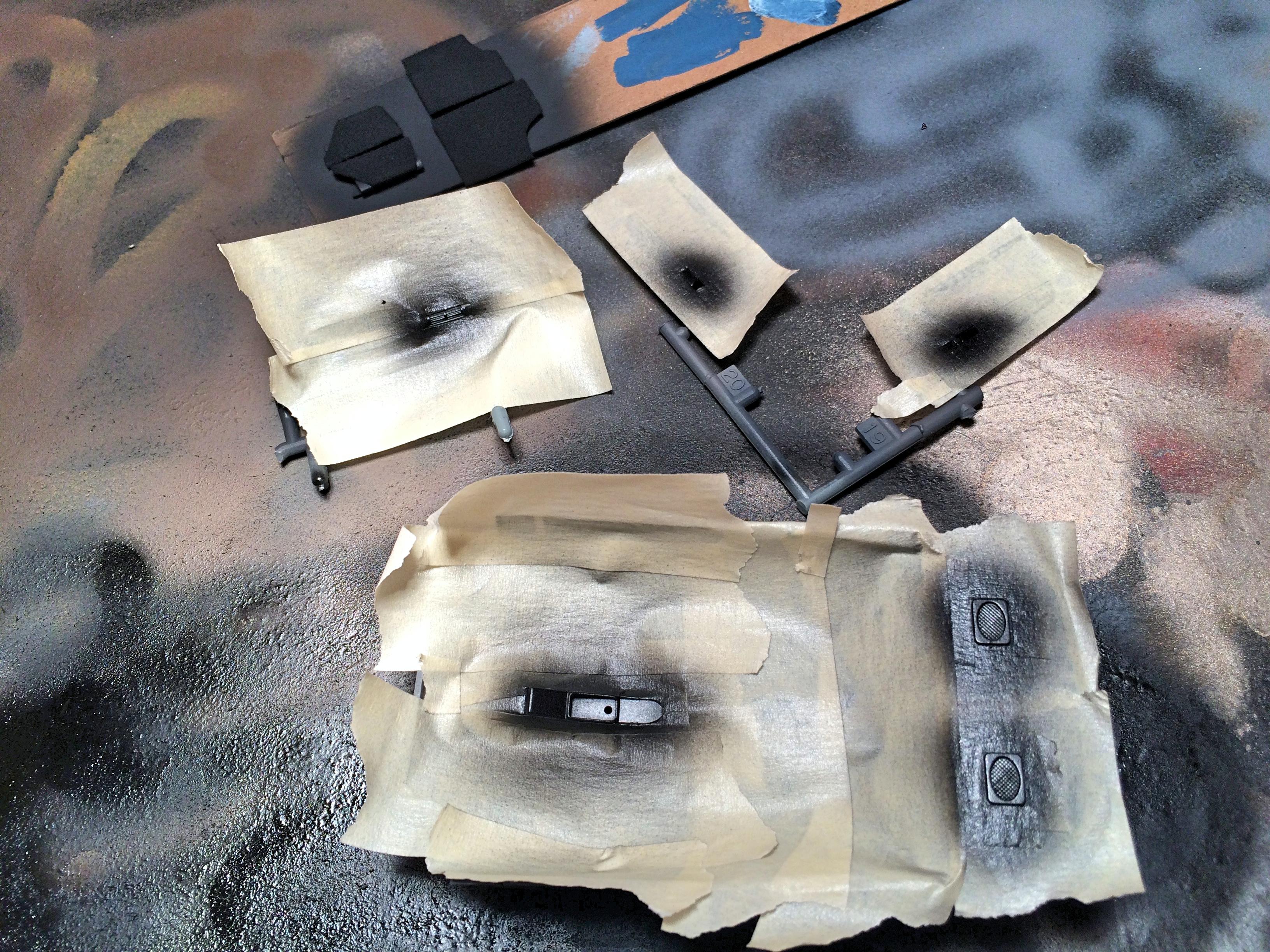

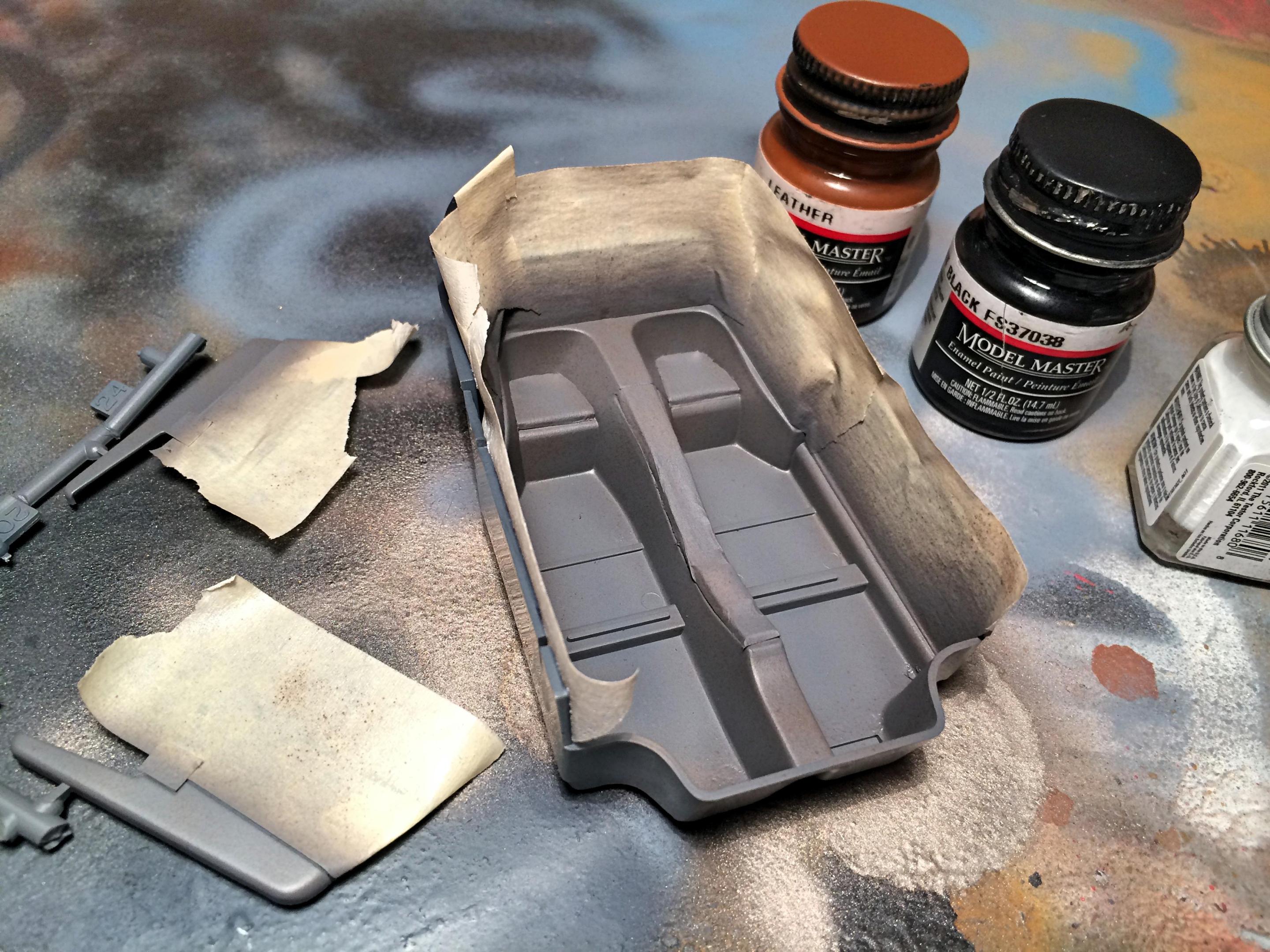

89AKurt Posted January 4, 2022 Posted January 4, 2022 "Best way" is subjective, this is what I'm comfortable with. This WIP sat for years in the box, because I was daunted by the multiple colors on the seats. If I recall correctly, there were 7 colors for the interior. I prefer regular masking tape, you can draw with a pencil on it. It cuts easily with a new #11 blade. When I work it down into the crevasse of the cushions, use a toothpick. Sometimes I use Scotch tape, if there are round shapes to go around. I so don't like brush painting! But I have to for touchup.
