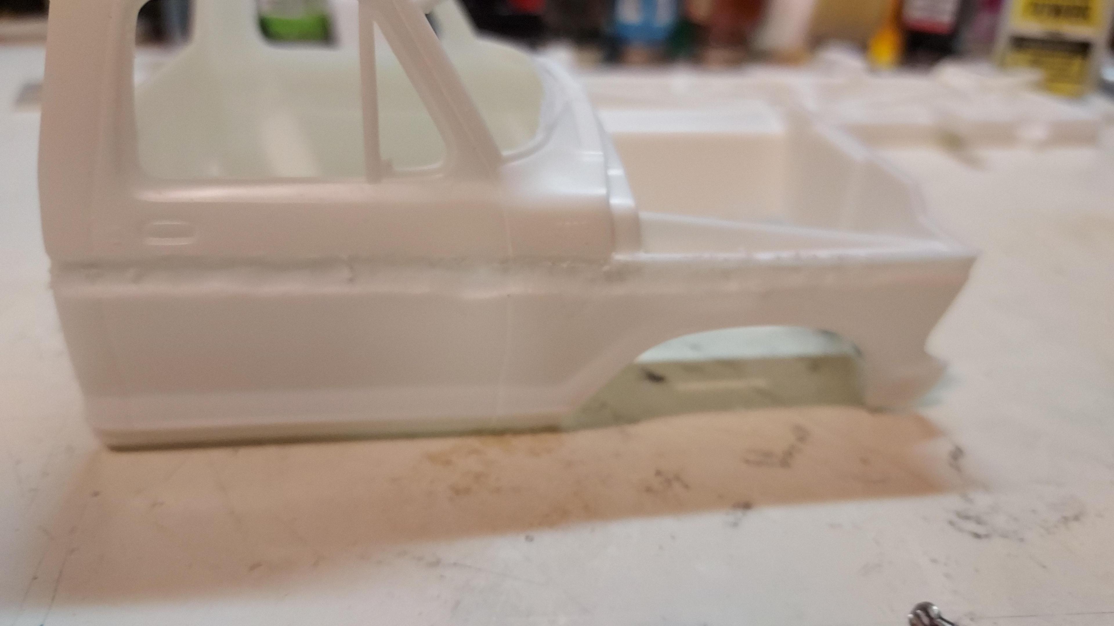

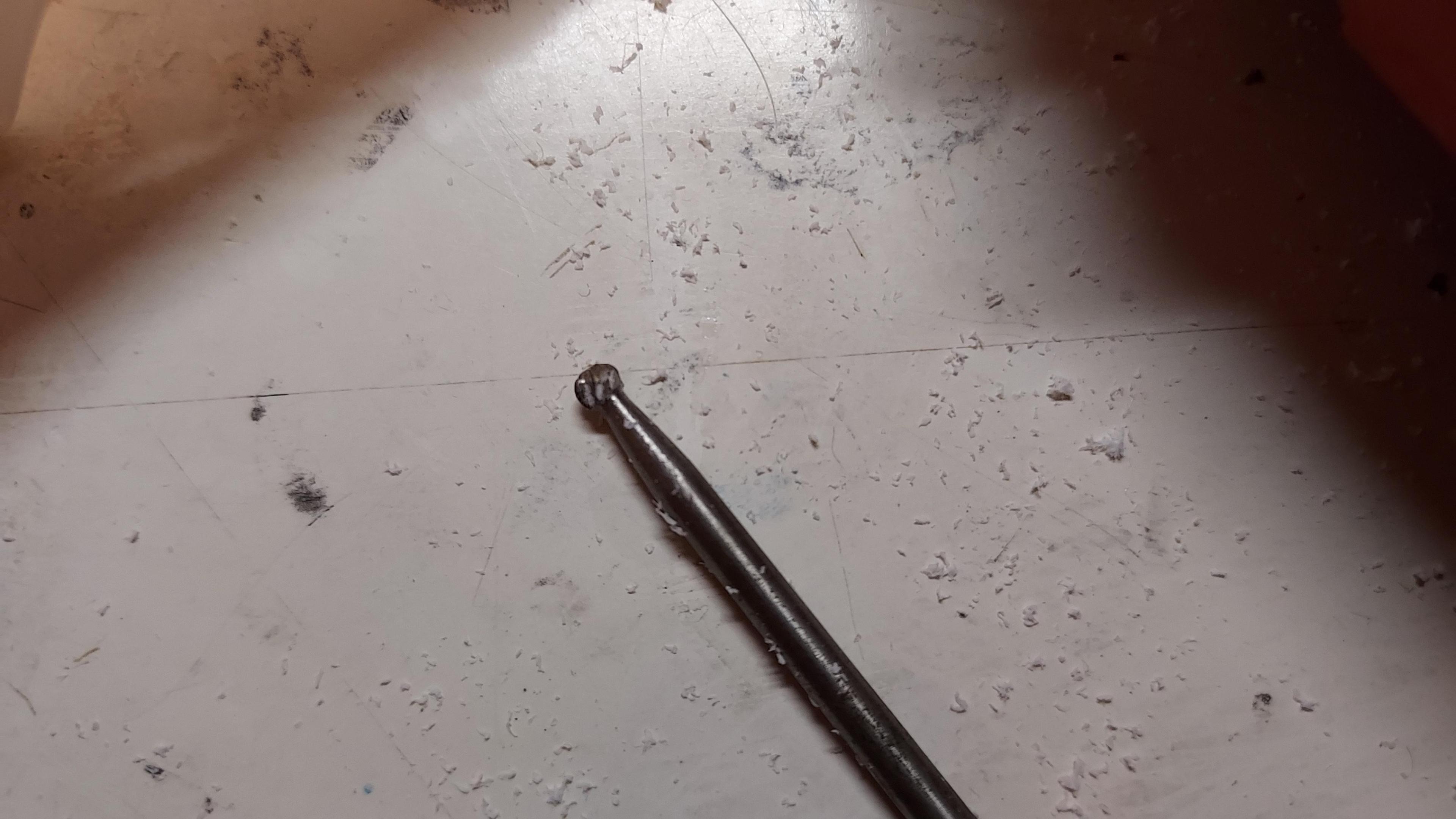

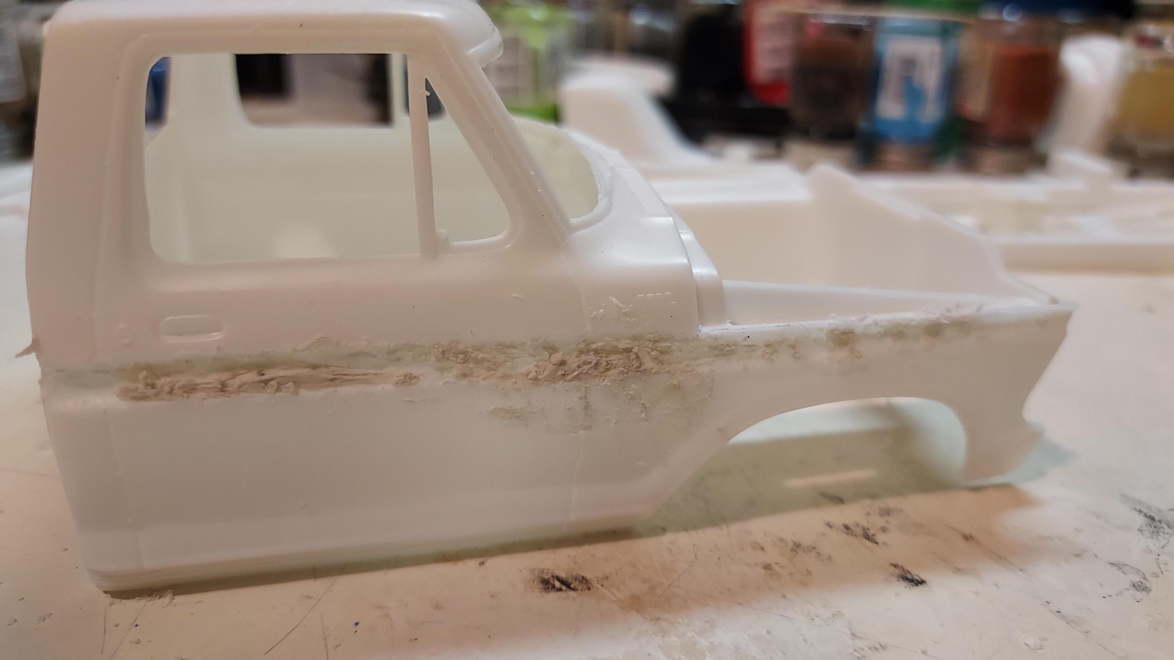

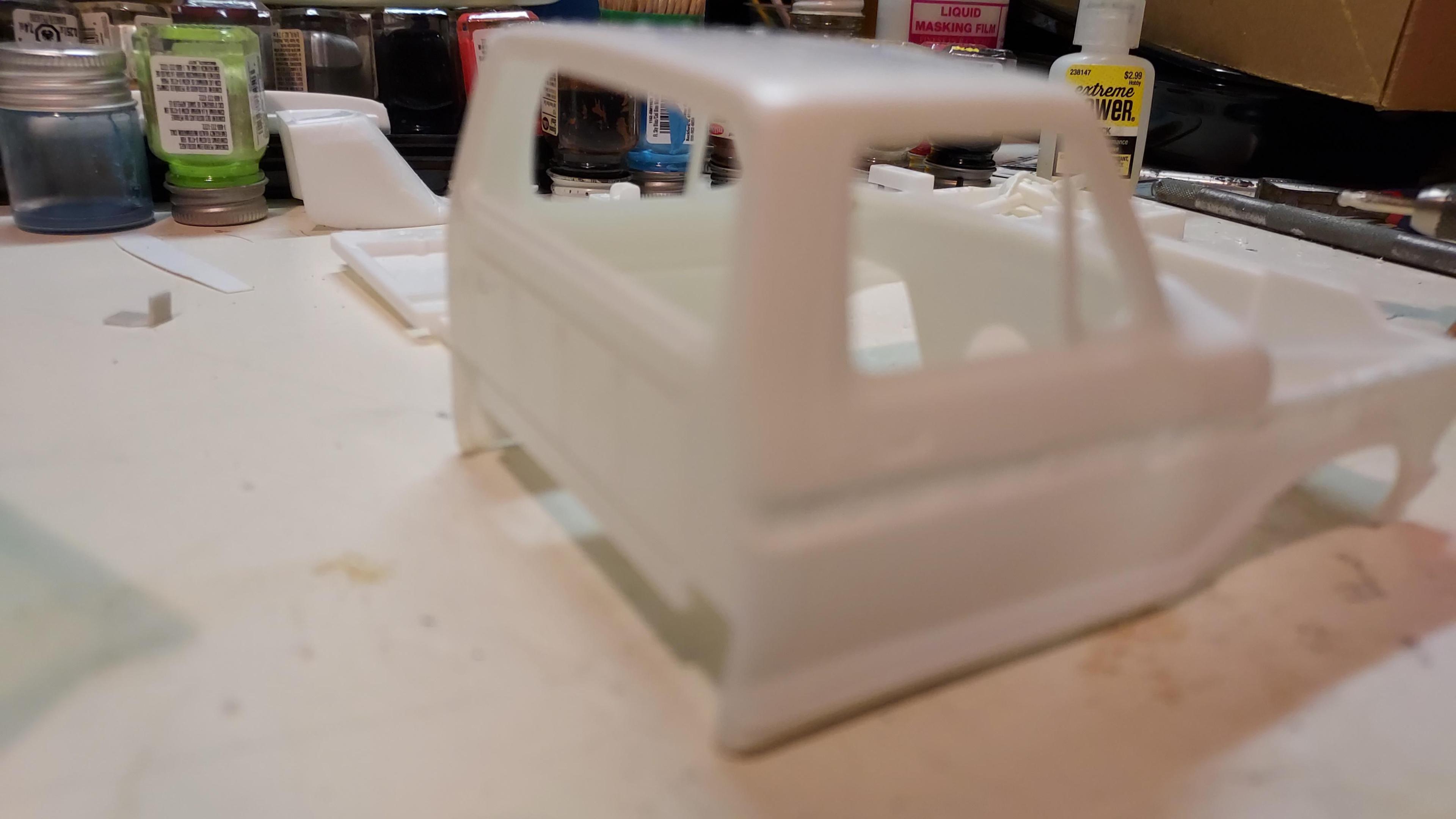

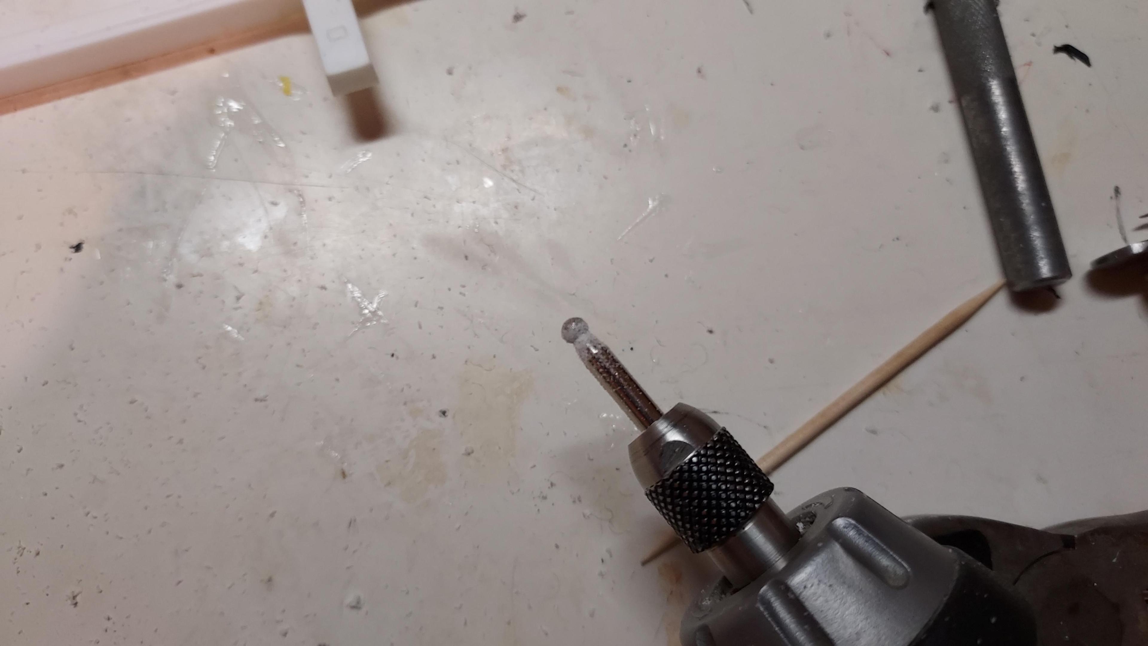

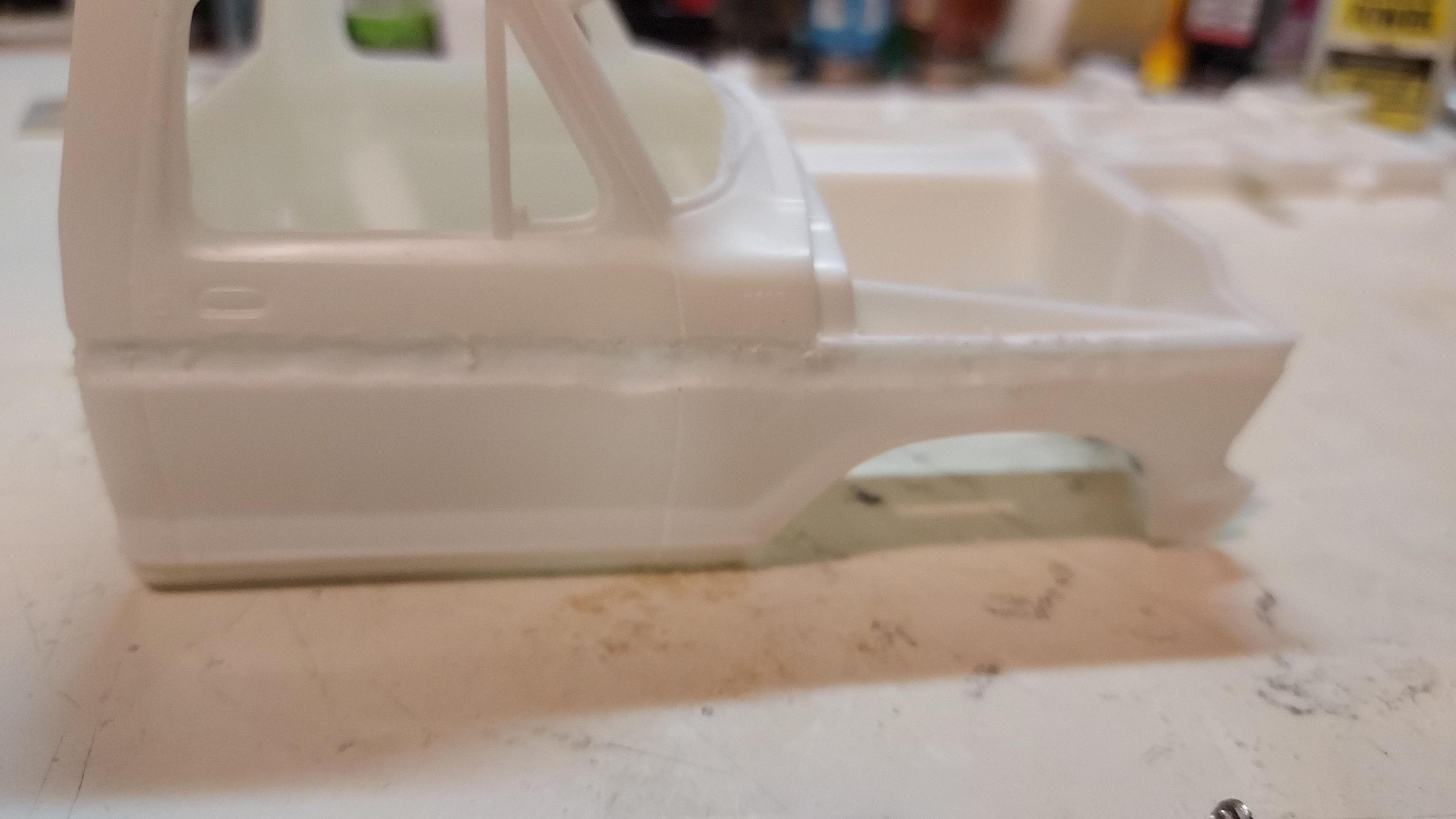

Starting way too many projects at one time again. I was thinking that I could build a tribute to my cousins f-250 custom that he bought new back in 1973. I remembered 2 Dremel bits that I had that make the job a snap (right?).
Well, I quickly regretted starting that. Turns out you need a much mor stedy hand to pull this off. I only finished one side of the cab and now I had to go back and put filler to correct all the inconsistencies in my snap chrome removal. Bad idea.

I've been considering that, but haven't worked up the nerve. I don't have the most steady hands.
Is your Dremel variable speed?
Yep.  I find low is almost always the way to go. I think I used med 1 time
I got the idea when I searched f150 on this board just to get some ideas and saw that someone did this . I thought my 2 bits would make it an easy undertaking.  When does that ever work out. ?
Nice project. This is a tough thing to do on this kit. I've done it twice and it's a PIA. My white 75 was done freehand and didn't come out very good. On my yellow 79 I used a couple old metal rulers and clamped them above & below the trim to keep from removing more than I wanted, then I finished with a round file. I understand your frustration but keep going and you'll get it.
