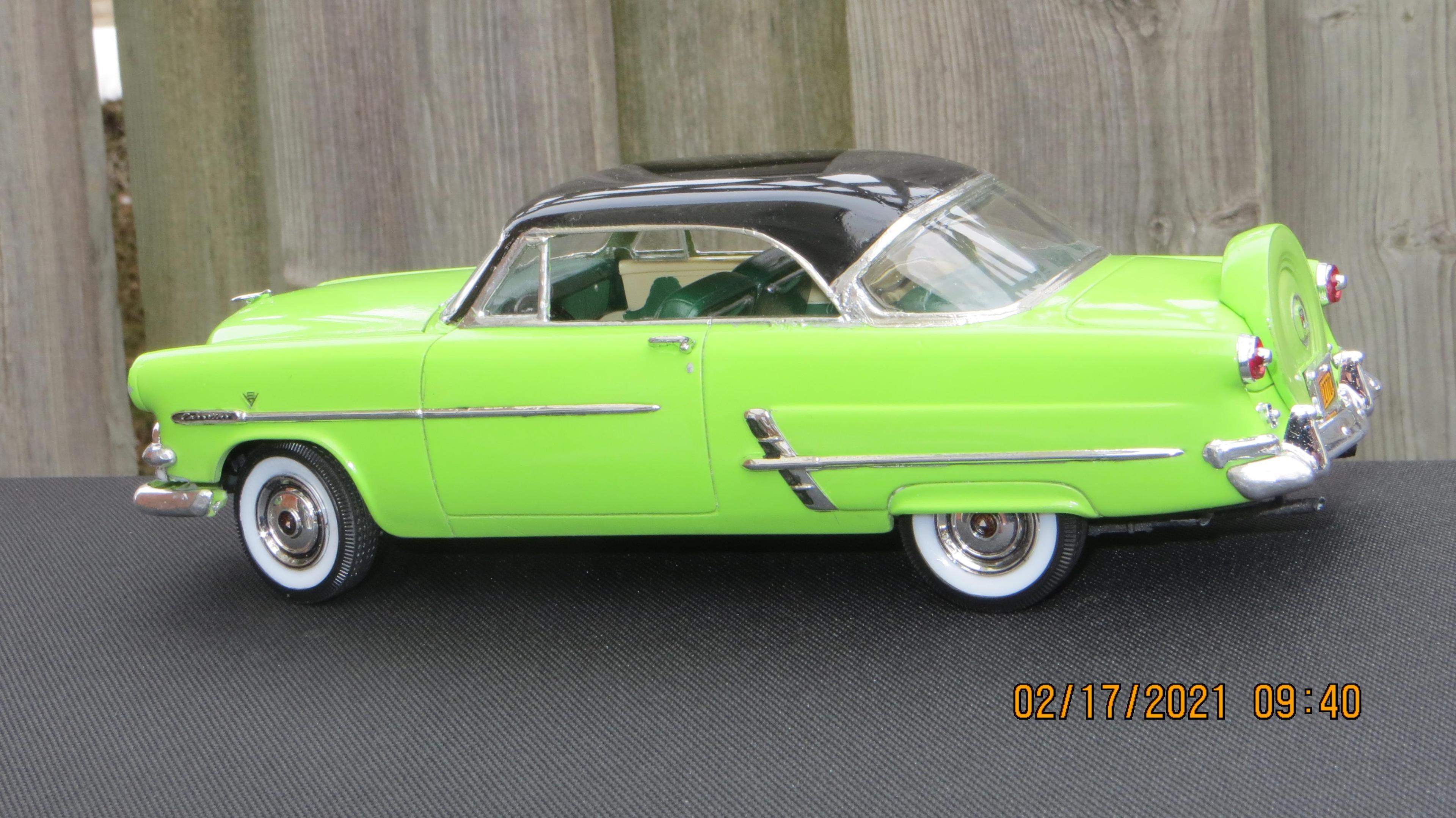

eastown Posted December 26, 2021 Posted December 26, 2021 Ceramcoat thinned with windshield washer fluid and airbrushed. 1

Dave G. Posted December 28, 2021 Posted December 28, 2021 On 12/26/2021 at 8:06 AM, eastown said: Ceramcoat thinned with windshield washer fluid and airbrushed. Nice Ford, clean build ! I assume it's clear coated, what with if so ?
eastown Posted December 28, 2021 Posted December 28, 2021 Clear coated with Pro-Form 4/1 two part clear, airbrushed. Thanks Bob.
