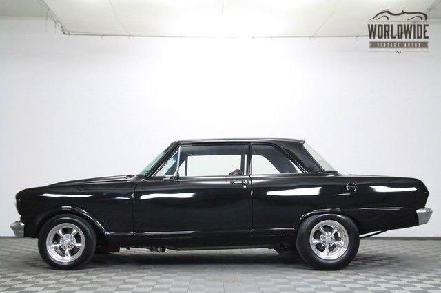

This photo shows how the door and quarter frames should look quite well.
This photo shows how the bottom of the backlight and the DLO are the exact same plane. It also shows that the lip above the beltline is pretty substantial.
So, no, I wouldn't say it's accurate at all.
Not sure what is going on with the black & white 1:1 in the pic above...has the '65 roof but '62-64 taillights???
And the parking lights in the front fenders, too, which the '65 doesn't have. WTH? :unsure:
Pretty sure it's actually a '64. Same sedan roof. The reason I used that photo is it shows the framing on the door and quarter windows well because of the way it's painted.
'64 sedan had the same roof as the '62-63, which is very different from the '65.   '62-64 2dr sedan roof had a thinner C-pillar and a larger wrap around rear window..
Edited by Rob Hall
  • Thanks 1
Rob has it right. That B&W car sure doesn't look like a '64 2DS body, but it doesn't quite look like a '65 either. I wonder if it's something of a "custom"? :wacko:
I think it's a '65 w/ a '64 decklid and taillights.  Not sure why someone would do that, unless they didn't like the '65 taillights...
It must be some kind of hodge podge. It has a '64 grille and a '65 bumper.
Is it possible it's a late '64 with a '65 roof? Kinda like how they used the '61 roofs on the first '62 Impalas? I hadn't looked at the front or rear before now. I just found that photo in a Google search and it showed the door and quarter window frames well.
No idea..all I know is what I've read that the sedan rooflines were new for '65.
