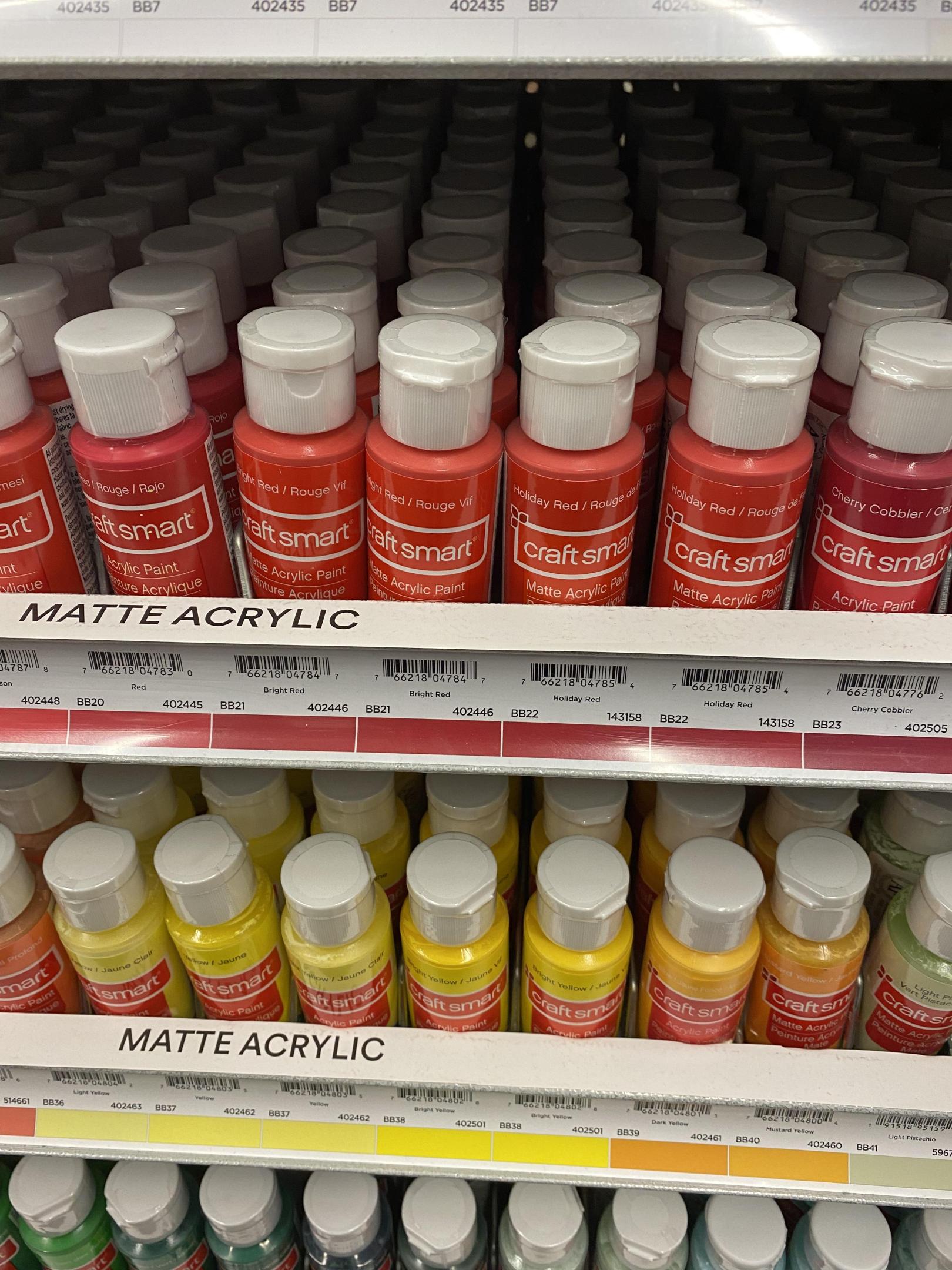

kymdlr Posted December 29, 2021 Posted December 29, 2021 Anyone have any experience with this paint? I had never heard of it but Michael’s had a big selection of them and there’re less than $2 per bottle.
Miatatom Posted December 29, 2021 Posted December 29, 2021 I gave about 50 bottles of it to my granddaughter who was getting into art. I've never had any luck with cheap craft acrylics. OK for interiors but that's it. I've had luck with Createx, which isn't anything like the craft stuff. Actually, I'm not really sure that it's an acrylic.
yh70 Posted December 29, 2021 Posted December 29, 2021 probably the same as Walmart sells . lot of these paints come from the same factory with the different stores having a different brand bottle.. a lot of builders air brush the Walmart brand . i use them for small parts.
Dave G. Posted December 29, 2021 Posted December 29, 2021 (edited) I use it all the time, now it's not my first choice in craft paints but they do work absolutely fine if you understand them.. They are thinner than most so you don't thin quite as much so it takes an extra coat or two and dries fine in terms of film thickness.. In the thread on Folk Art craft paints both examples I posted were base coated in Craft Smart Rose Gold. My thinner combo mentioned in that same thread works very well in Craft Smart. You just may need an extra coat or two compared with Folk Art as already mentioned. I noticed lately that my local Micheals store is really plugging Craft Smart and the secondary line is more Deco Art and far less FolkArt than they used to have. I did a 39 ford sedan, bought three different craft paints and once again settled on a green that happened to be Craft Smart. Then clear coated that with X-22 Tamiya. Came out quite nice. I shot 3 base color coats. Scuffed the roof and shot 2 more. When I say coats I mean I Shot a coat flashed it off, then the next etc. It's hugely affected by the color primer you use, I shot three test shots before shooting the body, one over white, grey and black. The black won and that's what I used on the sedan. If i can dredge up a photo later I will post it in this thread. It's stock so I didn't go for wet look with it but traditional 1939 finish look. I do confess that on these old cars craft paints work but enamel is more my go to and I could do an entire thread on just enamel alone since I've been shooting it for 60+ years + 35 1/1. Craft paints and acrylics only 4-5. I took two years to learn the ways in all sorts of test shoots of various craft and acrylic paints, it became a fun and educational hobby in itself ! Edit: the photos aren't worth posting, apparently on my computer I saved thumbnails. Edited December 29, 2021 by Dave G.
Claude Thibodeau Posted December 30, 2021 Posted December 30, 2021 Hi Ron! I use them often, but for interior parts only. Don't thin them too much, because they will end up like skimmed milk, and the base color/primer influence the final shade. So you would then need too many coats to achieve a satisfying result. CT
Dave G. Posted December 30, 2021 Posted December 30, 2021 On 12/28/2021 at 11:34 PM, Miatatom said: I gave about 50 bottles of it to my granddaughter who was getting into art. I've never had any luck with cheap craft acrylics. OK for interiors but that's it. I've had luck with Createx, which isn't anything like the craft stuff. Actually, I'm not really sure that it's an acrylic. Createx is acrylic. It's much like a soft body artist paint, high pigment designed originally for fabrics and T shirt artists. It remains flexible.
kymdlr Posted January 3, 2022 Author Posted January 3, 2022 Thanks for the replies. I only brush acrylics for interiors and small parts on motors. I was curious if this paint was comparable to Vallejo model acrylics or tamiya acrylics when brushing.

Dave G. Posted January 3, 2022 Posted January 3, 2022 2 hours ago, kymdlr said: Thanks for the replies. I only brush acrylics for interiors and small parts on motors. I was curious if this paint was comparable to Vallejo model acrylics or tamiya acrylics when brushing. Craft paints are closer in nature to Vallejo Model Color than to Tamiya. Pigments are finer and denser in the Vallejo. I use Vallejo or craft paints for your purpose, mostly craft paints. But everything is primed on my models though fwiw. I prime all the parts but the body right on the sprue then touch up later. I put my craft paint on a painters pallet and a little water or thinner near by. A touch of water in it will help flow and get rid of brush strokes. With Vallejo you use their flow aid. And with Tamiya you use retarder for brush painting. Craft Smart is fine for what you want to do. I've gone from spraying my engines to brushing them with craft paints myself in fact. Then weather with oil stains that are water clean up ( don't ask, it just works that way, no clue how, there are water clean up oil stains out there now and oil paints too).
