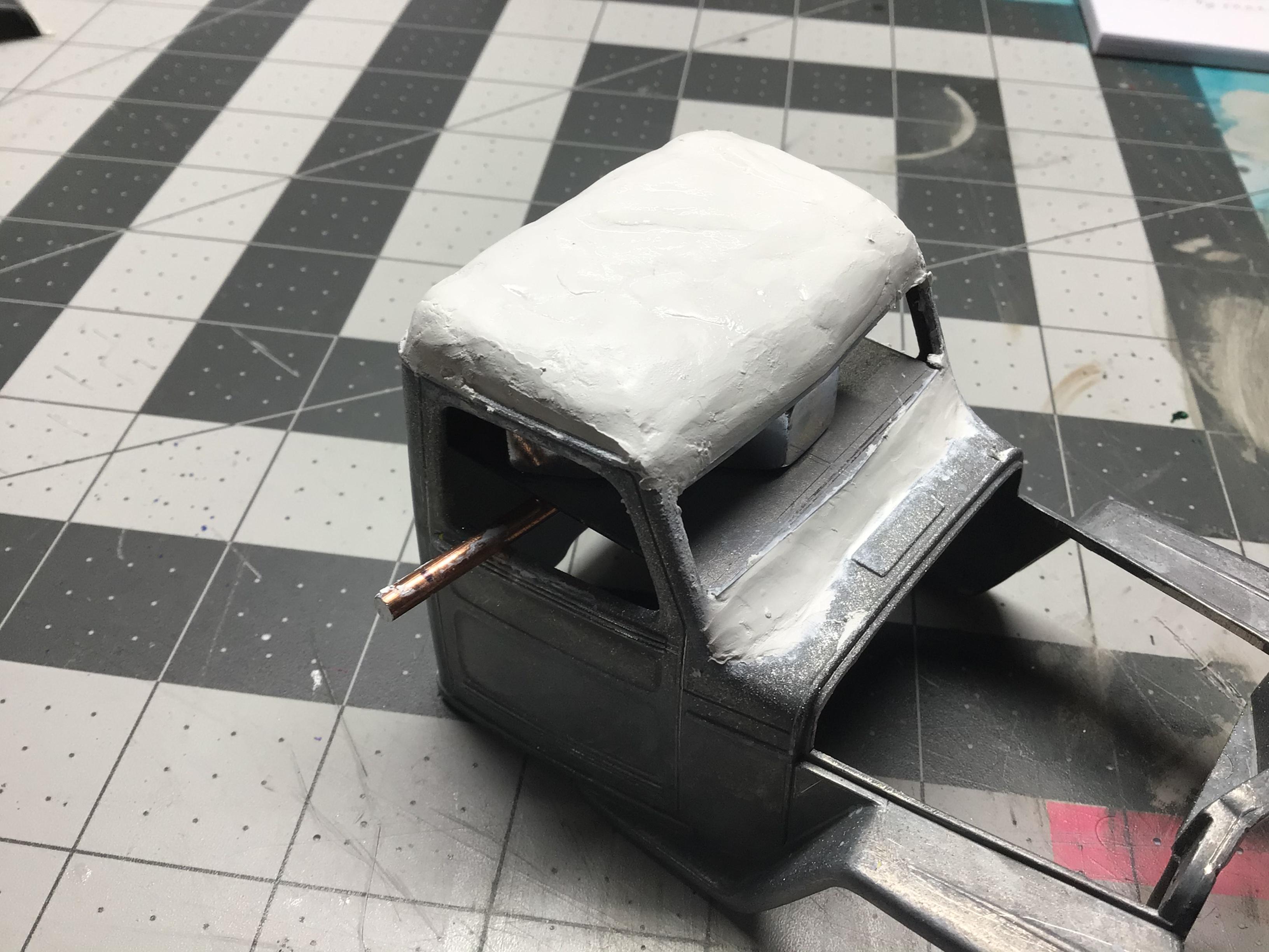

NOBLNG Posted January 4, 2022 Posted January 4, 2022 (edited) This is Milliput Fine. You can put it on as thick as you want to, and it sands very nicely! It is a two part putty, and depending on how thick you want to go it may work better. There is also Tamiya Epoxy which is similar, or JB Weld. I believe the regular JB stuff cures harder than the 5 minute variety, but I have not used it personally. Edited January 4, 2022 by NOBLNG

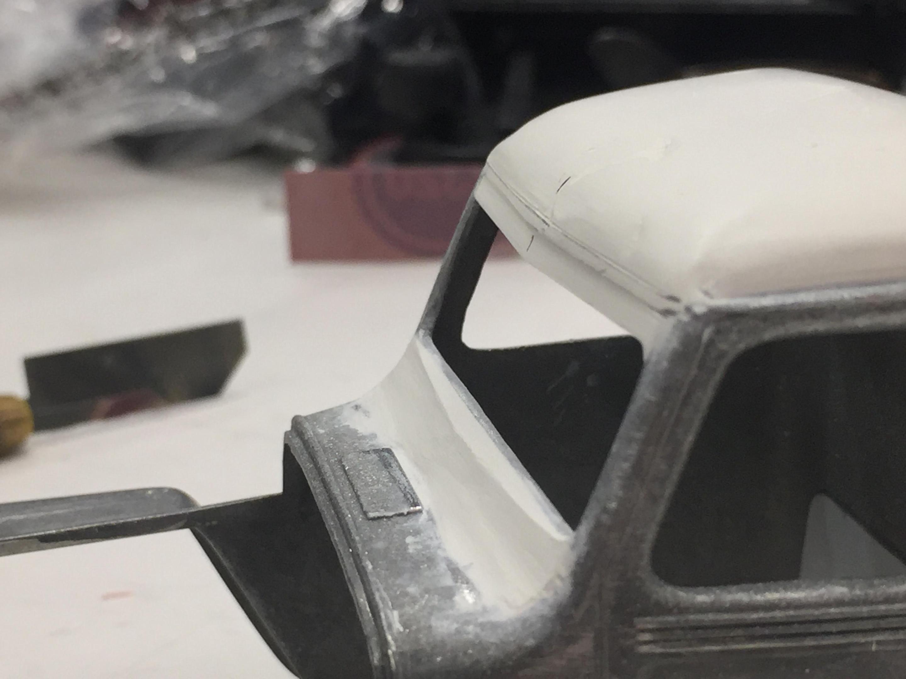

Ace-Garageguy Posted January 4, 2022 Posted January 4, 2022 (edited) 14 minutes ago, NOBLNG said: This is Milliput Fine, and it sands very nicely! It is a two part putty, and depending on how thick you want to go it may work better. There is also Tamiya Epoxy which is similar, or JB Weld. I believe the JB slow cure stuff sets better than the 5 minute variety, but I have not used it personally. Yes, the epoxies are generally excellent if used correctly, and will definitely adhere to diecast better than the polyester 2-part materials. For something a little more exotic, people can consider epoxy mixed with microballoon. We use it for light and strong filler on real airplanes. I prefer the West 105 epoxy, but any decent slow-curing epoxy should work (I'd advise against the 5-minute stuff, unless you experiment first and test its adhesion in thin sections). I used a West 105/microballoon mix on this build, and was VERY happy with the results: EDIT: Scroll to page 6 of the thread below for the final result, one of the very few models I've actually finished (at least to the curbside stage ) Edited January 4, 2022 by Ace-Garageguy

rightrudder Posted February 25, 2022 Posted February 25, 2022 On 1/4/2022 at 8:18 AM, Ace-Garageguy said: Yes, the epoxies are generally excellent if used correctly, and will definitely adhere to diecast better than the polyester 2-part materials. For something a little more exotic, people can consider epoxy mixed with microballoon. We use it for light and strong filler on real airplanes. I prefer the West 105 epoxy, but any decent slow-curing epoxy should work (I'd advise against the 5-minute stuff, unless you experiment first and test its adhesion in thin sections). I used a West 105/microballoon mix on this build, and was VERY happy with the results: EDIT: Scroll to page 6 of the thread below for the final result, one of the very few models I've actually finished (at least to the curbside stage ) Bill, I'm a big fan of both microballoons and West Systems epoxy. I used quite a bit building an Experimental aircraft (Van's RV-9A) but have yet to use it on a model. It sands so easily, like chalk. Hard at first to get the right consistency for "dry micro" and those tiny spheres blow all over the place before you mix in the epoxy, but it's another great arrow in the quiver. OT, but do you work with composite aircraft? My use of the stuff was limited to the cowling and wheel pant intersection fairings, stuff like that. Beautiful Challenger One!! 1
Ace-Garageguy Posted February 25, 2022 Posted February 25, 2022 (edited) 1 hour ago, rightrudder said: ...OT, but do you work with composite aircraft? Yes (not lately); I'd been doing automotive composites for many years previously, started repairing sailplanes with a shop here a few decades back, moved into general aviation...mostly Cirrus heavy structural stuff; did a lot of work on a racing Lancair build (getting the airfoils symmetrical and matching the blueprints, general fairing), other custom work on some other kitplanes. Learned one helluva lot working on aircraft, bring a lot of it back to the hot-rod biz now (and models). Beautiful Challenger One!! Thank you, sir. EDIT: I spent a some time with a gram scale developing just the right repeatable mix of West and micro; don't know where the notes are, but they're sure to surface during packing to finish moving. Edited February 25, 2022 by Ace-Garageguy 1
