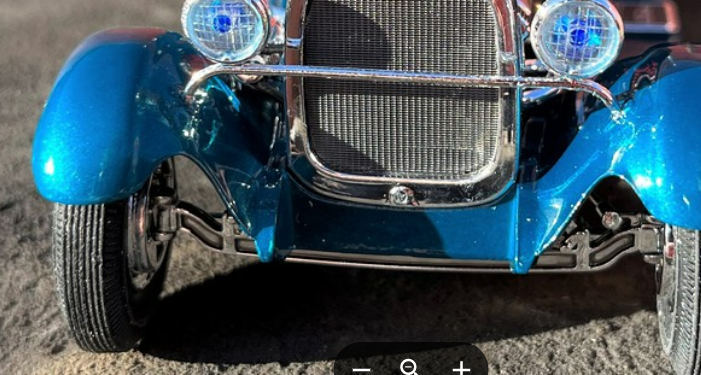

Modelbuilder Mark Posted March 17, 2023 Posted March 17, 2023 (edited) I prefer two part polyester (bondo) style like others have mentioned if I am using putty, but lately I have been using either styrene melted either with heat or liquid cement, or superglue with/without micro-balloons and accelerator which allows me to work it in minutes. In all of these cases, I do not need to worry about shrinking over time. Here is a short shot fender that I filled with melted sprue, from the same kit. I used a flame for this one, but it is better/more controlled to use a soldering iron. The advantage to this over putty is that it also provides strength. First round subsequent brush on filler primer final results Edited March 17, 2023 by Modelbuilder Mark
