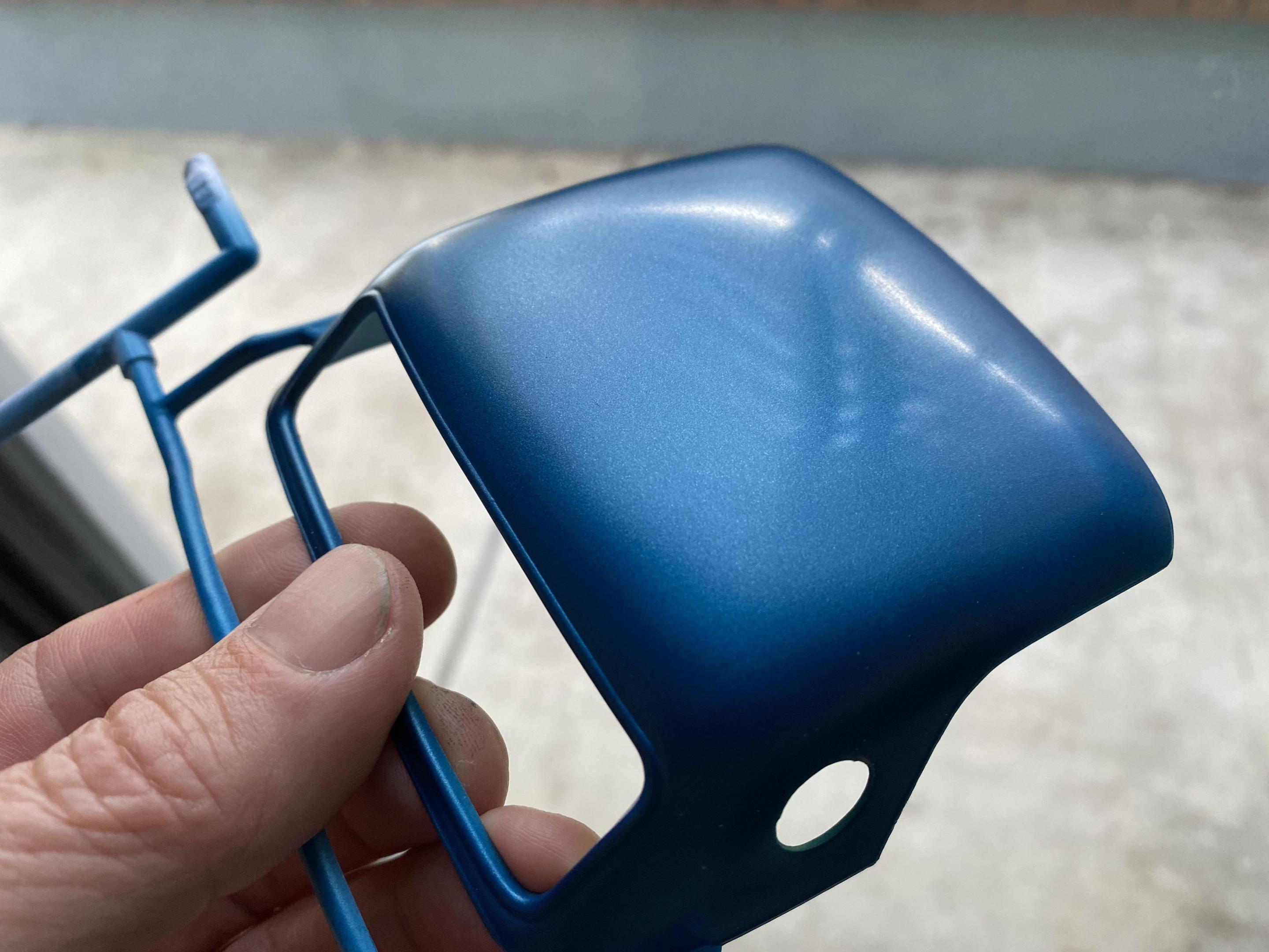

rightrudder Posted January 13, 2022 Author Posted January 13, 2022 Thanks, Pete. Your description does help me visualize what's going on with metallics. I've been rethinking the paints I want to use, given my skill level. Using an airbrush, I'm most familiar with Tamiya acrylics and am leaning toward using them on the body. I've been experimenting on a practice kit (1/16th '57 T-Bird) that I destroyed, but it's really helpful to use the parts to try out different techniques. The acrylics go on super smooth! Here's Tamiya Metallic Blue (X-13) thinned with rubbing alcohol, sprayed over bare plastic, then wet sanded with 1500 grit and polished with Meguiar's Ultimate polish. I think it would look amazing with a polished clear coat on top...and I do realize that I wouldn't polish the base coat before applying clear; I was just messing around here. I think this blue would really do justice to the '62 Bullet Bird project (kit should arrive Sunday), with maybe a lighter blue & silver interior.
Dpate Posted January 14, 2022 Posted January 14, 2022 5 hours ago, rightrudder said: Thanks, Pete. Your description does help me visualize what's going on with metallics. I've been rethinking the paints I want to use, given my skill level. Using an airbrush, I'm most familiar with Tamiya acrylics and am leaning toward using them on the body. I've been experimenting on a practice kit (1/16th '57 T-Bird) that I destroyed, but it's really helpful to use the parts to try out different techniques. The acrylics go on super smooth! Here's Tamiya Metallic Blue (X-13) thinned with rubbing alcohol, sprayed over bare plastic, then wet sanded with 1500 grit and polished with Meguiar's Ultimate polish. I think it would look amazing with a polished clear coat on top...and I do realize that I wouldn't polish the base coat before applying clear; I was just messing around here. I think this blue would really do justice to the '62 Bullet Bird project (kit should arrive Sunday), with maybe a lighter blue & silver interior. You should ditch the rubbing alcohol and get some mr hobby leveling thinner. https://spraygunner.com/gsi-creos-mr-color-leveling-thinner/?sku=T108&gclid=Cj0KCQiAuP-OBhDqARIsAD4XHpf9mUZVLEco-G7H5ziXyf6gBHGJodkjyuQHTojDbsQ5mWD-jBPT0Y4aApQdEALw_wcB

OldNYJim Posted January 14, 2022 Posted January 14, 2022 I’d be more than happy with that finish you showed above as being ready for clearcoat - looks great!
