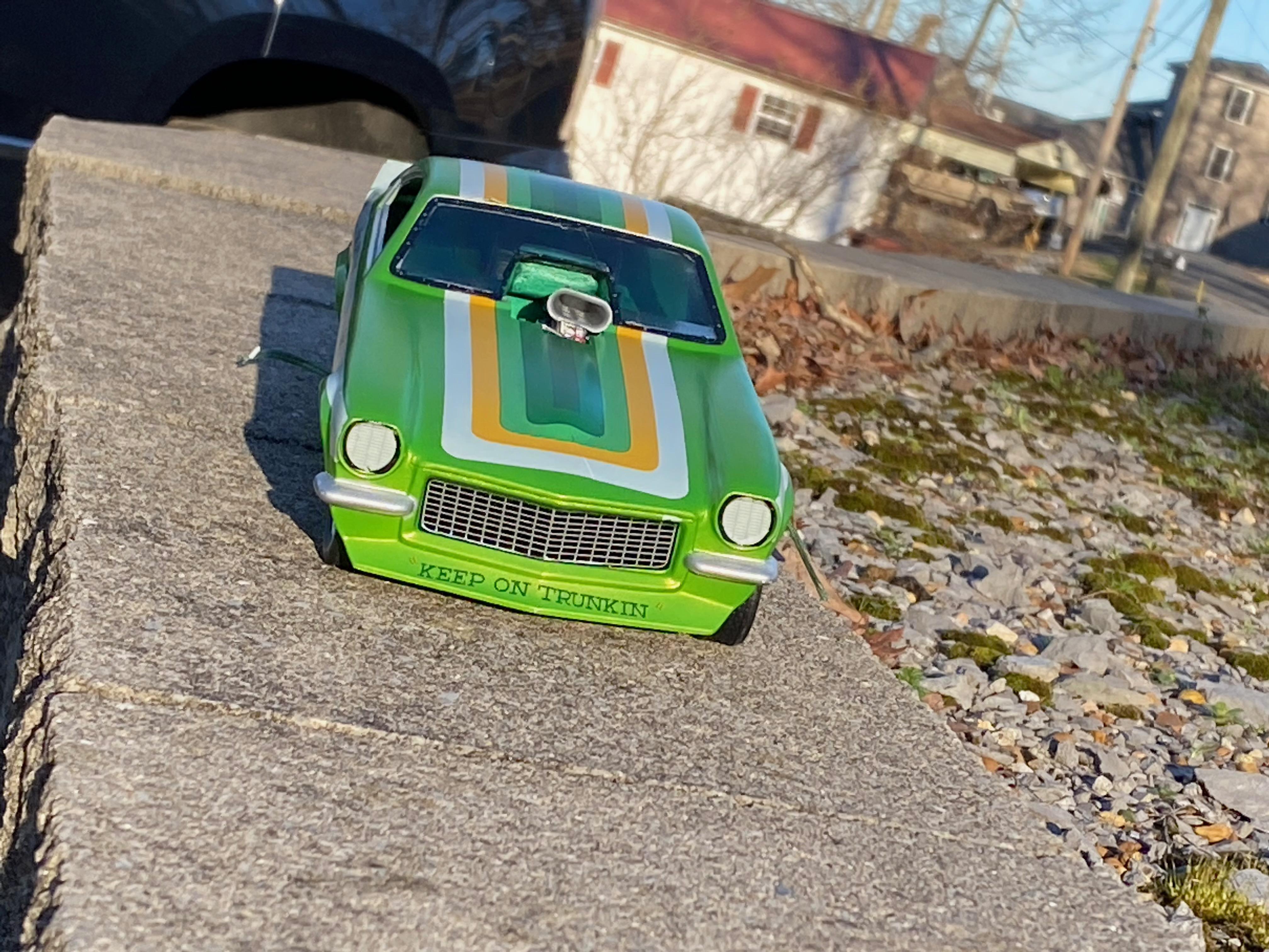

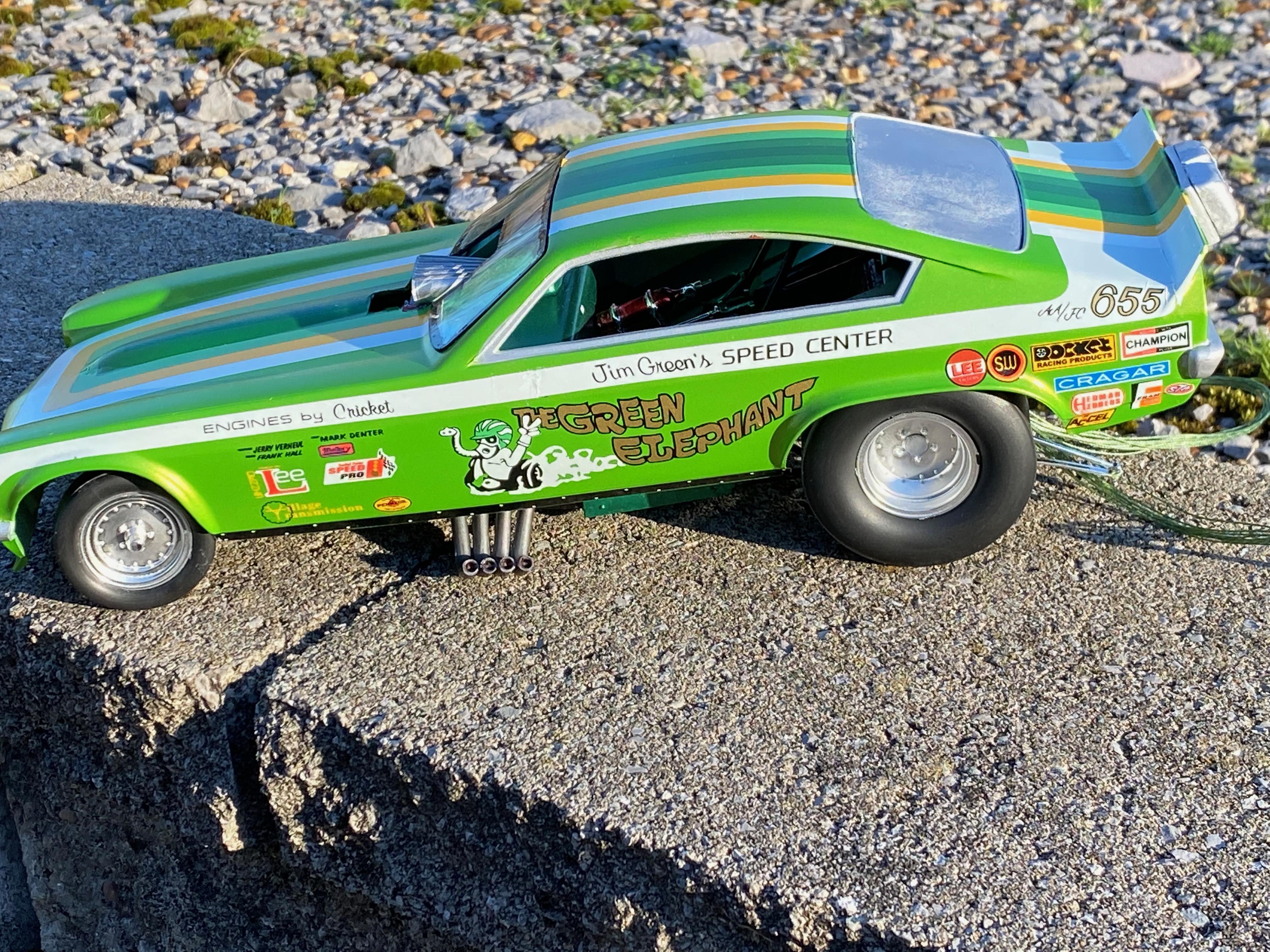

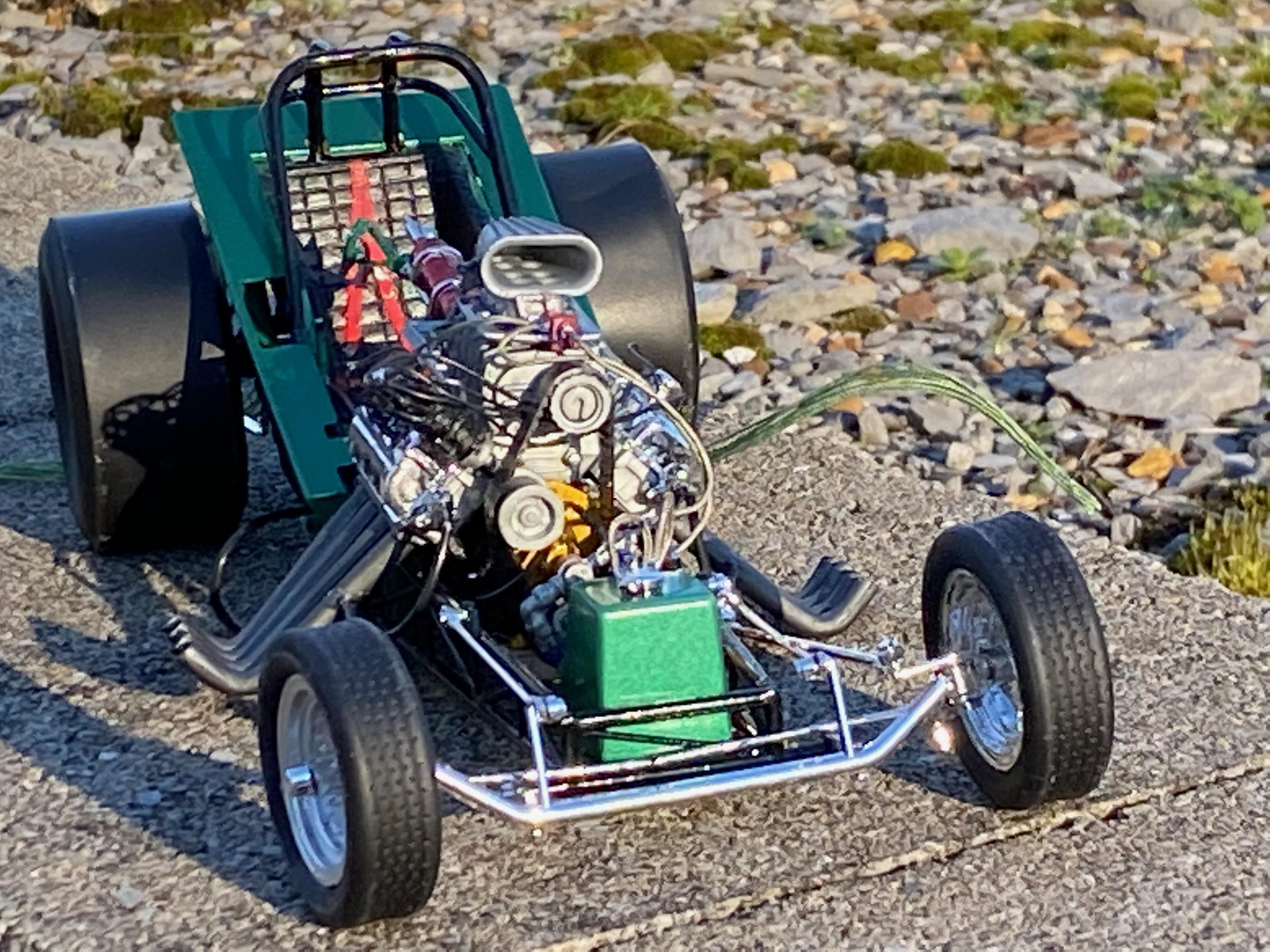

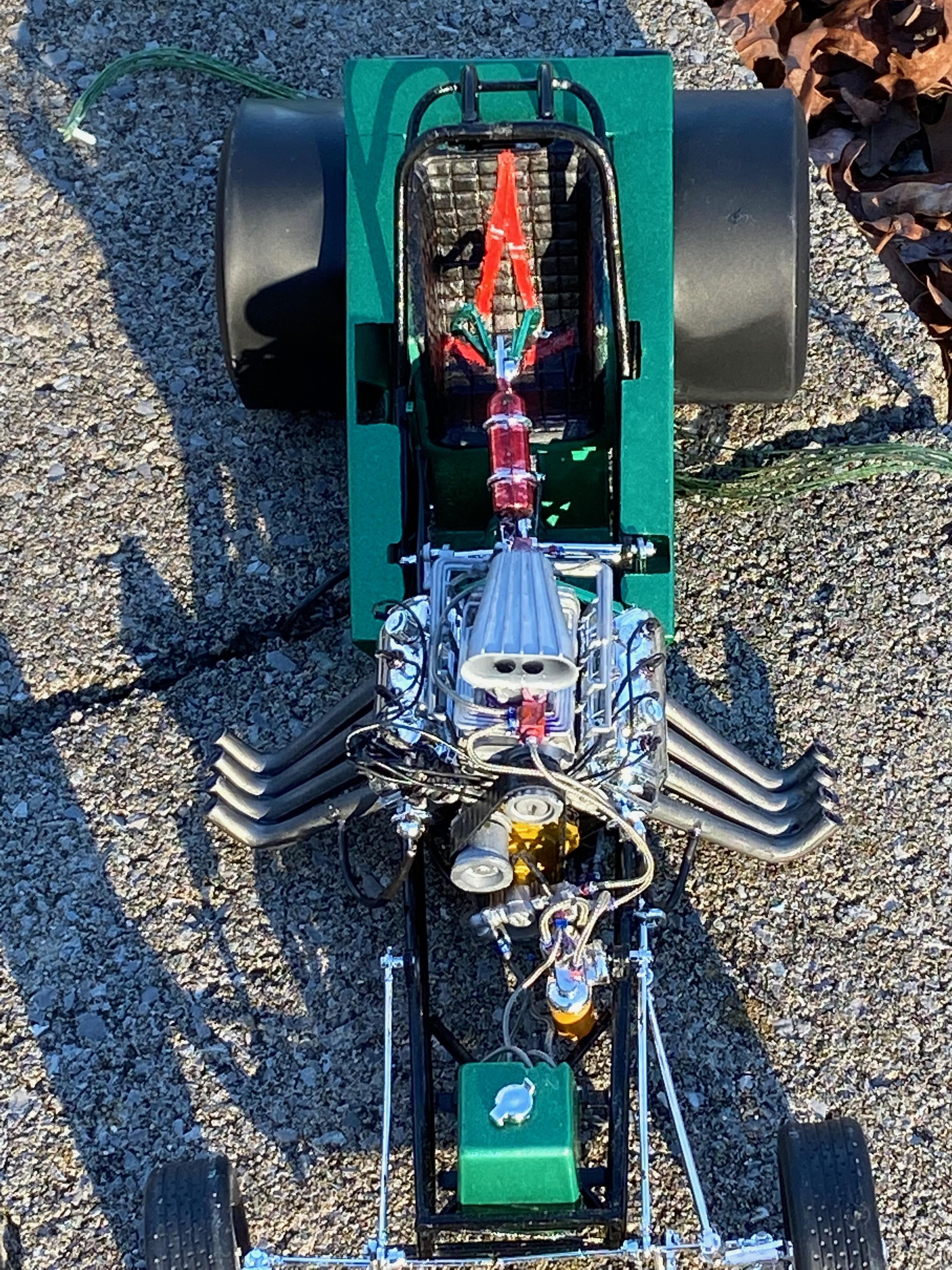

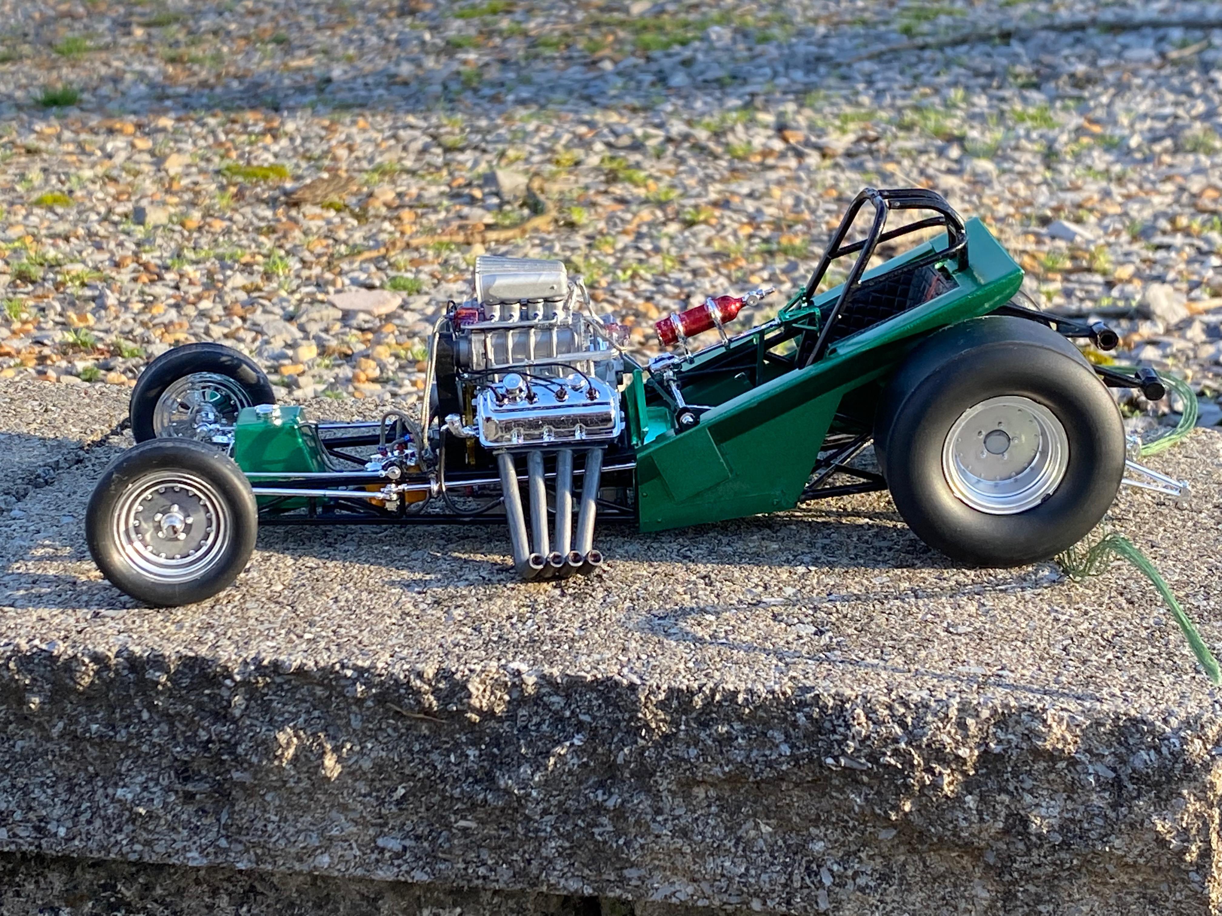

sflam123 Posted January 10, 2022 Posted January 10, 2022 I received my Green Elephant kit almost exactly 6 months ago. Building this kit has simultaneously been one of the most satisfying builds and one of the most frustrating. I put more effort in to getting as much as I could historically correct and adding that extra level of detail in to this one. The paint on the body is Tamiya TS52 Candy Lime Green over grey primer. The tins are painted with Tamiya TS 20 Metallic Green. Pro-Tech braided lines were used on the engine for fuel and oil lines, and Pro-Tech spark plugs wires were used in place of the plastic lines supplied with the kit. The engine injectors and injector hat are resin parts from LPH 1320 Model Parts, and are some of the most detailed parts I've ever found. Overall the kit built up pretty much like any Revell 1/16 kit. I know Atlantis made some modifications to adjust the stance, and I made additional modifications to lower the back end and get the nose down. The use of the LPH parts necessitated modifying the interior tin in the blower area, as I raised the blower cover 5mm (approx.). From what I can find, the real car always ran two parachutes, so I built up a new mount for the parachutes and "stole" a parachute pack from another 1/16 kit. A word of caution to anyone building this kit in the future. When I received the kit, the front windshield was in two pieces, although the box was pristine and sealed. I contacted Atlantis and they immediately sent out a new windshield. HOWEVER....the new windshield cracked when I glued it in place with Testors clear plastic glue. The curvature of the windshield does not match the curvature of the body and the windshield is very thin, so it fractures with very little stress. The decals were probably the most frustrating things I've ever dealt with. The completed model is actually a combination of two separate decal sheets, both from Atlantis. The first attempt at decaling the car was an unqualified failure! The hood and roof decals WOULD NOT lay flat (despite going through a half bottle of MicroScale MicroSol!) and bubbled up as they dried. Both the white side stripes also bubbled badly. After removing the bubbled decals, I again attempted to get the decals to lay down, (using the rest of the bottle of MicroSol) and a new technique. I heated the body up with a hair dryer as the decals soaked in water. I then slid the decal on the warm-up body and applied MicroSol and with a very wet cloth continued to smooth and apply pressure to get them to lay down. I still got a small wrinkle on the hood decal, but although I'm not happy, I'm not buying another set of decals! I have been building models for just over 60 years, and at almost 68 years of age, this is probably the best I can do on detailing and assembling a model. I hope you all like it. Questions and comments welcome! 1

sflam123 Posted January 11, 2022 Author Posted January 11, 2022 2 hours ago, TonyK said: Your finished model looks great. The body and decals look good too as I don't see any imperfections. I have this model and now you've scared me with your experience building it. There isn't any need to be scared! FOR THE MOST PART, the kit assembles just like any of the Revell 1/16 Funny Car kits. My suggestions to make your experience more enjoyable are: 1. Replace the kit supplied spark plug wires (which are stiff plastic) with aftermarket spark plug wires and boots. My personal preference is Pro-Tech, but there are several that make them. 2. Test fit EVERYTHING. I've built LOTS of the Revell 1/16 kits. I know what does and doesn't need checking. Even though this is just an updated "Jungle Jim Vega" kit, there were some parts that I didn't check, that I expected to fit, that didn't without some minor adjustments, and that caused some of my frustrations. This is totally on me and has nothing to do with the kit. 3. Don't use the rear window decal!! Either leave the rear window clear glass or do what I did, paint the rear window silver/aluminum. The decal is just a little too large and it interferes with the the roof and trunk decals from seating at the ends and IMO, contributed to the "Bubbling" I experienced with the first set of decals. 4. If you use the kit supplied tubing, become friends with your wife's hair dryer. Even though I didn't use much of the tubing supplied, choosing to use Pro-Tech braided line for most of the plumbing, I did use some. The tubing supplied with the kit is fairly stiff and it made getting the bends required somewhat difficult. Heating the tubing before using it made it more pliable. I certainly hope you have fun building up your kit. I'll gladly answer any question you may have as you progress on it. Just message me.

sflam123 Posted January 30, 2022 Author Posted January 30, 2022 1 hour ago, V8tiger said: This looks amazing to me. I'm doing the same model and was wondering hat size braided line did you use? This is the first time I've worked with this scale.. thank you At the recommendation of Charles at Pro-Tech Model Parts, I used 045" braided line for the oil lines and .035" braided line for the fuel lines. I think Charles' recommendations were perfect!
